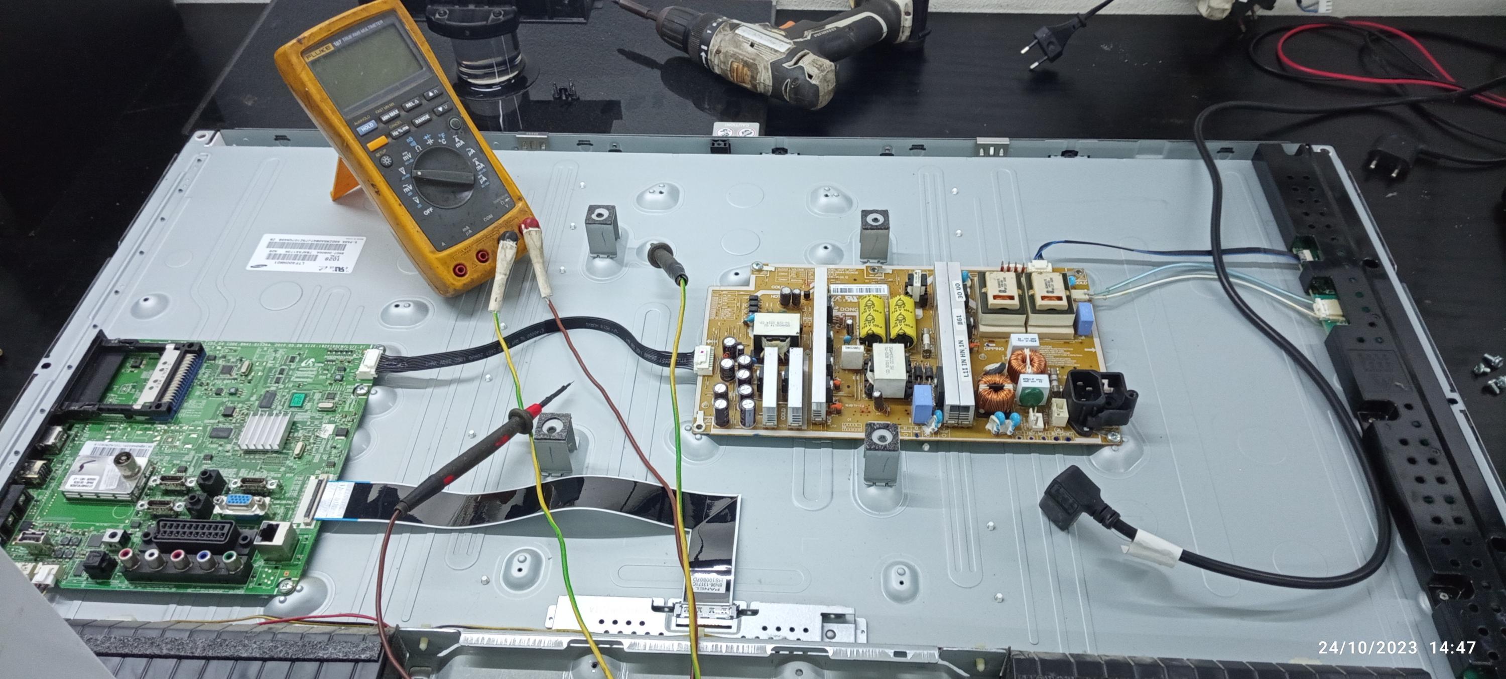

      While its on check voltages of connector CN802, 1-18, report here. like 1 pin b13 and the voltage, 2 pin xxx and so forth.

        Re: Samsung Backligth
        Image is present, tcon as got the 12v present, image is not so easy to see in this ccfl lcd´s.... its easy to see in led´s sets.
        Here goes the voltages:
        1- 12.95
        2- 0
        3- 12.95
        4- 4.49
        5- 12.95
        6- 2.08
        7- 0
        8- 1.78
        9- 0
        10- 0
        11- 5.25
        12- 0
        13- 5.25
        14- 5.25
        15- 12.95
        16- 5.26
        17- 12.95
        18- 2.11
        18 PS-on
        16 A5v
        15/17 B13v
        11/13/14 B5v
        9/10/12 Gnd
        8 H_Sync
        6 E-Pwm
        4 BL-on
        2 5v det
        1/3/5 B13v

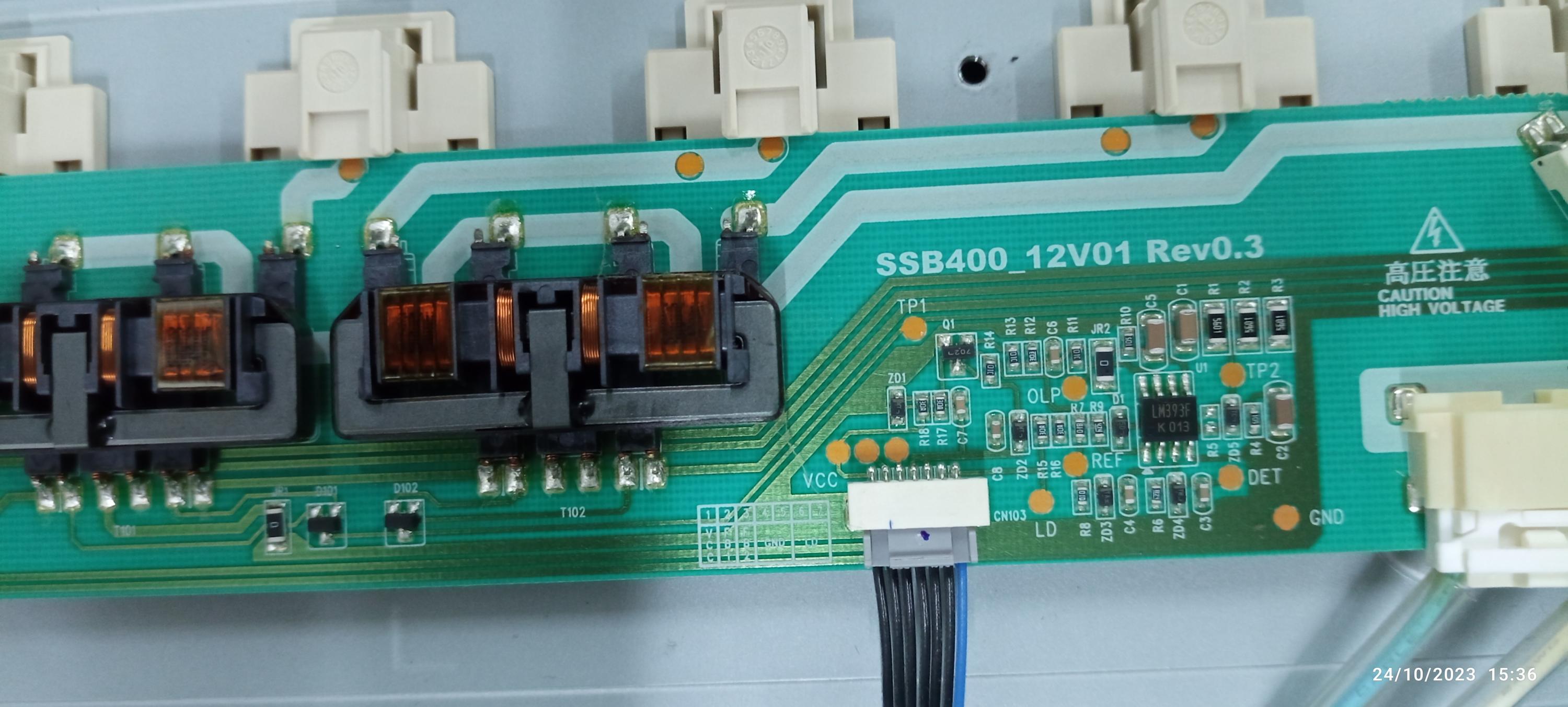

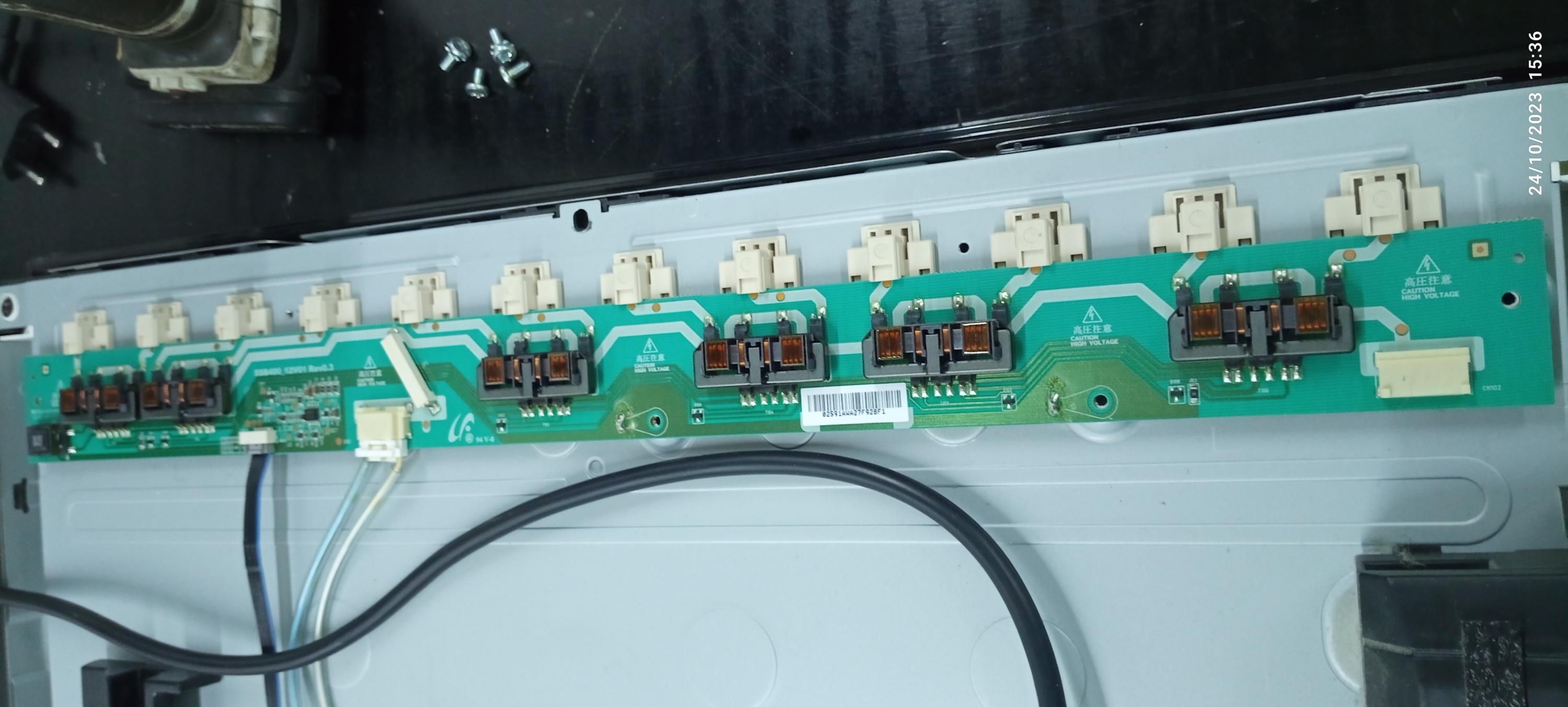

          No pictures, does this tv have separate inverter board/s or no?
          • nezocas
            • Oct 2015
            • 27
            • Alcanena
            Yes it does

              Not sure if this would be of any help, but the same PSU board appears to be used in Samsung LN40c630 sets (at least the one I have does.) That means the inverter board should be similar and/or compatible from those models too, I imagine.
              BTW, when you try the TV in a very dark room, does the backlight flash even for a split second when powering on the set. Try it a few times and look carefully.
              If I remember correctly, the HV inverter section on the BN44-00340B PSU board has a separate fuse for itself - the one on the right to the big yellow 450V caps. See if that's still OK... but first make sure the TV is unplugged and 450V caps discharged. Otherwise you may damage your meter. If blown, check the two MOSFETs and protection diodes in front of them that drive the inverter transformer. If all of these are OK, the issue might be on the inverter board or with one of the CCFLs.

                My memory is gone but there's a way to ohm out those transformers on the inverter board, they need to be pretty close compared to the others if you find a difference among them, it may be bad ccfl or transformer, there's some good videos on you tube, might be hard to find this exact model. Can also check the diodes capacitors and resistors on that board, might get lucky and find one bad.

                      This may be close for the transformer testing: https://www.youtube.com/watch?v=b36w2GNrH6Y

                        Just received another Samsung but with same power supply.
                        Changed it and problem is on the power supply.
                        I have allready changed from one board to the other ICP801 / UI801 / UI805 and problem still presists in the defective board.
                        I will change the 2 big inverter transformers.... lets see if it works

                          No joy with the transformers.
                          Checked and compared the voltages of both boards and all are the same, even the 380v boost on the caps.
                          The only diference is the 5v detect that is at 0v at pin2 of the CN802 connector.
                          On the good board the 5v are present

                            Re: Samsung Le40C550J1WXXC Backlight
                            That could well be the issue.
                            Good to hear you now have two boards to compare results with.
                            I'd say follow that 5V Detect line and see what generates it. If it's some IC or complex circuit, I wonder if it can be disconnected and pulled up to 5V from the standby supply via a 100-1000 Ohm resistor and if that would get the inverter running again.
