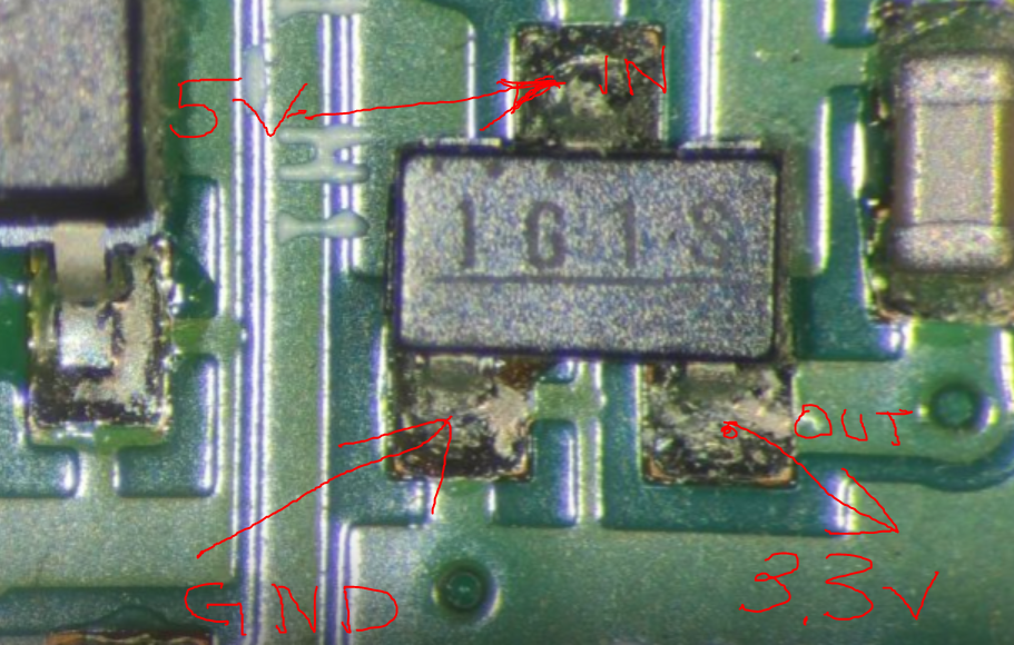

      Re: Samsung SyncMaster T24B350
      Originally posted by jason123
      Thanks.. I can't understand Hindi, but I think my board checks out except for the Memory Chips VCC.
      I found this video of a board with very similar problem to mine. But I'm not sure how he fixed it.
      https://www.youtube.com/watch?v=iJQIbeiXhsg
      My transistor (NPN I believe is getting 0.39 V on top pin, then 0.823 V (same as VCC on memory) on bottom right, and about 0 V on bottom left. I don't know why it's not getting 5 V on top pin??
      This is not a transistor, it's an LDO at 3.3v.
        Ok.. Quick Update. All videos, though not in english, implied the little transistor gets +5.2 V from the board and generates the Mem_VCC. However, upon running continuity check the MEM_VCC comes from Standby Voltage from the PS board!!!! I was not providing that, I was simply providing +5V, +11.9V, and GND.
        Now with +5, STB(+5) and 11.9V with GND, the little transistor is getting 5V, but still the bottom right (Mem_VCC) is only coming to +.9 V. I don't know how that 3.3 is supposed to be generated. Looks like one trace goes to CPU, and others go to resistors (voltage dividers? - 22k and 10k = ~3.4 V Checks out)
            Thanks I searched for that marking and came up with NPN.
            Any idea what part number that is? it does seem that the regulator is bad, correct?

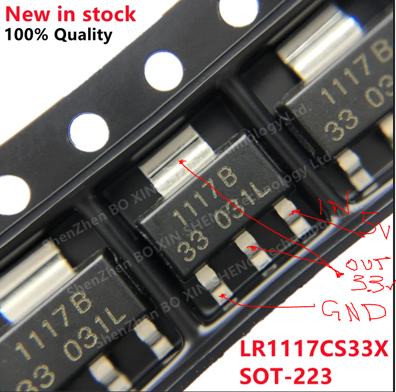

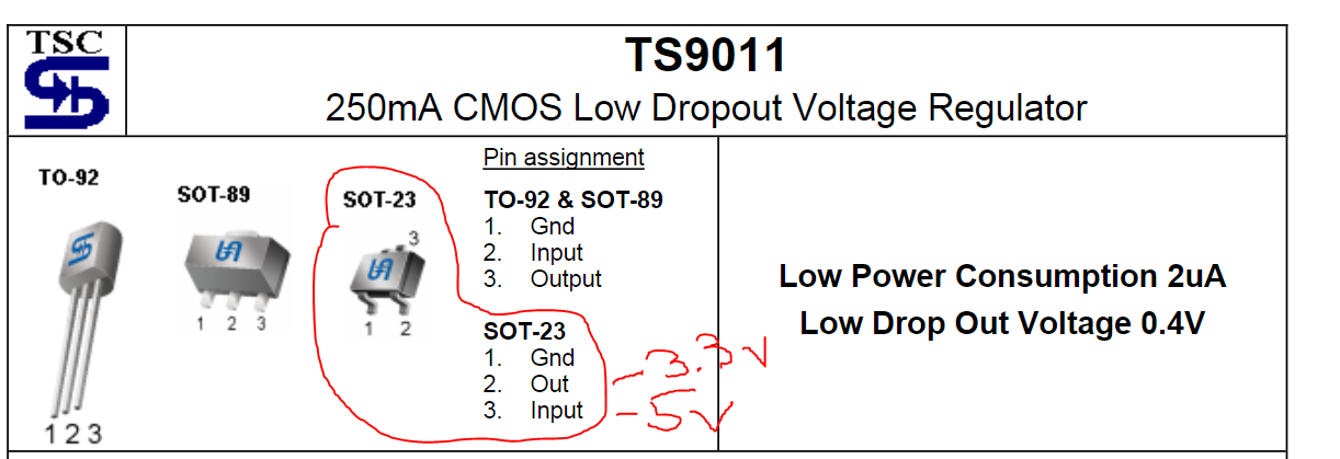

              You can use:
              S-1206B33-MT1G,
              TS9011SCX,
              MCP1700T3302E...
              Yes, and you can solder some kind of 1117 33 to check on short wires.
                Thank you.. On order

                    #29
                    Do you mean I use high output current device to test and see how much the 3.3 V node is drawing??
                    I meant to find the most popular regulator (1117 33), it also has a fixed voltage of 3.3v, solder three wires to the legs and solder the other ends to the board, instead of the original one.
