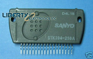

                          I'd return the wrong parts and get the correct ones. Call the supplier (you never said who) now and tell them the error. A lot of those policies are to scare folks off. Few people ever get hit with a restock fee when they are swapping a wrong number for a correct one. Mistakes happen and they (supplier) know it. They'd have a bad rep if they whacked everyone a restock fee.
                          Google STK394-250. There are a bunch of better prices. MCM, bdent (B&D), Liberty.
                          LOOK at the casing in those pictures. Knockoffs will not look like those.
                          Get the Sanyo's

                            Quasar, the vendor is Tritronix/Encompass, which someone on this board highly recommended. I called them before I sent the last post, trying to cancel the order. The parts had shipped, and my account has been charged. The parts are mine, now.
                            Tritronix does not have Sanyo in this part. They have Toshiba, Hitachi, Mitsubishi, Japanese Semi, and others, but no Sanyo. Could the Toshiba, Hitachi and Mitsubishi parts be made by Sanyo? ($35, $32 and $80 respectively)
                            The Toshiba 23135040 crosses to the STK394-250, but is obsolete.
                            The Toshiba 23135040X also crosses to the STK394-250, and is available.
                            If the 23135040 and 23135040X are not the same part, how can they both cross to the STK394-250? What is in the Toshiba part that is not in the generic -250?
                            I'll search Google, but all the above came out of a Yahoo search.

                              Then I'll be sure to challenge any recommendations to use them for parts. Actually, I'd refuse the package and call my credit card company and initiate a chargeback. "Yes, I'm willing to pay the shipping, but to return an unopened package I should be entitled to a FULL refund." Understand that a chargeback will -COST- them $25-35 whether they are right or wrong. I'm not nice to companies who try to stick it up my ***.
                              I gave you 3 names of sites with cheaper and absolutely real Sanyo chips. No faker is going to the trouble of making -that- molded case.
