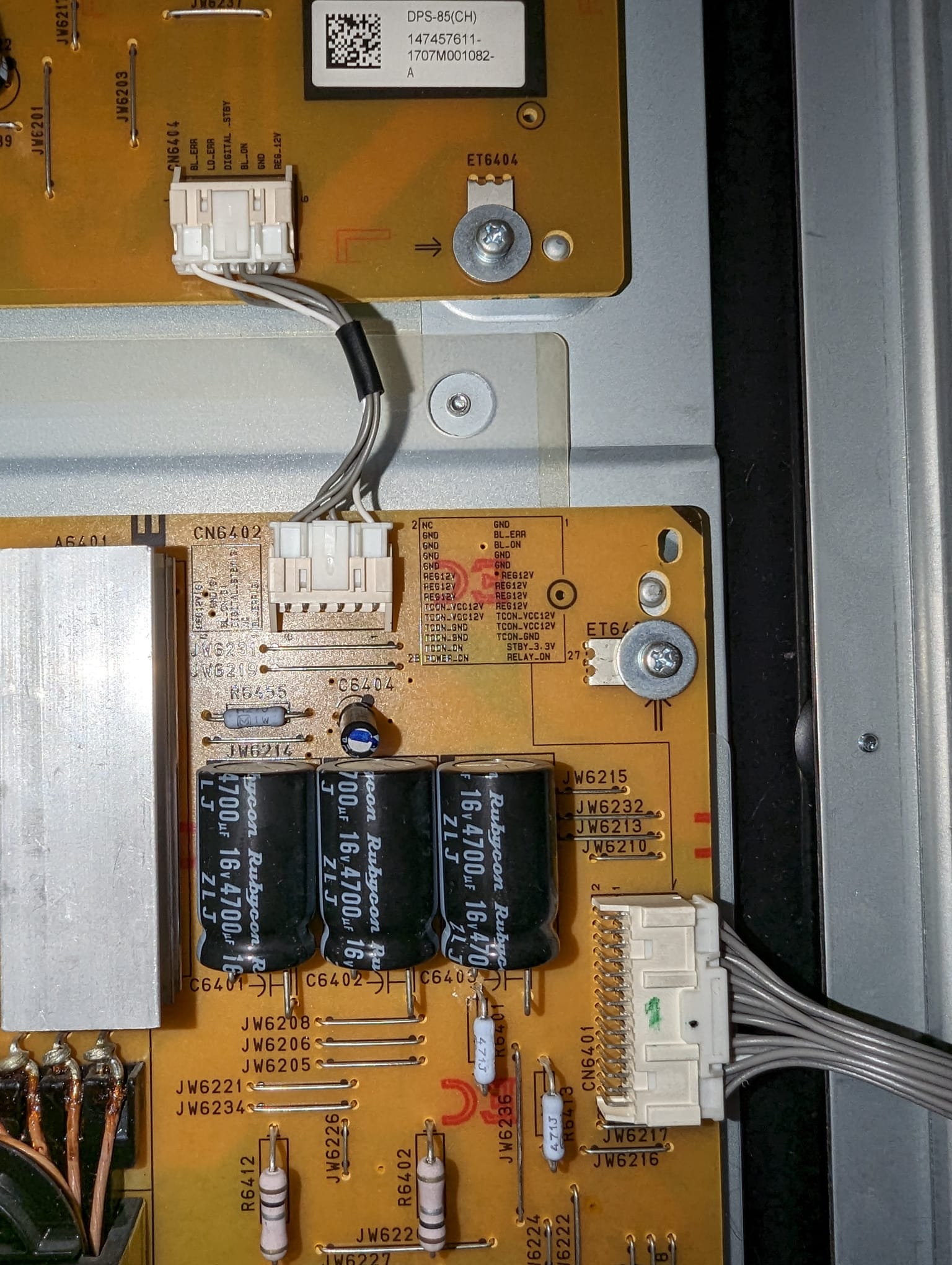

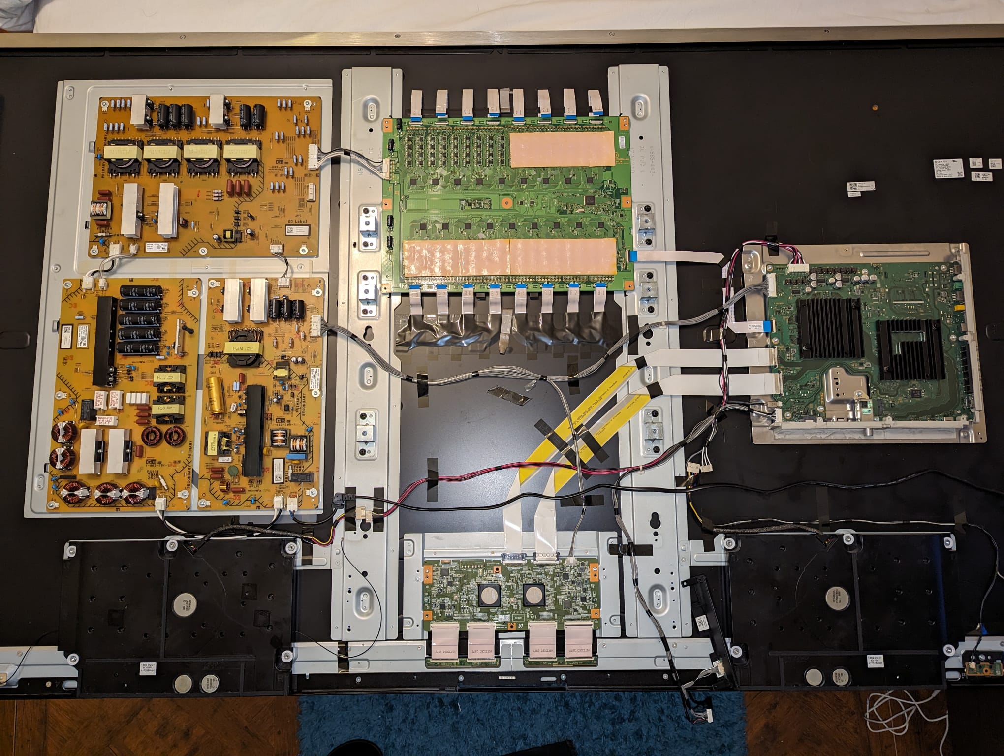

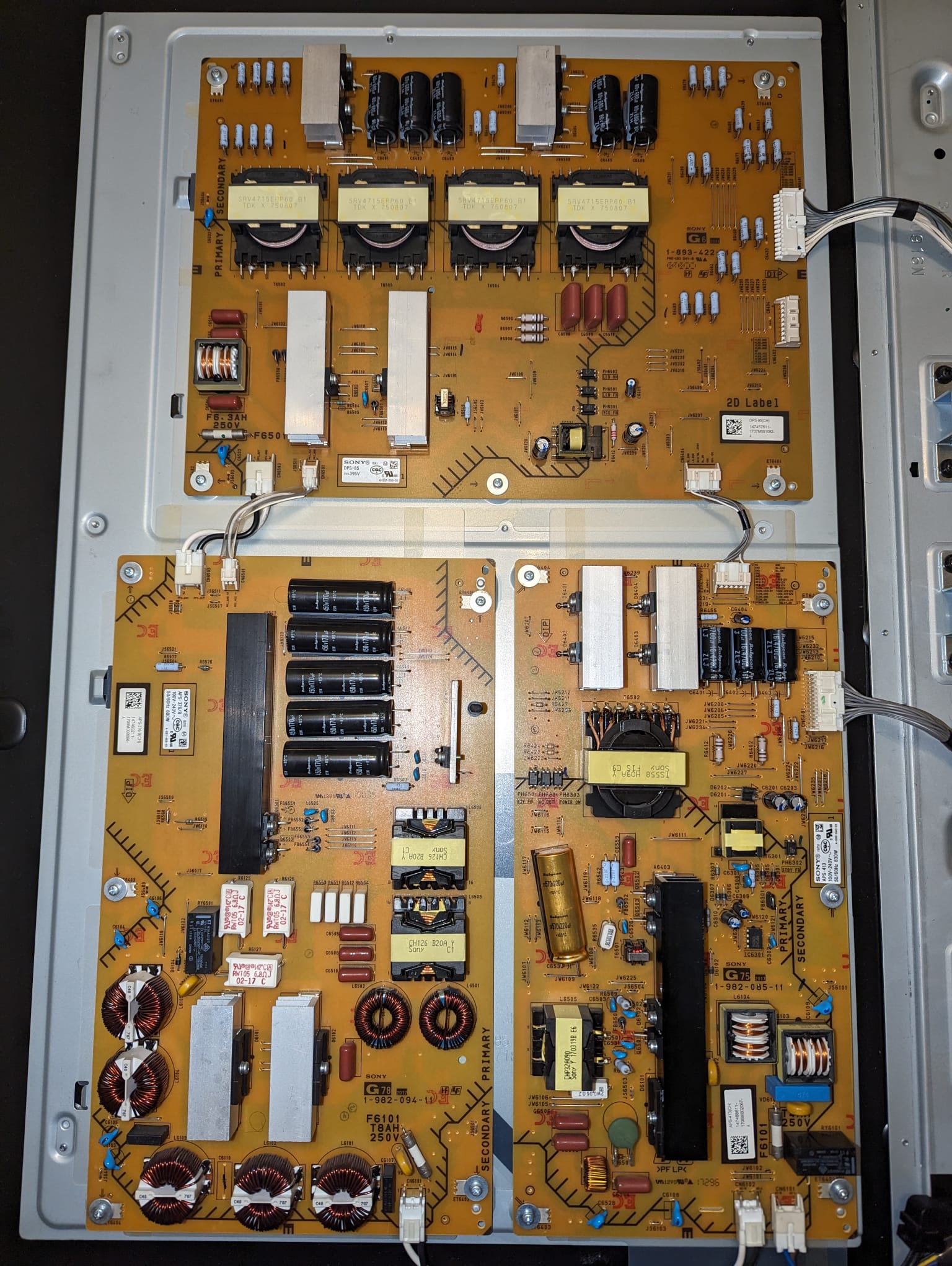

    I was using this TV for 5 years before it stopped working. I like this TV and would love to fix it myself.*
    When I press the power button, the white led comes on (sony calls the module smart core) and then it switches over to 5 red blinks. No screen, no backlight, no relay click, nothing. I have disassembled the tv and found the service manual for 75x940e online. The manual suggests a faulty power board, TCON or the panel.**

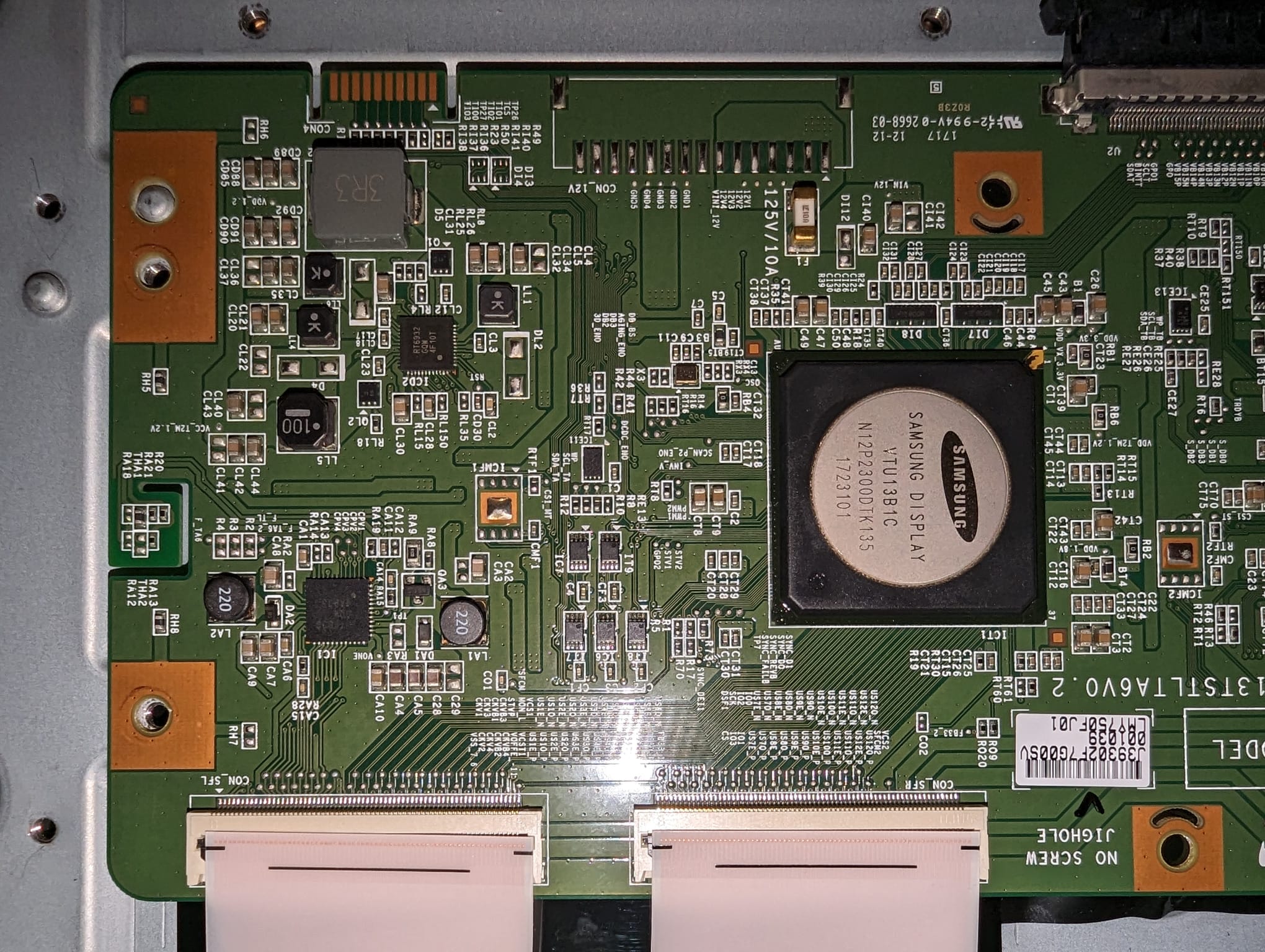

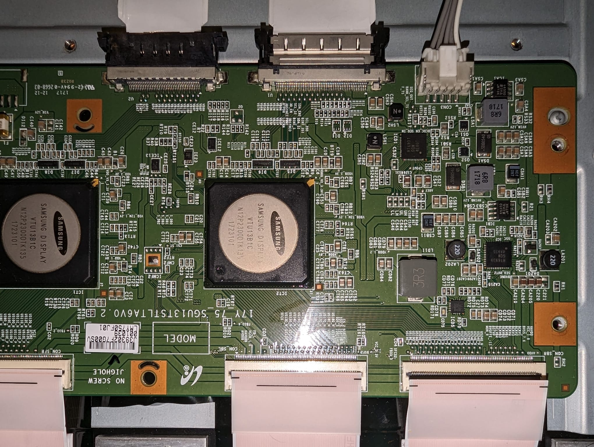

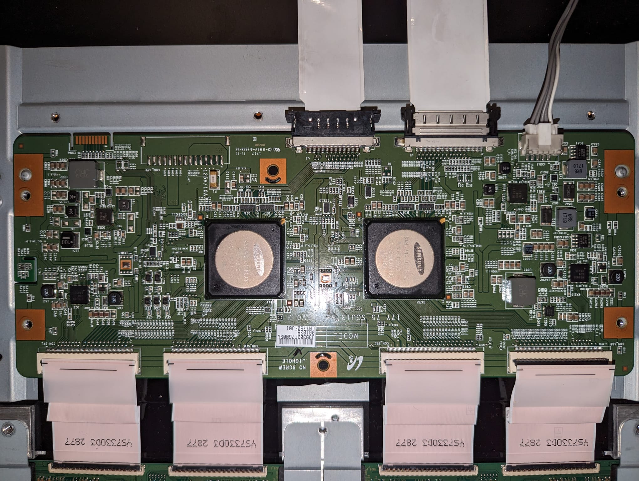

    The standby pin is at 3.3V. Fuses on the mainboard and TCON are fine. Caps on TCON also seem to be fine. When I turn on the tv the white led comes on and REG_12V pin on power board measures 12.8V, VDDB_3.3V pad on TCON measures 0.577V. When it switches over to 5 blinking reds, the voltage on REG_12V and VDDB drops to 0.**
    I also disconnected the power board and shorted standby pin to POWER_ON and TCON_ON. Both measure 12.8V. Power board seems to be fine.
    I disconnected the ribbons going out of TCON to the buffers and then turned on the tv. I still get 5 blinks.
    What should I do next to narrow down the problem, any advice is welcome. Thanks!

    Some updates, tcon is supposed to get it's power directly from the power board through a dedicated connector (obvious in the pics) . TCON_ON is not being shorted to STBY_3.3V by the main board during boot up. I disconnected the power cable to the main board and jumpered STBY_3.3V to TCON_ON. TCON started getting 12.8V and VDD_3.3V on the tcon was stable at 3.3V. Leads me to believe that the problem might be with the mainboard.
    I'm at a complete loss here guys, what should I do next?

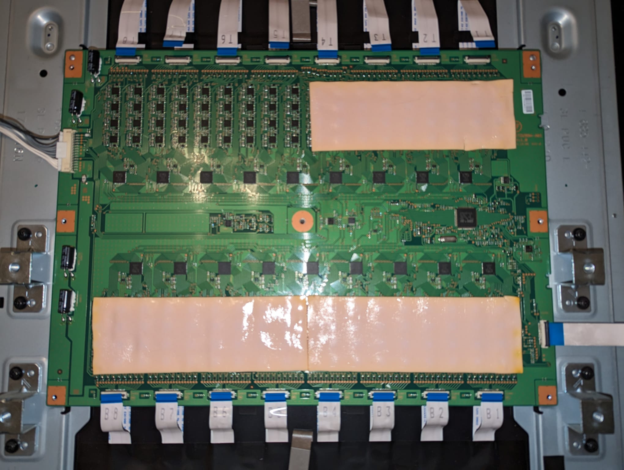

          Hey. Replaced the T-con, didn't make any difference.. Still getting 5 blinks just like you. In my case the soc and upscaler are on the same board (BMKP). I have pretty much arrived at the your conclusion, the bmkp is not turning on the power to the T-con.

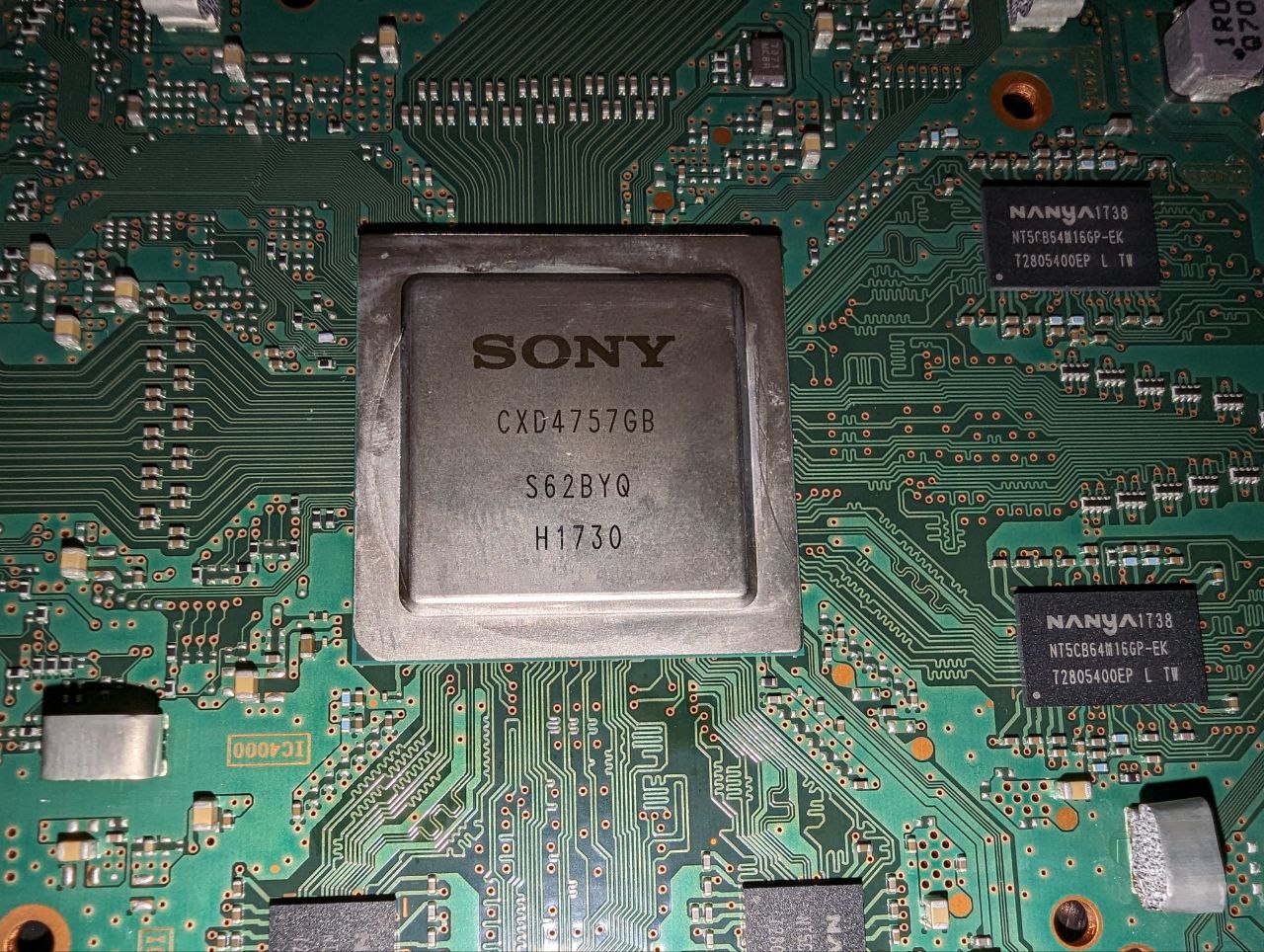

            Yes on my TV the DKA assets the TCON_ON pin into the PSU.
            But I’ve already replaced the DKA, so I’m now suspecting the main board (DKA) isn’t giving the right commands to the DKA. But that’s pure speculation.

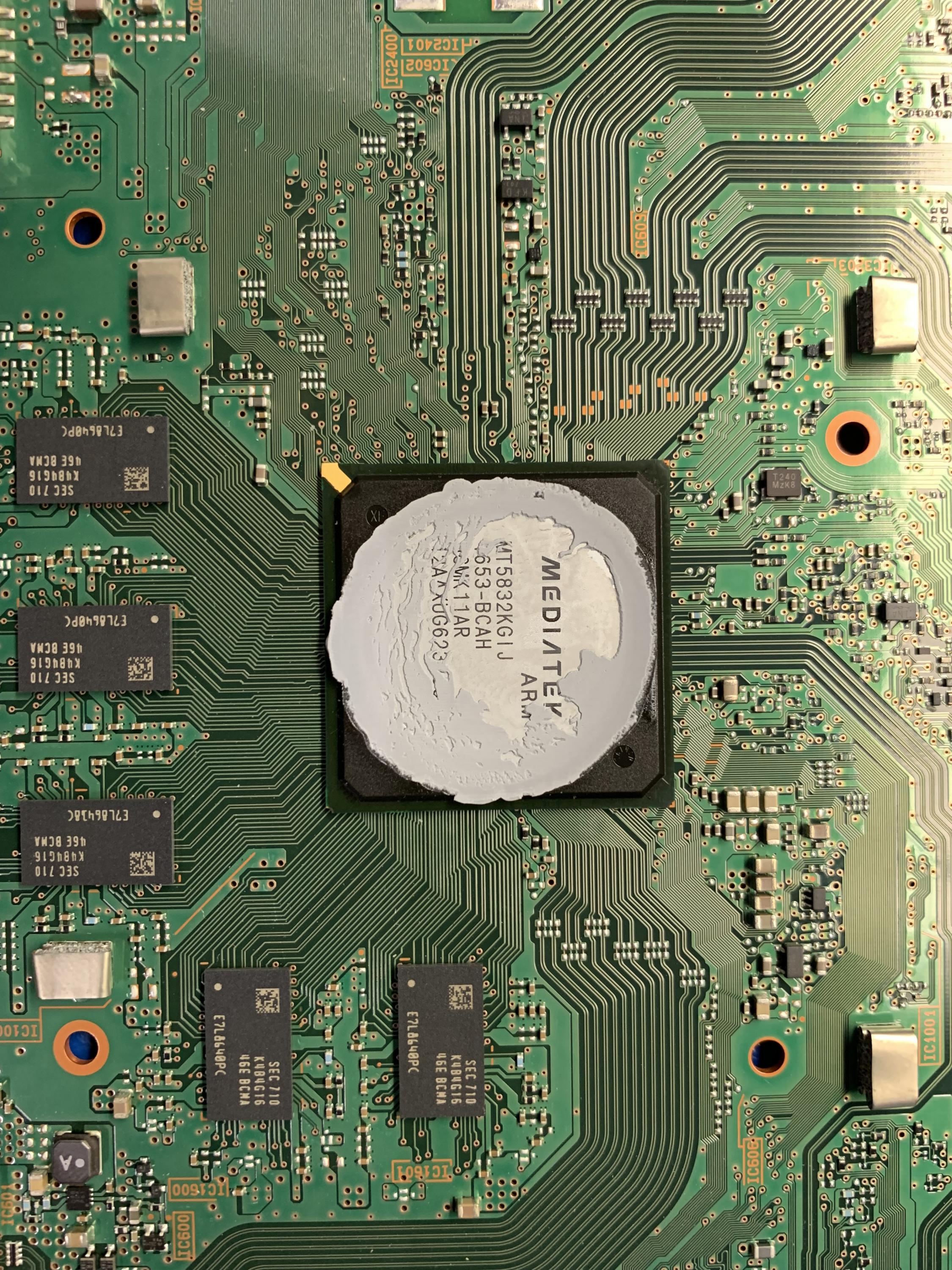

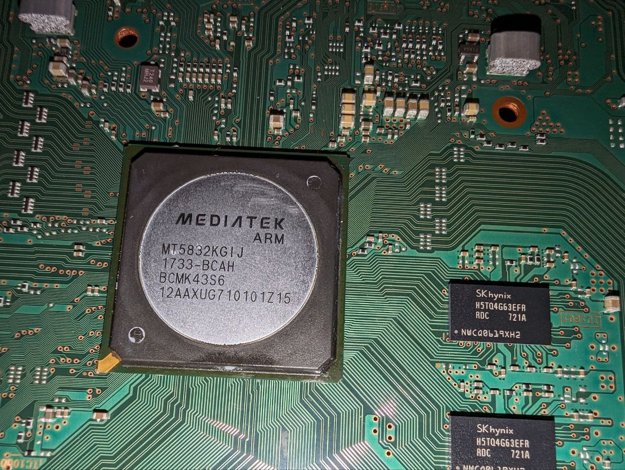

              Do you have any photos of the mediatek processor and the upscaler without the heatsinks? If the processors are similar in both the tvs, I wanted to check the resistance on a couple of caps around these processors.

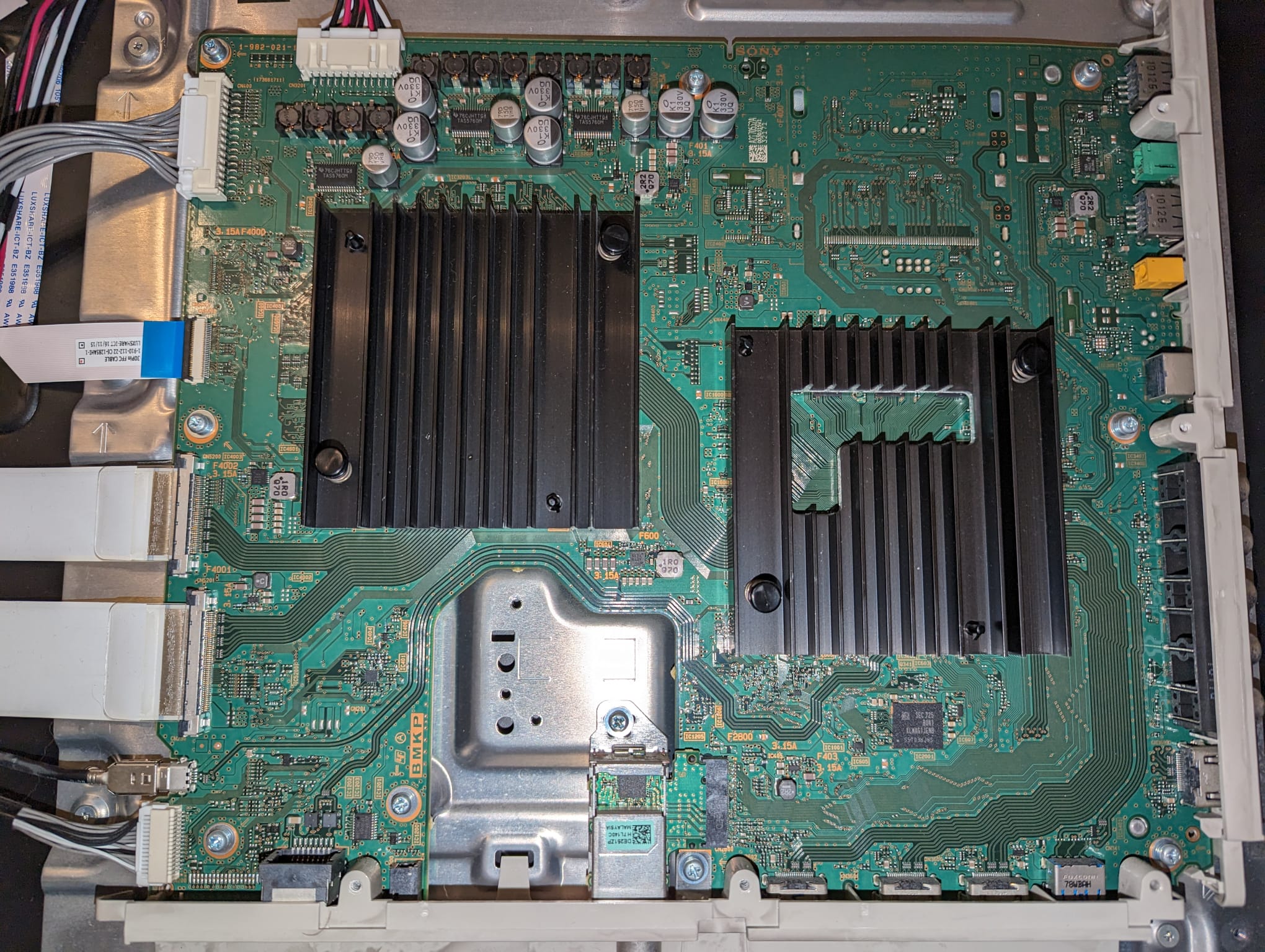

                Here's a picture of my Mainboard (BKA).
                It's maybe not surprising that our boards look pretty similar.
                Let me know which resistances you want measured.
                I went through quickly making sure no caps was shorted and that all the power supplies were the voltages called out in the service manual.

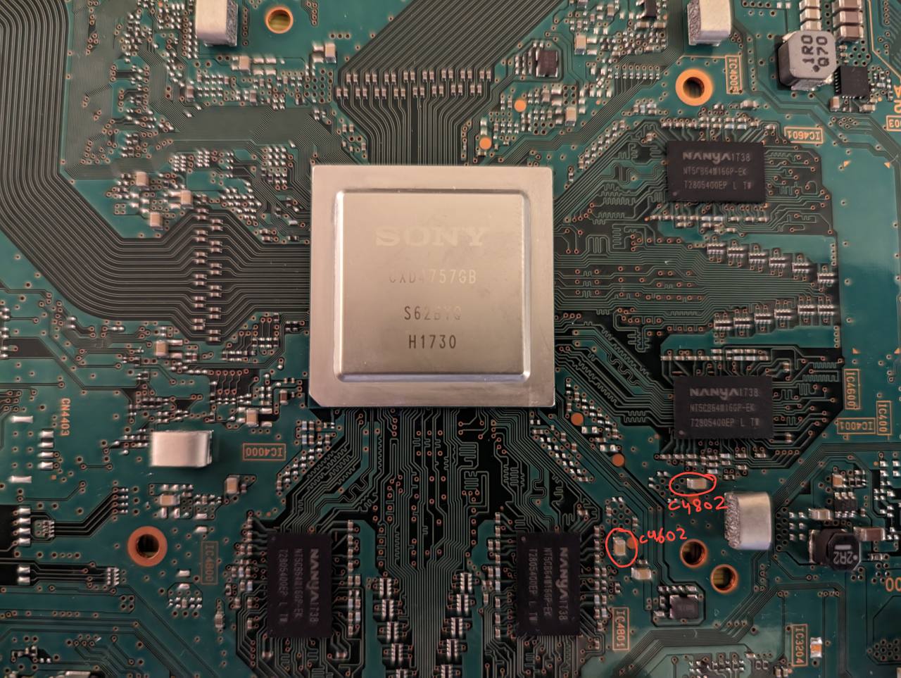

                  I think I might have found the issue in my case. C4602 and C4802 caps are giving me 5 ohm resistance. Probably means the upscaler chip is dead? Can you please check these cap resistances for me, I went through your board schematics and our boards are pretty much the same, even down to cap labels.

                    I have two upscaler boards (DKA).
                    The first DKA came out of my TV and draws a lot of current somewhere downstream of the 3.3V supply.
                    I bought a replacement DKA that came out of a TV w/ a cracked display.
                    On this replacement DKA board both the caps you highlighted measure 4.5 ohms to ground.

                      I think 4.5-5 ohms is a bit too low on those pins but then we both got the same value so I don't know. Not much we can do here until my replacement board gets here I guess.
