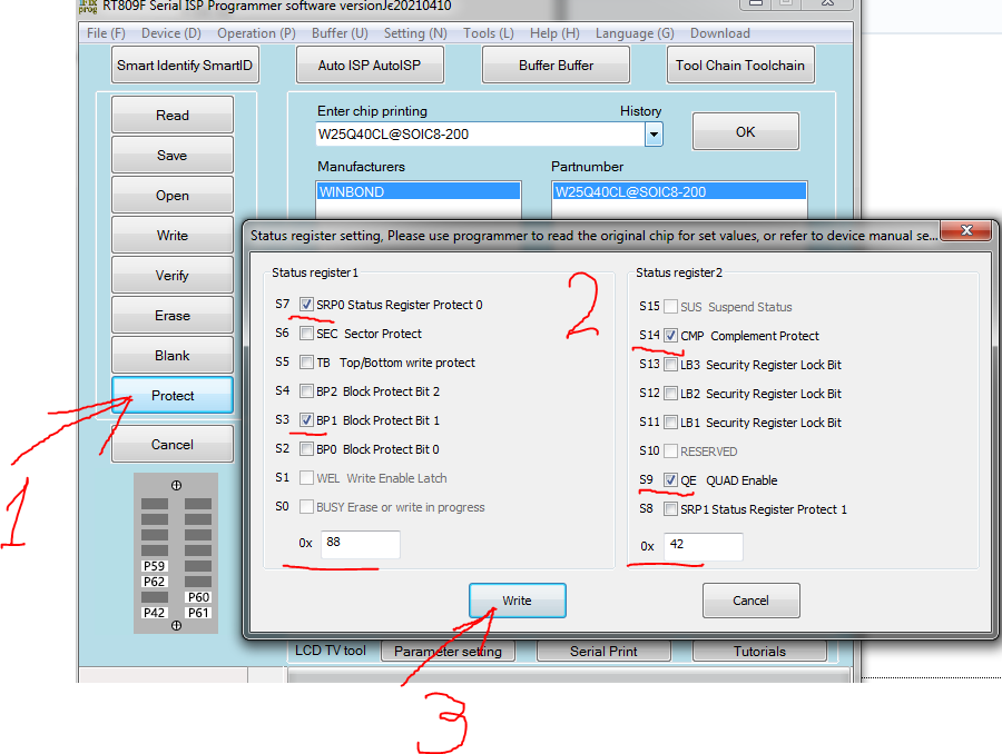

    This was a native dump, if it is a native one, then everything should work, after writing my corrected dump, you set and wrote status register 0x88, 0x42, without writing them, will the firmware be damaged again.

            im using RT809F to write the dump,
            i dont know what this mean: status register 0x88, 0x42
            can you explain this, thanks

              After write dump do this.
              And also, is the dump you posted his native one or did you already write something on it (different dumps) without saving his native one?​

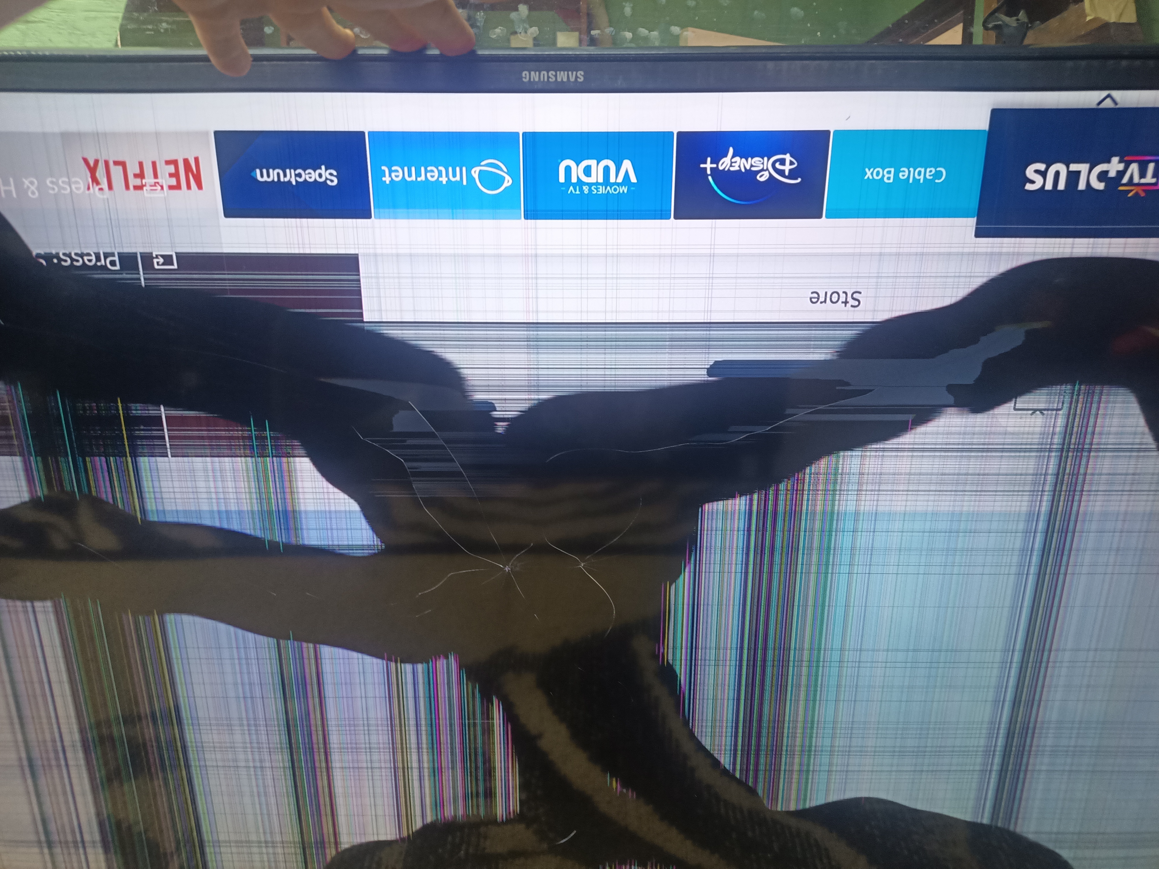

                Great, works, but I realize that the LCD is cracked, 😭.
                I have a question​: this dump its for any samsung board? or its a specified for this model, size,board shape,year,version?
                Thanks for all help.
