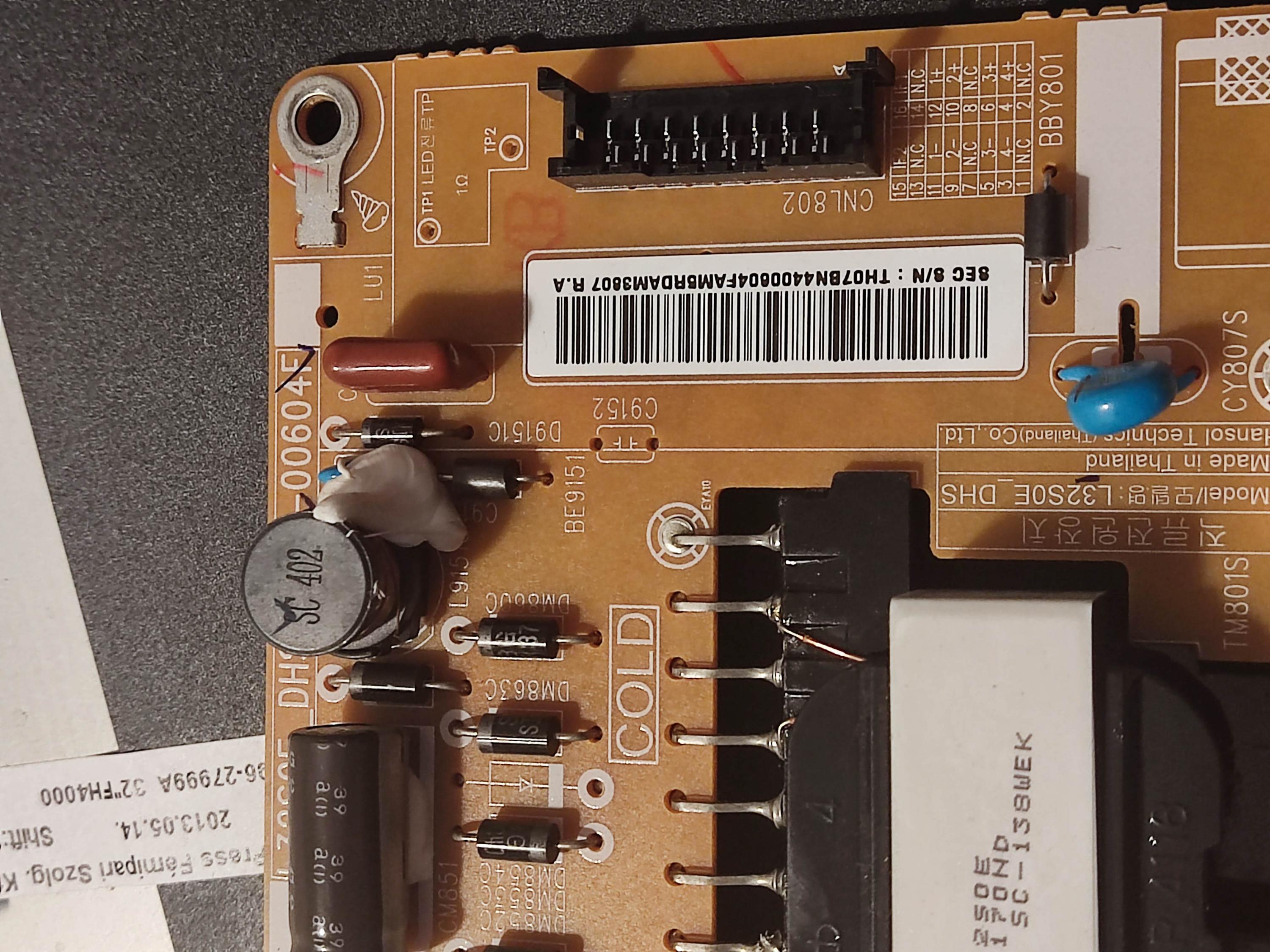

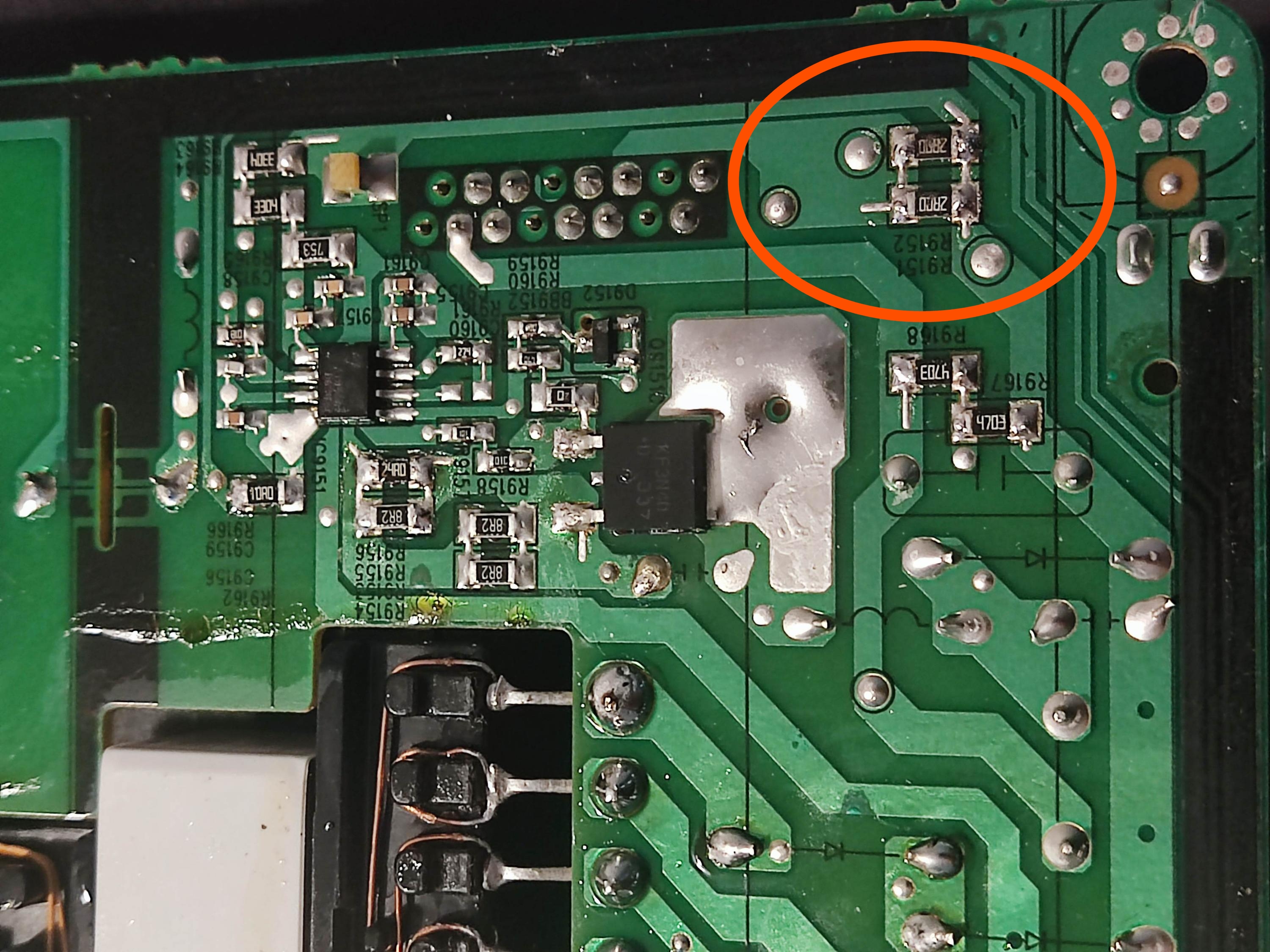

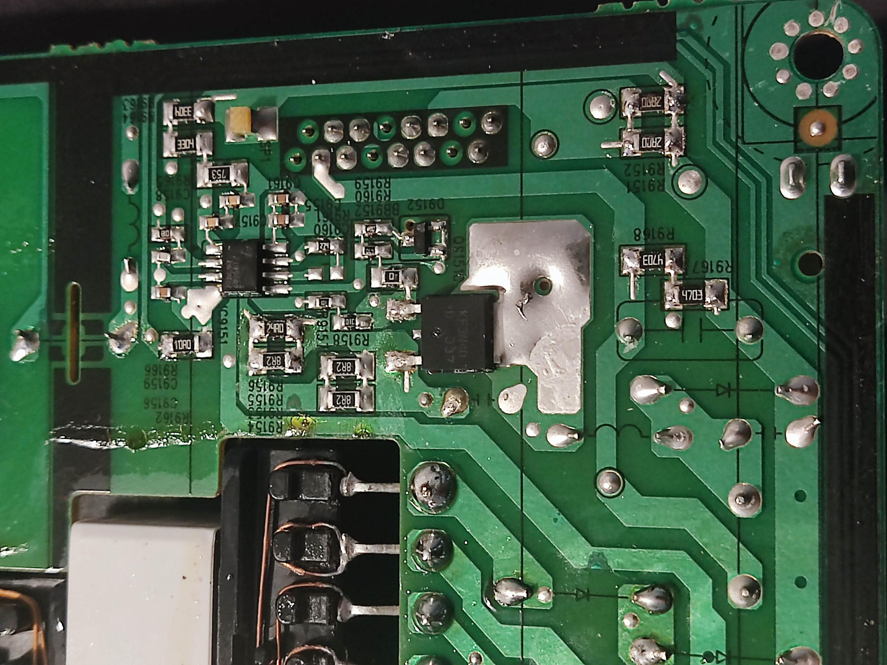

                      Ok, update on this.
                      No luck. I installed the new led strips. Same thing. I guess I failed at correctly testing the old led strips....
                      They still flicker extremely dim. I get 228V at the LED BL capacitor so it looks like it biulds up voltage but it doesn't fully get to the led strips
                      The TV somehow notices this as the stby led keeps flashing.
                      What to try next??
                      Thanks!
                      PD: Im attaching a close view of the BL section of this PS (both sides)

                        OK resistors R9151 & R9152 appear to be open on my multimeter, they show 2R?0 probable 2Ohm resistor in parallel so 1Ohm total. Does this make sense with my issue?
                        These resistors seem to feed the high voltage from the BL capacitor to the led strips

                          it's a 2 ohm isn't it, if so reading should be 1 ohm.

                            Is there a problem with that board? it looks like the solder melted and ran all over, strange.
                            • edugimeno
                              • May 2017
                              • 581
                              • Spain
                              #34
                              Re: Samsung has 5v_STBY but no B13
                              In what part do you mean? There was a shortcut that blew something, hopefully only these 2 R

                                #35
                                In that area you have highlighted it looks like the solder melted and ran over to the other components, can't recall seeing a powerboard that looks like that.
                                    The resistors are open, that is why the backlight voltage is high should be around 146v not 228v

                                        #39
                                        Ok I went to the shop today and bought a regular size 1R0 5% resistor. I guess a normal 1/4W resistor stands several times the power a small SMD resistor can handle
                                        Also I guess I should have got a more accurate precission one, more than 5%, as this resistor is probably used to measure the current flowing thru the LED strips but 5% is all they had....
                                        Will try it tomorrow
