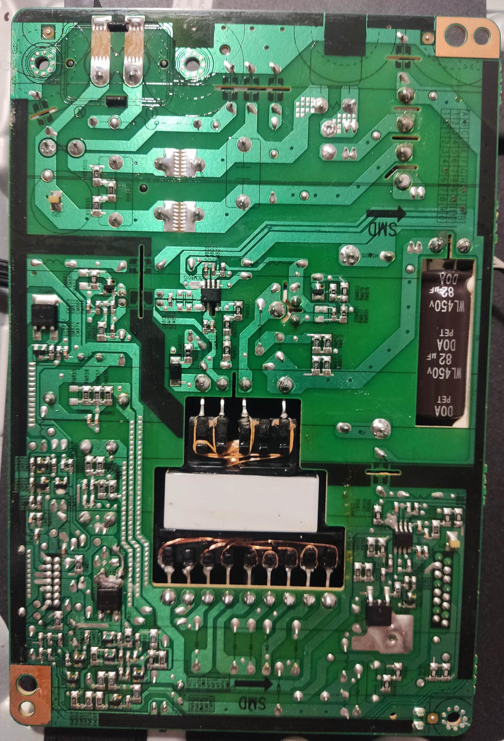

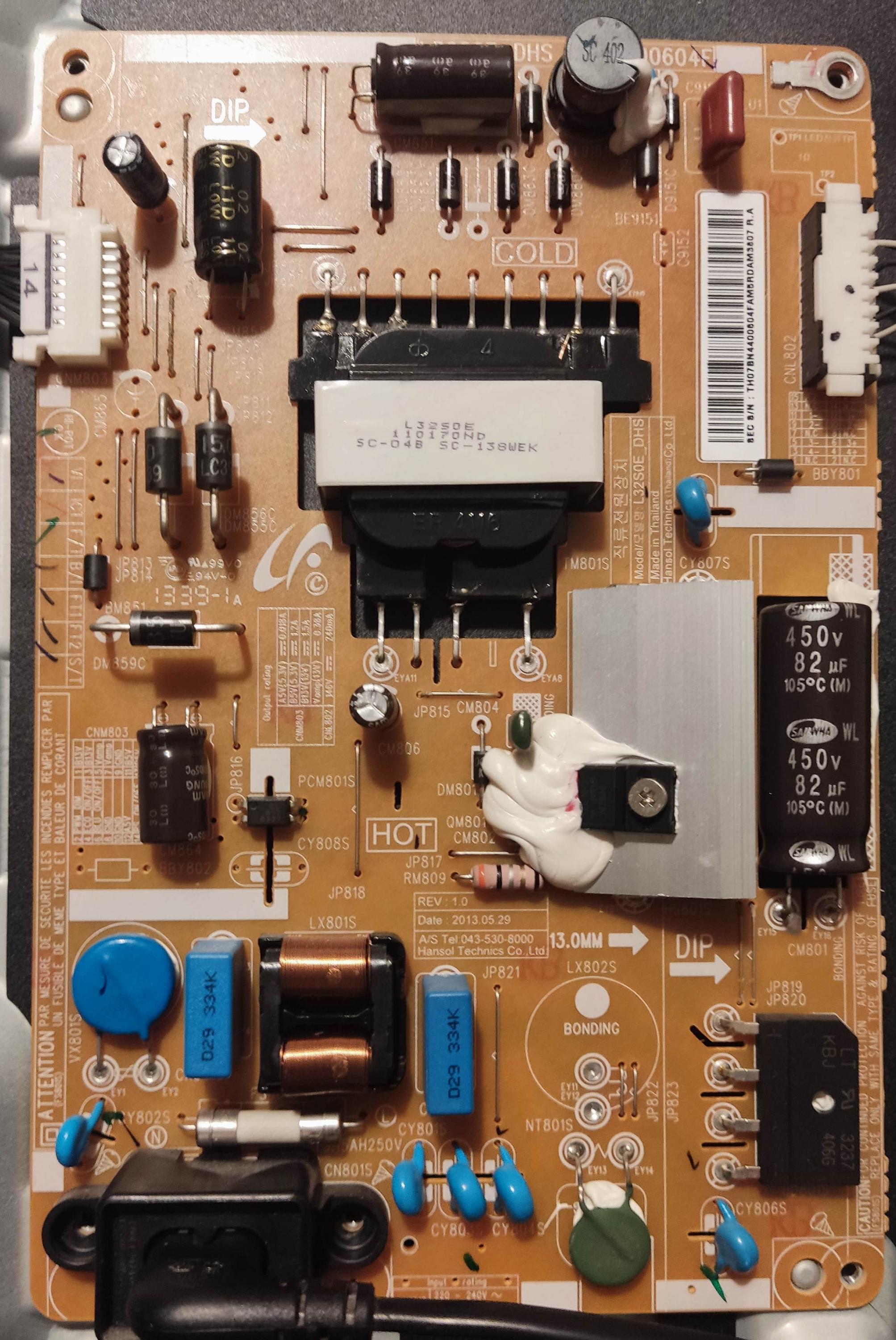

    Hi there!
    I have a Samsung UE32F4000 with a power supply model bn44-604F (L32SoE_DHS) and according to the owner, it gradually took longer and longer to turn on, until now that it won't turn on at all.
    Behaviour: Plug it in mains, led turns on. Push power button either on remote or physical pushbutton, led blinks once like trying to turn on, but after 2 seconds turns steady on again.
    Inside: I measured PS voltages. A5V measures 5.1v (expectable as I get LED on and remote signals have an effect) and when I try to turn on, I get B5V at 5.2v but B13V goes directly to 9v, quickly to 8v and then drops to 0 in under 1second
    I can't find the proper schematic for this PS but I tried swapping caps CM861 and CM855 (2 on top left corner in front side picture) and on first attempt I got BL to turn on for under 1 second but that was it, same behaviour again.
    I tried resoldering all the secondary leads of main transformer too.
    Any hint on to try next?

        Also, while I manage to get a proper schematic, I see only 4 capacitors nera the secondary side of the tansformer and close to the outputs socket. They give out these voltages:
        1.- 142v. This has to be for led strips
        2.-5.2v This has to be A5v
        3.-14V this has to be A13v
        4.- 8.8V this has to be B13V
        What happens if I jumper 14V to 8.8V and see if it turs on?
        Does this make sense?

                                  Re: Samsung has 5v_STBY but no B13
                                  Ok I checked something else.
                                  There is a mosfet that drives the 13V from the rectifier after the transformer to the B13V pin when there's a high signal in PS_ON. This all makes sense.
                                  I measured voltages at this mosfet: Source: 14V (close to expected), Gate 12V (meaning: "GO") and drain has 9V, when It should have 13V.
                                  I have checked other equivalent mosfets on this board that are in ON state and they drop close no 0V from Source to Drain, and this one drops 5V.
                                  I think either the mosfet is bad, or whatever is driven from it is in short
                                  Does this make sense? Anything to start with?
                                  • edugimeno
                                    • May 2017
                                    • 581
                                    • Spain
                                    Ups... I screwed up big time....
                                    The owner reminded me that I already fixed this TV for him some months ago and what I did was redoing some solder joints
                                    So leaving aside all my previous asumptions I redid a lot of solder points and VOILA! The TV turned on! I could see a "no signal" box floating around the screen, while I was holding the set upside down leaning it. At this time I forgot that the PSU board was not screwed yet to the chassis, so this board slipped off to one side and created a spark that turned everything off....
                                    Turned back on again and now I got the correct voltages B13v, etc (12.5v) but the backling it flickering at extremely dim, like 5% of its normal brightness. The BL voltage has increased 20 volts (From 165 to 185v).
                                    I removed the panel, and went ahead to all led strips checking them all individuallywith their test pads to realize ALL leds have blown out... Not one or two, ALL leds
                                    I need to buy new led strips now and see from thete what's missing...
