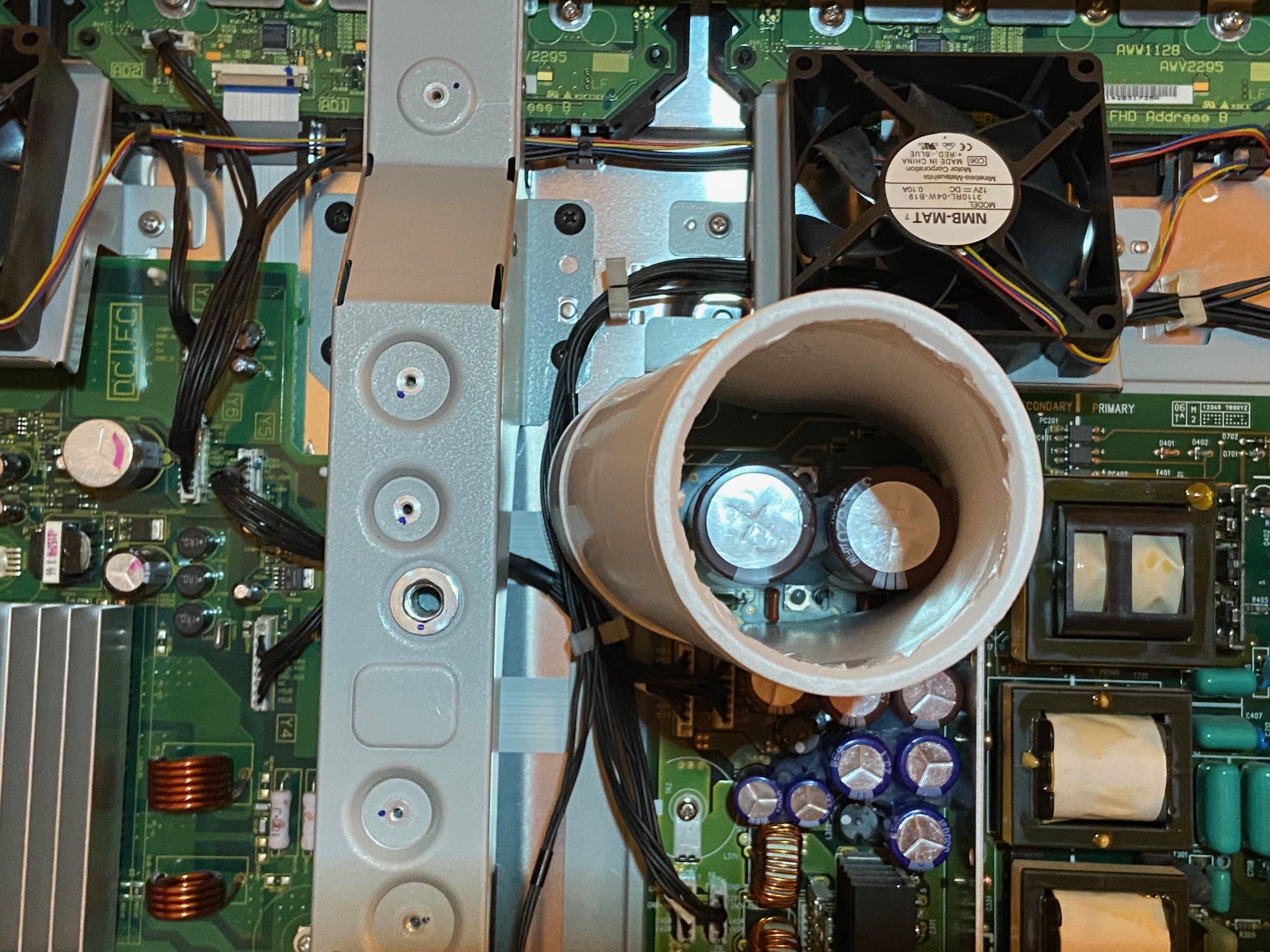

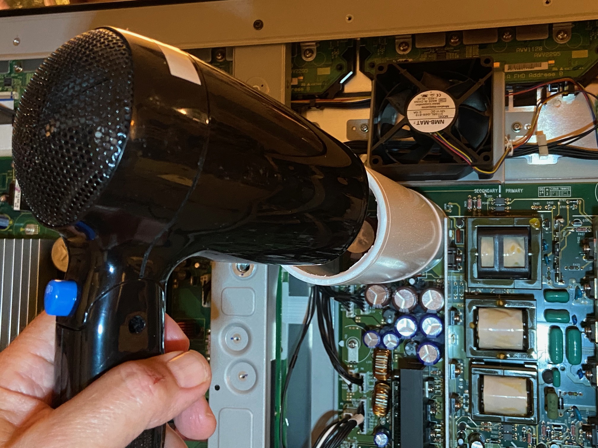

    I thought that I should try to isolate the heating of my power supply board with a styrofoam cup as a heat dam, rather than the cardboard that i had used before. The results were curious. The start-up success dropped to about two starts, then one failure.
    Previously, using cardboard to isolate heating, I was getting completely normal starting when I heated the upper left corner of the board. I'm now suspicious that the cardboard must have been leaking heat to a larger area than I had thought. Maybe the whole damned board is just heating up, as I try to isolate the hot air to one spot.
    I'm attaching phots of that very low tech method of isolating the heat to a limited area -- at least for a few minutes until the rest of the board warms up.
    I'm able to monitor the component temperatures accurately with a "K-Type" thermocouple and my multimeter.
    It seems that I'm back to heating a large are of this board, in order to get reliable starts. Gee I wish that I could find a Pioneer Plasma PRO-FHD1 service manual that could give me some pin voltages to check, or some other troubleshooting guidance...

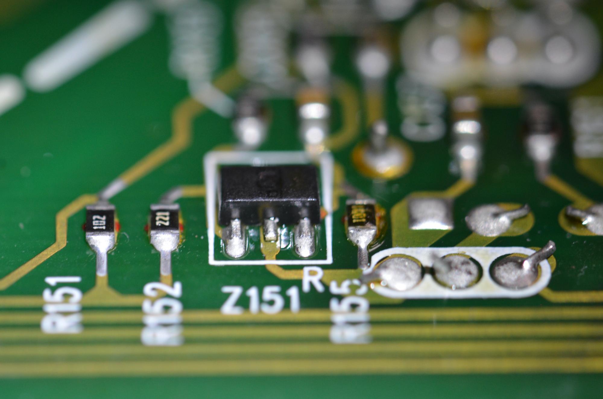

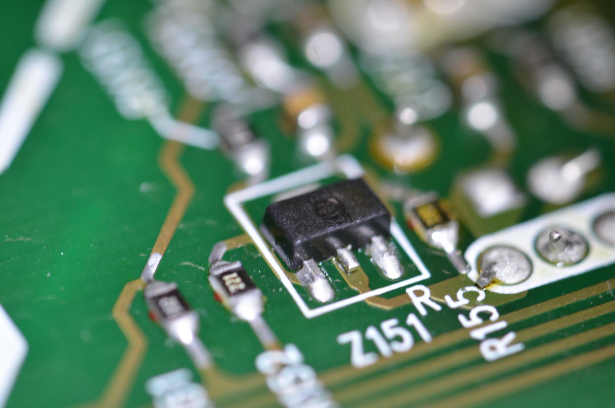

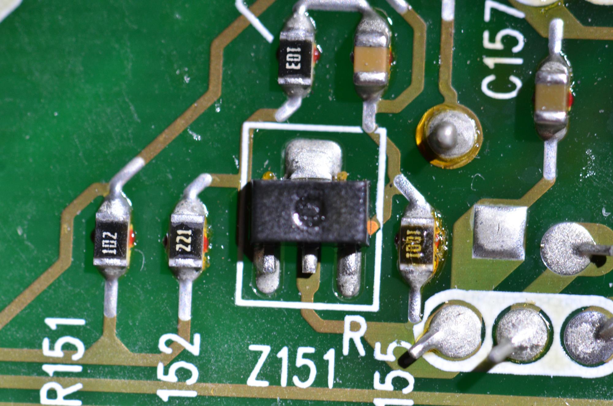

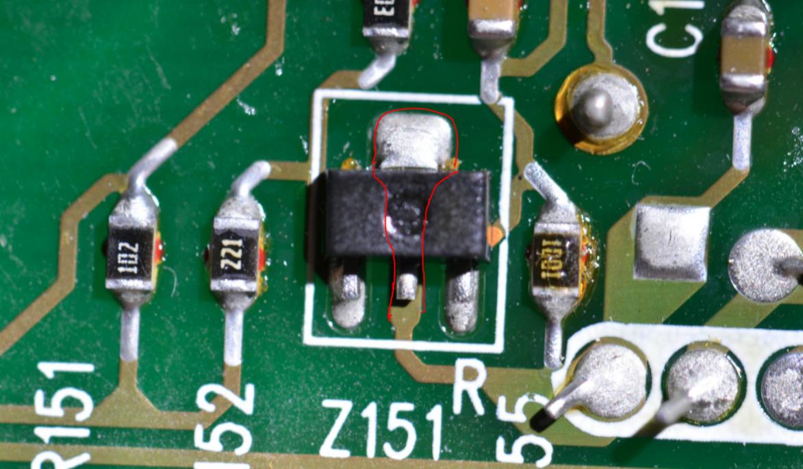

          Looking very closely at the soldering on this board reveals that most of the joints are not shiny, but rather buff, as cold solder joints look. The soldering that I've done so far looks brilliantly shiny compared to the factory work, and I'm no expert.
          I also found a small component, that I'm guessing is an SMD Zener Diode that looks as if one of the terminals is (intentionally?) not soldered. I've attached 3 images. It looks weird, and it seems to be the only component of its type on this board.
          I have no experience soldering SMD stuff, and could imagine messing this one up, if I tried to add solder to the center terminal. looking at it with the strongest magnifier that I've got, it seems that there may actually be a very tiny bit of solder under that central pin.
          What do you think?

            Re: Pioneer PRO-FHD1 Elite Plasma Monitor Start-Up Problem
            The upper part is soldered well, and it goes to the middle output.
              Thank you Iotas! That is a curious way to mount a component -- with a terminal just floating. Thanks for filling in a gap in my knowledge!
