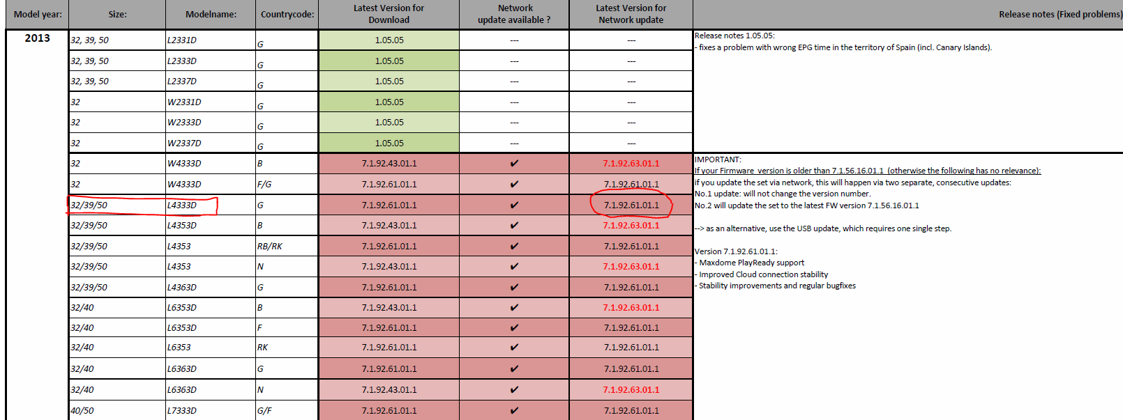

    Hi everyone,
    I'm trying to fix my sister's Toshiba 39L4333D TV with motherboard model number 32L4300 REV: 1.02.
    After a power outage the tv automatically turns on when plugged in and does not respond to any input (remote or direct buttons).
    It stays on the last viewed channel.
    Searching for other threads on this forum I've found another user that had a similar issue, but the url for the firmware is dead (toshiba link).
    I've tried to download a bin file I've found online to flash the firmware, but it seems incompatible, it still turns on by itself but this time it remains stuck at the logo splashscreen.
    Thanks in advance.
    EDIT:The model number is 39L4333D not 39L433D. I've missed another three.

      Re: Toshiba 39L433D need firmware
      You need firmware number "7.1.92.61.01.1".
      • lotas
        • Jan 2016
        • 4765
        • Russia
        Toshiba firmware 7.1.92.61.01.1
        https://drive.google.com/file/d/1llg...oece1Qs96/view
              There, you will probably need to change to your panel, that is, "39" and the letter at the end "X" - this is the manufacturer of the panel, as in the instructions.
