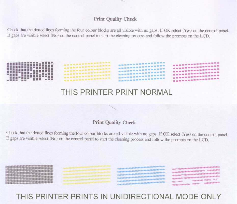

    My friend brought his MFC-5895 for repair. Same problem "No ink in the ink tubes". Quick FIX when you have 3D printed parts.
    But his printer has this problem of only printing in Unidirectional mode, else the text is blurry.
    All service manual adjustment done and make no difference.
    timing strip is OK
    See nozzle check is also out of alignment.​
