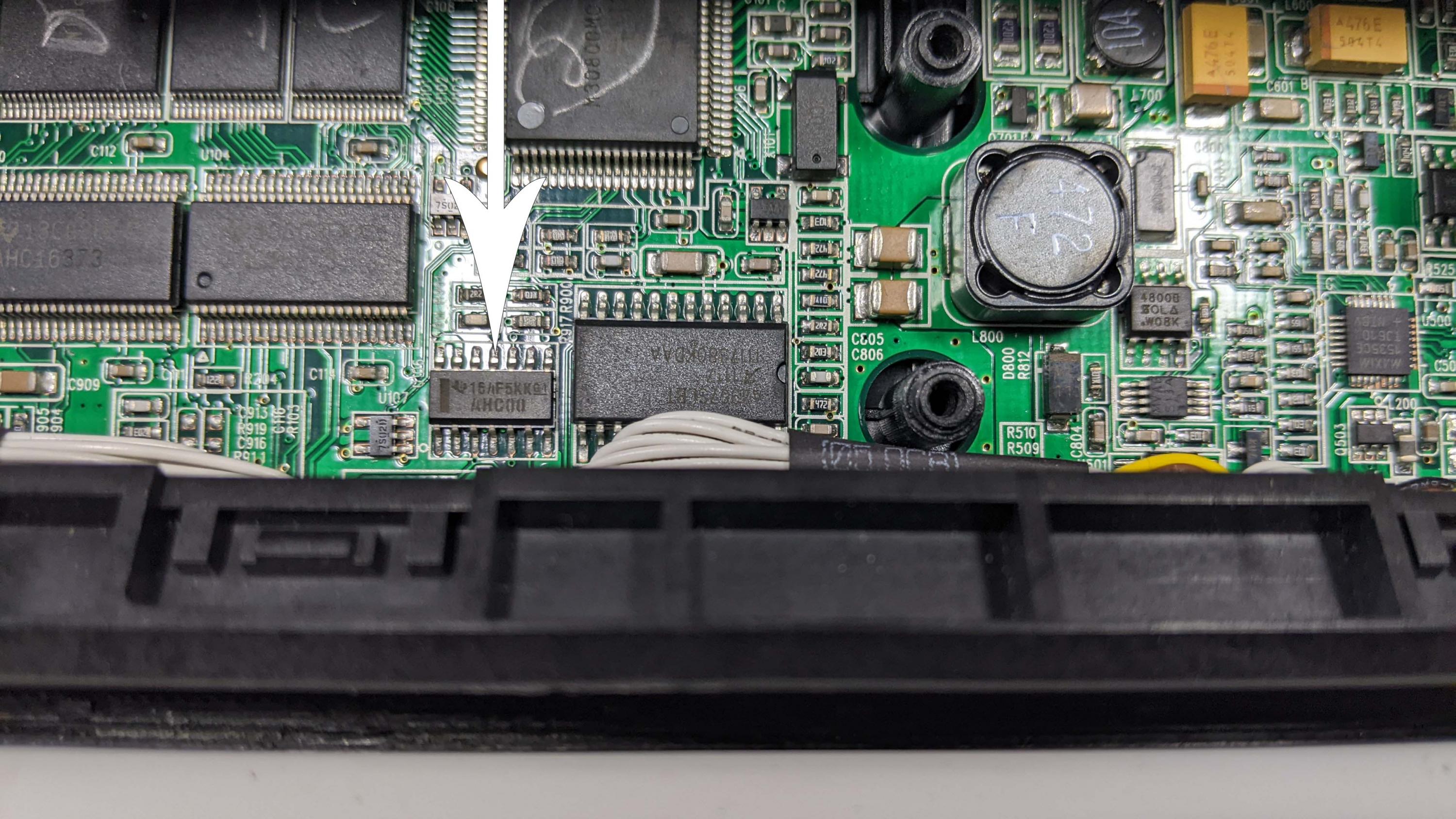

    I have found the data sheet for the chip on the right side which is upside down.
    It is an A3967
    I can't find datasheets for the other chips.
    The two large chips say :
    13CG3FK G4
    AHC16373
    And the smallest one can be made out easily in the attached image, I think it says :
    16AF5KK G1
    AHC00

      Re: Portable fax machine thermal printer printing blocks of black with no text visibl
      for AHC ad 74 at the begining.
      74AHC00 is a quad 2input gate
      the 74AHC16373 is probably a 16 element latch

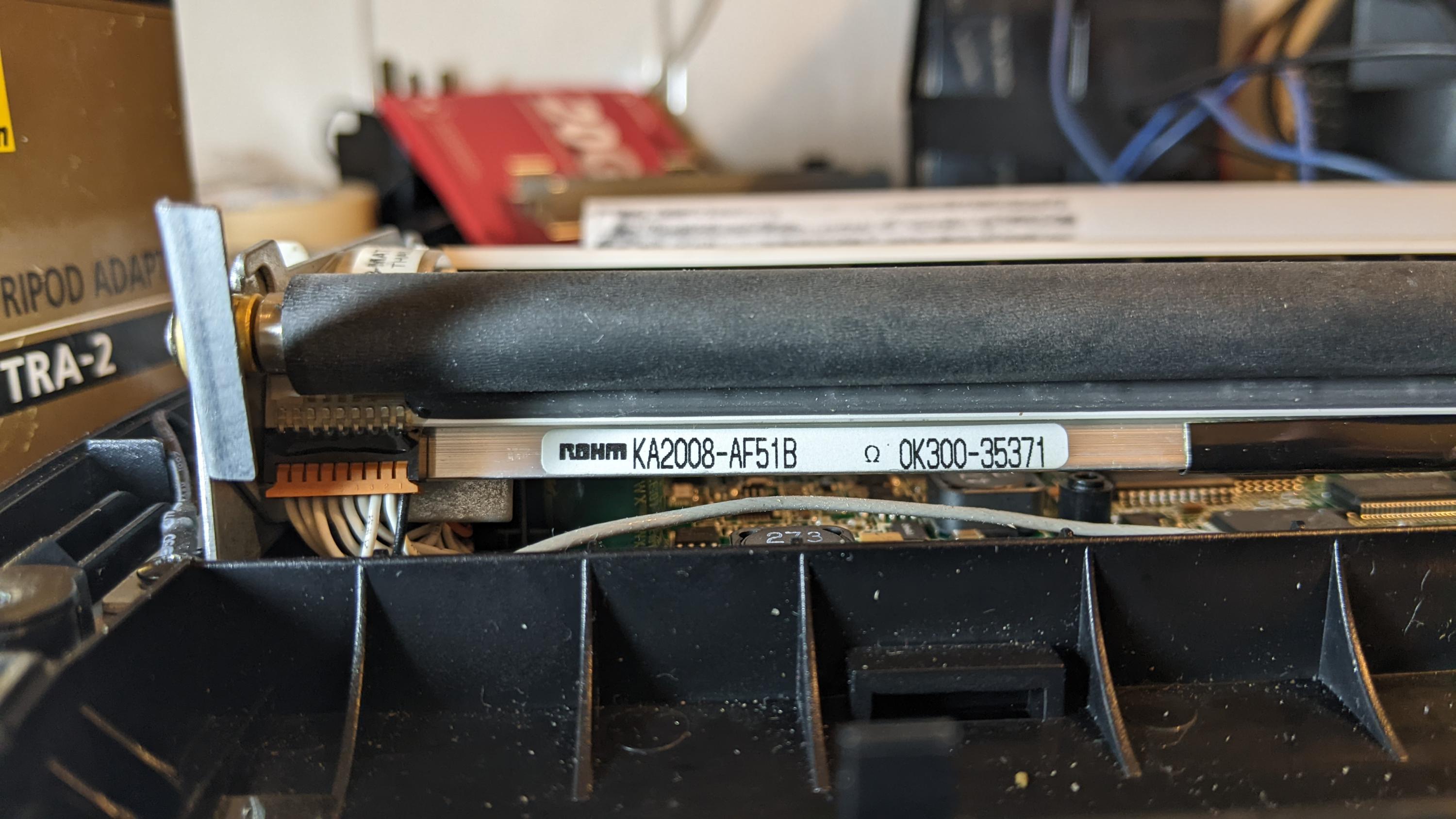

          I still suspect the printer head might be either broken or just past it's normal operating life.
          These machines are old now and I've seen thermal print heads stated as lasting around 10 years.
          They are only supposed to work for so many metres of paper.
          I took the print head out from its connecters and I don't know if it should have any continuity from one end to the other, but none of the pins at one end connect to any pin at the other end.
          I was able to touch the heatsink on the print head while it was printing and only one end gets warm.
          I realise that could still be a faulty chip only feeding a signal to one side of the print head.
            if you can get the pinout of the head you can compare the resistance of all the heating elements

              I can't find out any info on the print head anywhere.
              See attached for numbers

                      i searched that head number, found a rohm datasheet but it didnt have the pinout.
                      it did make me pretty sure the head is the problem though - it has over 1000 elements with onboard switching.

                        Do you have a link for the datasheet?
                        I can't find a replacement head anywhere but I have asked a few places if there is a similar one that will work with no replies yet.

                          https://yandex.com/search/?text=rohm+ka2008-af51b
                            Yes I already have the ka2008-A10 datasheet but it shows as having 7 pins on each end and the KA2008-af51b has 9 pins.
                              I was wrong about the pins on the KA2008-AF10A it does have 9 pins so might work but I can't find one of these to buy anywhere in the world.
                                it probably needs different current to run too.
                                i noticed on a smaller one the last part of the number can mean the heater resistance
