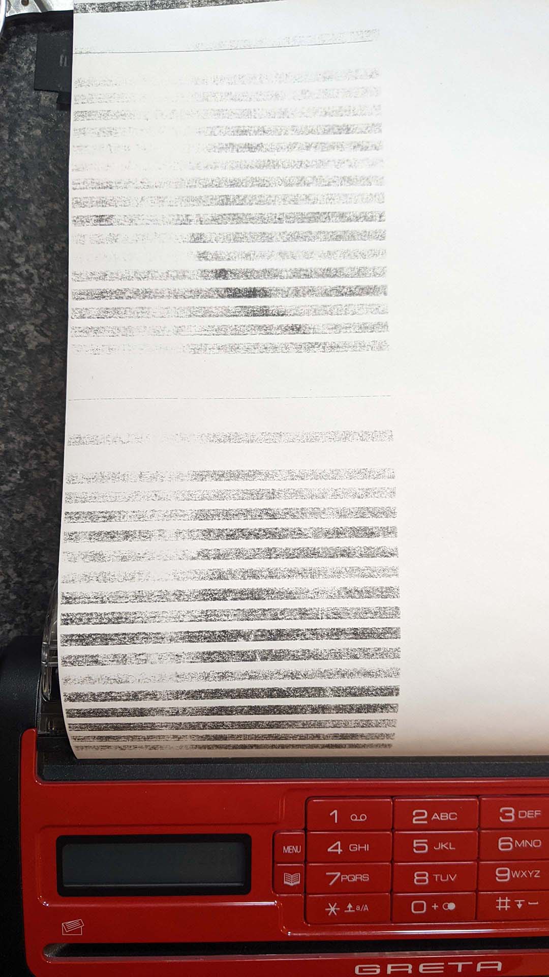

    I just got a used possio greta portable fax machine.
    It uses thermal printing.
    Possio stopped support for these a while ago so I can't get spare parts for it.
    The print head is a ROHM KA2008-AF51B 0K300-35371 which I haven't been able to find online.
    I've attached an image of what the print looks like when printing any text.
    Any idea what causes this?
    I've cleaned the printer head, but it was already immaculate.

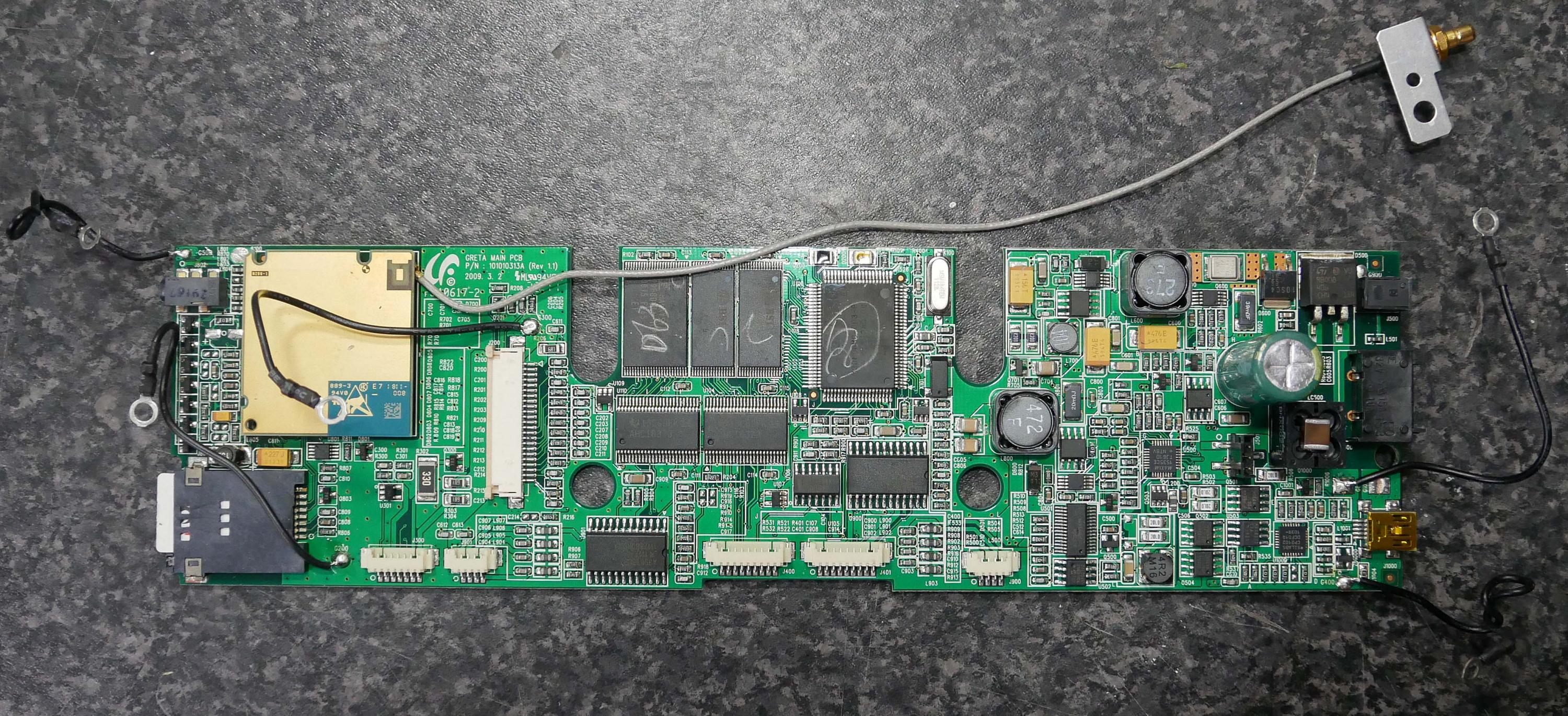

    lets see the board(s) in it

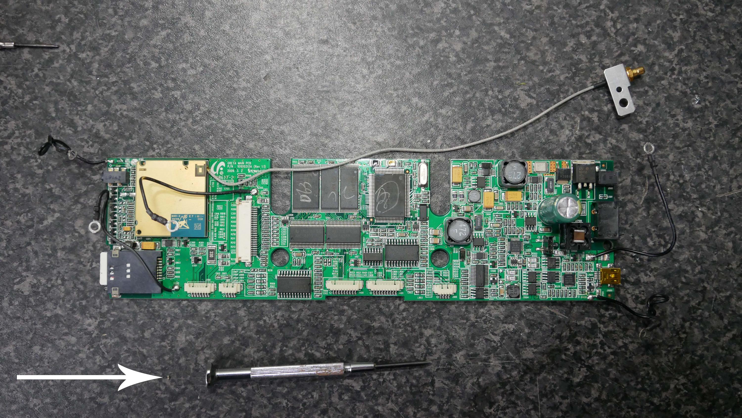

      I can take more (closer) pics if needed.
      I don't know if it was good or bad luck, but I just noticed a tiny component after taking the board out the case.
      I inspected closely every empty part of the board where this component could fit, but every empty space has two domes of solder in good condition.
      The part I found has solder on one end and none on the other so I am confident it has not fell off this board.

        yellow tantalum capacitor c600 upper-right looks cracked
        can that wifi board unplug? mabe the loose part was under it

          It's not a crack it's a pen mark.

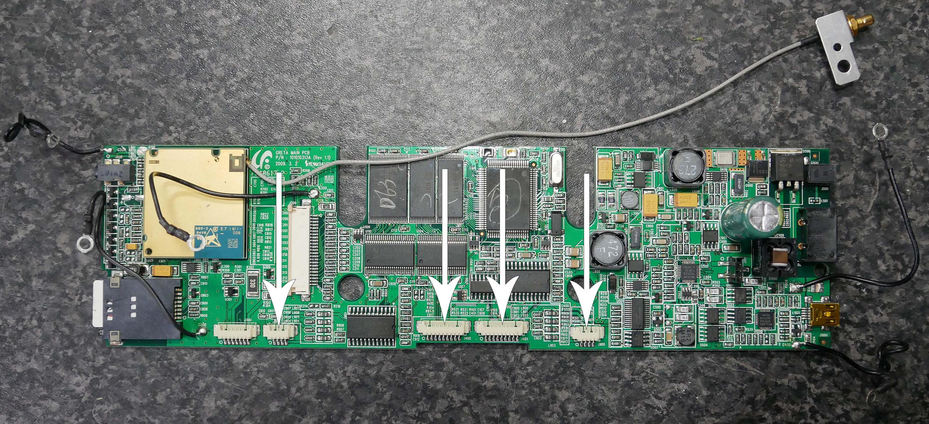

            which connector is for the printhead?
            • waigy
              • Nov 2009
              • 93
              Re: Portable fax machine thermal printer printing blocks of black with no text visibl
              These 4 connecters are connected to the printhead.
              I'm aware that the printer only seems to be printing one half of the printhead and at one point faint print appeared on the other half, but it was still just solid blocks of print with no text visible.

                I've looked at every component close up and can't see any burnt or cracked components.
                  • 31170
                  burnd or cracked parts are rare.
                  check the inductors and caps left of the small connector,
                  and see where the larger ones go.
                  is their more parts on the printhead?
