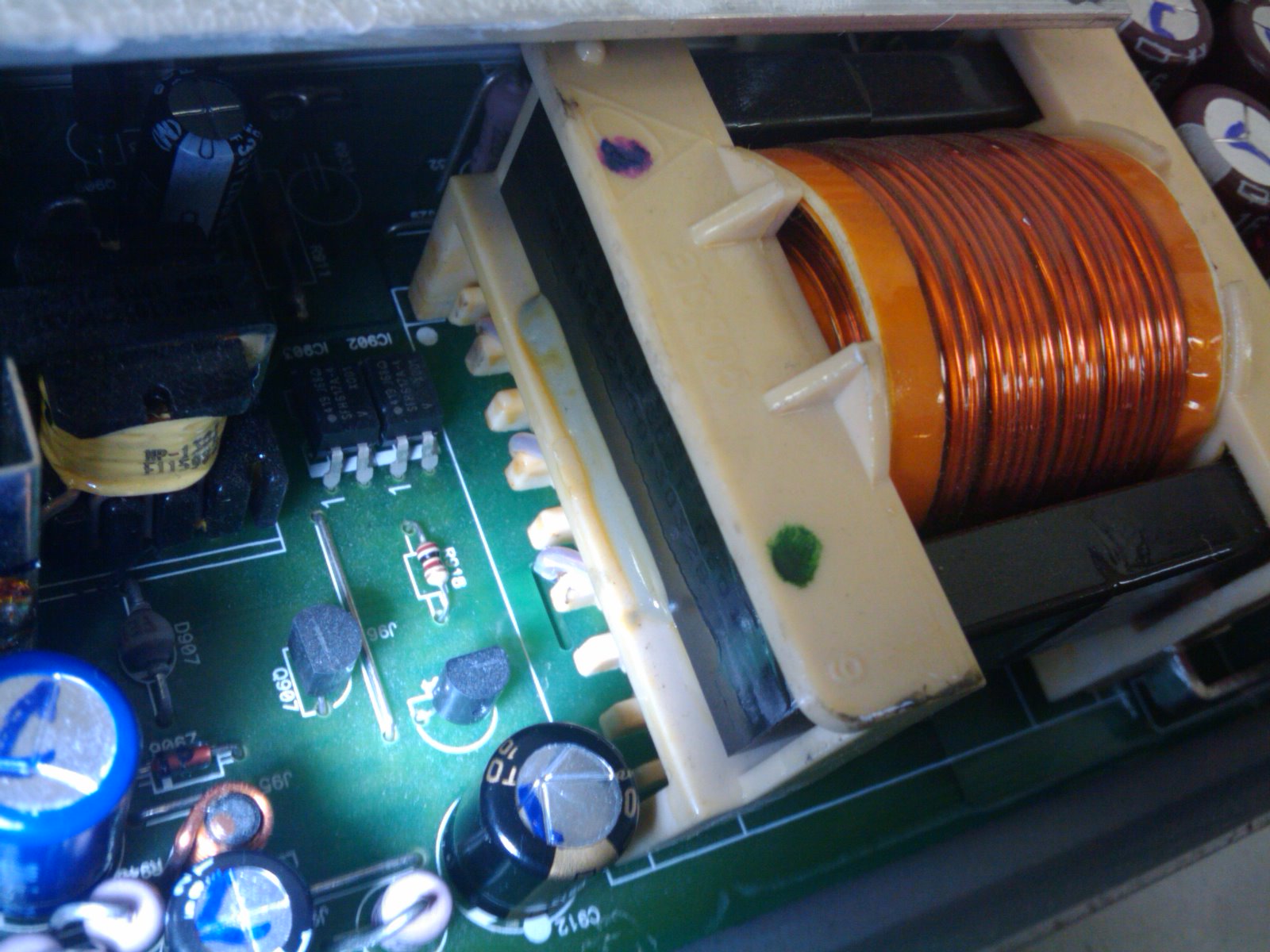

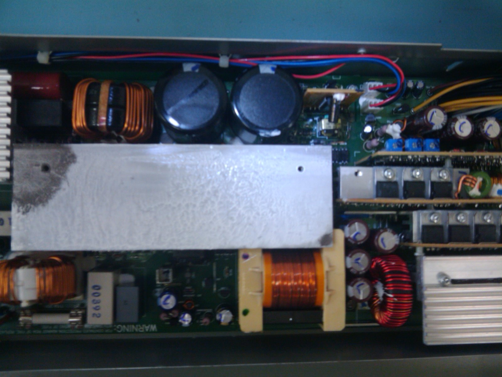

    I picked up a Precision 670 for cheap off craigslist and found out the power supply squeals something awful when it is plugged in (under load or not). I opened the PSU and found no bad caps, I read about if it is >3 years old, you should recap/replace it (source: https://www.badcaps.net/forum/showpo...9&postcount=3). So, I decided to recap it and see if the squealing stopped. Ordered all the necessary caps and went to soldering. Now, not only is it still squealing, it has gotten a little louder. I am having a hard time determining if it is the big high voltage caps or the transformer(s) below them, but it is definitely coming from that area. I added some pics to show what I am referring to.
    I am really trying to avoid buying a new power supply because whenever people see I am in Alaska, they immediately triple the shipping cost and I don't want to spend $50+ on shipping for a $50 power supply . Any help would be most helpful.

        Using a hollow pen (appearently, I have no straws), the noise is loudest coming from the little transformer, which is kind of what I was afraid of. I am a little unsure of where to go from here--is the problem caused by a failing transformer or is something else on the board causing it to squeal? I would hate to go to all the hassle of finding then replacing the transformer (not to mention having to pay like $15 shipping for a 3oz part) if something else is causing problems. Just a note, there are no burn spots or discoloration on the board and all the components appear to be in perfect physical condition.
        Transformers are an area in which I am unfamiliar, so maybe someone can help me identify this little guy. On top is DT-E16-126T 8000 DET0422<01>2536A. On the side, printed on the plastic wrapper is MP-1301 E115982. Punching these into google gives me no information at all.

          Taking a measuring tape to a standard ATX power supply I have laying around (550W Rosewill), I am fairly certain that if push comes to shove, I can take out the dell supply and replace it with the power board in the Rosewill then splice in the proprietary dell connectors. The only problem I may run into would be the mounting holes, but that gives me a good reason to use my dremel . Hope it doesnt come down to that, but if it does, it seems like a good contingency plan to me. Only problem I forsee would be the wire labeled Fan_Fail, but that is probably just going to be something I can tie into a ground or +5 or something. Will research further.

            You can try resoldering the transformer
            They are heavy and can easily for that reason alone damage the solder so it does not make contact, they also get hot which is another reason the solder can fail

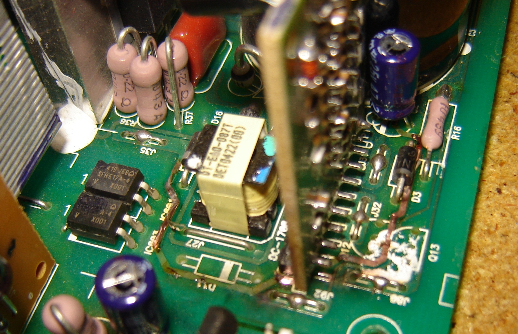

                  So I am pretty sure its dead now for some reason. I pulled it apart to resolder the transformer and find out what caps I would need to order when I found this (check out the pictures). That trace was most definitely not there before and I am not sure where it came from. I have not had it plugged in since I recapped it. Maybe it happened while I was testing it? Either way, it does not fire up at all anymore, and I am pretty sure this is fatal. I considered just using a piece of wire to jump the busted section, but I'm not sure that is really gonna help.
                  I was hoping to save $150ish on a new psu, but unless anyone has any ideas about what may have caused it or any way to fix it, I guess I have to buy one anyway....

                    I think it's gone to meet it's maker.
                    It probably is repairable but it's not something that can be talked through I'm afraid.
                    I can't see what that track connects to but it's likely it would have been one of the mosfet connections which has probably gone s/cct.
                    The two optic isolators have gone too and more than likely a zener diode. Even if you repaired all these you might still be back with the 'squeal'

                      A week or so ago, I tried putting a piece of wire across the burnt trace and soldering it to the PCB (it wasnt working anyway, so i had nothing to lose...). Still dead.
