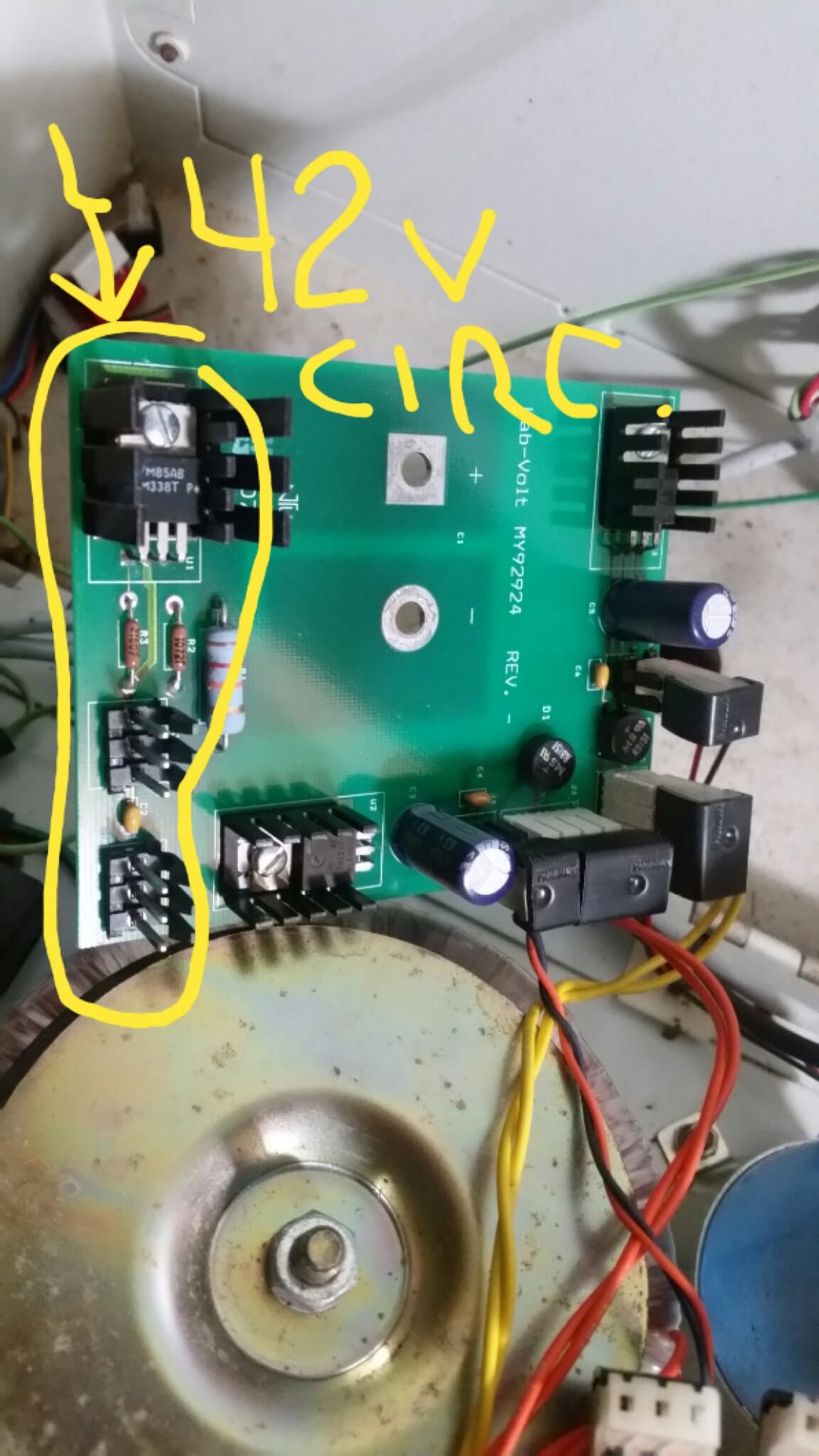

Dc power supply in cnc not working
    Re: Dc power supply in cnc not working
    Pic attached
      In case you didn't see post #20 after my edits:
      - Make sure your 42V consumers aren't shorted... TOP PRIORITY as this is the TOP reason for needing to do the following replacement:
      - Replace U1 (LM338) on the board, make sure resistors aren't open (infinity ohms) after you remove the LM338 to make it easier to measure them.
        Hi eccer
        Thank you that does sound logical
        Maybe ill try ordering the u1 and replace it...if part isnt obsolete
        as you said its probably the most common failure part on the board.
        It say LM338 is 1.2v to32v...which i am getting about 1.4v at the output terminals
        My circuit is 42v...so maybe need upgraded part? Higher than 32v?
          It is going to be a challenge to find a regulator that goes higher 36 volts
            You don't need to get a better regulator as long as there are no and never a short(s) on the output to ground even for a short duration.
            If there's a short, expect to toast the device pretty much instantly.
            If you need a 42V regulator that can withstand temporary shorts, you'll pretty much have to design your own.
              Ok thanks ill buy same part...one note...when this loss of 42v happened at same time a 10a fuse blew near the machine main ac input
              I replaced the fuse and has not blown again
              At the time i was working on a diff area of the machine...trying to install a potentiometer on a diff board to control rpms of spindle...when i installed the pot and set it at 0rpms the spindle was turning fast...i was like what the heck...so i powered off machine...rechecked pot wires and powered on again and main fuse blew...along with losing my 42v output.
              Maybe this is all related.
                So maybe this is related
                Do you know what caused the fuse to blow in the first place
                  No i do not know what caused main fuse to blow but it has not blown again
                  ..if i replace the lm338 maybe it will blow main fuse again...its a cheap part so ill try it
                  Or maybe wires shorted out while i was working on machine
                      Try this LM338T
                            Originally posted by sam_sam_sam View Post
                            hmm that looks like it's on backorder too, but probably easier to get that way than mouser.
                            Seems you can only get the TO204 version in stock at the moment which sure wouldn't fit...and costs $ARM$LEG ...
                            Ah here might be an option. https://www.jameco.com/z/LM338T-Nati...or_192284.html Would be a pain if it truly was unobtainable, but I'd not be surprised if they become more and more difficult to acquire as time goes by...
                              I will have to get some it looks like they are becoming obsolete and will be really hard to get
                                  The spindle has a separate speed controller board called cheetah-sm-2hp
                                  I was just hooking up a manual potentiometer to control speed...and i connected it per manual.
