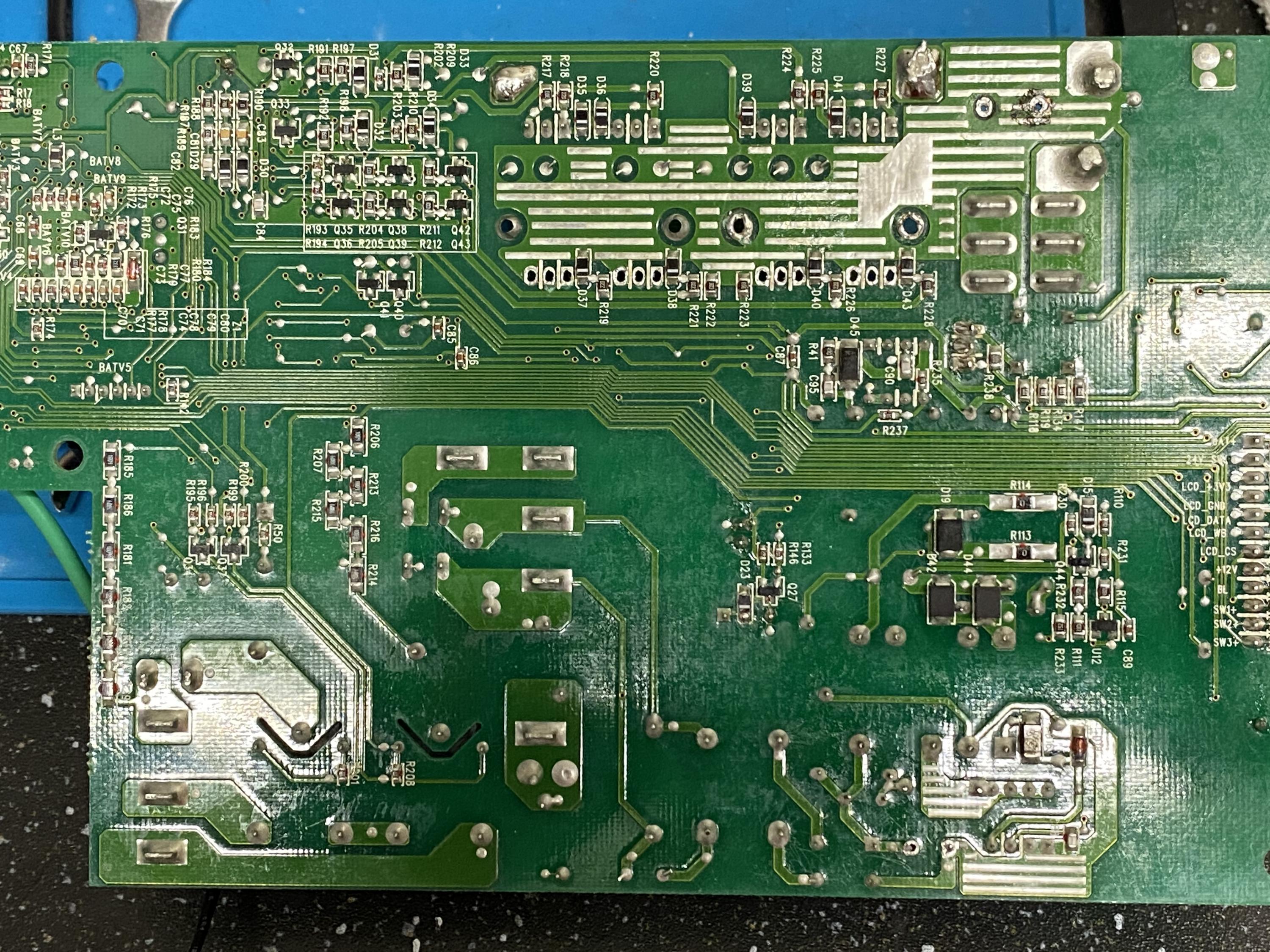

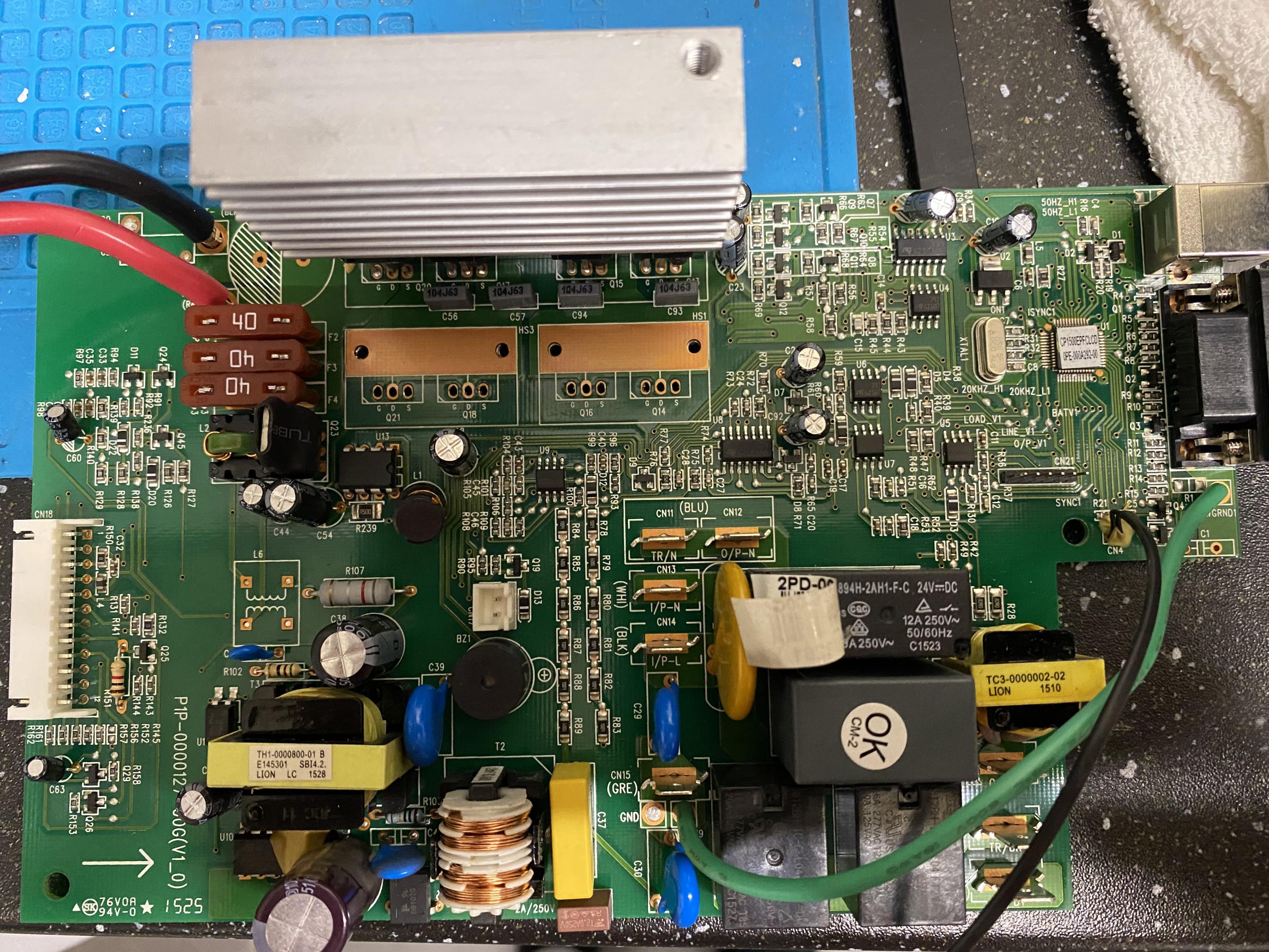

    I have a Cyberpower CP1500EPFCLCD which is failing on battery test (power cord detached). There are no errors on LCD screen, no issues reported on PowerPanel software. Not sure if this is linked or not but I suspect that this behavior came after a thunderstorm although the UPS was connected to another AVR.
    I have checked most of the components (no sign of burned components, capacitors looks good), mosfet checked, relays checked and working, batteries are ok but still not switching to invert the 24v DC to 220 AC.
    Any help or schematic (even better) is highly appreciated.

    Shows some pictures of the front and back of the boards so we can see what you are dealing with

      I hope these pictures are ok.
      Thank you

        The first thing I would do is replace the viper ic chip right in front of transformer and the low UF capacitors that are near this chip
        I would also highly recommend that you use a incandescent light bulb instead of the fuse is just in case there is still something else wrong with this switching power supply

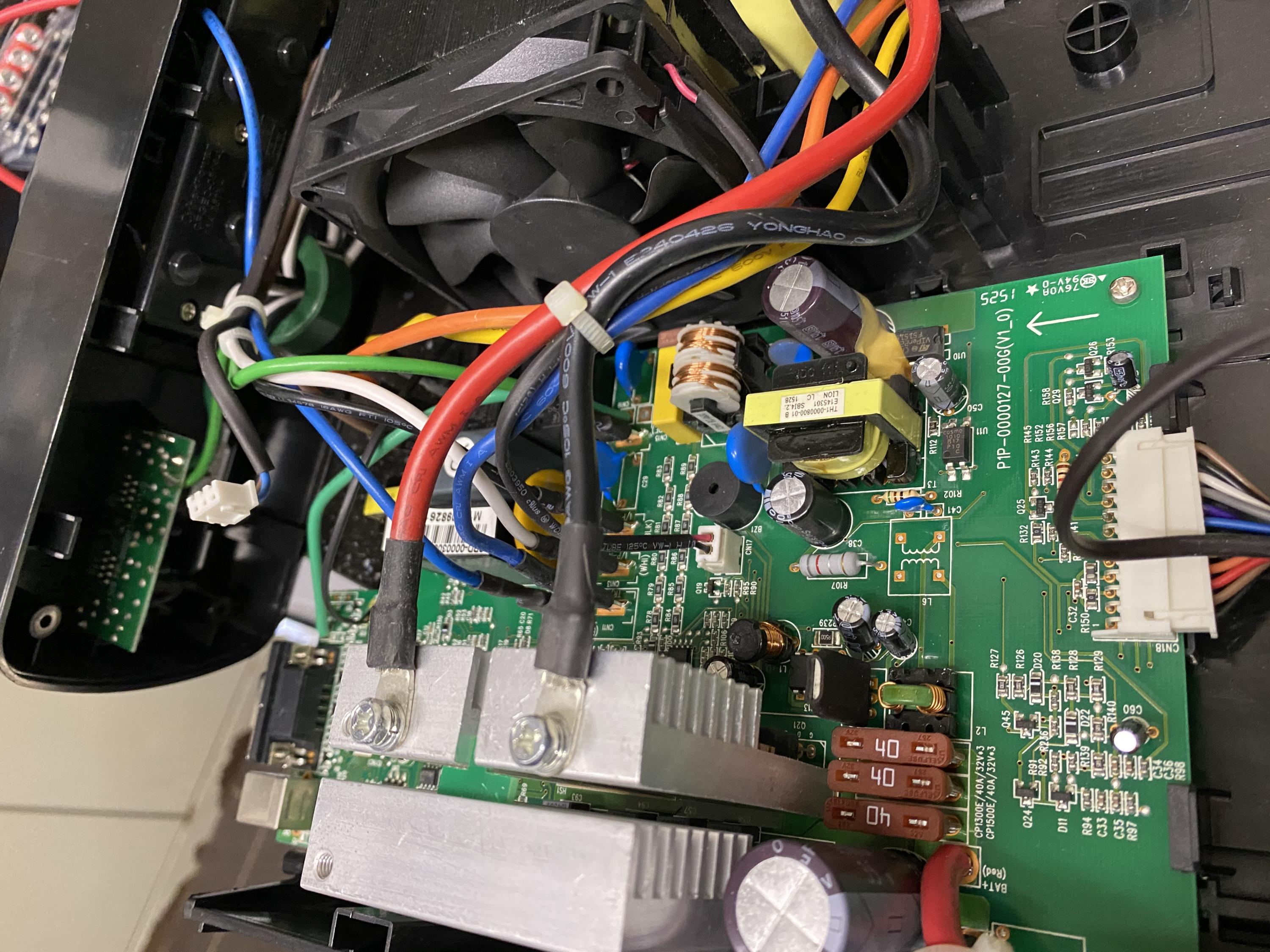

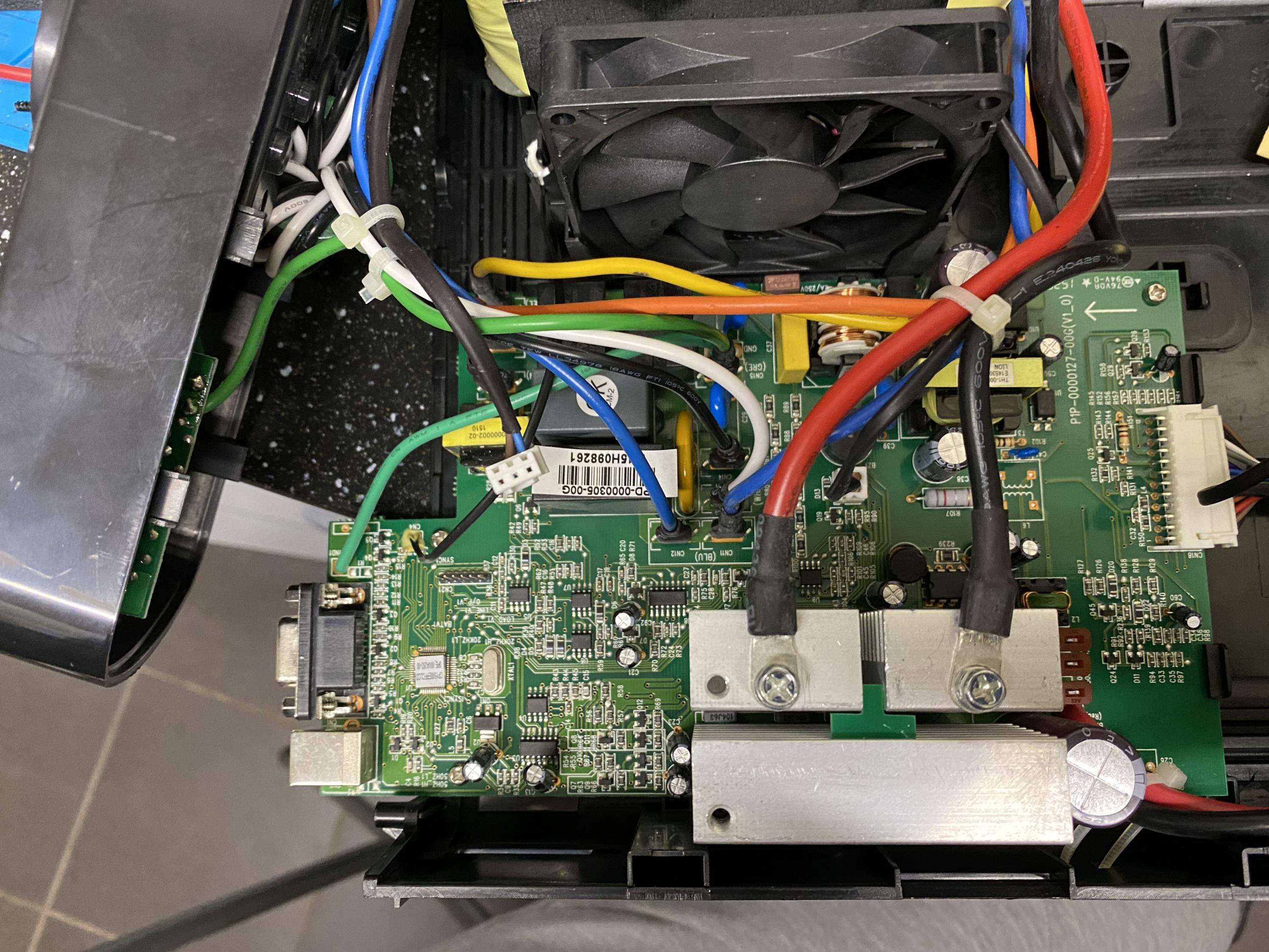

            Hi, I have just replaced Viper and all UF capacitors. The battery is charging, fuses are all ok, but I cannot make the UPS to switch from line to battery (test, unplug). I'll try to use the "bulb" method to see if there is something else.

                I would check the devices that the battery terminals are attached to the heat sinks use a 1156 light bulb or a MR16 light bulb 50 watt one on the battery terminal while testing the battery circuit
                Google the part numbers that are those two parts are mounted on the heat sinks please post the part numbers and or post the pictures of them

                      If they are mosfet on the heat sinks then you would want to test them to make sure that are working the incandescent light bulb is in series with the battery just in case something goes terrible wrong with the circuit
                      For the battery power not to power the inverter is what seems to be likely your problem now so you need to figure out is it the mosfets or is it what is controlling the mosfets is where the issue is
