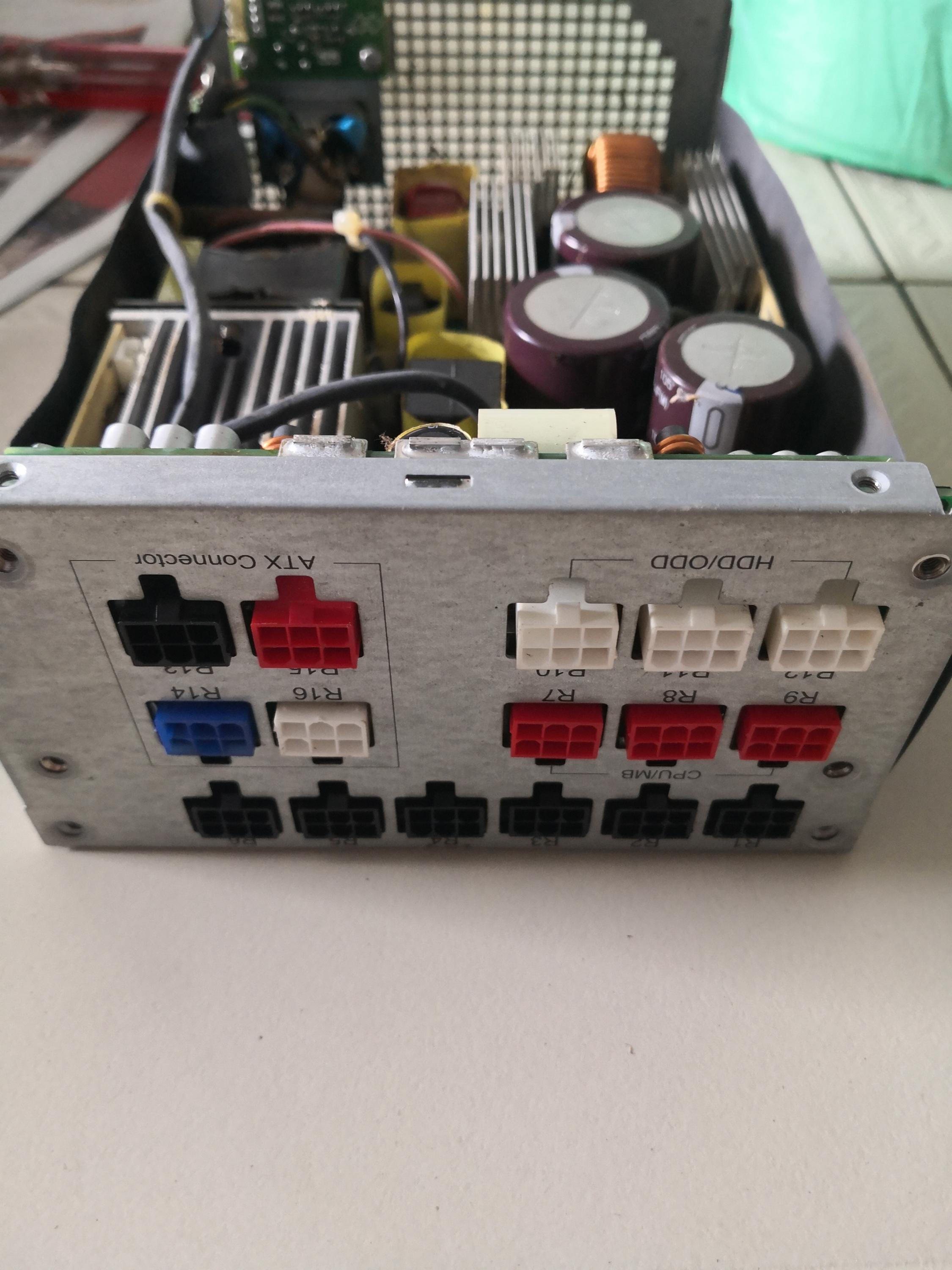

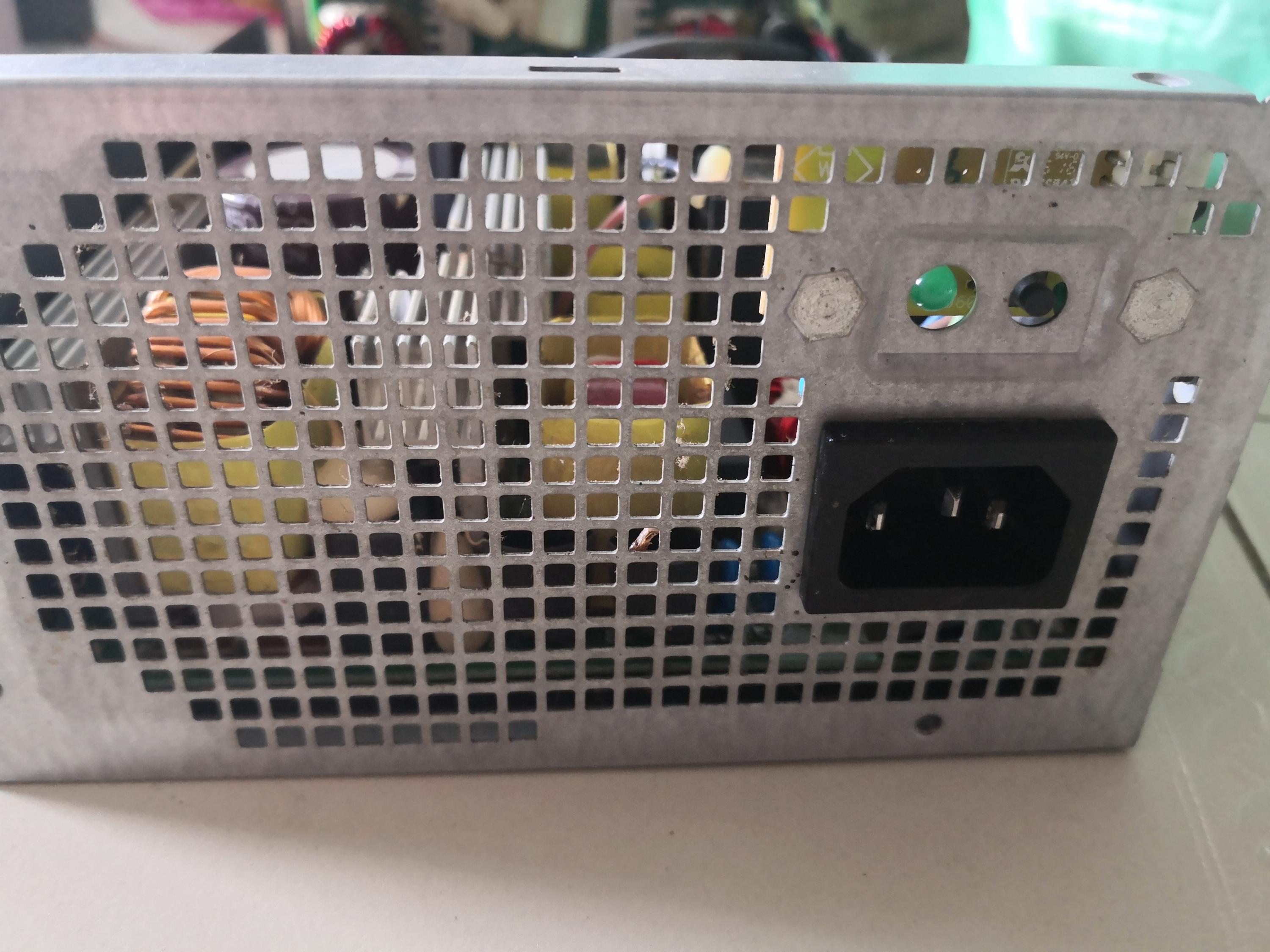

    Hi, anyone knows how to check this psu is good or not? There is no light when press the button at the psu there
    • Jul 2011
    • 6070
    Re: dell d1500ef-00
    Look at the board and see what marking are on it
    See if you see a power ON power GOOD 12 volt 5 volt 3.3 volt and the normal ATX switching power supply markings if it does then hook the power ON to a ground wire and it should turn but you might have to load the 5 volt rail
    If not then someone else will need to help you with it
