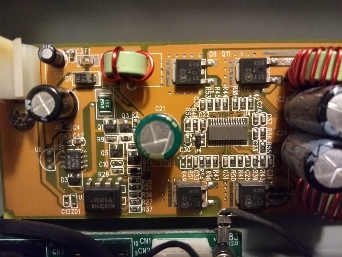

This "beautiful" converter board is from an old Mini-ITX case. It uses 12V DC as input and converts it to ATX voltages.
I'd like to recap it. The machine is in use 24/7 as a router.

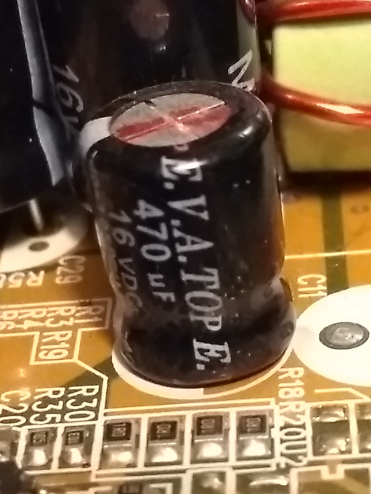

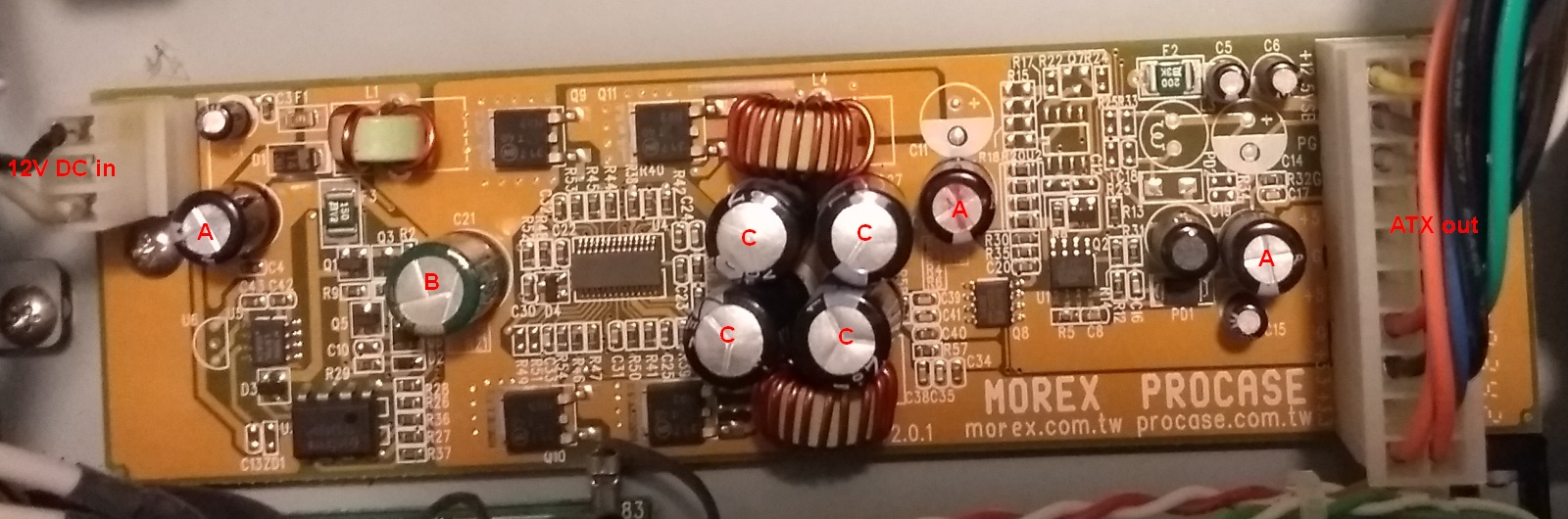

A: "E.V.A. Top"
470µ/16V
B: Sanyo WX 470µ/16V (in the 12V rail)

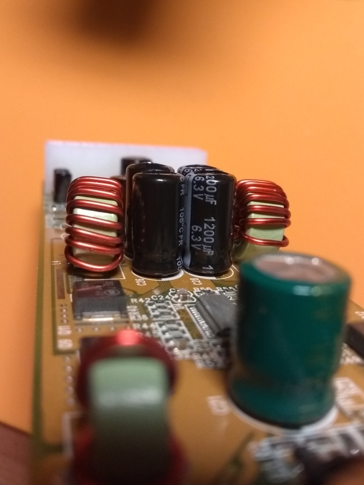

C: (currently four bulged junk caps that need to go) originally these were four green sleeved low quality 1000µ/6,3V caps that blew up years ago (the upper two are in the 5V, the lower two in the 3,3V rail)
My plan is:
A: measure, if not ok replace with Chemi-Con LXZ or Panasonic FC
B: keep
C: replace with Panasonic FR 1200µ/6,3V, 8x15mm, 1240 ripple, 0.041 Ohms
I'm not sure about C. Regarding low ESR electrolytics the Panasonic FR series is the best I can get my hands on easily. Could FRs work out?

left side of PCB, the markings on the - probably - Mosfet controller chip are scratched off unfortunately

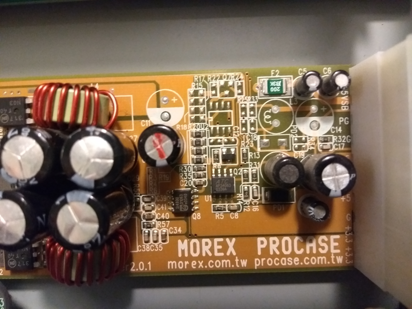

right side of PCB
"E.V.A. Top" in all it's glory
