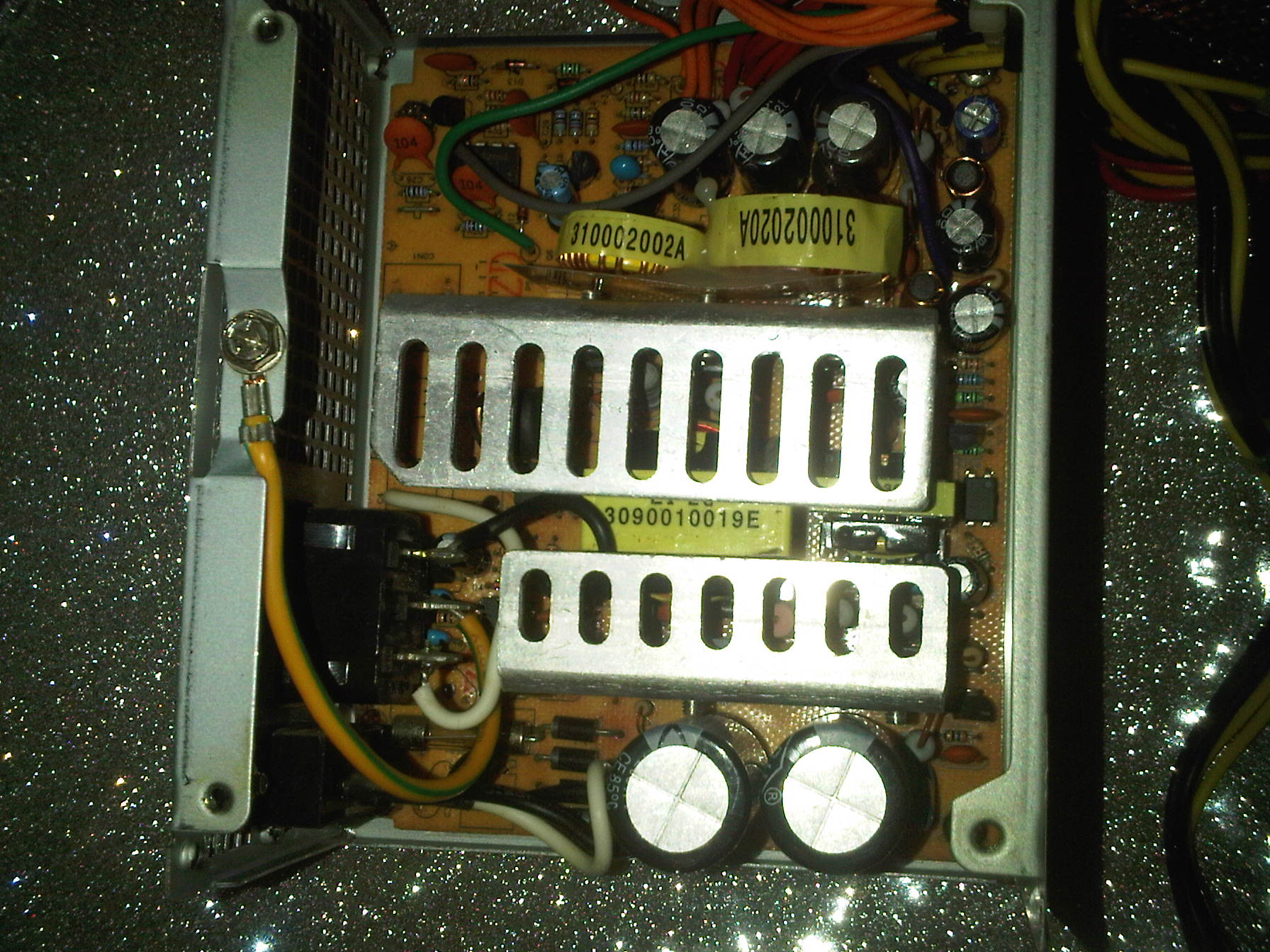

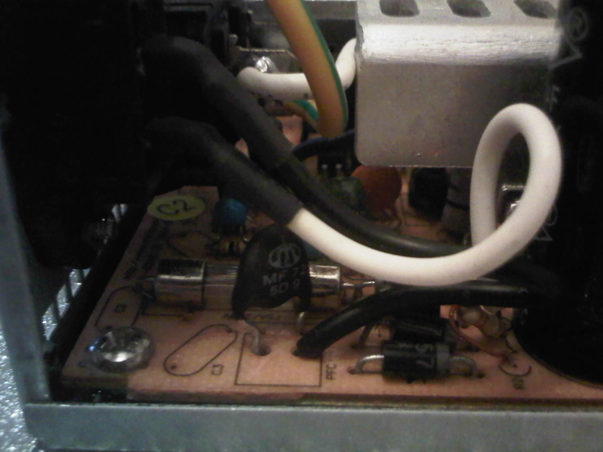

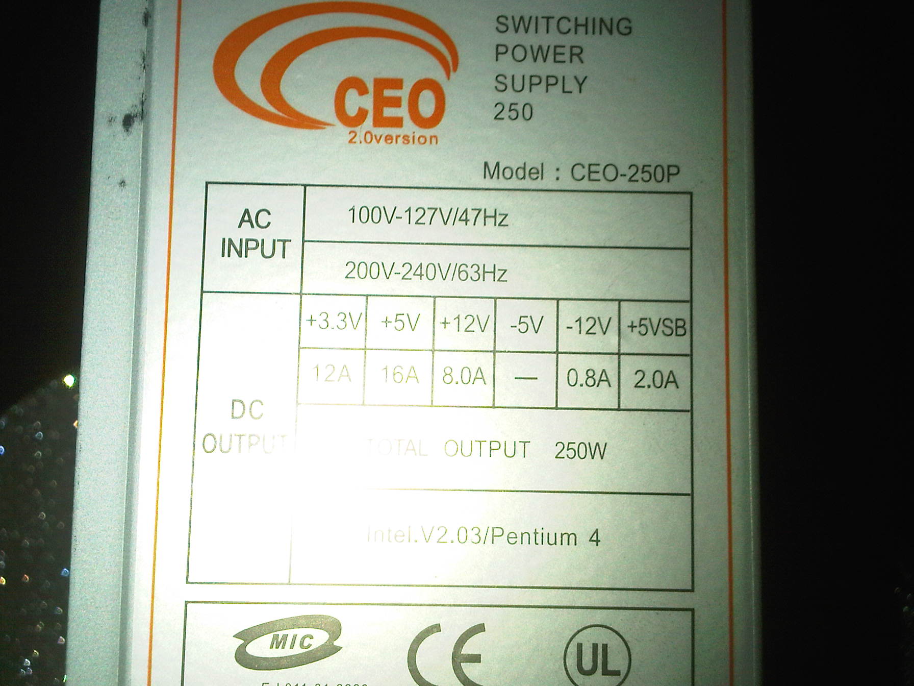

      Attached are pics of a CEO-250P MATX power supply. Thoughts would be welcome. It seems to be lacking vital input filtering components?
        Re: the gutless, bloated, and fried power supply hall of shame
        Well, it seems to be built slightly better than most wonders claiming to be 350+ W Pi coils seem to be missing which may be a problem as for ripple being in specs. Could be solved by increasing capacitance to absolute limits (~3300 uF for D10), for this power (250 W).
        Transformer is OK, rectifying diodes could be as long as they are at least 2 A rated. What is rated capacitance of those big caps on primary? What transistors are there and what rectifiers on secondary?
          That is a cute little PSU there! Recap, add some EMI filtering, and it will be pretty decent!
          Muh-soggy-knee
            Heatsinks look adequate, O/P inductors look reasonable. The I/P rectifiers look the same size as 1N400x series, which are 1A rated parts. Hope they're better than that! wouldn't operate that thing in the same room as a TV or AM radio! If you have decent switch transistors (probably BJTs) and O/P rectifiers, it might be worth kludging in some I/P filtering to reduce interference with other nearby electronic devices.
            PeteS in CA
              It looks like there isn't room on the board for adequate filtering on the outputs.
                I wouldn't trust it in a P4 computer with only 8A on the 12V
                  To add EMI filtering, can I just add X capacitors from random (junk) power supplies? I will take a closer look at the ratings of some of the components later.

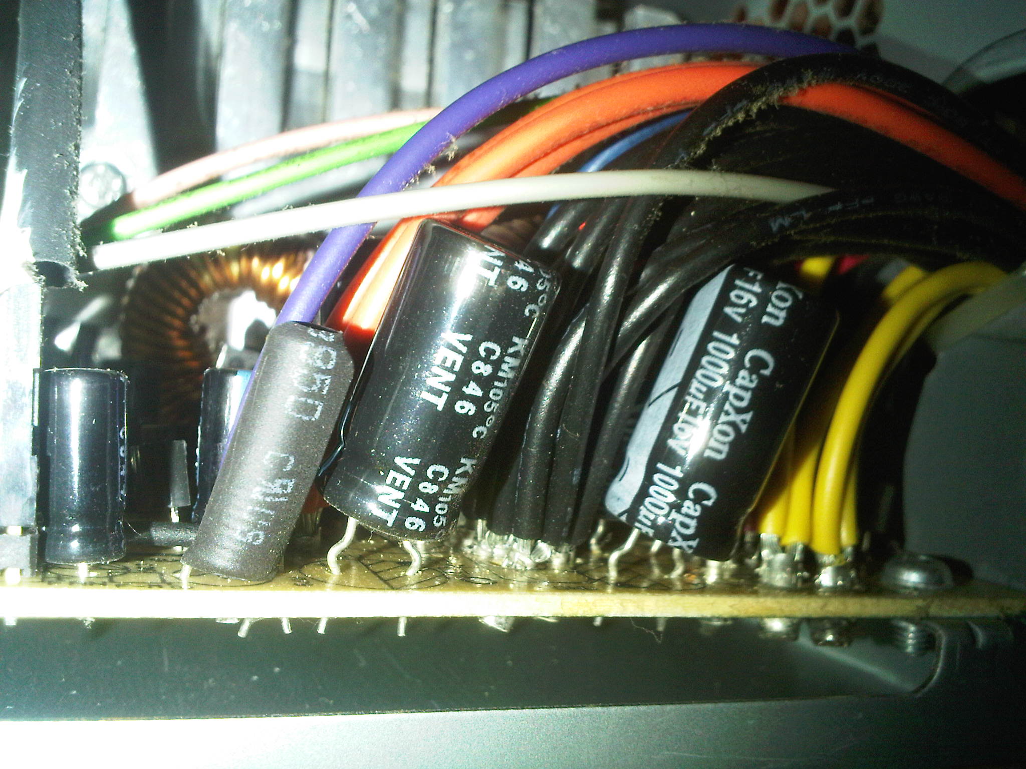

                  I had a peek inside my Bestec 250W which is working fine except for some fan noise. I noticed a lot of the caps are not soldered on close to the PCB - the leads stand up off the board (see pic attached). Does this matter?
                    Sure, we all do that. Just use those safety-aproved X caps, not ordinary ceramics. The same for Y caps.
                    Don't think so.
