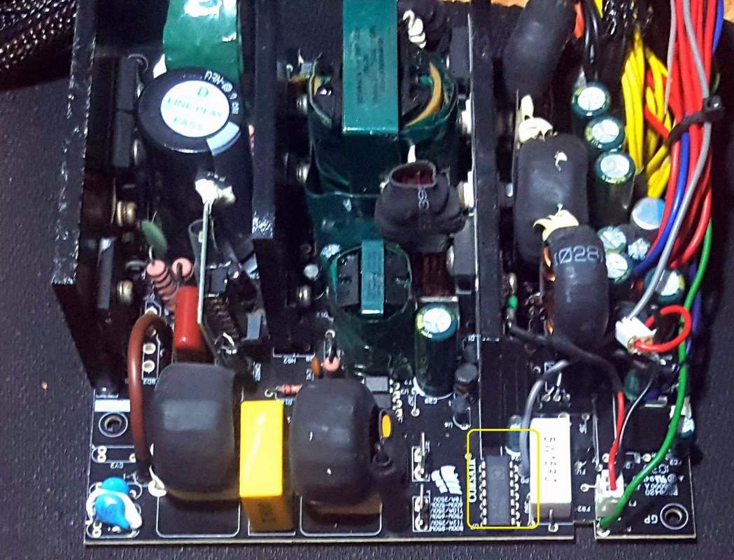

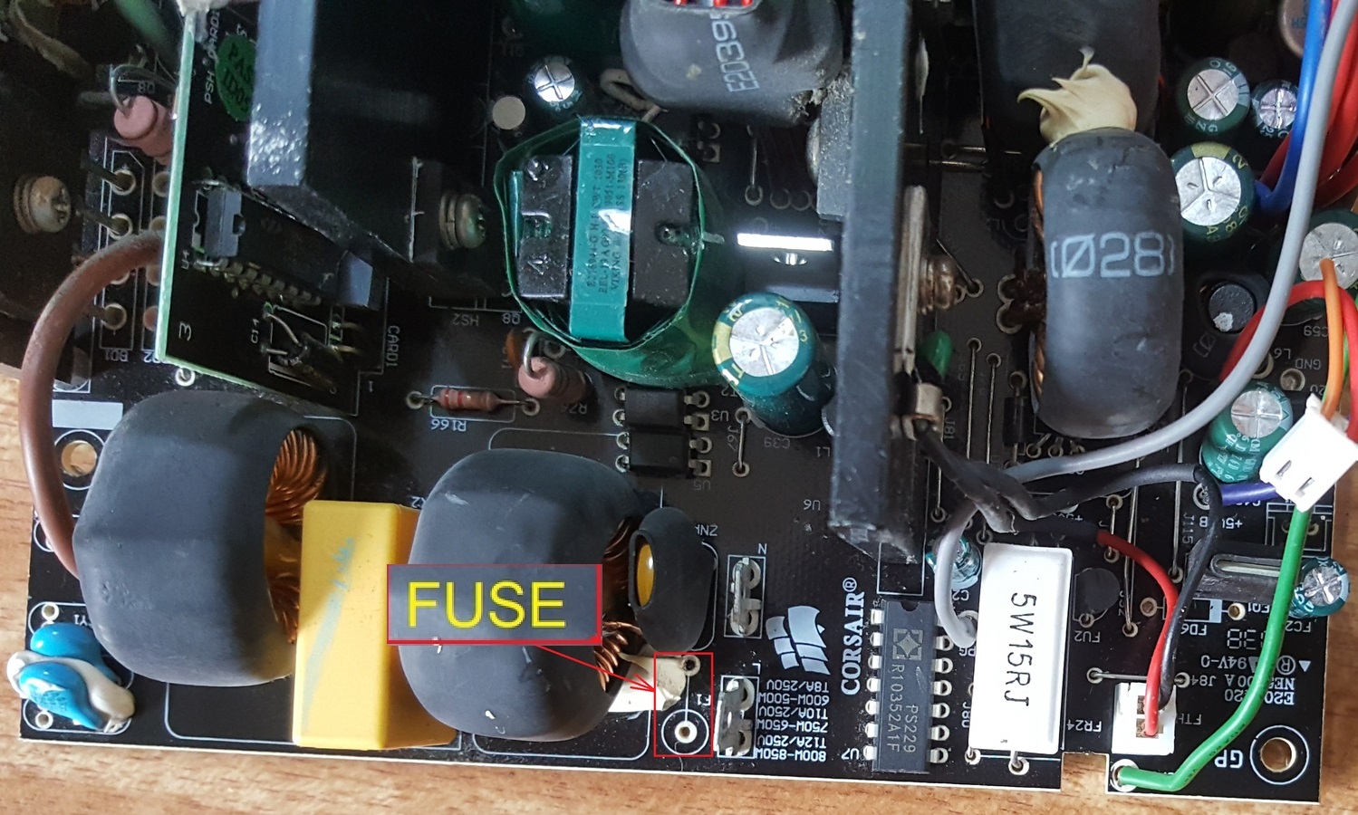

      The PSU is a Corsair Gs 600 Gaming Series. I do not so gaming, but some CAM, CAD as a hobby.

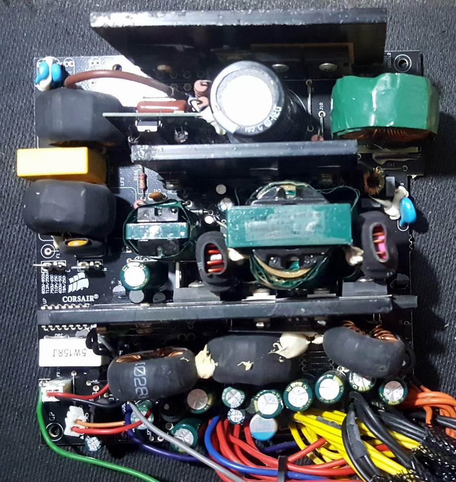

      The unit died, I turned the PC and nothing, no fan no light. I took it out and connected the green and black on the ATX connector and plugged the unit to the mains, tested every pin on the connector, they were all dead and the fan not spinning.

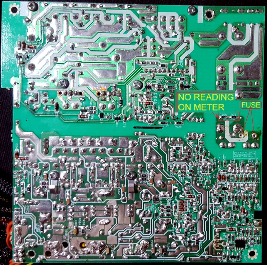

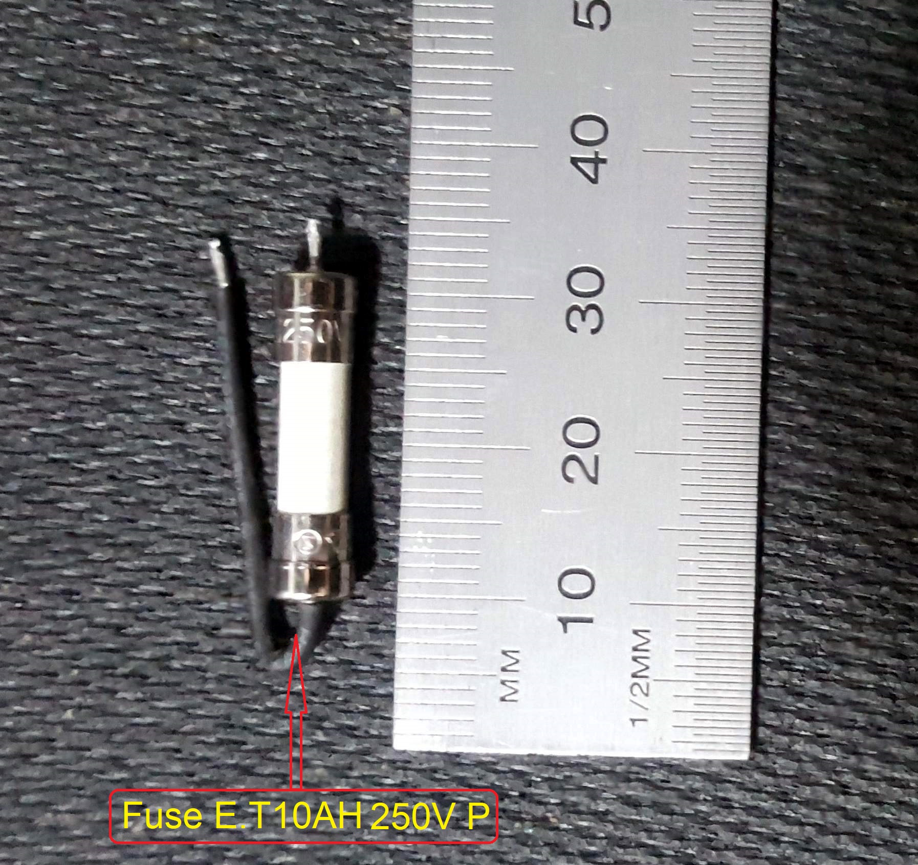

      Now I disassembled, desoldered and cut some wires to remove switches and do some tests. The fuse's reading goes up and down and settles to zero no the meter at 200k oms. The two SM resistors next to the fuse are apparently dead, there is no reading. probably because they are still mounted.
      The fuse was shrouded with shrinking tube.
      I only have a AU$20 multi meter from Jcar shop. For what I do I think it's enough.

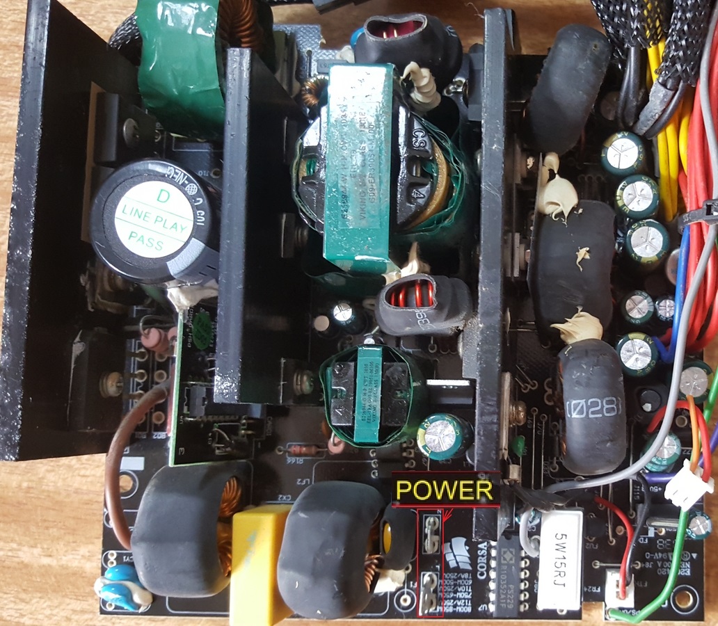

                The resistance readings for the fuse should not "jump" at all. You should get a solid LOW resistance reading, instead. Low, as in whatever your meter can display on the lowest resistance scale (typically 200 Ohms for manual-ranging multimeters) when its test probes are shorted to one another - so no more than 1-3 Ohms, really.
                If the fuse is good... then let's start with the simple things first:
                1) With the PSU plugged into the wall, check if you get any voltage on the 5VSB rail. That is, measure voltage between 5VSB (purple) and ground (black) wires. You should get about 5V DC (+/- 5% variation acceptable, provided your multimeter is accurate.)
                2) If test #1 above fails to produce any voltage, check voltage across the pins on the big cap on the primary side. WARNING: THIS INVOLVES MEASURING HIGH LIVE VOLTAGE. For this test, you will likely need to have the PSU PCB out of the case and flipped upside down. Make sure the PCB is placed on a non-conductive and flame-resistant surface (wood OK). Avoid touching any heatsinks or metal parts of the PSU while doing this test (the primary-side heatsinks MAY BE LIVE!) The voltage across the big cap should read about 320-340V DC for you in Australia (for the rest of you folks reading this with 110-120V AC mains, that should be 160-170V DC). If PS-ON (green) wire is shorted to ground (black) on the ATX connector, that voltage should go up to about 380V (+/-10V). Make sure you do have some kind of a load on the output of the PSU, though, or it may not turn On. An old hard drive or two (or some 12V DC fans) may be just enough. Some PSUs won't try to turn on, unless they have a good load, such as that from a motherboard. So if bad comes to worse, see if you have a spare motherboard you wouldn't mind use for testing.
                Please post back details what results you get back from these tests.
                If I had to guess at any faults...
                I see Teapo capacitors on the output. Those aren't the worst capacitor brand out there, but they do fail often enough that none of us here consider them as "good". Depending on the results you get above, I suspect you may have either bad caps on the 5VSB rail or on one or more of the output rails, preventing the PSU from turning On. Just remember this: capacitors don't have to be bulging to be bad.
                On that note, another test you can do when you encounter a PSU or other device (that is acting up) with caps from a cheap/bad brand: use a hair driyer to heat the device and then see if it works. If it does, more than likely you have caps that are starting to get marginal (if not outright failed.)

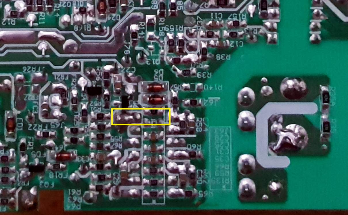

                    It took me all Monday morning on the pone to find a place that stock SM resistors. I got some this afternoon, but when I check them at home they had the wrong multiplier, instead of being 474 they were 473, 47k instead of 470k. Have to wait till Thursday to change them.
                    I have a fuse that has no pigtails. Can I use it if I solder wires to the ends or they would disolder with heat? There are slow and fast blow. Which one are recommended?
                    Capacitors: What brands would you recommend? “Teapo capacitors on the output” Could you be able to show me on the attached picture which ones are they? Are they the ones close to the long wires?
                    At the moment the board is out of the case. I cut and disoldered wires to remove switches and fuse to test them, so I have to replace the resistors and fuse first, then put it together to power it on and carry on with the tests you suggest. (I'll be extremely careful) I don't want to be electrocuted.

                                    • bigjohn22
                                      • Jun 2012
                                      • 22
                                      Re: Corsair Gs 600 Gaming Series PSU help

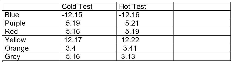

                                      G'day again guys.
                                      I finally did some tests on the PSU. Pics attached.
                                      Here are the results:
                                      Cold Test Hot Test
                                      Blue -12.15 -12.16
                                      Purple 5.19 5.21
                                      Red 5.16 5.19
                                      Yellow 12.17 12.22
                                      Orange 3.4 3.41
                                      Grey 5.16 3.13 (Is it very bad?)
                                      These tests were loaded with tow HDD. I have not tested the large cap. I have a lot of respect for it.
                                      The grey wire apparently connects from behind with the chip next to the big, white, ceramic (I think resistor) That's as far as I could trace it.
                                      I have not the slightest clue how to continue. But if you guys want to take me by the hand I'm all for it.
                                      Many Thanks in advance.
