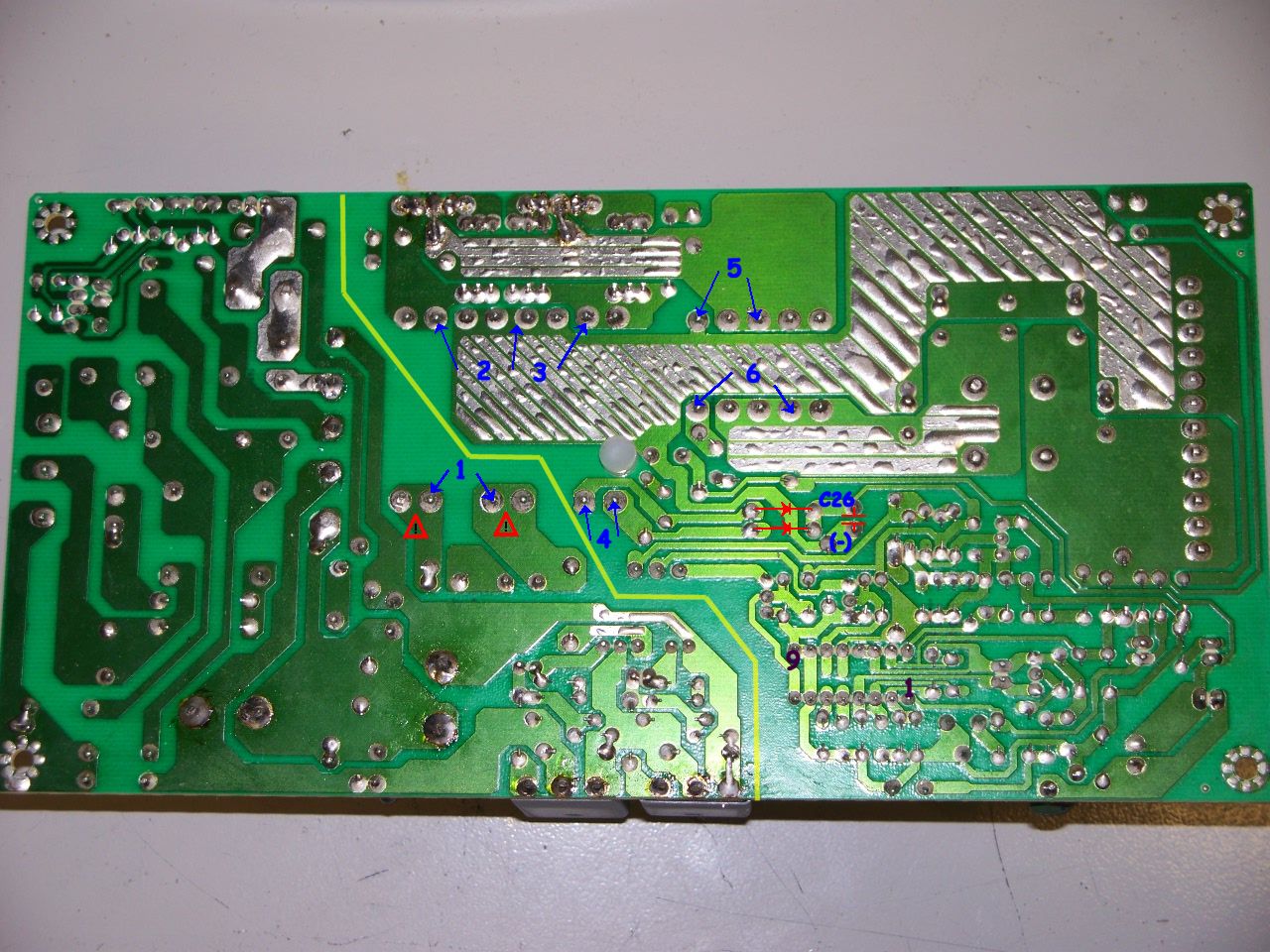

Well, I orded a replacement one anyway, just to be on the safe side.
Disconnected it has an even higher resistance. I'll order a replacement tonight.
Yep, BT137-600D. Triac. Datasheet is here:

R1 is to far from IC1 I think it is not the start up resistor, it's value is 820ohm probably 1W, the value is too low for start up.
If you read 50Kohm be sure all caps are discharge, you can lift on leg and measure it disconnected. If it is 50Kohm then replace it with 820ohm 1 or 2W.
Looking at the pictures I see IC3 near D13: have you identified it?
Maybe it is another part to check.
