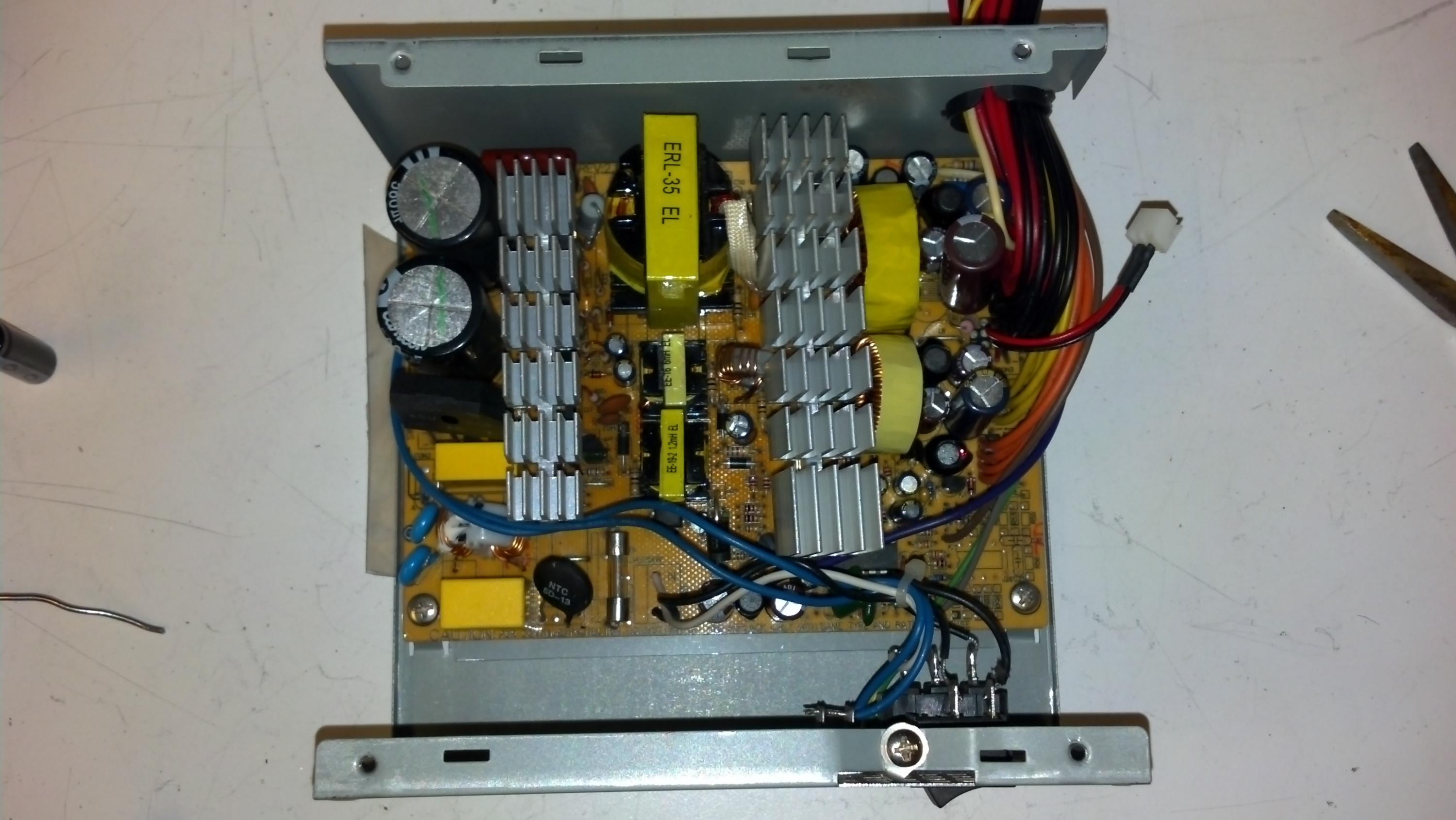

Had a look at 10 ms and lower, there was some ripple at this frequency, but not that high, around 40 mV amongst both +12 and +5 V. The scope also measured the same ripple no matter what time I have set so it has to measure the highest peaks on the whole interval, you just see smaller part when you "zoom in". I use integrated peak-to-peak meter, you don't think I read it manualy, do you?
