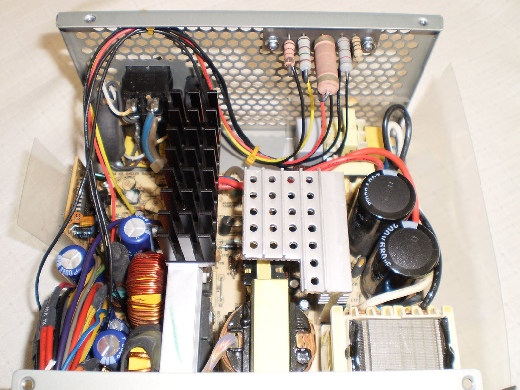

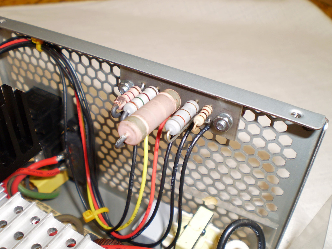

      Repair and modification FSP300-60PN for my audio system
      All output capacitors replace for Nippon LXZ.
      Hot resistors relocate.
      Added passive cooler.
      Remove noisy fan and temperature senzor.
