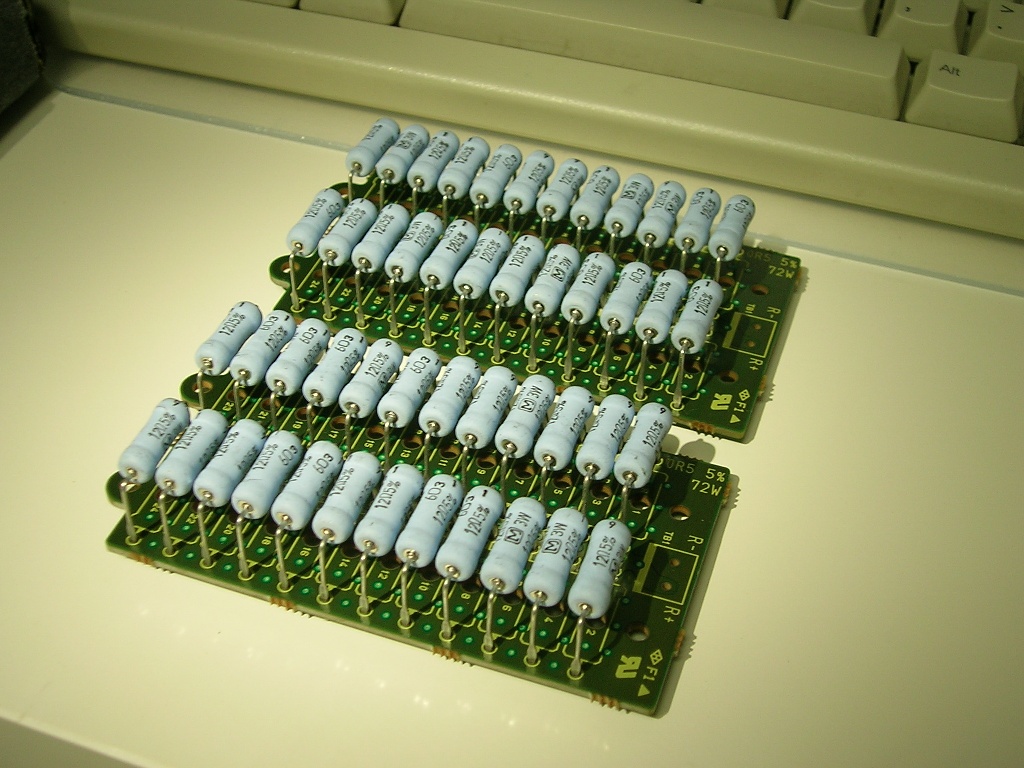

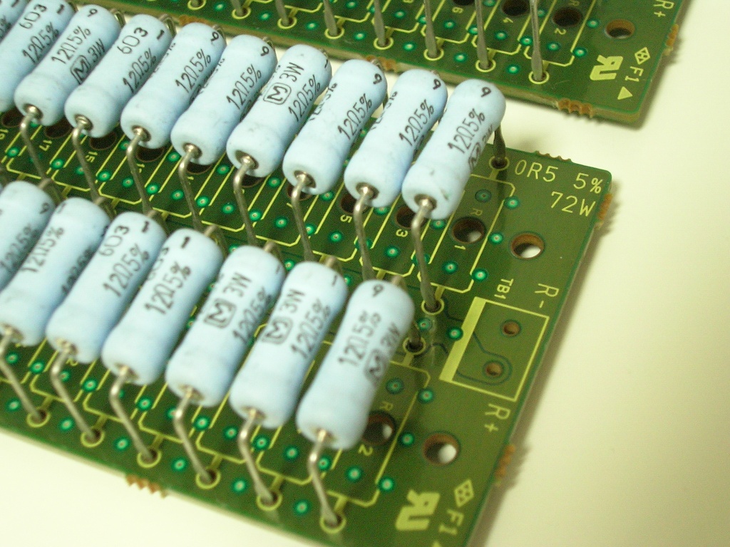

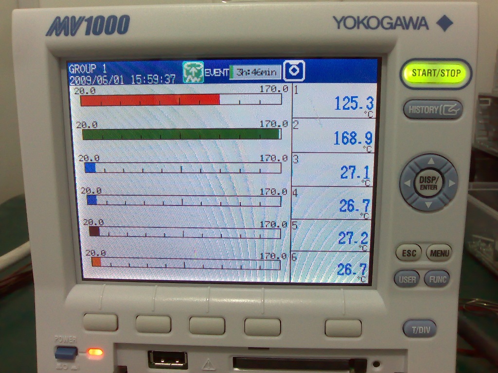

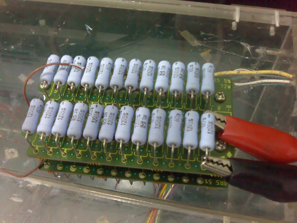

    I made 10 pcs of 72W 0.5Ohm load module for +5V rail loading test. Each modules can sink 10A ( 50W ). The resistor body temperature hits ~170 oC in just 5 minutes. It sure needs fan cooling ... PCB temperature is about 110 oC.
    ( 1 ) The Load Module
    ( 2 ) Resistor Body Temperature

    Whaa.. NICE! Sure it needs an active cooling. I built one like that, but not as massive as yours.
    days are so short when you actually do something..

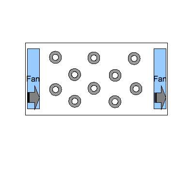

      Those look really nicely made but aren't the resistors awfully close to each other? That could make them difficult to blow cooling air through.
      Here's a diagram of how I arranged the resistors for cooling in my PSU tester.
      Have Fun,
      Keri

        Your wirewound resistors has much lower temperature coefficient than my metal oxide film ...
        The metal oxide film has TC of ±350ppm/oC. I will get some data of Resistance vs Temp. when I am free.
