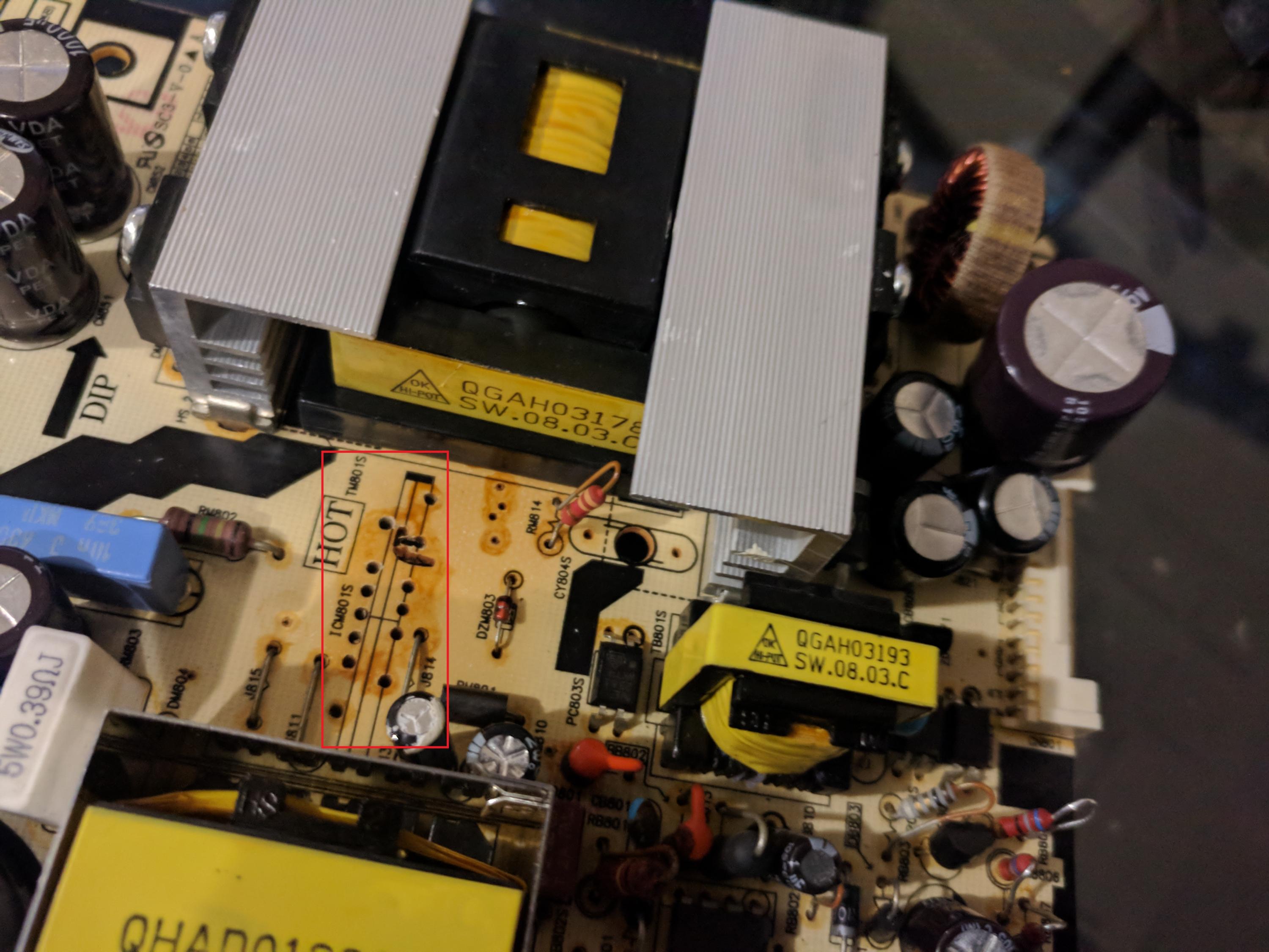

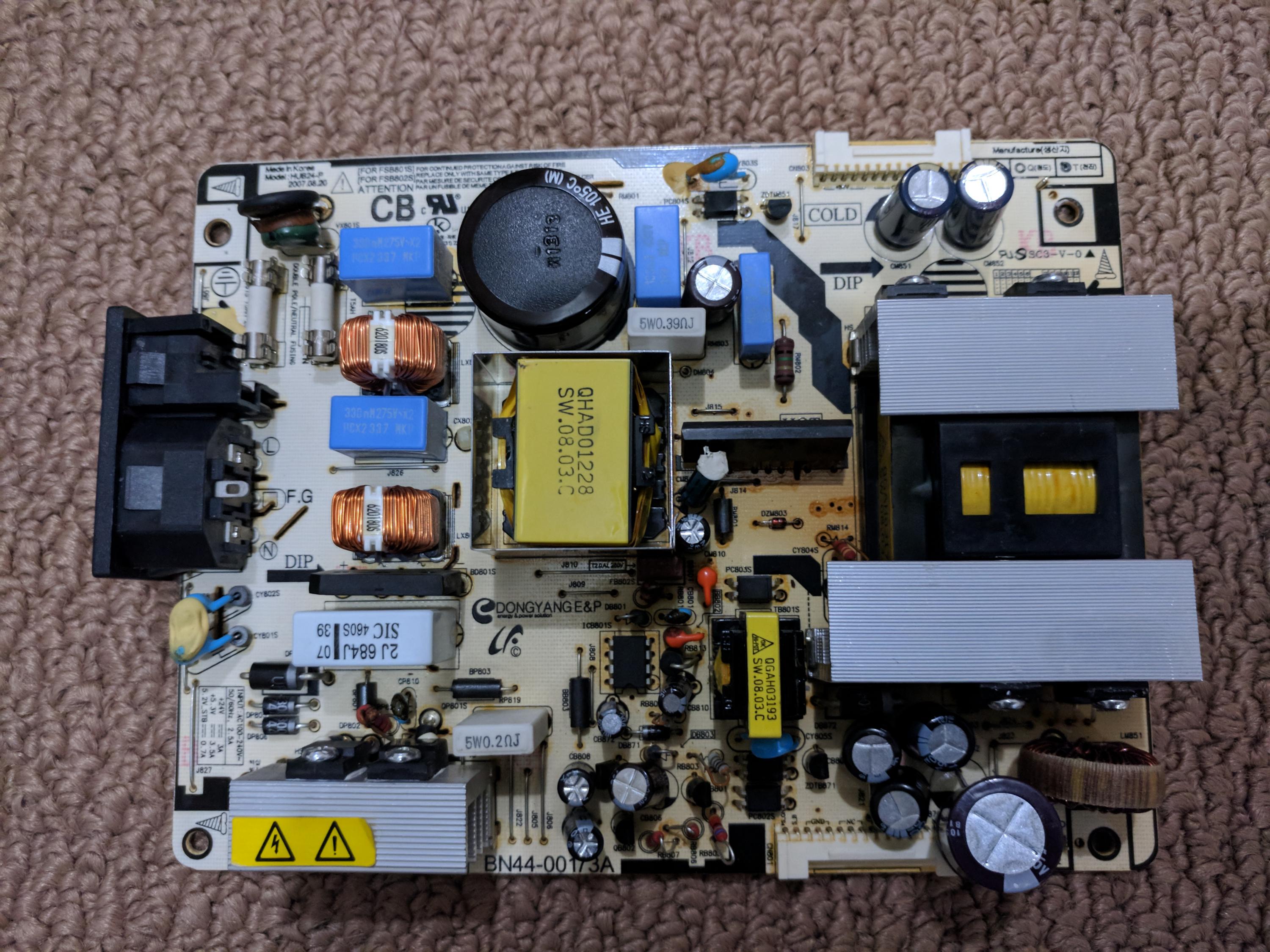

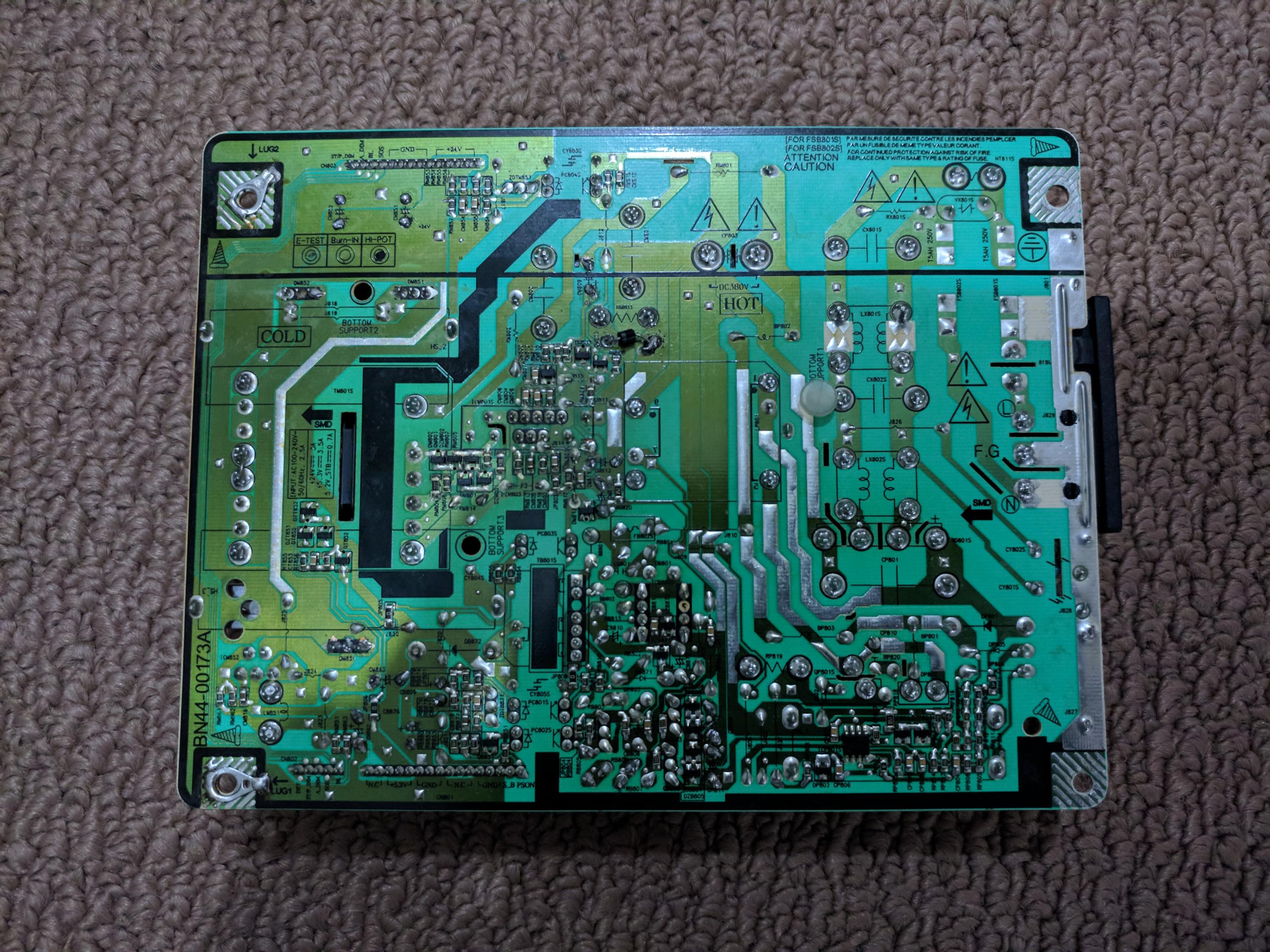

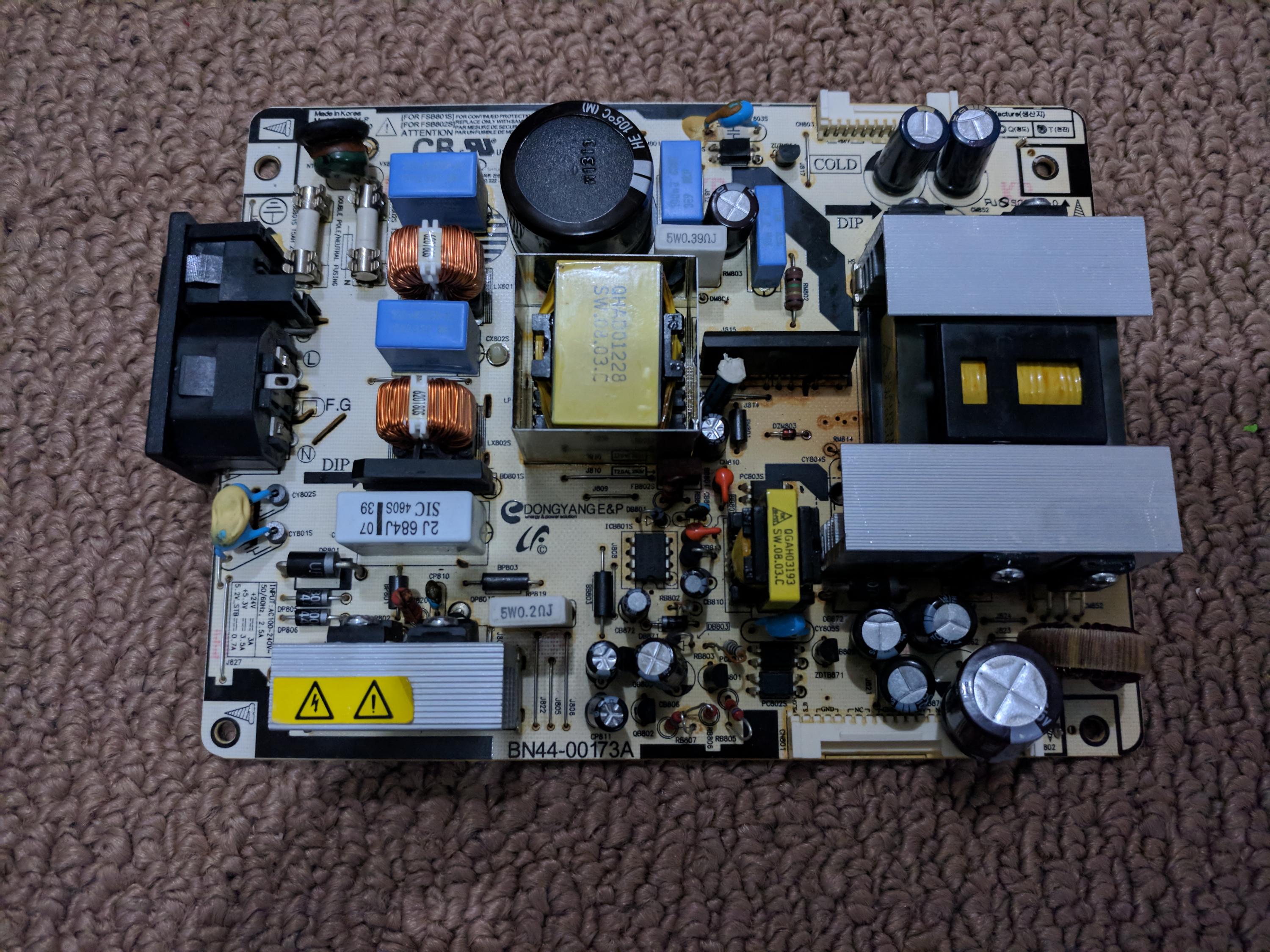

    As the title says. i am having a hard time with this board. I can confirm it is the power board as I have two of these monitors and when I swap the power boards the monitor works.
    I am not a pro with circuit boards by any stretch of the word but I can follow simple instructions well and i have decent knowledge on the use of multimeter and soldering. Please do bare with me when I ask "obvious" questions
    Here are what I have tried so far based on searching this platform.
    1. I have replaced all 3 resistors (RB805 -7)
    2. I have replaced all the capacitors besides the main high voltage capacitor (CP803)
    3. I have checked all 3 fuses and they are all ok
    4. I checked the CP803 for Voltage when plugged in with the main power switch (next to the 110V input in the pack) and I get 168Vdc
    5. I tried to measure the voltage on the connectors (CN801) and ground (I used LUG1 and LUG2). I got 0 Volts on all of them except S_B pin where I got 0.9Vdc.
    6. I also measured the voltage on connector CN803 in a similar way as I did for connector CN801. I got 0 volts on all of the connectors.
    So it seems i do not have 5V and 24V
    I still do not have power not even the power button blue LED.
    Any ides on what I can do next or what could be the problem. I really like the monitor and it will be a shame to toss it.
    Thanks in advance for the help.

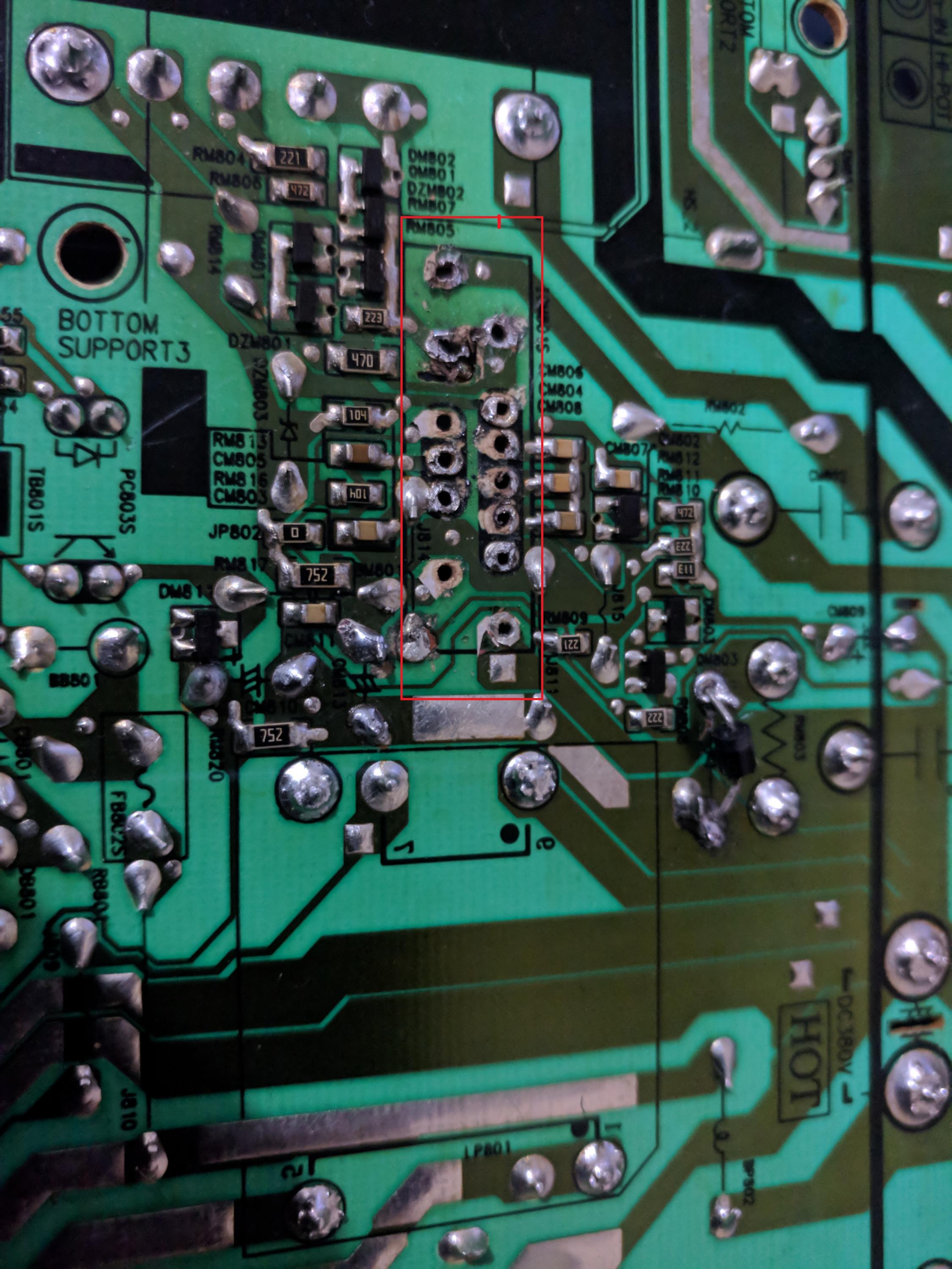

                      I decided to replace the IC ICM801S. Ordered online and will be delivered tomorrow. In preparation decided to desolder the old IC so that all i have to do tomorrow will be just soldering the new one in and assembling.
                      However, it seems where IC located has overheated or something making the location weak (see pictures attached, also visible in the initial pictures I posted) so during desoldering, the connections seems to have lifted and the trace broken/lost (pictures attached). I realized this after the fact unfortunately.
                      As a note, the soldering iron wasn't the cause as the temperature is constant and I have replaced resistors and capacitors on this board with it without issues.
                      Is there a way to salvage the board or repair the lifted/broken areas?

                        Why would you remove that ic? I thought you did NOT have 5 volts standby (S_B5V)? That is ICB801s the small 8 pin ic
                        If this ic (ICB801s) is not working, you will never get ICM801S to turn on. That ic WAS likely good and the circuit board could have been left alone.
                        What did you use to remove the solder? looks like you used one of those desolder pumps that sucks the traces along with the solder, you should use a good quality solder wik. likely the solder iron is way too hot also

                          Originally posted by R_J
                          Why would you remove that ic? I thought you did NOT have 5 volts standby? That is ICB801s the small 8 pin ic
                          I decided to replace that IC through googling and I guess my ignorance.
                          I used a desoldering bulb to remove the solder.
                          found out about solder wik after the damage
                          I will be ordering some soldering supplies just in case I have to this again.
                          The soldering iron is the same one I used to to replace the resistors and capacitors on the board (25W)
                          Hopefully the board is not toast and can be repaired

                            If you are going to google for the answers good luck. Replacing that ic will do nothing if you don't have standby voltage.

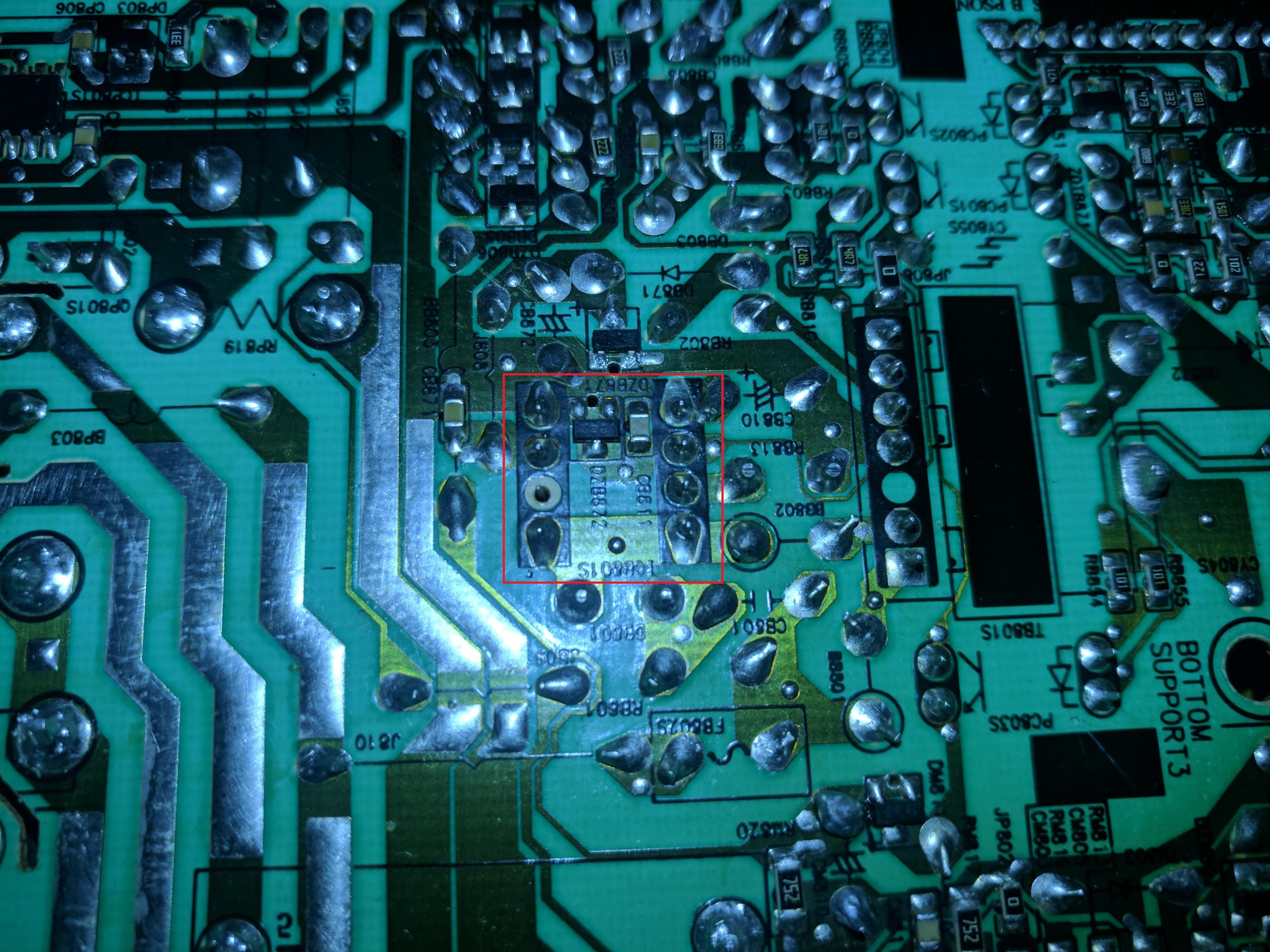

                              After reading your post I rechecked the IC ICB801s and it seems one of the pins is not soldered (picture attached). is this normal or that is a sign of something being wrong?

                                If you look at the schematic I provided, you will see pin #6 NC (No Connection) You can look up (google) the pdf for the ic which is ICE3B0365J, it will explain the pinouts and what they do.
                                If you use hot ground, measure the voltage on pin 5, it should be min 160v DC. Then check the voltage on pin 7, It would read about 10 vdc if the ic is in shutdown mode or around 20 vdc if the ic is working. If that voltage is 0 the ic is likely dead.
                                This circuit NEEDS to work as it gives the 5 volt standby to the main board. AND it supplies the VCC via the 3 resistors and QB803 to the ic (ICM801S) you removed.

                                      Tested the voltage on ICB801s with a hot ground (used -ve on the rectifier). Here are the results
                                      Pin Vdc
                                      1= 0
                                      2= 5.03
                                      3= 0
                                      4= 168
                                      5= 168
                                      6= 0
                                      7= jumping rapidly between 12.4 and 14.8 give or take
                                      8= 0
                                      These tests were done with ICM801S still desoldered I am not sure if that has any effect on the results.

                                        It looks like the ic is trying to start, Are you getting any voltage on the S_B5V line?
                                        A couple things to check would be CB872 (22uf/50v) CB810 (1uf/50v) or maybe the 5 volt filter, cb876 or cb809.
                                        Most likely would be cb872
