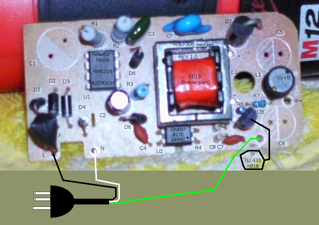

    Here ya go.
    The EGC and "Vo-" go to the same point on the PCB.

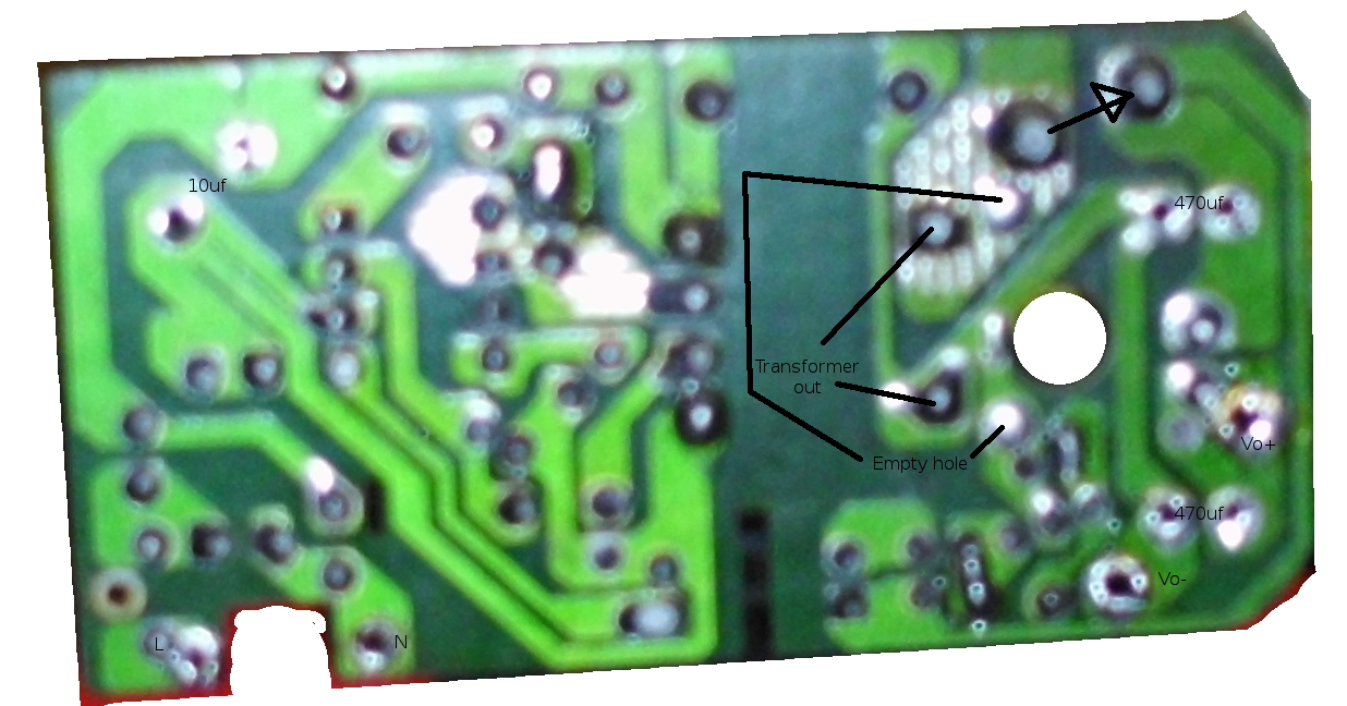

      Well that makes it much simpler, just connect earth ground to dc ground
      Can i use the empty hole labeled - at the lower right of the transformer, that point is connected to Vo- on the bottom of the board and is amount 1cm of track from the transfomer's pin and i could solder jump and be right on it, or does it need to be closer to the caps
      At the bottom there are are two 5% 210 Ohm resistors, it is labeled C8 and C7
      i think C mean cap, so what is going on there?
      both of the tan disk caps are labeled 104
      the green one is labeled 3A222
      i can not read the blue one right now, but line one says JNC and line 2 reads JNT02N (need a magnifying glass to read the diagram/symbols on it)

        Can you please take a photo of the back side of board like you did the front side thanks
        “Can i use the empty hole labeled - at the lower right of the transformer, that point is connected to Vo- on the bottom of the board “
        That depends on what is all going to that pad if just a capacitor or capacitors then I would say maybe because I have seen this done in other power supply before but I would want anyone with more experience than me have the final word on this (if someone comments on this I will start a new post with a photo of some
        One note on switching power supply is that some real cheap one or real low amp power supply
        They do not seem to have a switching power supply IC chip or least I can not find one one the board WHAT is up with that

          Re: I found the bad cap, looking at replacements
          Sorry it is a little blurry, my camera's autofocus is as crappy as those junk 470uf caps
          i flipped to keep the parts in the same relative location on the image and added a few labels to it for reference
          thew middle pin of U3 is connected to ground next to the empty - pin hole
          there is also a resistor there that connects the middle pin to another pin on U3, from there there is one more resistor that connects it to Vo+, i believe this is how the 6206 (U1) monitors the output voltage via the optic isolator or is that vise versa?
          What is the part between the 470uf caps labled L1, by the Vo+ hole called?
            You can use that.
            L1's a small choke, from the + terminal of C5 to + terminal of C6. You have a C-L-C output filter.
