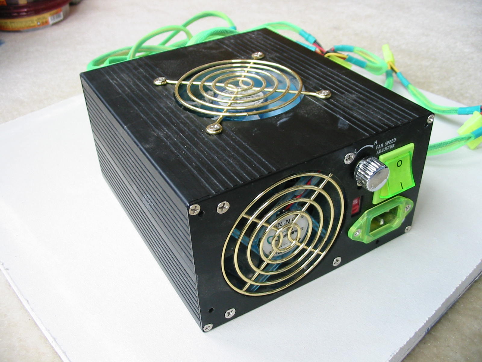

    As usual, first a picture of the PSU's case front and back…
    https://www.badcaps.net/forum/attach...1&d=1508117050
    This PSU features an all-aluminum case, which is one of the reasons I wanted one of these (after all, the case itself was worth the money I paid for it). There are three 80 mm fans: one of the front, one on the back, and one on the top. The top fan also has blue LEDs. Otherwise all fans are re-branded by Aspire and rated for 0.25 Amps.
    Unfortunately, the Aspire PSU I got was not version with the see-through acrylic top. :\ What a bummer, right? … Well, maybe not really, unless you like all kinds of EMI and RFI noises. After all, there is a reason why SMPSs are enclosed in a metal case.

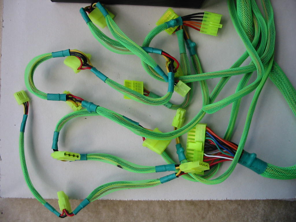

    Next, a shot of the cables.
    As you can see, there are plenty of regular drive Molex cables – eight to be exact. This power supply also provides two floppy cables, two SATA cables, and one Auxiliary power connector (in 2005? WHY?!?!). Main ATX connector is 24-pin, and there is also a 4-pin 12V CPU connector. All output wires are 18 AWG, which is good to see. The only exception is the SATA connectors, which use 20 AWG for whatever odd reason (and of course the floppy connectors – standard 22 AWG).

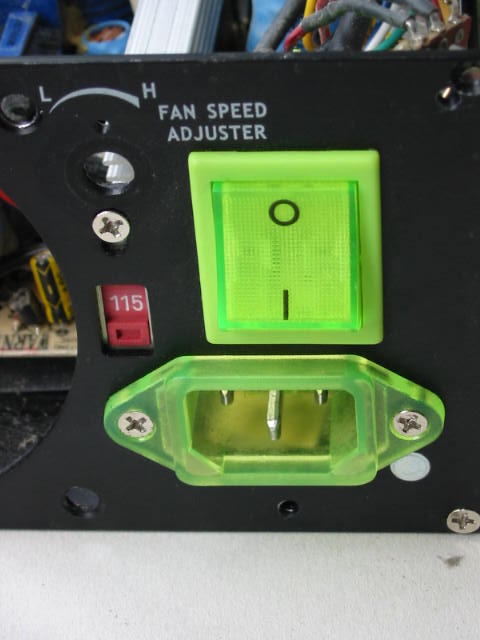

    As I started to disassemble it, I stumbled onto something a little amusing:
    Don’t see it? Okay, I’ll give you a clue: look at the screws holding the voltage selector switch and tell me what you see.
    While talking about that picture, I do want to note that the ON/OFF switch for this PSU is quite nice – it has a very defined switching action when being toggled. I’m thinking if I fix this PSU, I might actually end up installing a white or green LED in it to make it glow when the PSU is plugged in the wall. After all, this is an “all-show” PSU (don’t know about the “go” part yet).

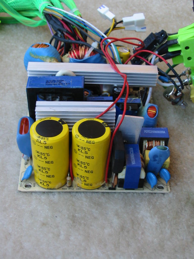

    And here is the PCB itself after a brief de-dusting session:
    https://www.badcaps.net/forum/attach...1&d=1508117721
    Man, look at all those bloaters! I’m sure some of you already spotted that in the first overall shot I posted above, but here it is even more clear. You can also see quite a few darkened spots on the PCB. Whatever this computer was pulled out of sure was NOT in working condition. And I bet the seller knew that. But I knew very well what I was buying, so of course I didn’t hold it against him. For just $1 (shipping ate the rest), I think that’s pretty fair, actually.

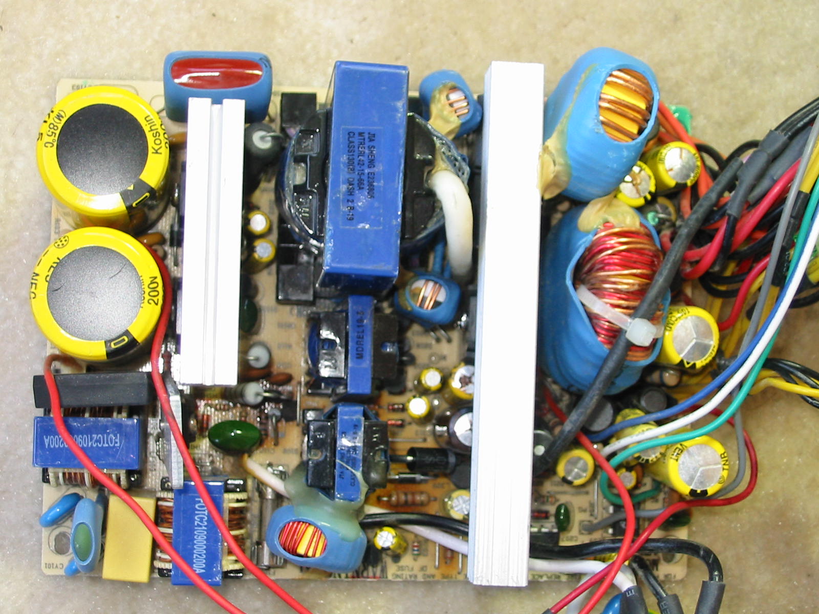

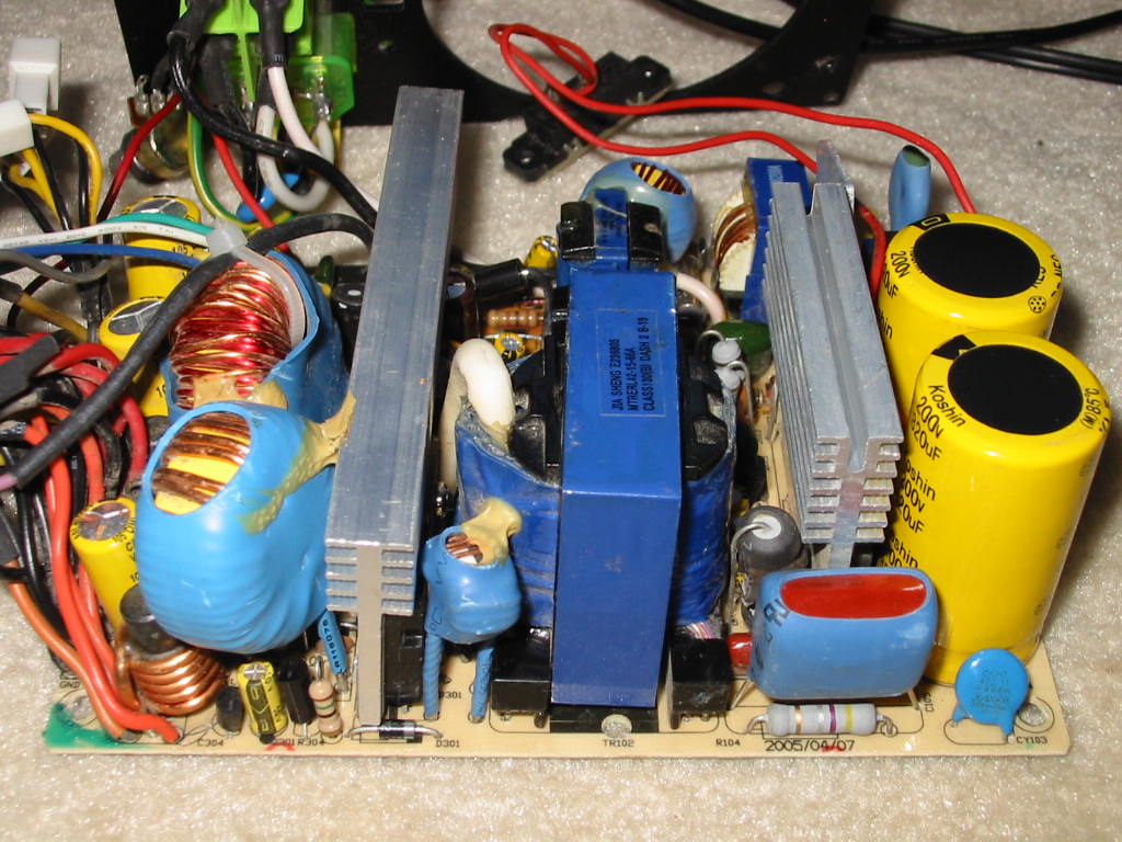

    Moving onto the primary side…
    We have full input filter, big primary caps (820 uF in 25x45 mm cans), a bridge rectifier, and also a big film cap for the half-bridge transformer coupling. The only thing that kind of bothers me is the primary heatsink – it could have been bigger. Mainly, YY could have extended it a few cm to the right by removing that small heatsink for the 5VSB transistor and actually mounting the 5VSB transistor to the (now extended) heatsink. Also, the wires for the selector switch are quite a bit on the thin side, rated for only 300V and 22 AWG.

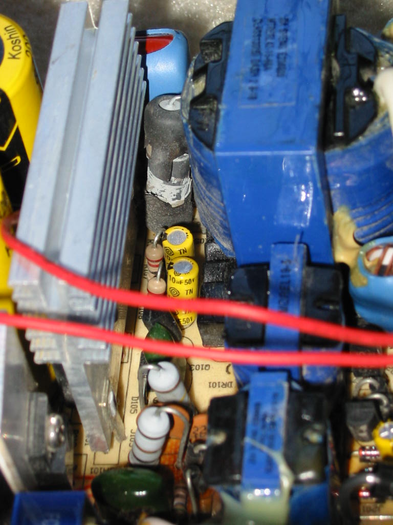

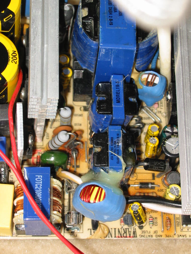

    Here is another interesting shot:
    Hmmm, that snubber resistor does not look very happy. Though its rubber heatshrink cover appears to have broken down along with its ceramic coating, the PCB underneath it does not indicate any signs of overheating. It showed a healthy resistance of 68 Ohms on my multimeter, out of circuit. This snubber resistor is in series with a 4.7 nF, 630V, film capacitor.

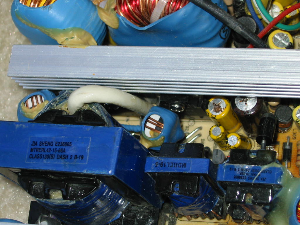

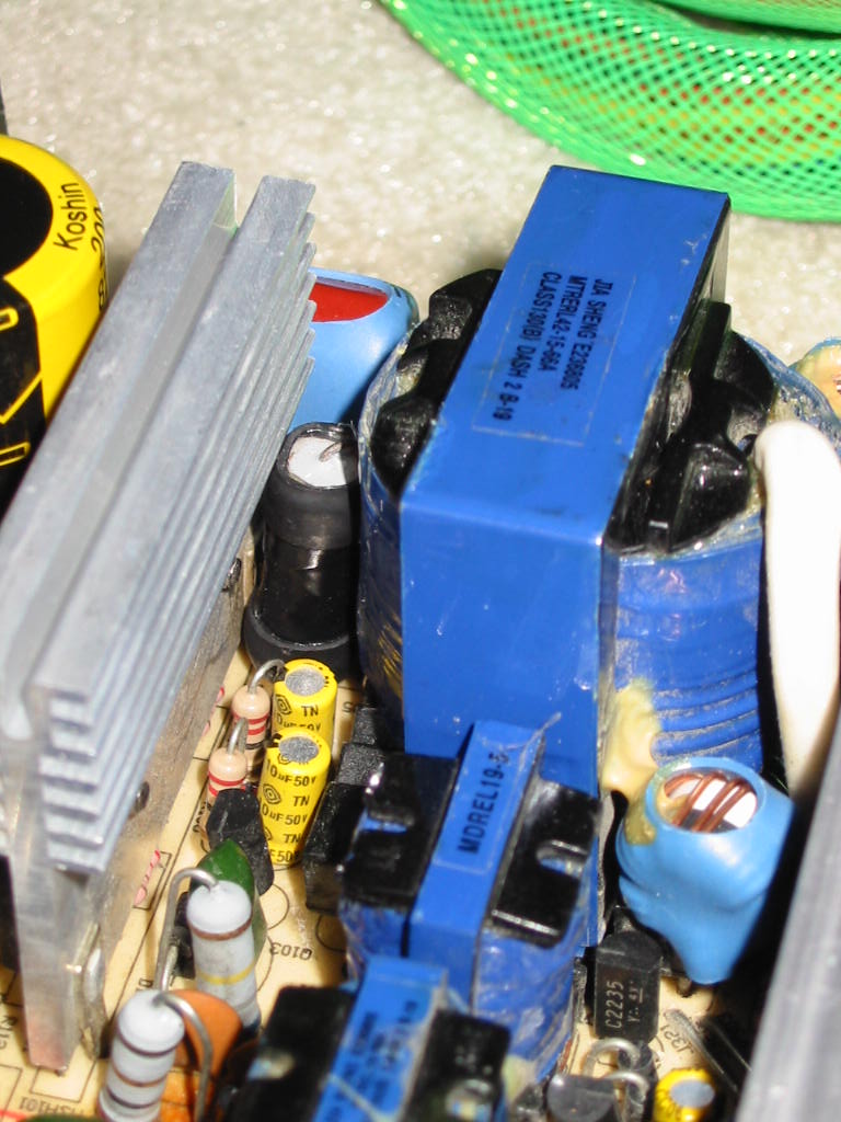

    Next, a shot of the transformer labels before moving to the secondary side:
    The two coils next to the main transformer are both for the 3.3V rail’s mag-amp circuit, so it’s dual-side regulated - which is good (most PSUs usually only regulate on one side). And worth noting is that all of the rectifiers on the secondary heatsink are TO-247 and TO-3P parts.
    And a picture from the front:
    Here you can actually see how big the main transformer and output coils are relative to the primary input caps. In terms of component size, YY definitely didn’t cheap out. It’s really only the bad caps and a few bad design decisions that make this PSU mediocre.

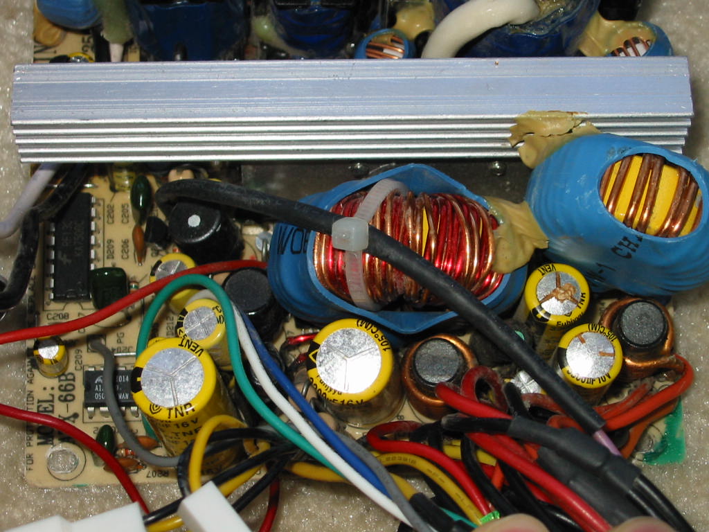

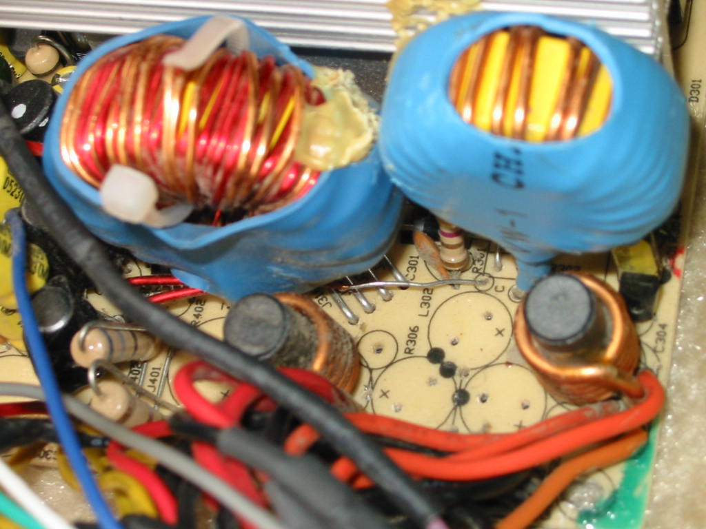

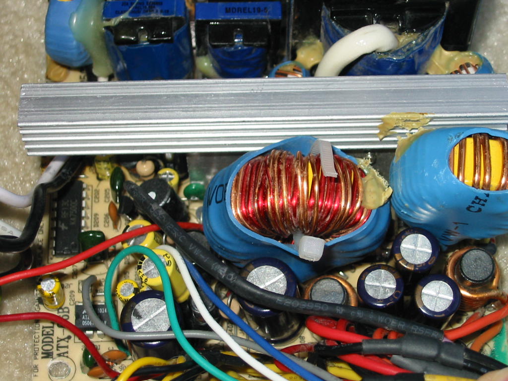

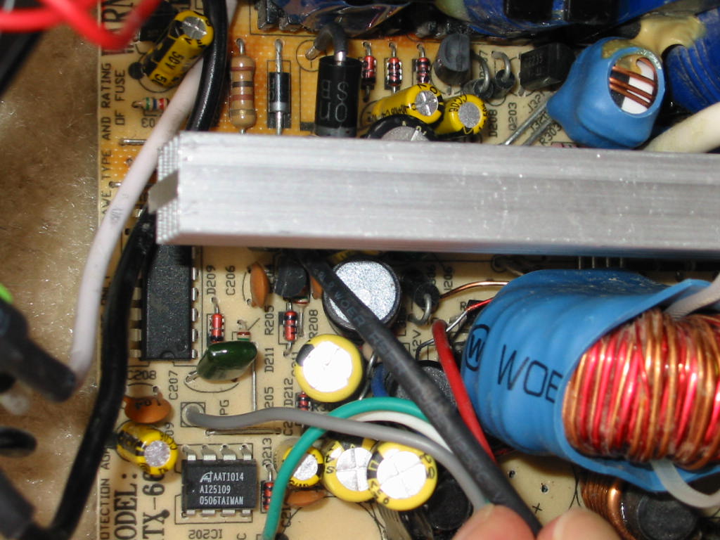

    On that note, let’s see where things go bad:
    Look at that cramped secondary side – it’s a mess! I know the caps are crappy brands (Fuhjyyu, Y.C. and Su’scon) so they probably bloated on their own. But I’m sure the lack of airflow from the mess of wires helped them die faster. To add insult to the injury, YoungYear added a 10-Ohm load resistor on the 5V rail (which translates to a whopping 2.5 Watts of heat there).

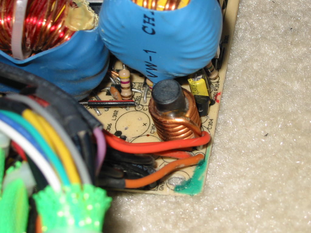

    But it gets better… as in more bad.
    See how that main output toroid inductor is connected with the wires going everywhere and plugging into various spots on the PCB? It’s like the whole thing was a complete after-thought , as if they forgot to include an output inductor in the final design and did it literally seconds before it got sent to the production floor. If I can imagine a sketch for that, it would probably go like this: YoungYeah started the design with the input EMI/RFI filter and dedicated enough space to it. Then they placed the primary side components, again allocating enough space for them. Then the transformers and secondary heatsink… and by the time they got to the output inductors and caps, they realized, oh shit, we totally forgot the PSU needs those. Let’s just shove them here under the output wires. Should be fine!
    At the same time, this PSU has not one, not two, but THREE fans – which are totally unnecessary and take up a lot of valuable space inside the case. What YoungYear really should have done is get rid of all fans (minus the exhaust) and made the PCB bigger, placing the components with more space between them for better airflow. Not to mention this would have probably saved them time and money, as it would be easier for the workers to install the components. You can bet it took a lot of time for someone to fiddle with the output inductor’s wires to get them in the right holes. Not to mention this makes the production even more likely to suffer due to the possibility of the inductor’s wires shorting to something, like they almost did on my unit above. And to top it all off, the 5V and 12V rails have spots on the PCB for only one cap each. However, YY installed two additional small caps on both rails (470 uF each) by having the caps connect with extra-long leads above the other caps.
    Ugh, I need to take a break from typing here. The more I think about all this “design” nonsense, the more my head hurts. I might need a “special” soldering therapy after posting this. (More like snort an entire can of flux to set my head straight. )

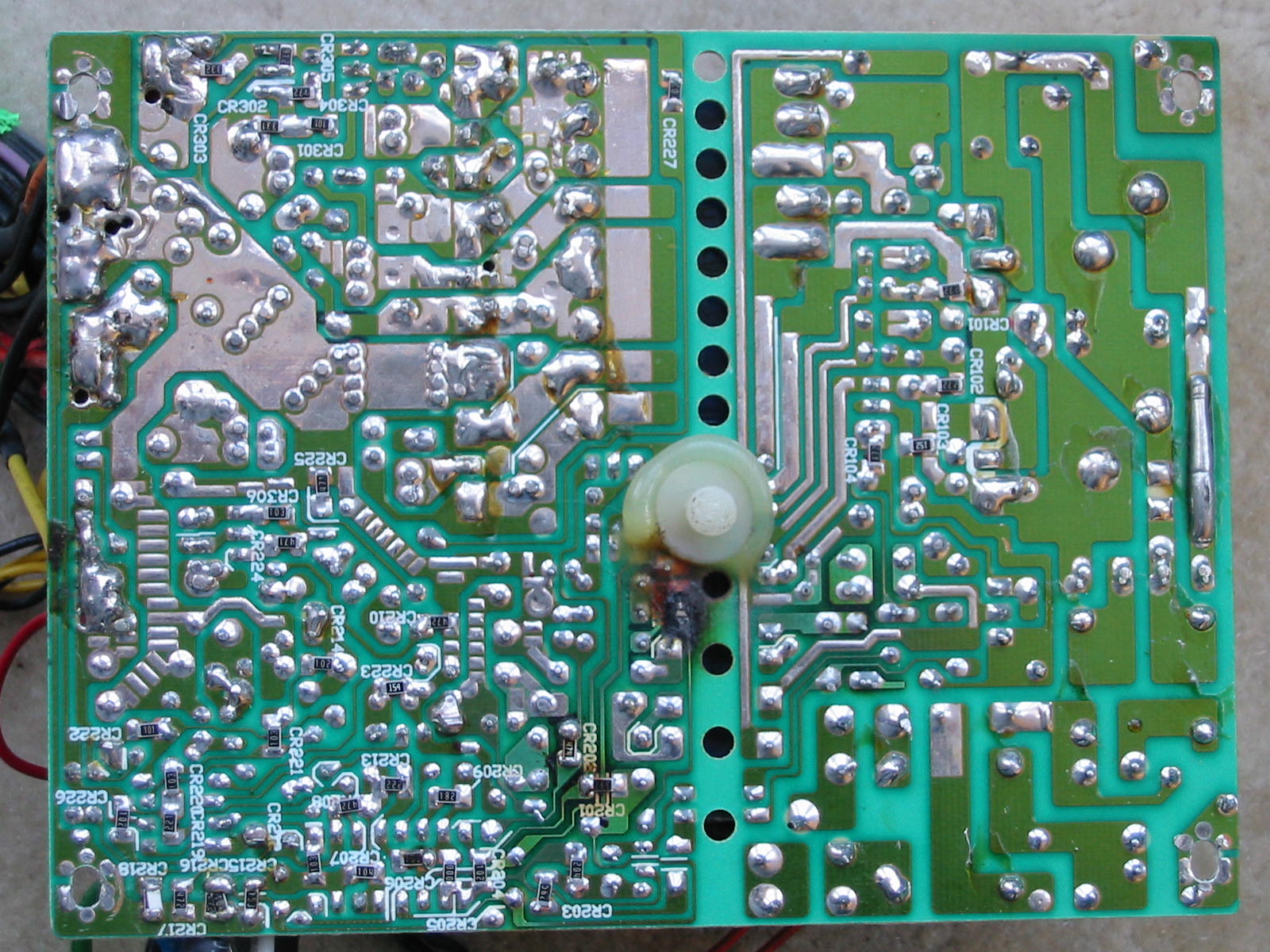

    But before I do that, let me just finish with a few more images. First, a solder-side shot:
    At least the soldering is not too terrible. Might need to fix a few solder blobs (more like solder lakes - look at that trace for one of the primary caps!) and re-align some of the SMD resistors. Some of them barely made it into their targeted spots.

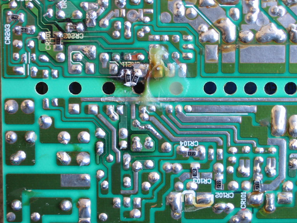

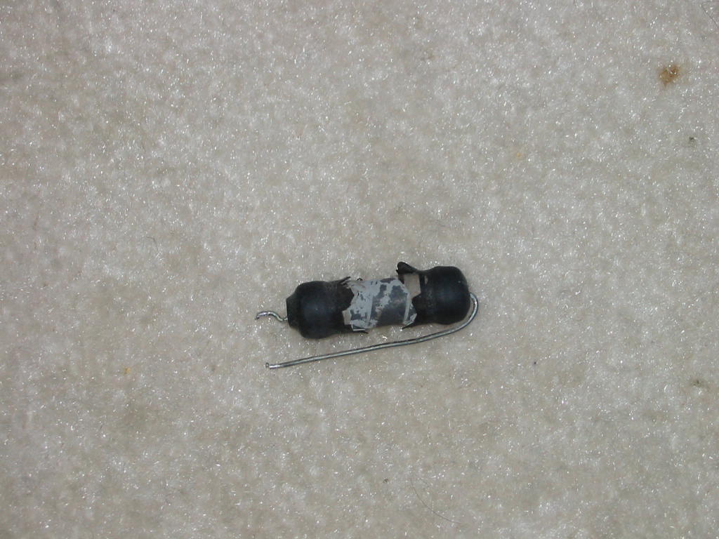

    You can also see there appears to be something that has burned. Let’s investigate…
    https://www.badcaps.net/forum/attach...1&d=1508117846
    Looks like an SMD resistor: CR211.

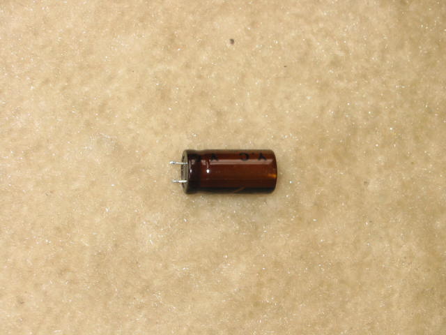

    Of course, all of that damage was probably caused by these bad boys:
    Despite being different brands, all of these caps have yellow sleeves. I suspect they were all custom-ordered by YY for these PSU – particularly the ones with the clear top case. Well, there is only one cap that is brown – but that’s only because that cap got burned to a crisp. Don’t believe me? Here’s some interesting proof:
    See that tiny yellow spot on the right side of its sleeve? That’s where the cap was touching the (much cooler) heatsink, so the sleeve didn’t burn up. Amazing!
    This cap was on the 5VSB output filter, by the way. So if anyone is still wondering why the PCB has so many burned spots, that’s exactly why – 2-transistor 5VSB circuits do NOT like bad output caps.

                                  Apevia / Aspire ATX-AS520W power supply - repairs v1
                                  I forgot to mention that before I did anything to the PSU (other than opening the top upon arrival ), I tried plugging the power supply to the wall (though an incandescent bulb, of course) to see if the 5VSB came up. Guess what? It did – and that was with those horribly blown Y.C. caps . BUT! The PSU was not a happy camper for sure – the 5VSB squealed for a few moments before settling into “regulation” at around 4V with *no load*, meanwhile the PSU was drawing a whooping 8 Watts from the wall. At the same time, the secondary auxiliary rail was sitting at 26.5 Volts (which is technically still well within the KA7500’s Vcc range, but a bit high for unloaded 5VSB from what I am use to seeing.)
                                  So, the first thing I did: recap the 5VSB to see if I could get it to output a healthy 5V. Out went the Y.C. caps and in went… United Chemicon KZJ (16V, 1500 uF) and Teapo SC (6.3V, 1000 uF).
                                  https://www.badcaps.net/forum/attach...1&d=1508342847
                                  Okay, I know those aren’t exactly ideal choices, and both were board pulls (with the Teapo SC coming from HP DC5000 PCs that had many of those blown – though the one I used measured “reasonably” good ESR ). After the recap, I hooked the PSU again to my incandescent bulb setup and plugged it in. Result: proper 5V on the 5VSB and no squealing. Also as I expected, the secondary auxiliary rail dropped a bit – to 23.5V. First I tried putting a 0.3A load on the 5VSB, and all went well. The sec. aux. rose only to about 24V, which is good. Then I tried a 1A load. Unfortunately this time, I got only 3.75V out of the 5VSB, and it was squealing like mad at me (but regulation was stable). Very strange, I thought. Then it crossed my mind that the incandescent bulb I had in series with the live line was only rated for 40W. Having no mercy, I swapped it for a 100W bulb and tried it again, expecting something to cook or smoke. But nope – 5VSB came back up to 5V again, no fuss. And aux. sec. came out at 26V with this load, which is alright again. For repeatability, I swapped the bulb one more time back with the 40W. As expected, the 5VSB was back to 3.75V. So conclusion: it seems the 5VSB of this PSU does *not* like low line voltages.
                                  Next item on the list: the snubber resistor on the primary – the broken heat shrink was such an eyesore to look at!
                                  I cleaned it well with IPA, wrapped it with a few layers of electrical tape, and added some heatshrink tubing only at the edges where it is closest to the primary heatsink. Then I soldered it back in – it barely fit. The result:
                                  Speaking of burned resistors, remember this one?
                                  https://www.badcaps.net/forum/attach...2&d=1508117846
                                  I found a picture of a similar Aspire PSU (not exactly the same model/layout), and R211 was 1.5 kOhms, if I remember correctly. While I do have 1.5 KOhm SMD resistors of that size from some broken CRT TV boards, I decided to do something different (as usual). Hint: it is a bit
                                  Yup, those are two 1-kOhm SMD resistors in series. I figured since the original resistor burned, higher resistance with two series resistors should avoid that, because they can dissipate more heat. Of course, this comes with the risk of making some circuit not work. But from what I remember tracing, R211 provides current to the BJT drive circuit on the secondary side. Thus, if the resistance was too high, the main power supply would just not work when requested to turn ON.
                                  The last step was to install some new caps and test the PSU. But before doing that, I thought now would be a good time to fix this:
                                  There! No more bare wire running between random components and nearly touching their leads. It was a pain too, as I did this without removing the whole output inductor (used tweezers and pliers to slip that insulation on the wire).
                                  And finally, the caps:
                                  Out went the yellow caps and in went the dark blue caps. Oh wait, did I say dark blue caps? What replacement caps in the world did I just use? Rubycon MBZ?
                                  –Nah, those don’t have “X”-type vents. So what then, OST RLX?
                                  –Nope.
                                  Before I tell you, take a deep breath.
                                  I *re*-used ….. wait for it………. GSC caps. Yes folks, I’ll say that again – I re-used GSC caps. They are all ME series that came from my Jetway N2PAP-LITEmotherboard. To save you all the reading in that thread – yes, many of these caps were starting to go (electrically) leaky and registering higher than normal capacitance. But they passed my “spark” test – i.e. charging them up to maximum voltage and discharging on a metal object, observing for sparks. This method works on larger caps and will reveal if a bad leaky cap is fooling an ESR meter to show good ESR and capacitance when the cap is dead. Thus, for a temporary recap, I figured these would do. After all, I had no idea if the PSU was going to nuke itself, so I figured it wasn’t worth using brand new parts. The caps I used were:
                                  2x GSC ME, 16 V, 2200 uF, 12.5 mm dia. (one for the 12V rail and one for the 5V rail)
                                  3x GSC ME, 6.3 V, 1500 uF, 10 mm dia (two for the 3.3V rail and one for the 5V rail)
                                  The -12V and -5V rails were left alone with their Su’scon caps back on duty, as they registered good ESR and capacitance *and* passed my spark test.
                                  After all this mad business, I connected the power supply to the wall with the 100W bulb in series with the line again and plugged it in. Bulb barely flashed, then pretty much went dark. The 5VSB came up and nothing smoked. My new replacement resistors in place of R211 also remained cool. So then came the moment of truth: with a 12V 20W Halogen bulb on the 5V rail (1A of current draw) and a 12V 10W car bulb on the 12V rail (about 0.8A of current draw) I jumpered the PS_ON signal to ground, getting ready for something to smoke. The two load bulbs lit up as the 5V and 12V rail voltages came up for about a second. Then the 100W series bulb became dim and OFF went the PSU. I tried it a few more times, and same thing.
                                  Then it occurred to me that I’ve seen this before with a series light bulb – it usually means the voltage input to the PSU is getting too low and so the PSU cuts out. I measured it, and sure enough, the input voltage was dropping below 90V. Thus, I swapped the 100W incandescent bulb for a 450 Watt heating element. This time, WE HAD SUCCESS! All voltages came up normal and stayed that way. I tested the PSU for about 5 minutes and then unplugged it. The PSU remained working for almost an entire second with this load before shutting down, so the hold-up time looks okay. I then started checking for hot parts. Needless to say, I didn’t find any. The “hottest” part perhaps was that snubber resistor on the primary side, and by hottest, I mean just a little warm. Not burning or anything like that.
                                  So folks, I think this PSU is going to be saved after all. It may not be the best, but I am going to put more work into fixing up some of its problems – that means giving it better caps too (well, I don’t know if it’s worth new Japanese caps, but it definitely deserves better than GSC). Until that happens, this is all the updates I have.
