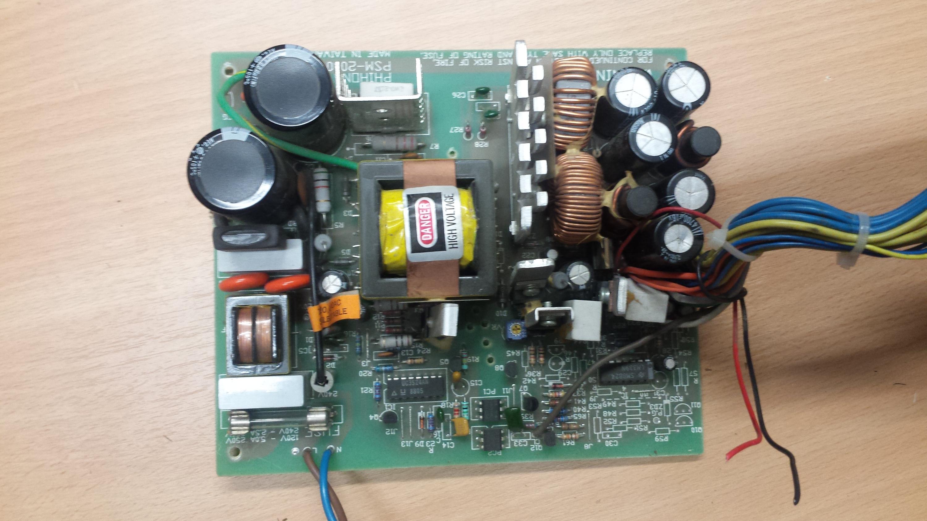

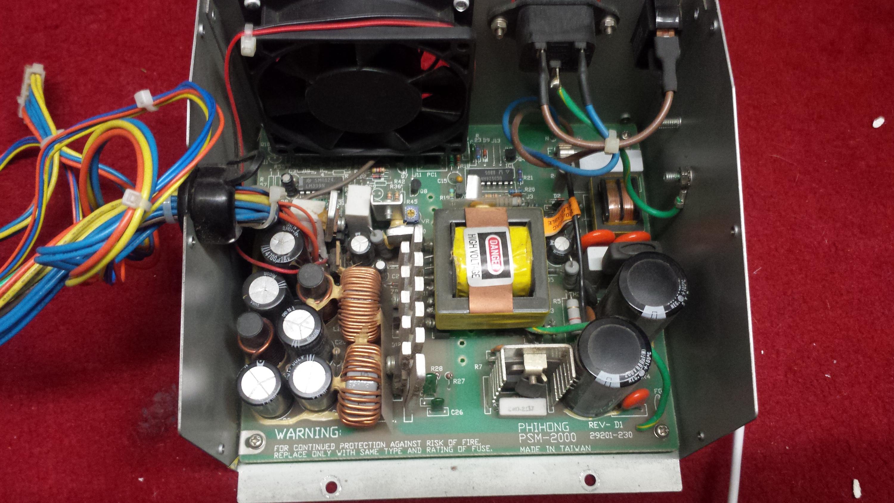

    Cant believe my luck recently as everything I seem to touch goes wrong and this is the latest. I just spent the last few days making some other small repairs to the computer like reseating chips etc due to system instabilities and got it all working perfect. Turned it off, built it all back up and then when I turn it on the Power supply just when "Tick Tick Tick" and the fan jerked. I took it apart and nothing looked bad inside so I plugged in a PSU tester and powered it up again to see where the ticking sound seems to be coming from a Philips BUW13A (Silicon diffused power transistor) and I also accidentally touched its heatsink and it shocked me which I am sure its not meat to do either. So is it possible this is what has failed.
    some pics attached.

    live heatsinks arent unusual.
    your tick sounds like a startup capacitor or an output short.
    given it's lasted atleast 20 years, i'd replace the caps anyway.

      Re: Amiga 2000 Power supply suddently stopped working
      That's interesting. Don't think its a short as I've tested it out of the Amiga and it even ticks with nothing connected unless there is a short somewhere in the PSU itself caused by a failed component or is that what you meant. Are the two big caps in the picture the startup caps? Yes it might be worth replacing all the caps now after all these years right enough. I've got another Amiga 2000 but its PSU failed years ago too and its a older model 2000 anyway. Had this computer from new and its got all the kit like PC-XT bridgeboard 5.25" & 2 x 3.5" floppies plus Amiga hard drive and PC-XT Hard card. So really want this one fixed back up again its kinda special to me..
        i did mean a short in the psu - usually an output diode.
        startup caps are small ones - often 10-47uf.
        you find them near the controller chip - in this case, ic1
          change the small lytic near the orange tag.
              If I read the date code on the LM339 correctly, that PSU was built in late 1988 or so. You should regard all the electrolytic caps, possibly excepting the two big Rubycon I/P caps, as suspect. The O/P caps are "Nicon" brand, which I've not heard of.
              Usually I'd expect a PSU with a single switch transistor like that to be a discontinuous flyback, but I'm pretty sure it is not. First, there are two large O/P inductors. In a flyback the transformer primary serves as the inductor. Second, discontinuous flyback designs of that era were usually self-oscillating, and that PSU has a UC3524A PWM IC. I've not seen a 3524-type PWM since the late 80s. The SG3524 was, I think, the very first PWM IC, introduced, I think, in 1976. The "A" is an improved version. The TL494 and clones have surpassed it in low-end voltage mode switching power supplies. Anyway, the UC3524A has an internal oscillator. The vendor, Unitrode, was bought by TI in the 1990s, IIRC.
              Re your immediate problem, that cap kc8 pointed out is a key suspect. I don't think that PSU will start up if its capacitance is way low or its ESR is way high. Checking for shorts in the output circuit, as stj suggested, would also be a good idea. It may be a slim chance, but Phihong has an office in Fremont, CA. You might try emailing them, usasales at phihongusa.com. Or maybe their Netherlands office, sales at phihongeu.com. I do know they have a design and a tech support group at their Fremont office.

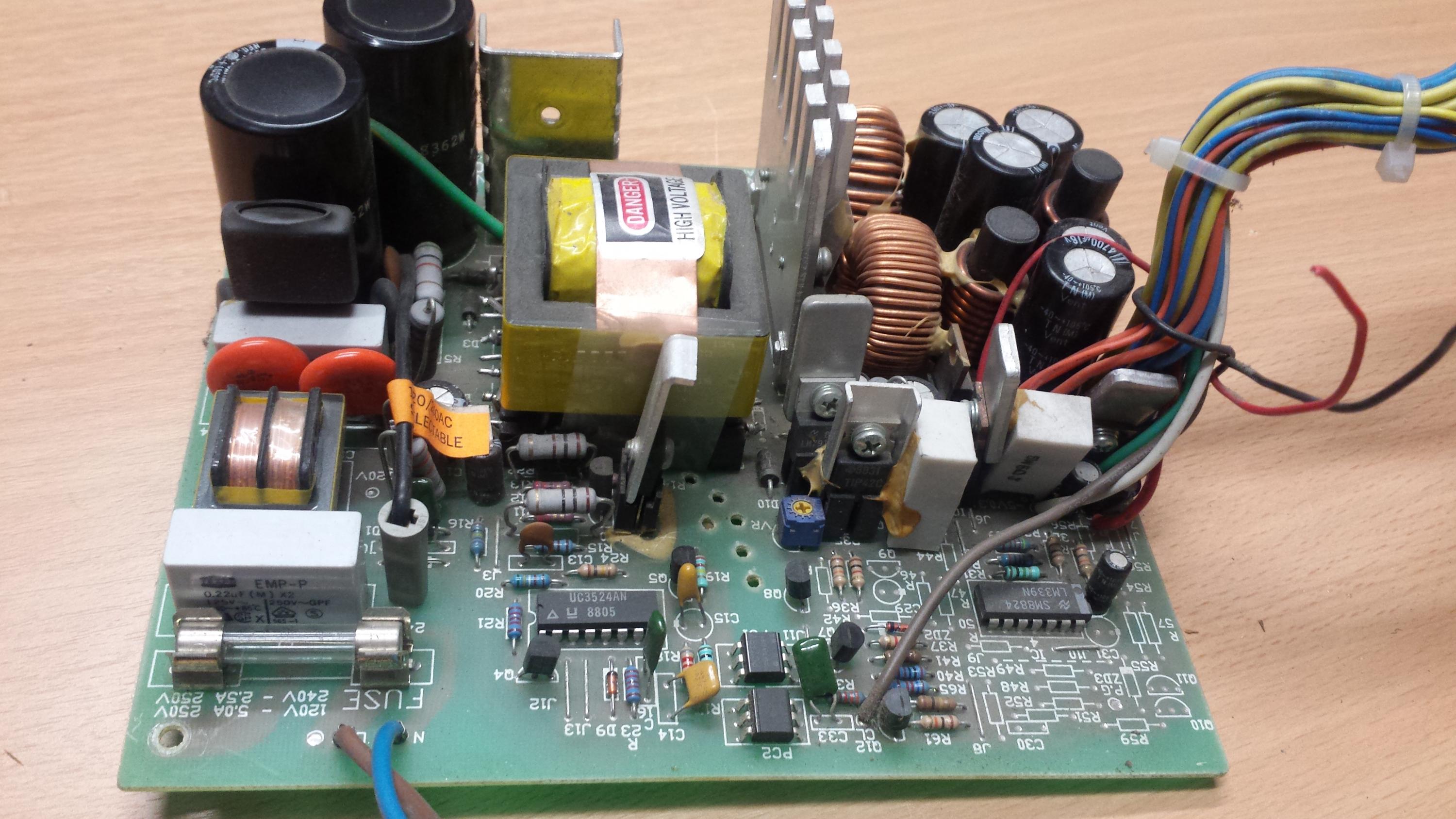

                  Wow I wish I had all your knowledge about PSU's. Motorcycles are my speciality but some PSU repair knowledge would come in handy too keeping all my vintage computers working. I've attached another couple of images for you to see now I have it out of its enclosure. I have another Amiga like this one but it has a different PSU and it went a few years back so will be fixing that one next and you will be able to see what they did with that earlier version. Apart from the 100uf 35v cap near the label is there anything else I should check. Is there some voltage readings etc at certain parts I can take that will lead us to the area of the fault.
                    to be blunt, given the age i would be replacing every cap other than the mains filters before i even test it.
                    if you want to learn something, download the datasheet for the controller chip - they usually have example circuits and descriptions of how it all works.
                    infact a lot of simple psu's and amplifiers are just clones of the example in the datasheet.
                      The ancient 1976 Silicon General datasheet for the SG3524 was very informative, and it did have a sample design. TI's datasheet for the UC3524 looks pretty helpful, a bit more so than for the UC3524A.
                      That being built in 1988 or 1989, I'd suggest using older series parts from Nichicon or Nippon (or United) Chemi-Con - PS or PM series from Nichicon or LXV series from NCC/UCC for the output caps. Modern parts can be "too good" and cause stability problems. The series I named are similar to what was available when that PSU was designed and built.

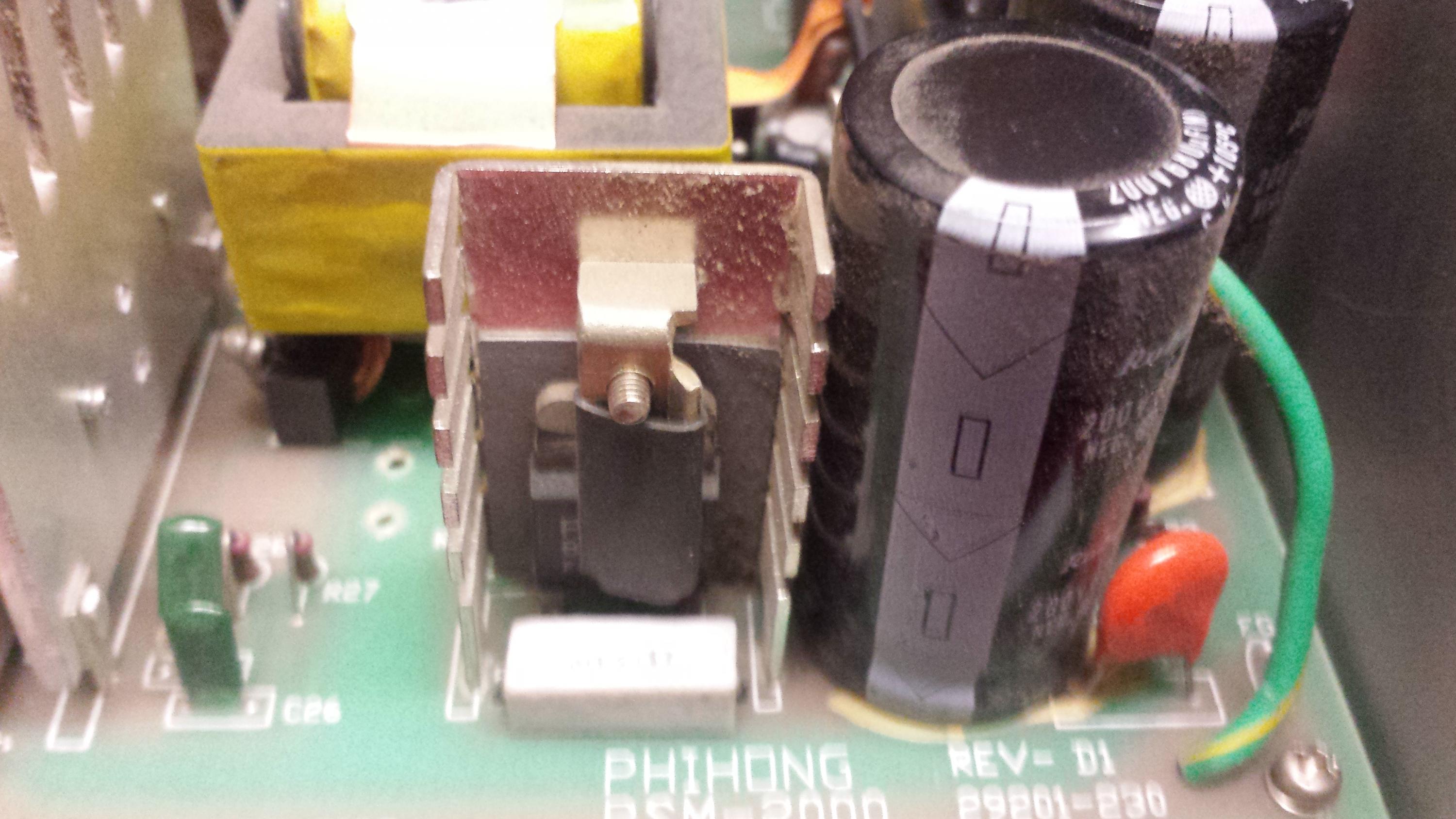

                        I see a dent on the top of 4700uF 16V cap and a couple TO-220 parts near it looked baked like they've run hot. You might be drawing too much from this PSU with all those addons. I would look there first, for a shorted semi.
                        It's very close to an IBM-PC power supply, with a special "TICK" signal which is probably AC line pulses. Electrotanya has motherboard schematics but no PSU schematic.
                        When working on this, be careful you don't bump parts into touching each other. There are many parts close to each other with no insulation.
