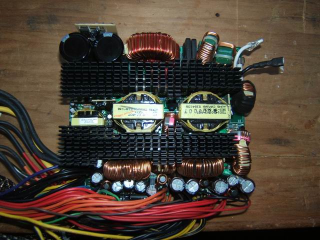

    Enermax Galaxy 1000W dead :(
    Any info regarding this type of unit that can aid me in the repair process?
    Any input is much appriciated.
    The 5V std by is in "hick up" mode... but there is no short to ground.
    An external 5V does not correct the problem, maybe it needs an external -12V also. I'm not sure what part of the unit generates the -12V.

    Re: Enermax Galaxy 1000W dead
    power supply is crowbarring, there is a short somewhere. probably a diode.
        If the +5Vsb is squegging, then the auxiliary flyback controller is seeing a short somewhere. Since this also supplies the Vcc for the main PWM controller, it's possible that there's a short or a blown controller. Check all the caps on both the secondary and primary of the auxiliary flyback. Check the flyback rectifiers on both sides as well - they're sometimes rated for only 1A (FR107 or similar) on the secondary, when it would help to have a 2 or 3A rated rectifier there (the silkscreen will usually have space for a 3A rectifier).
