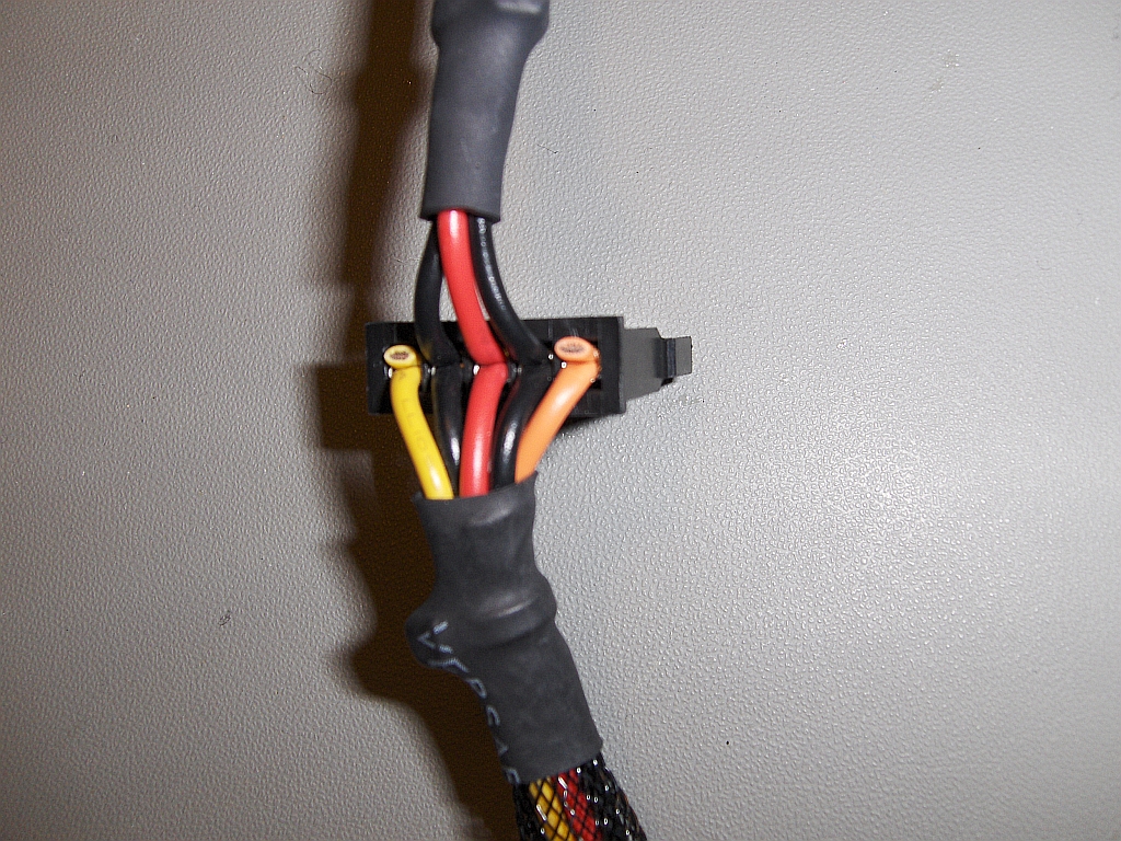

    For a project I'm modifying a sata powercable for use with 2.5" ssd only so I removed 3.3V and 12V cable to only to keep 5V and ground.
    Does it matter which of the two ground cables I keep ?

      Re: Sata power cable

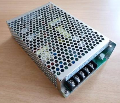

      Yes the ssd's would still work but I'm using a meanwell supply with 5V output so I removed the extra cables I don't need.
      After googling this I found out it's best to keep the ground cable next to the yellow 12V wire, the drive will always power on and not wait until spoken to.
      From wikipedia
      If pulled down at the connector (as it is on most cable-style SATA power connectors), the drive spins up as soon as power is applied. If left floating, the drive waits until it is spoken to. This prevents many drives from spinning up simultaneously, which might draw too much power.
