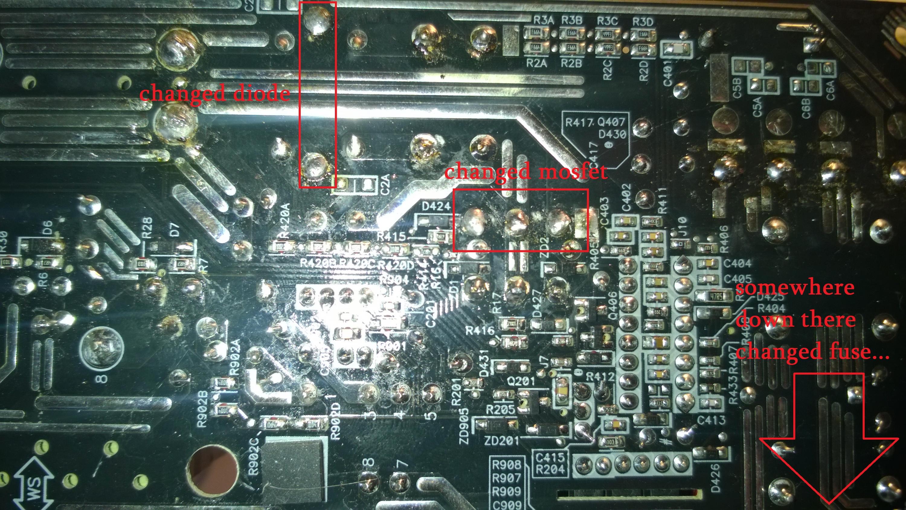

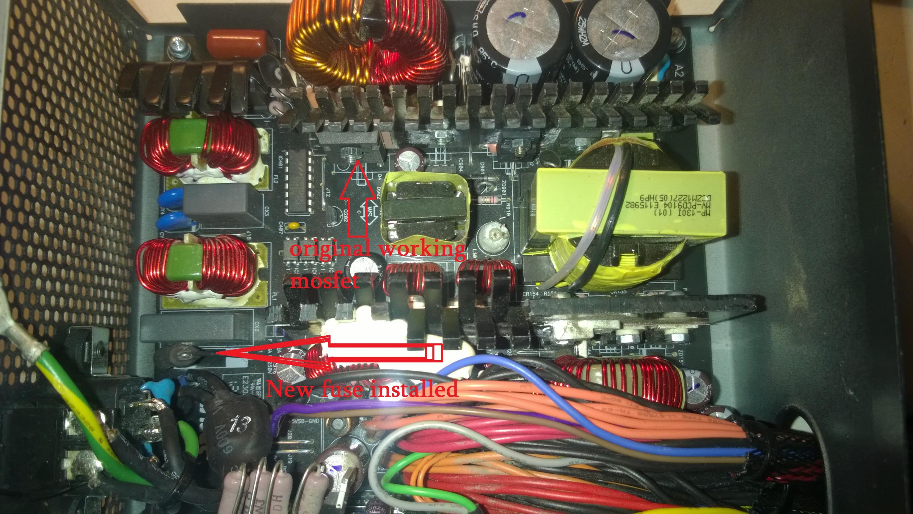

    Several days ago I got just dead "Antec High current Gamer 750w (HCG-750)"
    disassembled it, and first what I found out, was blown fuse, as we all know fuse doesnt die by itself, so i just changed fuse to new one, and powered psu from "UPS surge",turned psu switch on, BEEEEP!....UPS light indicator says "OVERLOAD",well we have short circuit here....

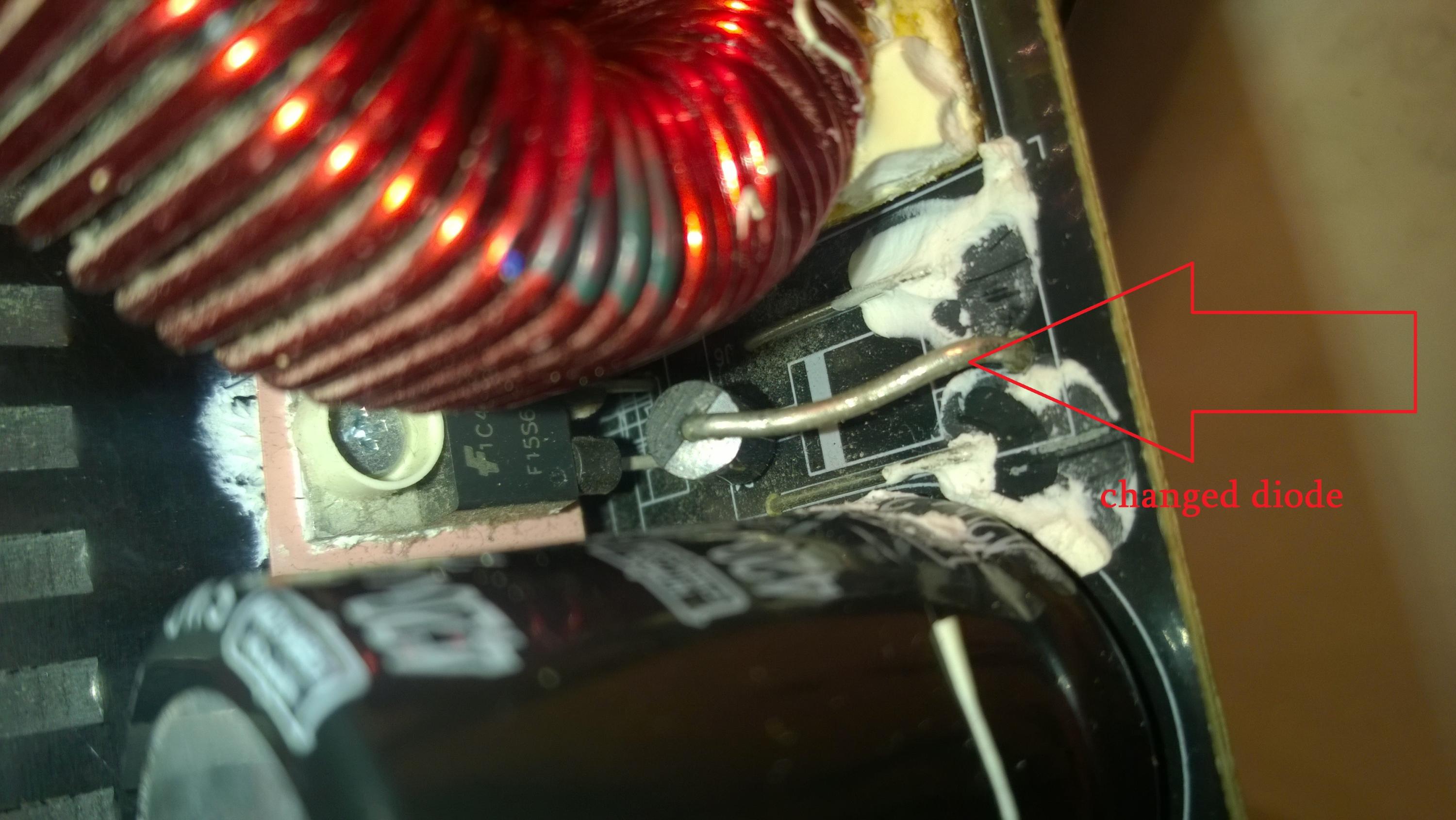

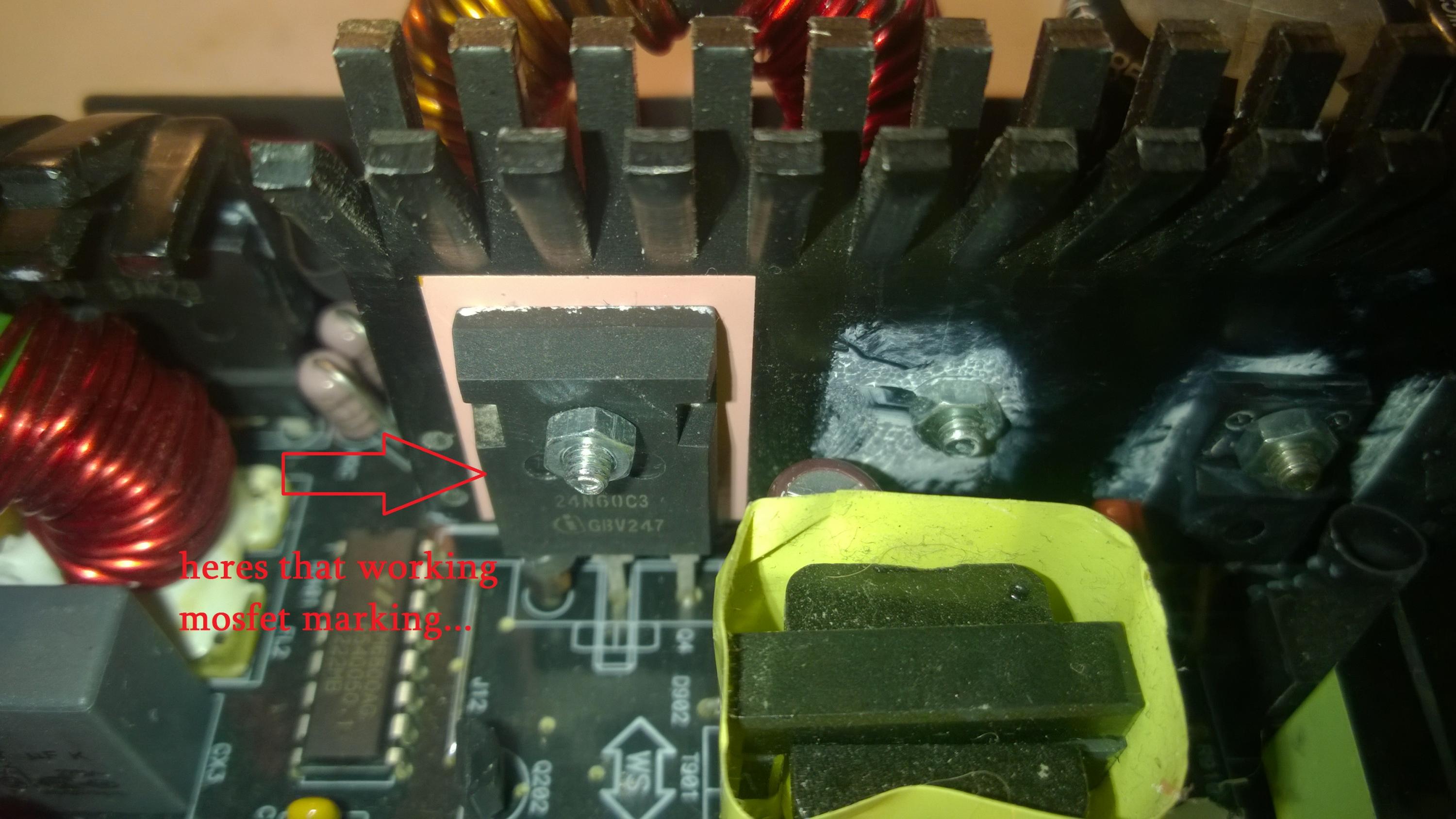

    long story short:except bad fuse, I found dead Diode(no outter damage, like burned spots, etc...) and one bad MOSFET(again no outter damage).
    I had several scrap psus (all from 600w to 1200w (thermaltake,PC P&C silencer, rocketfish,Tagan etc..)) so I took exact same diode from Rocketfish 750w soldered it onto antec, then found similar mosfet on rocketfish, desoldered it and appears it's 20n60c3, but we need 24n60c3 ... well, so i just took 20n60c3 and soldered onto antek psu, assembled everything, turned on, whoa ! it works , tested only 12v and 5v rails, they were 12.4v and 5.2v.... BUT ! here is a problem , first everything worked well , then pc suddenly shutted down, turned pc on again, and i hear that HDD sometimes loses power and computer reboots by itself...
    several days ago ran Everest Stability test, it was passing ok for about 4-5 hours, then I just opened chrome, and pc shuts down...
    Question : any idea whats going on? is that mosfets fault ?

    Is the Pfc bus voltage working ? The mosfet changed and the diode are for the Pfc.
