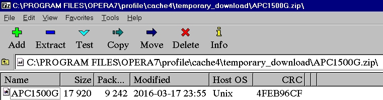

          How is it that the BIN is so much larger than 16K?

            I just checked the file on my system and it shows 16k, both the original and after I unzipped it. The zipped file shows 9k. Is that what you see?

              Re: apc SUA1500 Repair
              The ZIP contains a single file named APC1500G (17920 bytes). This file encapsulates the APC1500G.BIN OTPROM dump (16384 bytes) within a 0x200 byte header and 0x400 byte footer (padded with zeros).

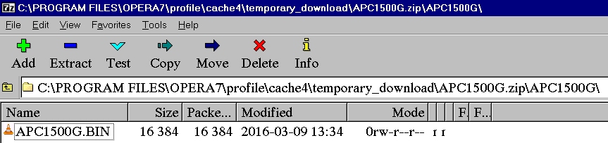

                  I use 7-Zip.
                  The first screenshot shows the 17920 byte APC1500G file. Double-clicking this file produces the second screenshot which shows your 16384 byte APC1500G.BIN file.
                  If I extract the first file and examine it in a hex editor, it looks like this:

                  ISTM that your software encloses the 16KiB ROM dump in some kind of wrapper. This wrapper is what confused me.
                    The ZIP file is in fact an tar.gz archive... and the file owners name is "mjstefl". Its a good dump rev .3, probably GEN3.6. This is to my knowledge the last generation where schematics are available. The newer GEN4 has slightly different hardware, i found that the Chip select between the ADC and 93C56 eeprom is using only pin (I think) P3.7 and unfortunately the CPU goes to the CS of the ADC and the eeprom CS is connected directly to a inverter output. So I had to solder the memory out because it was impossible to read in circuit. But from two units i had enormous luck and can provide the dump for GEN4 REV13 CPU. Its a NXP P87C51FB-4A. I soldered a socket and tried a replacement CPU AT89C51RB2, which can be programmed by FLIP over UART. Just disable the bootloader bit. I hope it will help you and there is a lot of new commands in the PROG mode. Its a lot of code, but you can freely analyze it. This dump is 100% correct, the same one found on russian sites is bad.
