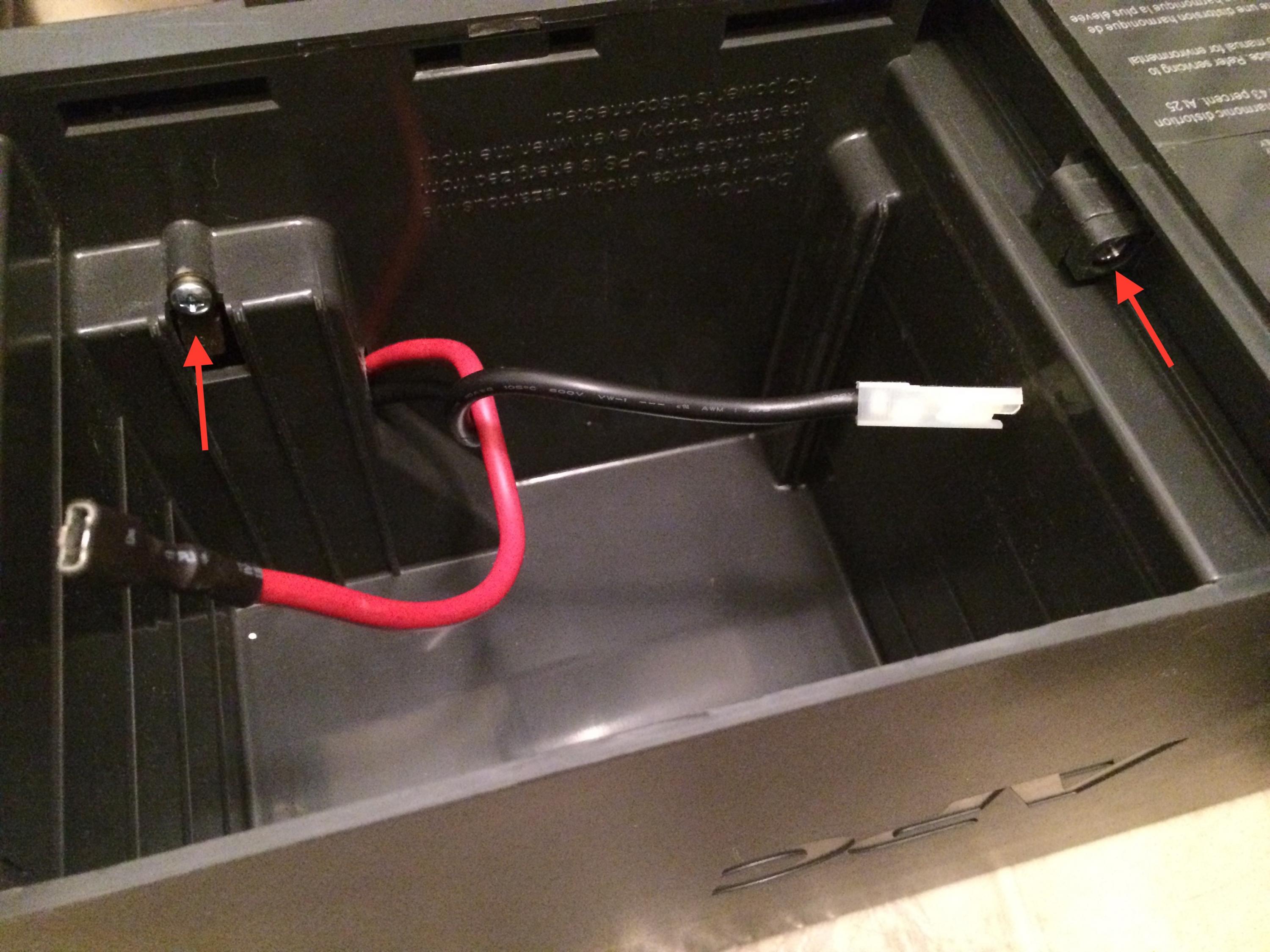

    Knowing that if I left this UPS to drain the battery, I could damage the battery permanently, so I shut it down, removed all attached equipment, and removed the battery.

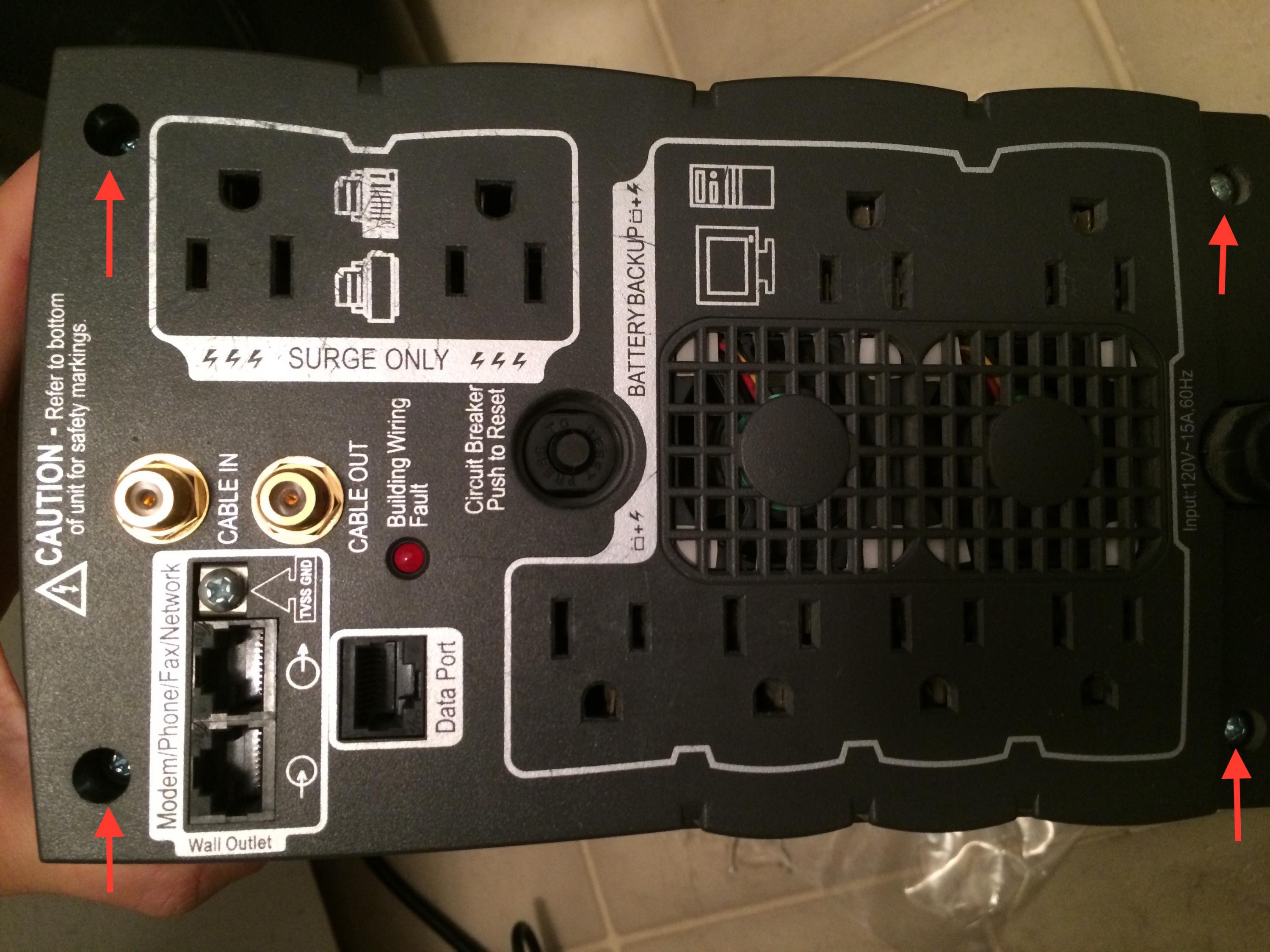

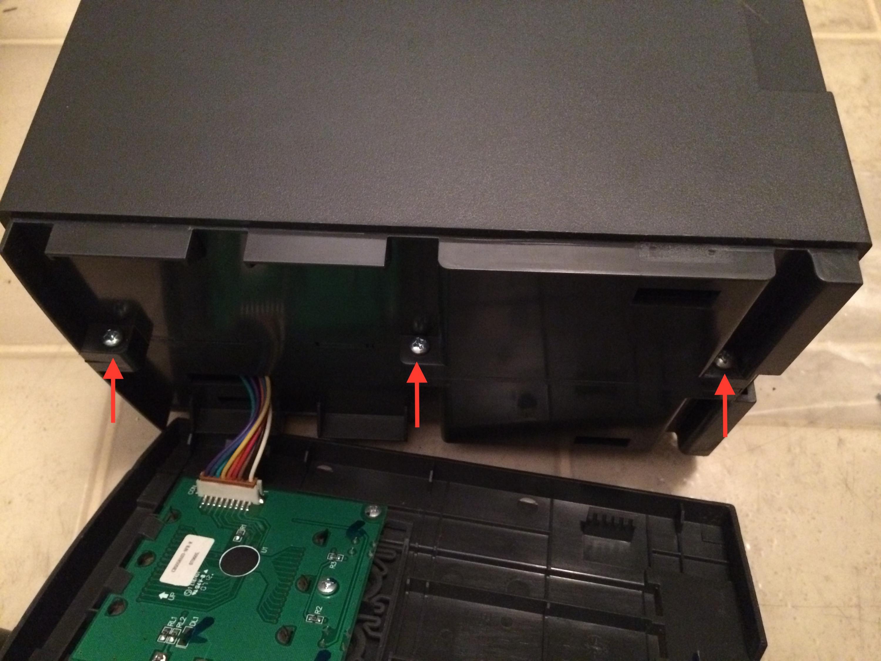

    Then, I opened it up. Remove four Phillips screws from the back panel, and it slides out about 2in. The front panel snaps off--use a plastic spudger to pry it off. It is pretty firmly snapped on.
    Hidden under the front panel are three Phillips screws. In the battery compartment there are two, and that's all of them. The right side (when facing the front of the unit) lifts off.

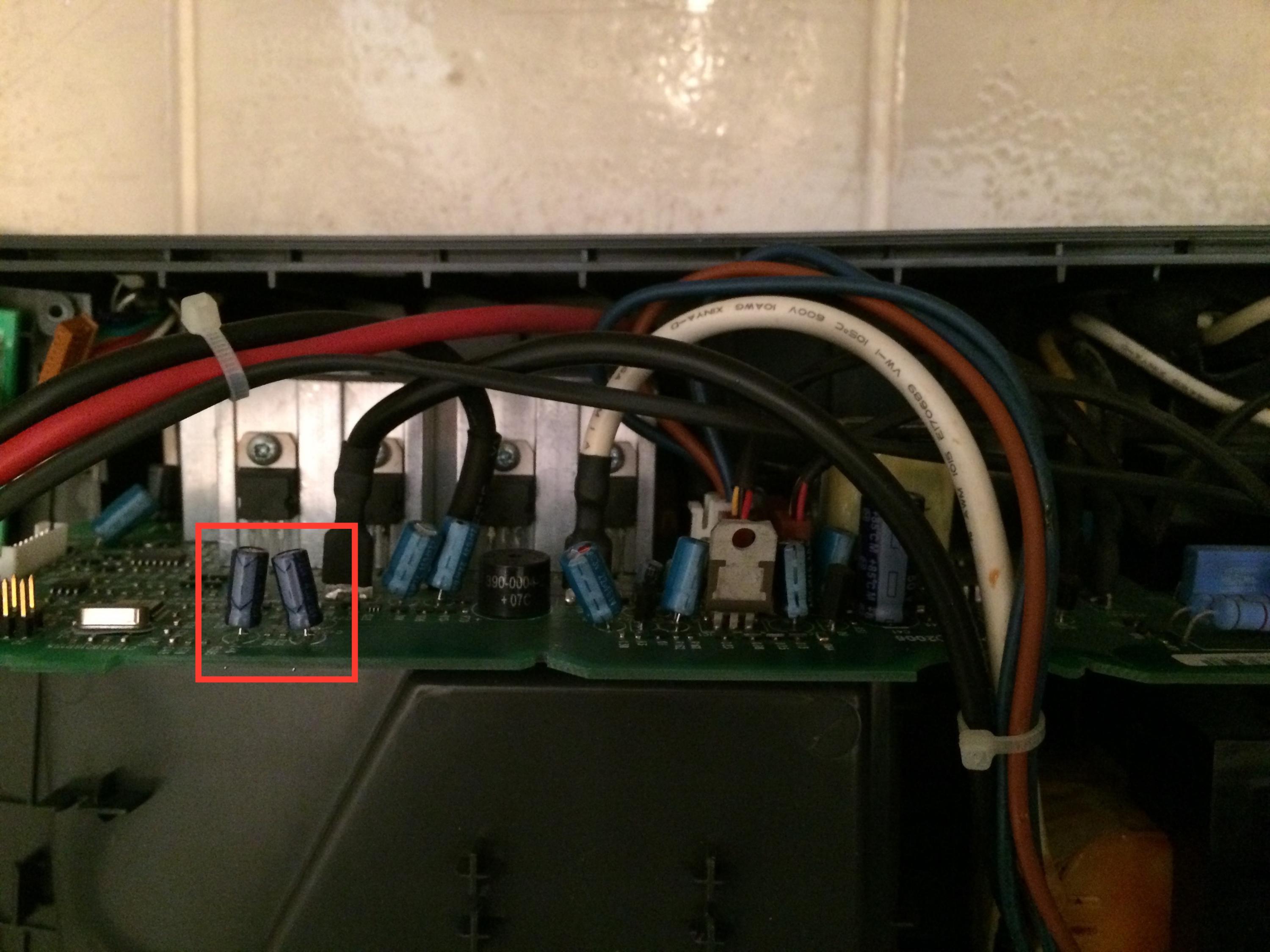

    On the mainboard, there are roughly a dozen electrolytic caps, most of them small and low-voltage. Nearly all of the ones in my unit were Jamicon, but three were CapXon.

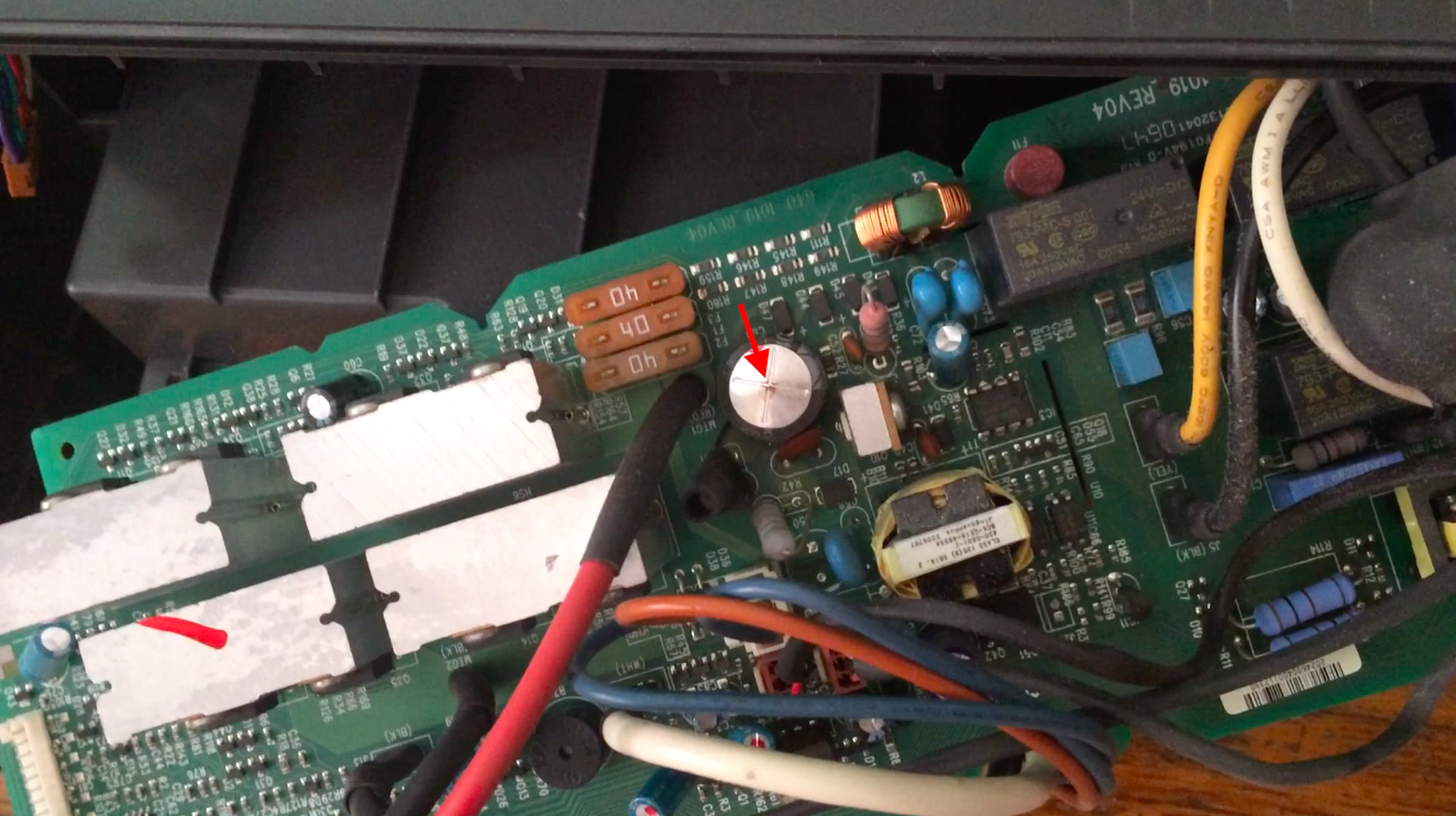

    Yup, sure enough, one of the CapXon caps, the physically biggest one that is marked C69, 22uF 400V, had vented its top. The other two tiny 4.7uF 25V ones looked okay, but I don't trust the CapXon brand, so I went ahead and replaced them too.

    1x Panasonic EEU-EE2G220S 22uF +/-20% 400V 105C
    2x Nichicon UPW1E4R7MDD 4.7uF +/-20% 25V 105C

    I soldered them in easily, put the UPS back together, and it began working immediately without any trouble.
    For less than $3 in parts, I got my >$150 UPS working again, probably for another many years and saving this from the landfill.
