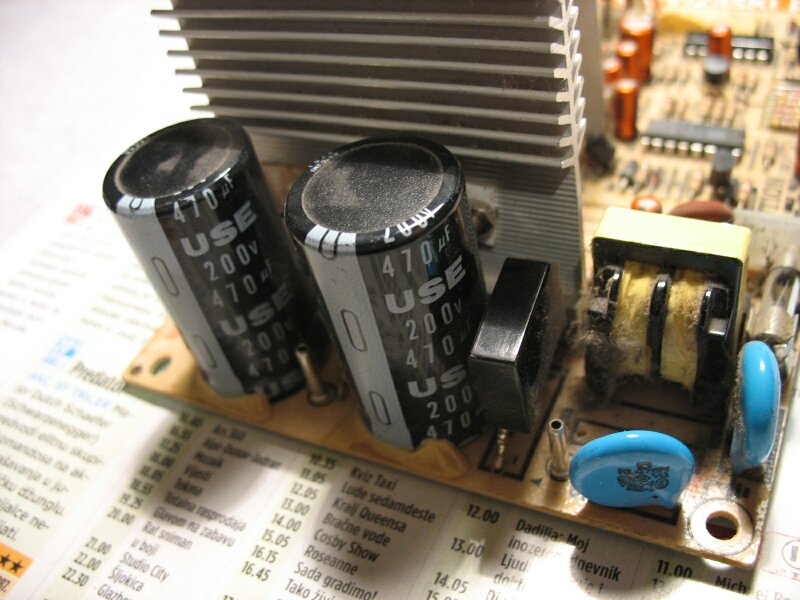

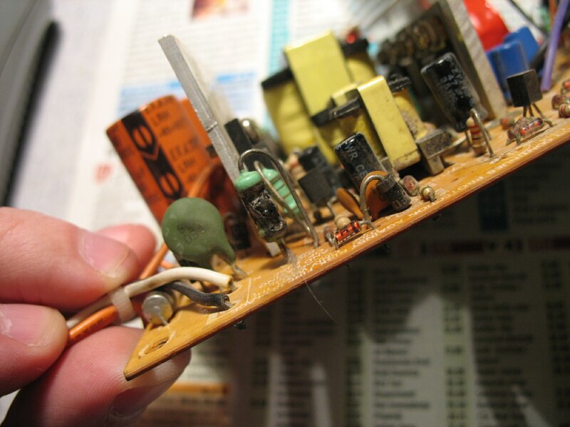

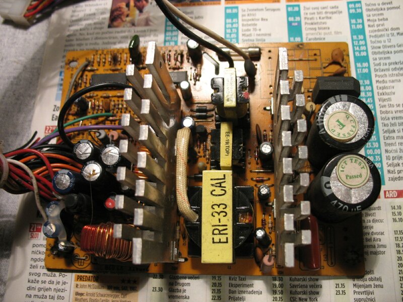

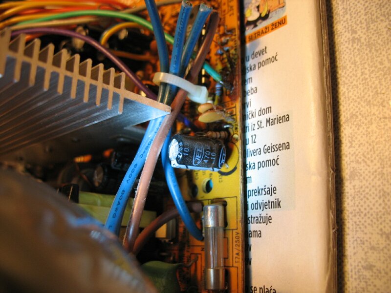

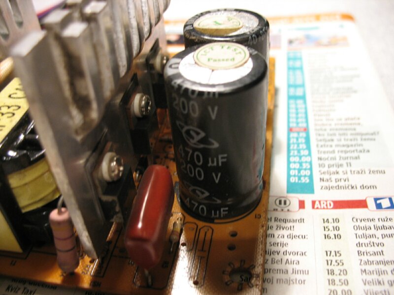

    so let's start. somewhat typicall example, this unit doesn't have EMI filter at all.
    primary rectifier is comprised of four diodes, uses cheapest caps available(as i mentioned elsewhere, teapos look like premium grade compared to this junk..all of these psus have bad caps even if pix don't represent it fully), pwm ic is sg6105.
    i don't have housings for most of these (they take too much space) but these are easy to spot; they're unusually cheap, they're very light, they bare weird brands etc.

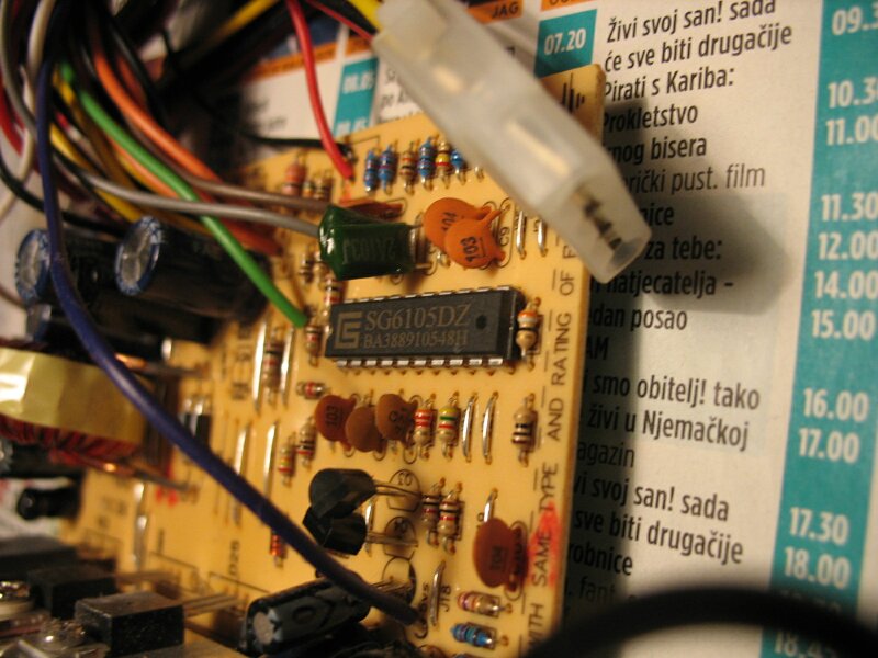

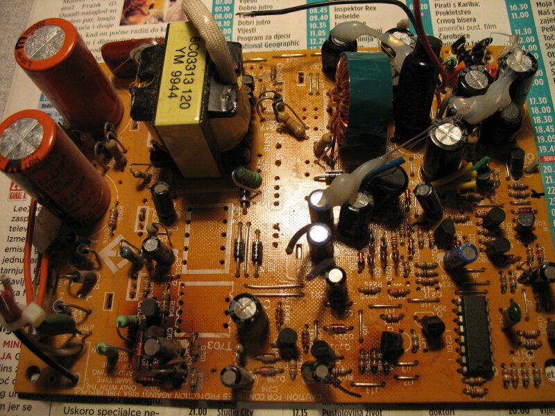

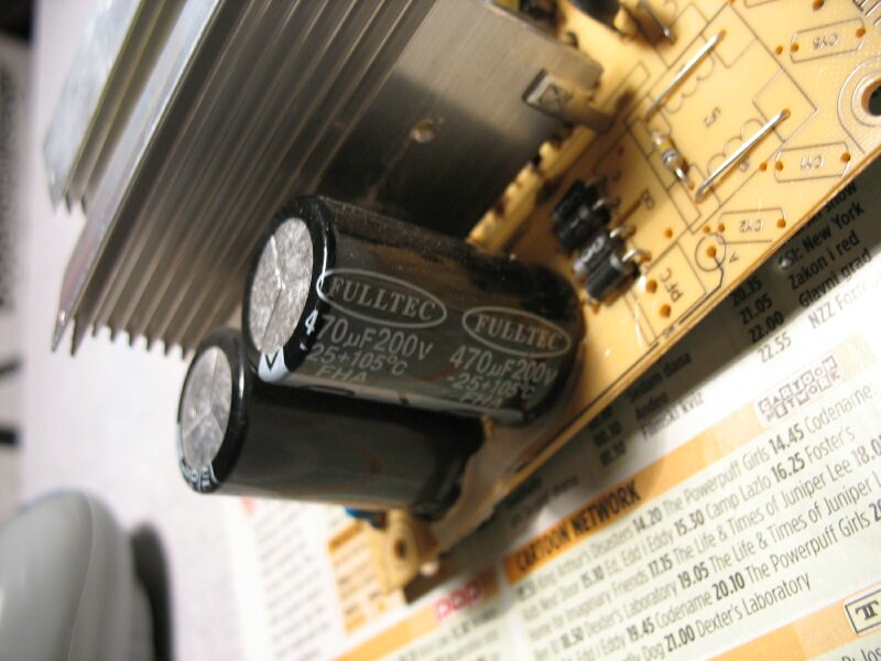

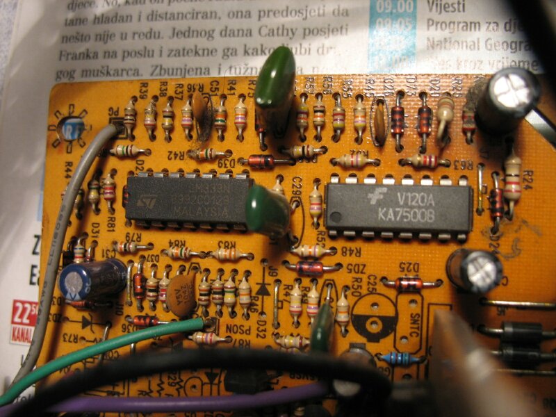

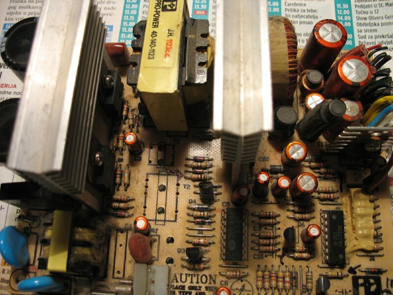

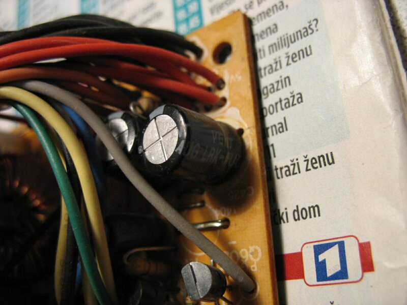

    2nd specimen: here we see something that repeats often at these cheap and cheesy designs->temperature strain around the two small transformers (+5V stby trafo and another one that connects low voltage secondary circuit (its pwm section) to primary, to reach and steer those hi-power switchers, but still keep primary and secondary sections electrically separated).
    the only explanation i can find for this are (surprise, surprise) badcaps. the more they work the warmer they get and then they lose some more of their crappy electrolyte and this vicious circle continues untill their esr reaches astronomical values and circle just stops functioning, or untill that causes some disaster like (quite literally) burning itself and other components(like we'll see in examples to come) or failing to steer those switchers, which can lead to producing, well, anything on the load, and usually it's nothing good.

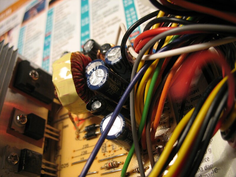

    this design is simillar to above shown, has some emi filtering, sam pwm chip, and with lytics like this no good chance of reliably lasting.
    as we'll see later, these are actualy better examples(lasted some years, didn't kill no mobos, didn't produce smoke). we'll see worse. much, much worse.

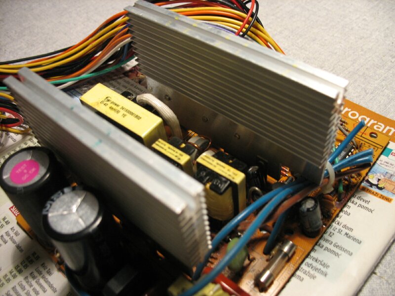

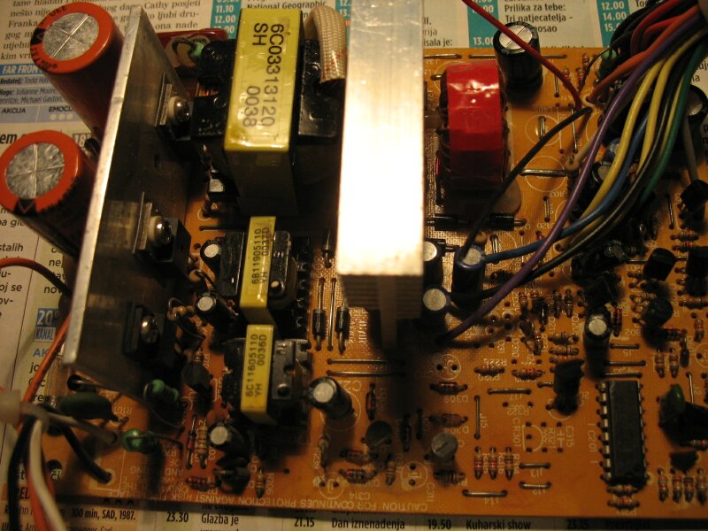

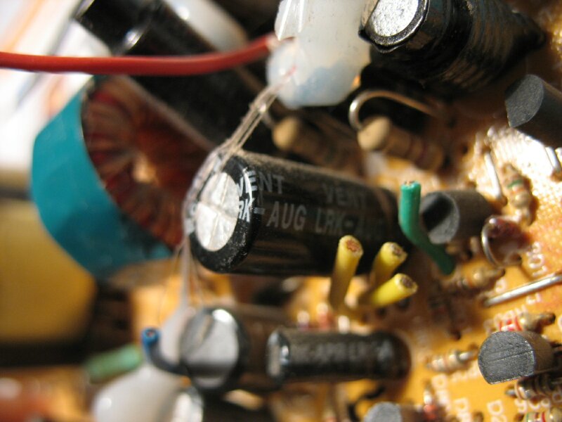

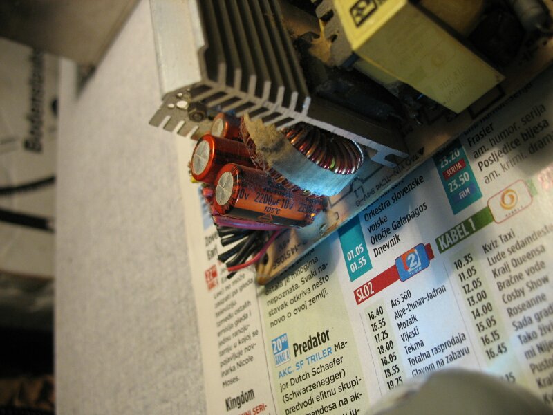

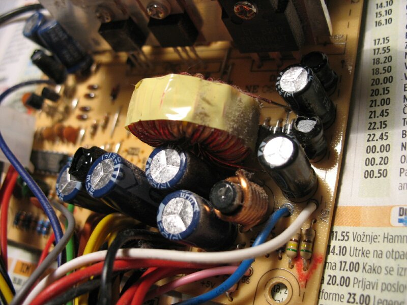

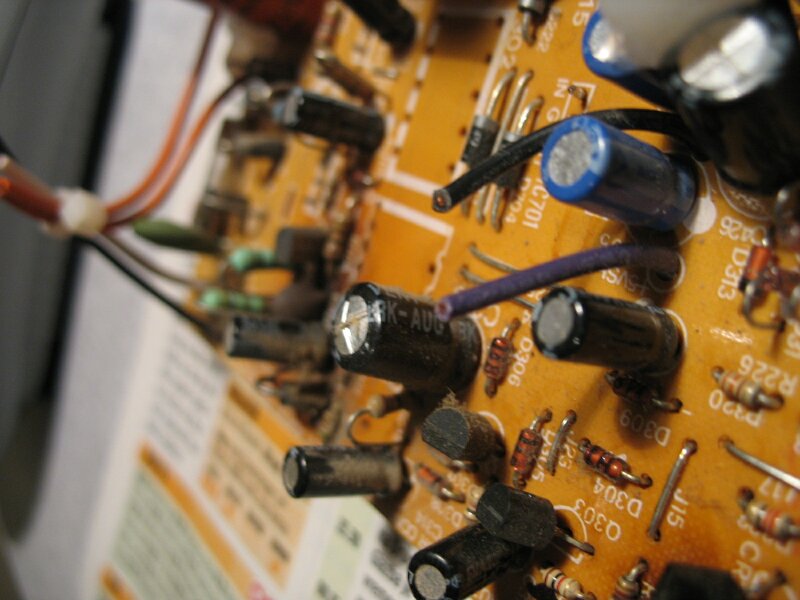

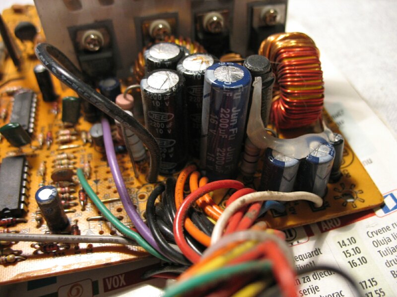

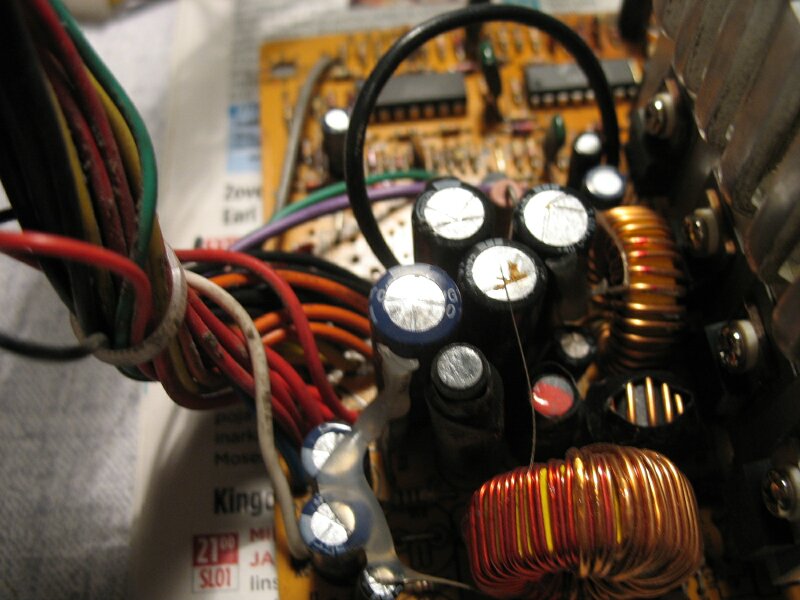

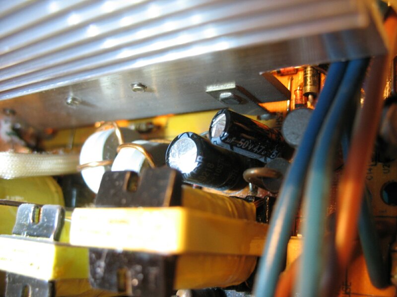

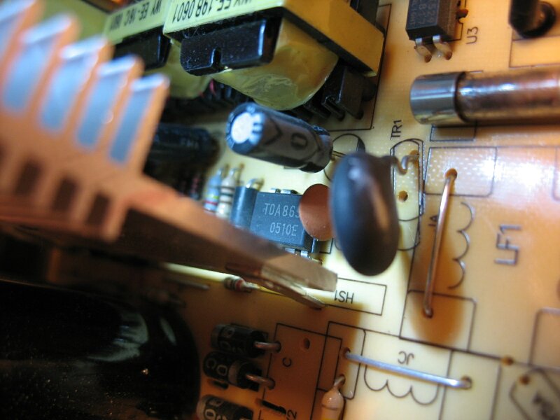

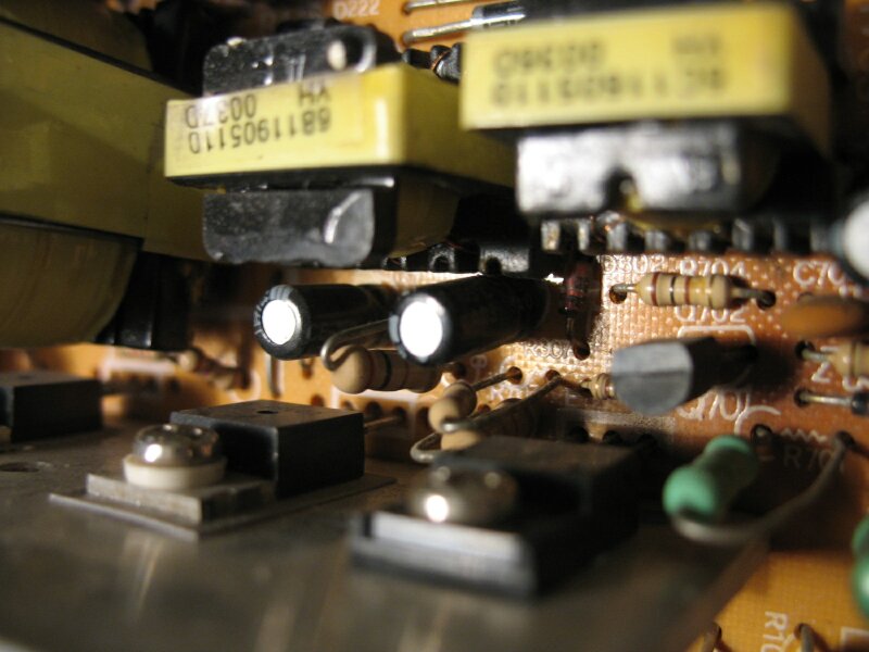

              i'm feeling generous, so let's do 2 today. next time we'll finish it off.
              3rd one shows more prominent secondary caps deterioration. again, it's better to have secondary(output) caps bulging and pwm shutting down ocassionally(making you swap the psu while it's still on time) than to have crap happening on primary that causes your mobo to fry. this psu didn't cause catastrophic failure that ate whole machine. it deteriorated gracefully. it's crap, but still, worse can happen.
              this design employs different pwm ic, but i wouldn't say failures are connected to ics at all. it's more about passive components, their quality, and the lack of them (emi filters missing etc.). these stress out switchers, and they fail. upon failing they can produce too high voltages on output. nothing can prevent disaster, as blown transistor cannot be regulated.
              (that is, at least, best explanation i came with thus far. if anybody has better explanation i'm interested to hear it.)
              at first i was thinking it may be a flaw of transformer, but that is probably least probable, even though i have actually seen one example of trafo with primary shorted to secondary, but even experienced repairer will be surprised by such outcome. it is completely unusual event.

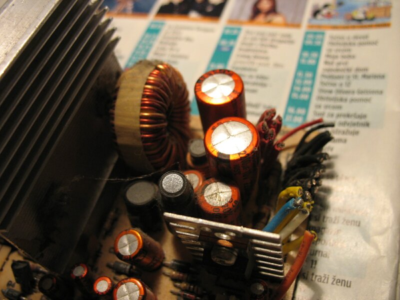

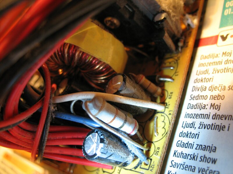

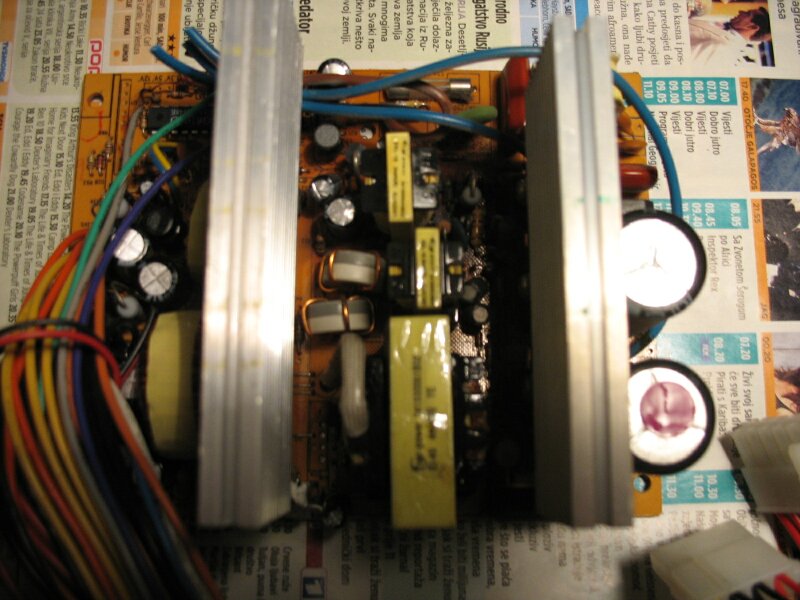

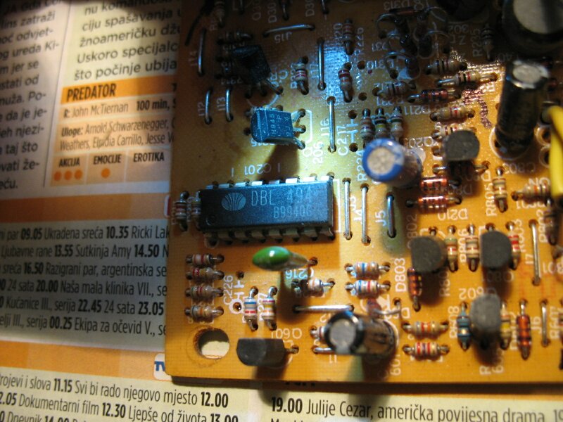

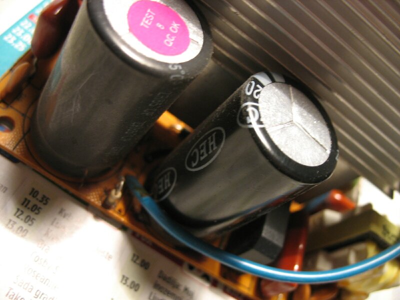

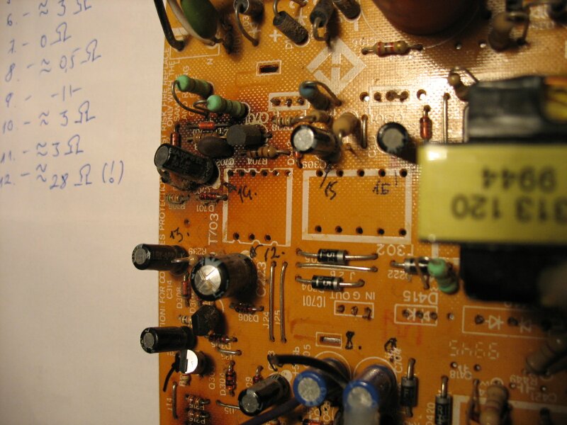

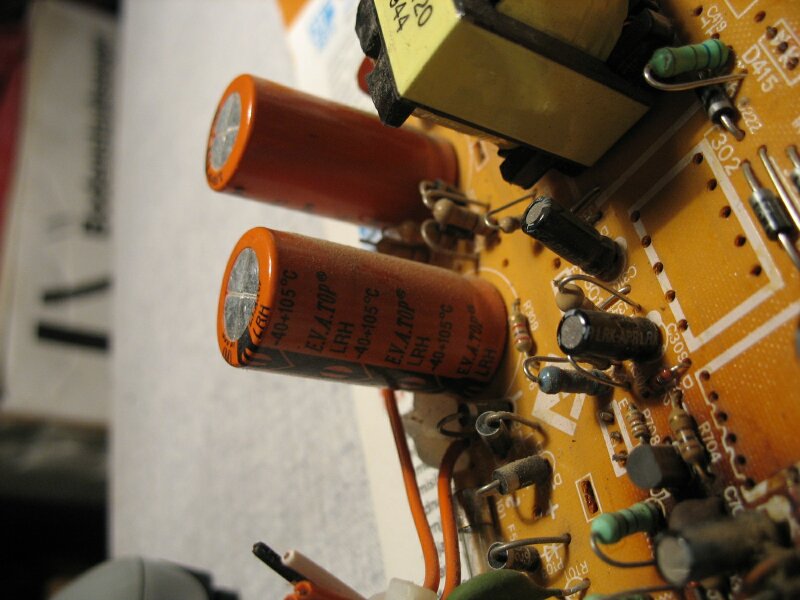

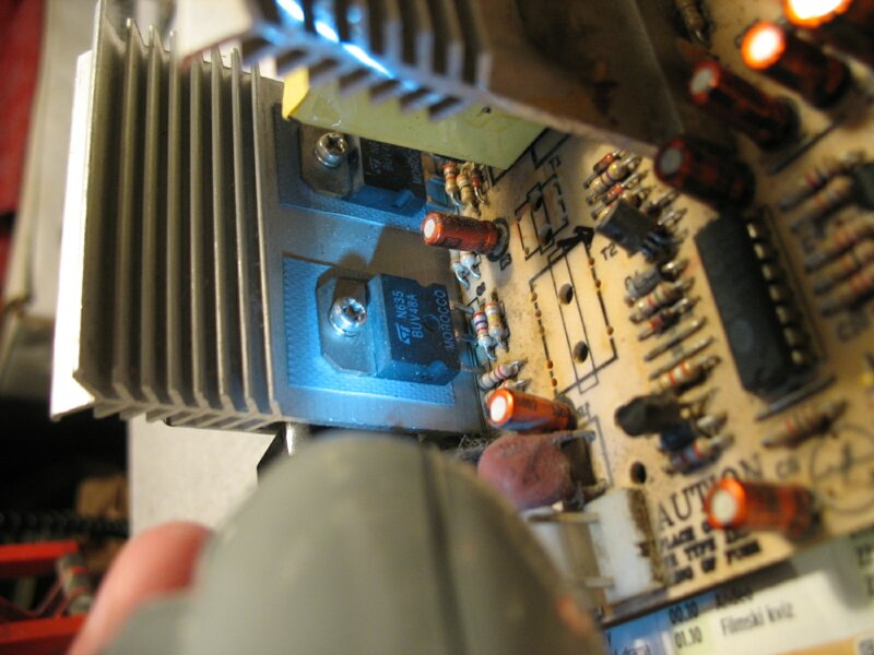

                moving on to case no.4: here it gets interesting, as we'll see marks of real burning on this one. it seems here we had a bad cap on 5v stb primary section (T703 place) that caused smoke coming from psu, and this made owner swap it.
                nothing bad happened to the rest of the machine.
                cap manufacturer is "E.V.A.top", it's shown on this list
                http://capacitor.web.fc2.com/abcde.html#abcde
                no website, it seems, i surely hope they died. <wink>
                you can also see one more evatop cap on the secondary side, not completely destroyed as one on the primary side, but bulging.
                this psu was called "sunny", if i remember correctly.
                http://www.sunny-group.com/en/production.asp
                i dunno if they're making such psus anymore, it seem they don't, good for them and us!
                next time we'll see same design(same pcb actually) with another brand, but equally crappy, the one that destroyed my complete system back in 2001.
                we'll devote some more time to that...

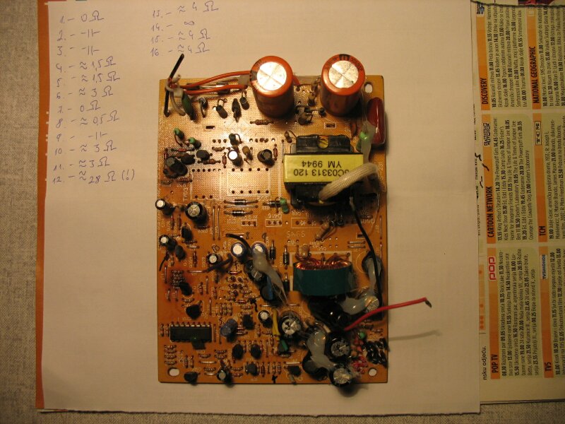

                  Re: Bad design examples

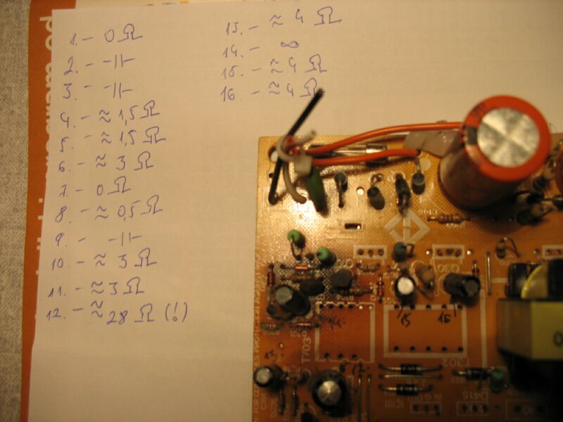

                  something else belongs above (case no.4) : esr measured on those caps.
                  on pcb you have numbers, and those numbers correspond to particular esr measurement written on paper.
                  those evatops are crap.

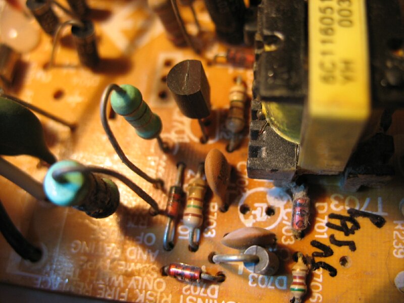

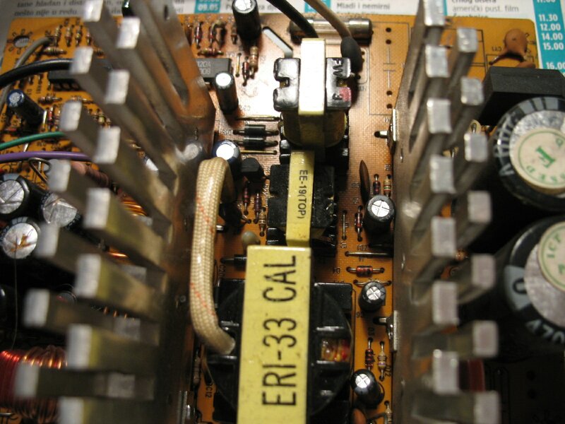

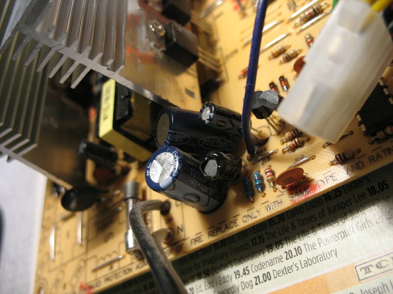

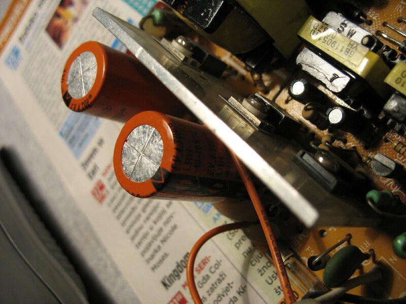

                          dav, here's the case no.5, the one which should put your doubts to rest.
                          first we'll see pix of it, and in next post (autopsy) we'll try to figure out what happened to it.
                          let's compare this(https://www.badcaps.net/forum/attach...achmentid=7351) and the previous(https://www.badcaps.net/forum/attach...achmentid=7323). obviously, same pcb, but the case no.5 has few components missing.
                          (i took out c311, but the rest is as-is. we can see missing transistor, missing resistors that accompyny it, 2 missing caps...).
                          notice green resistor that is completely black now(burnt).

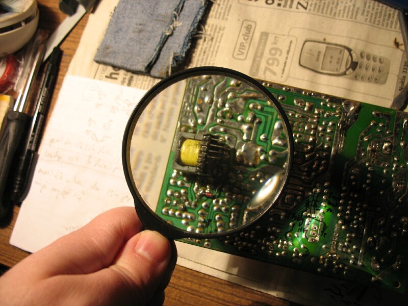

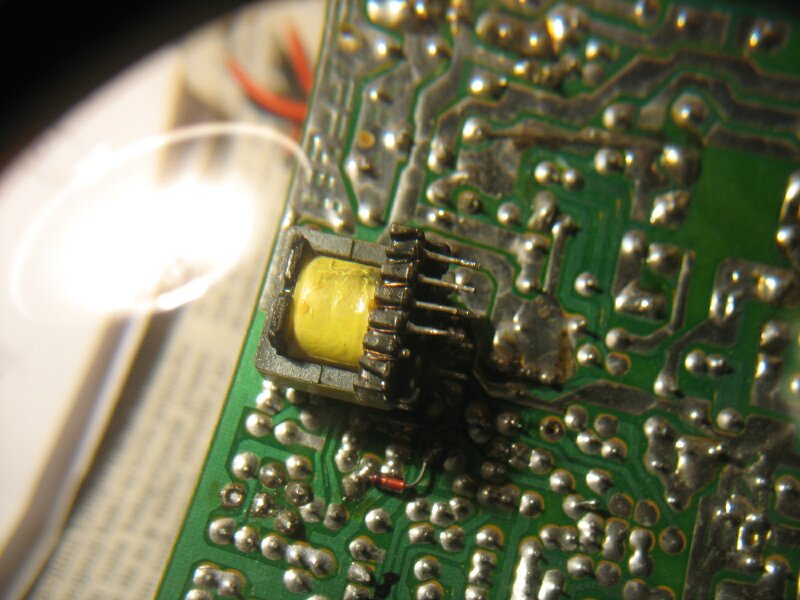

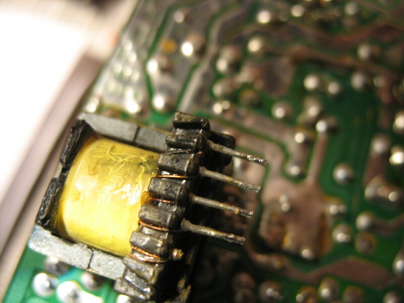

                            autopsy of case no.5
                            now we arrive at interesting part. trying to establish what happened here. first we'll see the results and then we'll see if we can figure it out.
                            these are parts from the +5v stb circuit that provides psu and the mobo with initial power to operate. it's oscillator that's hooked to this small trafo(T703 shown in case 4), and output of it is rectified and supplies pwm ic and mobo.
                            this design is simple (really too simple) and it obviosuly offers no safety.
                            notice dm311 on my new fortron(https://www.badcaps.net/forum/attach...achmentid=7346), it's this chip
                            http://www.fairchildsemi.com/pf/FS/FSDM311A.html.

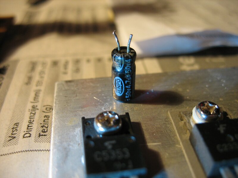

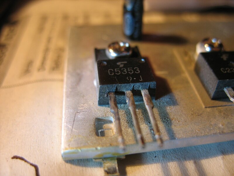

                            moving on to pix that show the following:
                            -jenpo 4.7uF lytic with substenitaly increased esr (about 25ohm)
                            -blown switching transistor (2sc5353)
                            -even the transformer is blown (it's first pin and attached wire chared and cut to 2)
                            -chared resistor (it's purpose was probably to provide a way for excess current to escape, but it didn't do this job too well...)
                            -mains fuse (not shown here) is intact. obviously it has thicker wire than this trafo.
                            what seems to have happened: crappy jenpo cap is gradually increasing its esr. when it reaches a certain level it causes oscillator to stop functioning, and this means there's nothing to properly limit the current that flows thru the transistor and trafo. during a short period transistor is not switching at all(it's blown), this increses the primary current to max the trafo wire can take and in the end that wire fails. offcourse this doesn't go unnoticed on the secondary side: mobo is destroyed alongside everything that's connected to it.
                            (main switchers are ok, so it can be discussed if this 5v stb failure also induced pwm ic to go out of spec and produce crap on main trafo primary and on all rails, but that interest me less, as i'm interested in how things unfolded. and i'm pretty sure 5v stb circuit was the trigger...it's obviously very bad design if we see it failing on 2 psus, cases 4 and 5).
                            that is my version anyway. others can offer better explanations if they have 'em.
                            this was jnc psu.
                            http://www.jnc.com.tw/company.htm

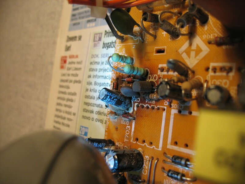

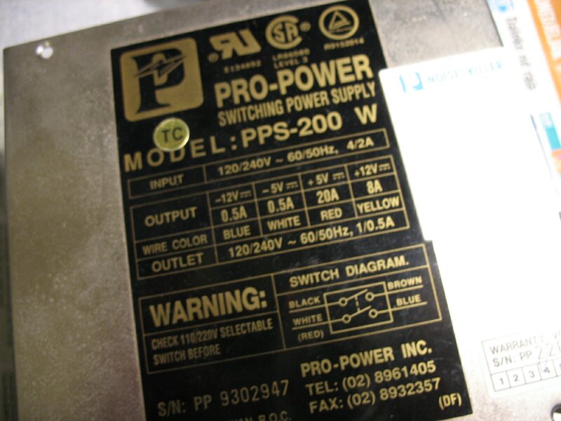

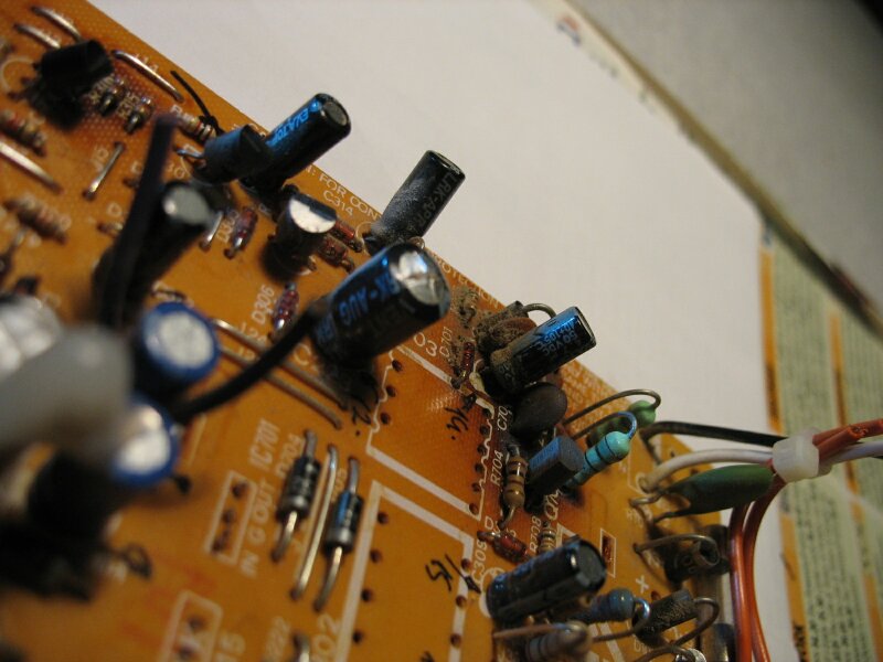

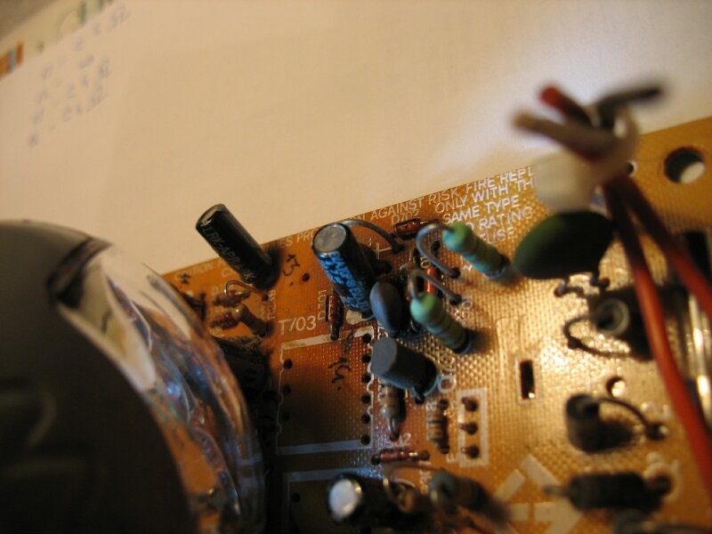

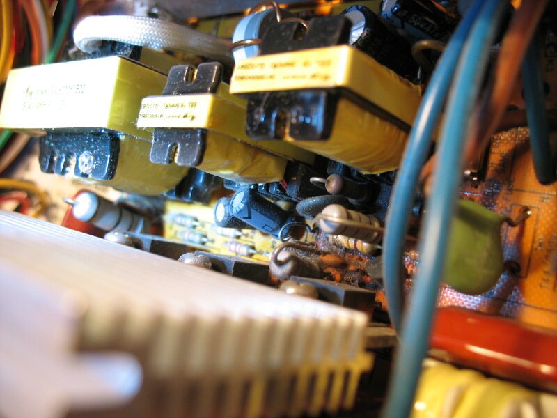

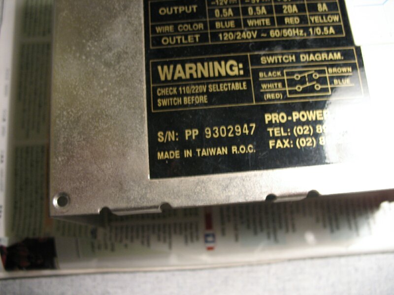

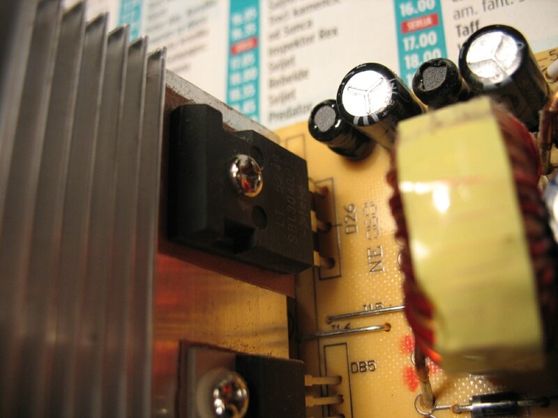

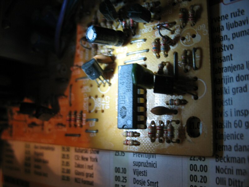

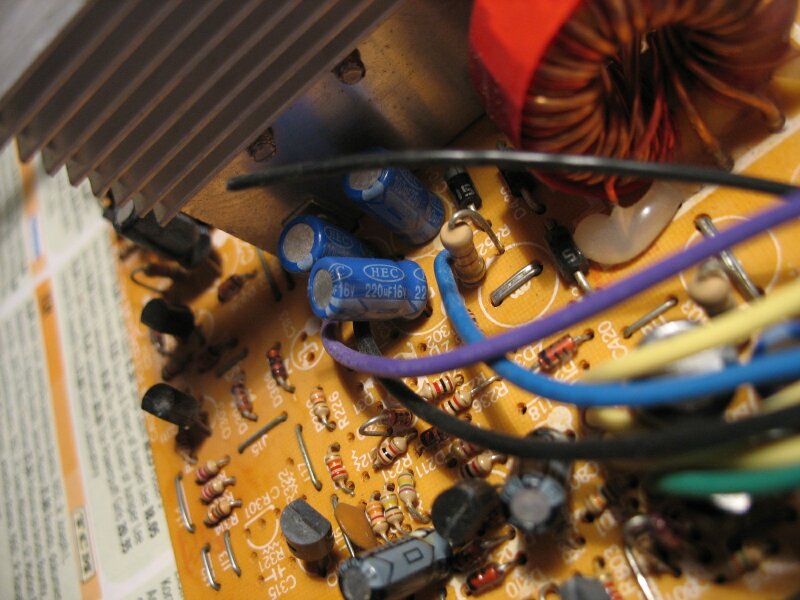

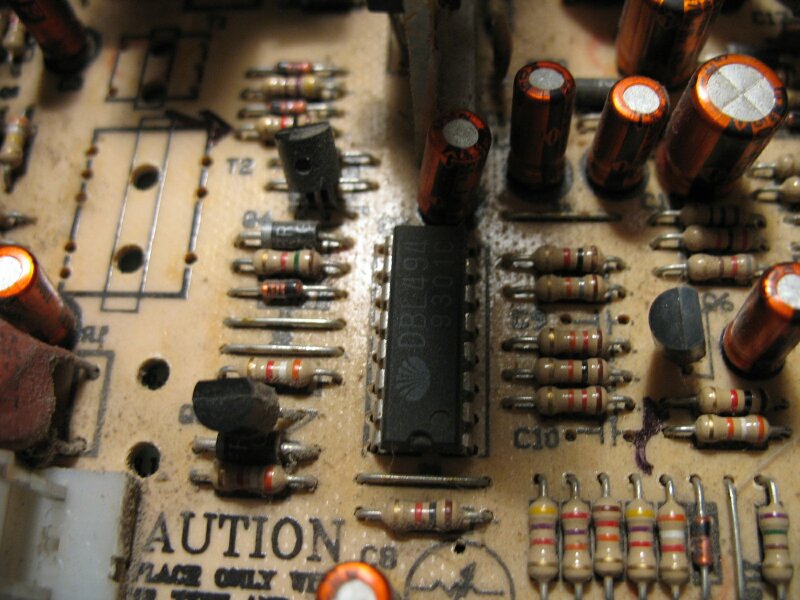

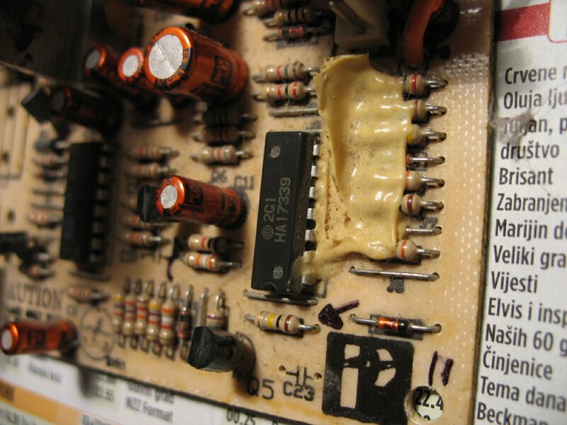

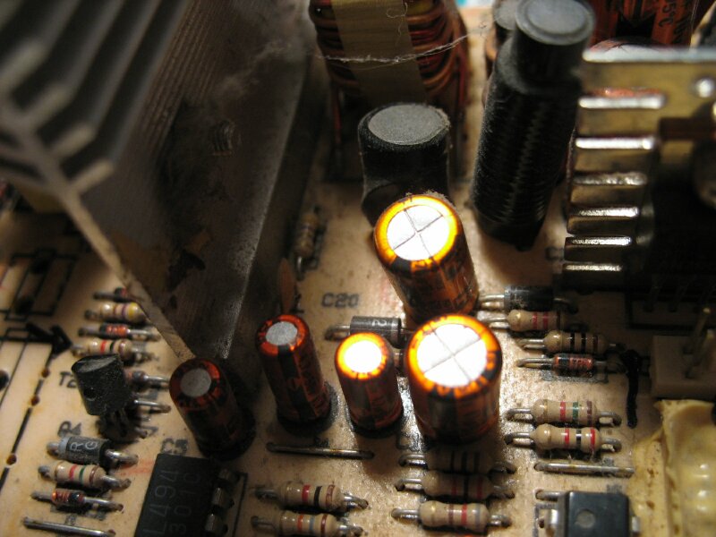

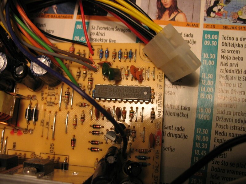

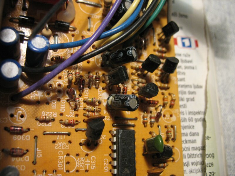

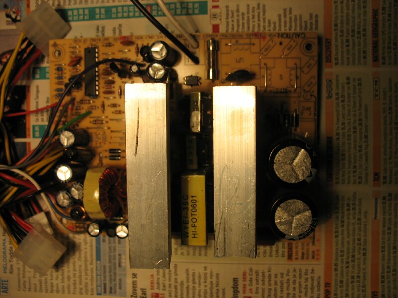

                              moving on to our last patient, propower psu from 1993. no.6.
                              built around dbl494( same chip used for a whole decade, it seems. cases no.4 and 5 are early 00s), but a better design, not so much saving is apparent. again a lot of the badcaps. this supply failed but didn't destroy machine, and as such it's not too interesting subject to investigate.
                              looking at these pix i notice 7805 regulator and it reminded me to search for it on case no. 5 too: and ineed it has one, so i should be clear:
                              7805 is used to supply mobo with stby voltage so it will not be the one that destroyed the mobo in the case no.5. but the pwm ic indeed is supplied straight from that trafo, after being rectified and smoothed. ic accepts supply voltages of 7-40V.
                              that doesn't change the main reason of failure, but it means that more than likely this is correct:
                                    Is there any evidence of this? Normally the 5V stb is independent of the main switch mode regulator ie not involved in the control of operation other than switching it ON.
                                    Gigabyte EP45-DS3L Ultra Reliable (Power saver)
                                    Intel E8400 (3000Mhz) Bios temps. 4096Mb 800Mhz DDR2 Corsair XMS2 4-4-4-12
                                    160Gb WD SATAII Server grade
                                    Nvidia 8500GT 256Mb
                                    160Gb WD eSATAII Server grade for backup.
                                    Samsung 18x DVD writer
                                    Pioneer 16x DVD writer + 6x Dual layer
                                    33 way card reader
                                    Windows XP Pro SP3
                                    Thermaltake Matrix case with 430W Silent Power
                                    17" Benq FP737s LCD monitor
                                    HP Officejet Pro K5300 with refillable tanks
                                      1. ALL SMPS have a feedback loop to ensure control of the output voltage. Refer to FSDM311A data sheet page 2 where feedback loop connects to pin Vfb.
                                      i mentioned my new fortron psu and its fsdm311 chip as an example of better design than one i was describing.
                                      i said the "circuit" didn't have feedback, ie circuit that is providing initial power to pwm ic, which in the case of crap psu is db494.
                                      look at the left-bottom of the image: "second power supply".
                                      and..huh...i should of looked at it earlier to, as it seems it has some sort of feedback via other section of primary windings.
                                      d29 and elko c19 probably rectify and smooth this error voltage and lead it to base of q12.
                                      (this schematic doesn't show same thing as this psu hosts, but it's fairly simillar)
                                      also, it was a mistake to call this circuit "+5v stb circuit", because it's really not it. i mistakenly thought this circuit is supplying both pwm ic and +5V stb to the baord, but it's not. it's just supplying the ic.
                                      +5V stb has another path alltogether, and as i said, it's protected by 7805 regulator.
                                      So what I am saying is that heavy current in a transformer primary only transfers a small proportion of energy across the transformer.
                                      so what explanation on why "second power supply" failed you offer?
                                      by your account, high primary current can't wreak havoc on secondary side.
                                      so what did it?
                                      to repeat again, this transformer is not the main smps trafo(its ok, and main switchers are ok), but the auxillary one, one that supplies power to pwm ic because first you need to start ic.
                                      we only have proof of high primary current, because transistor and trafo(primary section) are blown. this means we surely had high current there.
                                      my suggestion is that this caused voltage spike that offset pwm ic and then it sent wrong signals to main switchers.
                                      the other path we could take would be to discard what was happening to this secondary power supply alltogether, but seeing how it also caused problems on psu no.4 i think we shouldn't. supply to pwm ic is important.
                                      btw. what's the source for saturation being 50% more energy?
                                      do you have graph representing flux.density vs. current?
