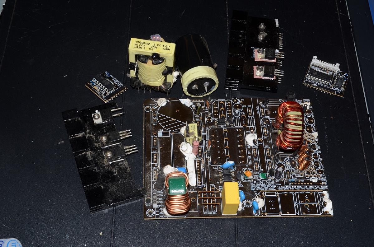

                  I don't really like those Tier Lists...
                  Because we can't really know how good/bad the actual caps are...
                  We can only see how a couple of years old caps are...
                  Besides the most important thing is the enviroment the cap has to live in...
                  There are better Designgs that don't stress the caps that much and than there are real shitty designs where no cap can really last...
                  I'd rather have like a row of 6 Capxon caps instead of one or two 'Japanese' ones...
                  And a prime example for a real shitty layout:
                  You can see that there are some 'non redundancys' as well as caps next to Heatsinks and other shit...
                  Pretty awful that one is...

                    FSP GLN, that is definitelly capacitor problem. It may be stressing caps a bit more but those custom not-in-datasheet crapxon KF caps are the only problem. They go bad everywhere not just around the heatsinks and in other PSUs from different manufacturers too.
                    • Stefan Payne
                      • 1267
                      Re: 'First Tier Caps'
                      Yeah, but according to the datasheet the 8mm KF Series is specced for 3kh life, only 10mm and more are specced for 5kh...
                      And the other thing is:
                      What did those companys order from CapXon?
                      When they don't want decent quality, than that is what they will get...
                      Don't get me wrong, that's not great but you can NOT blame CapXon for delivering something the customer wants...
                      That's how they make their living...
                      Anyway, let's see how long the Rorsair RM and Superflower HX Series may last...
                      PS: A good example for what I mean is Delta and ltec Caps.
                      Some say they are not that great, but they last in Delta units.
                      That may be because Delta knows how to treat and use them right - others may not...
                      As the example seen above...
