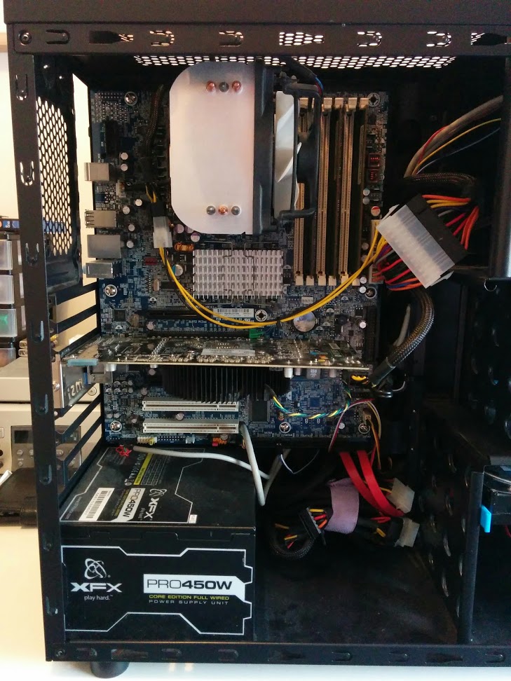

    Hey guys

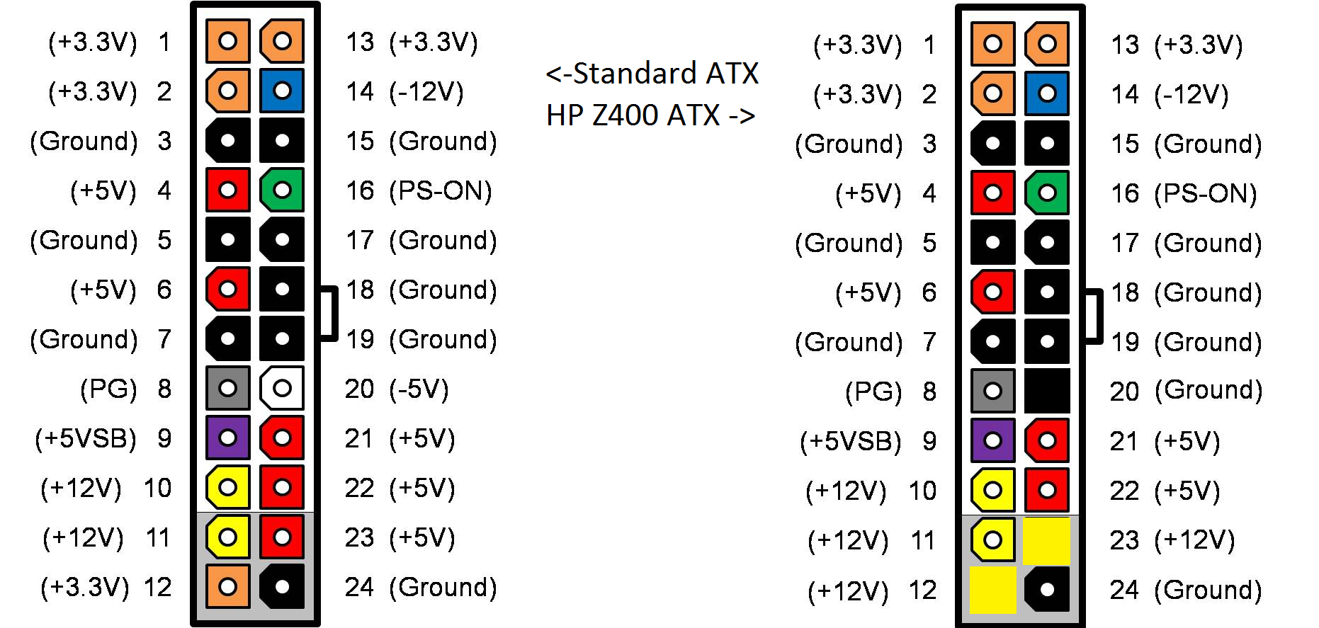

    I have a rather nice 1366 socket board from a HP Z400 workstation here and it has a non-standard pinout:
    There are 3 pins different.

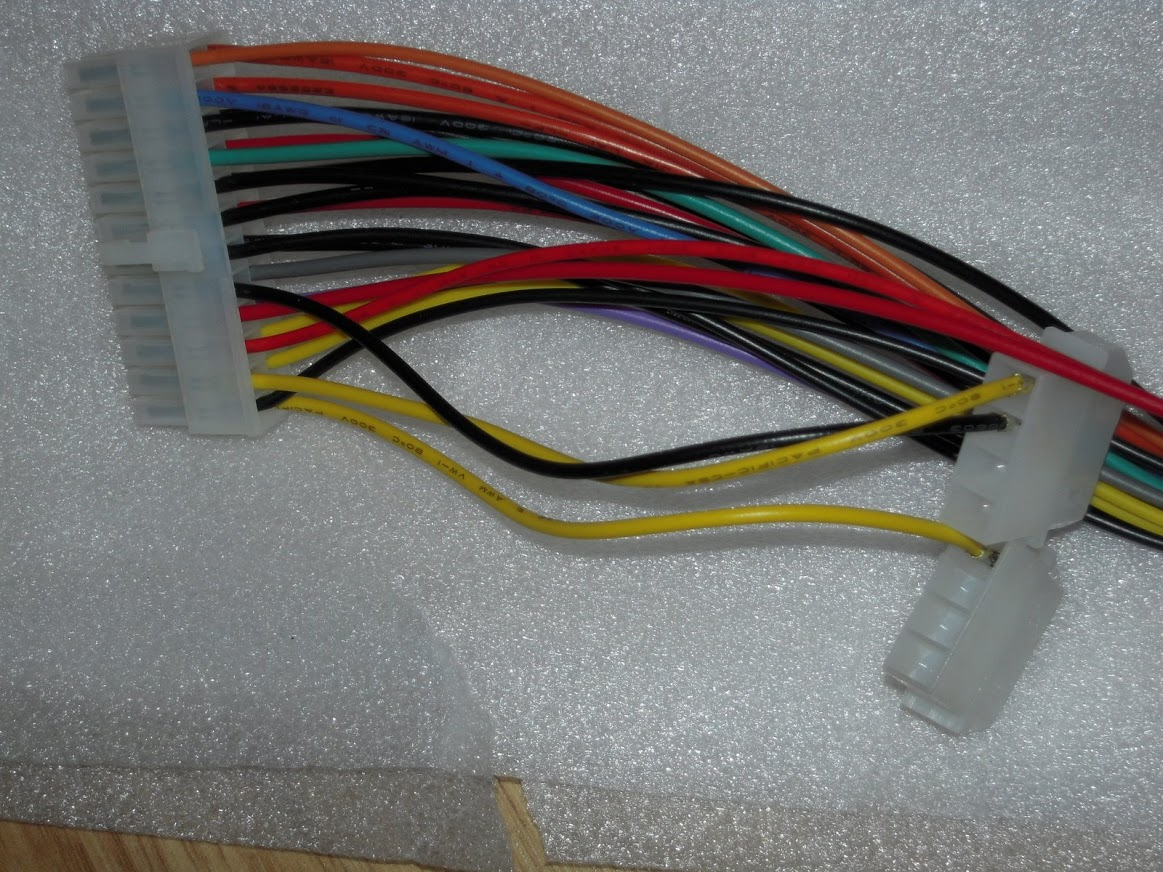

    I have seen someone make an adaptor that daisy chains a molex to change the voltage of the pins to 12V and a ground.
    I can do that but IMO it is messy.
    Would it be possible to just feed 12v from the existing 2 12v pins already in the ATX socket?
    Thanks in advance!

    Re: Making an adaptor for a non standard ATX pinout HP Z400
    PIN 20 (-5v) is obsolete, it's no longer used in modern systems. In new ATX power supplies, the pin is not connected to anything. That's probably why HP replaced it with a ground wire. You could probably leave the pin in the HP connector unconnected, as there are enough ground wires already in the ATX connector.
    The two extra 12v... it's a bit strange that they replaced a 5v wire with a 12v one, I would think it a bit risky but I guess they figured they don't need that much power. I can understand replacing one 3.3v wire with 12v but two..
    No, I wouldn't recommend splicing wires into the existing wires going to the connector, the wires seem kind of thin (AWG 20 maybe) so if the motherboard uses a lot of 12v the wires may overheat or they may be too much power loss through those cables.
    If it were up to me, I'd cut a 6pin pci-express connector and solder the 12v wires to those 12v pins and be done with it. That improvization with the molex connectors also works.

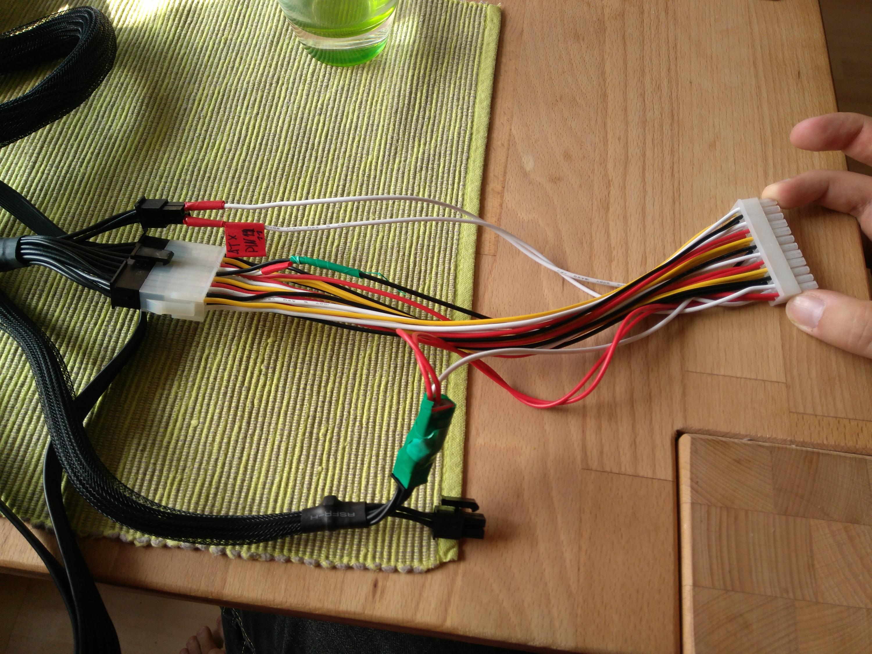

            Swapping the pins around would be ideal but there are not enough 12v lines, hence needing an adaptor.
            I made a fairly neat one running off the 2nd 4 pin 12v CPU connection, it works a treat!
                      I used this thread to mod my Z400 that way with a new PSU, but it doesn't work.
                      Any Idea what I did wrong?
                      • Leu
                        • Aug 2018
                        • 2
                        Forgett it, I just tried it with the CPU Cable, but now when I used the Molex Cable, it's working. Thinks by the way, my PC is now much more silent then with the default Power Supply!
