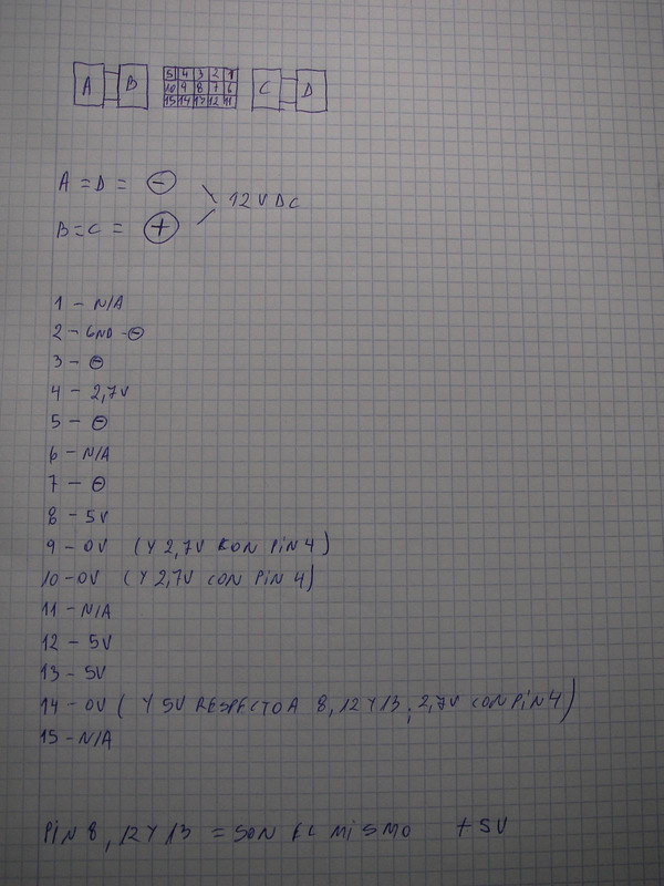

    I purchased a Mac Pro A1289. The team has some LEDs Test. When I plug in a moment the first two come on and then go off.
    If I plug while squeezed power, the LEDs remain lit, but only the first two. The third, which is PSUPWROK, not light.
    From this, I conclude that the PSU is bad (if not, please correct me).
    Now the first problem I have is that there is no human way to find the schema of this team .....
    Then, there is no human form that appears around a pin out of the PSU, nor how to make it start ...
    Because of this, I have taken measurements in the connector, but if I have to compare them with, is useless.
    What I ask, is first, if anyone has experience with this equipment, confirming me that failure is the PSU.
    Second, if someone has a good PSU 614-0454 and would be so kind as to remove it from the computer, plug it in, and take measurements on the connector, you would appreciate ...
    I'll upload a photo of measurements that I have taken, and by the way, and stay here embodied, for the future, if anyone needs them, it saves a little ordeal .... (The photos, upload the dropbox, to have full resolution, and you can see well, because my handwriting is a bit frightening. There is also a picture of the front view pin. The pin 1 corresponds with which it has a mark on the plug from the PSU)

              Hi joaquinmjuan, Did you have any luck repairing or replacing this PSU?
              It would be really helpful for the community if you could measure the voltages on the pins of the repaired or replaced PSU.
              Pins 4, 9, 10 & 14. Can you explain more about these. Thanks.
              This maybe helpful> https://eastbay-rc.blogspot.com/2015...09804113787927
