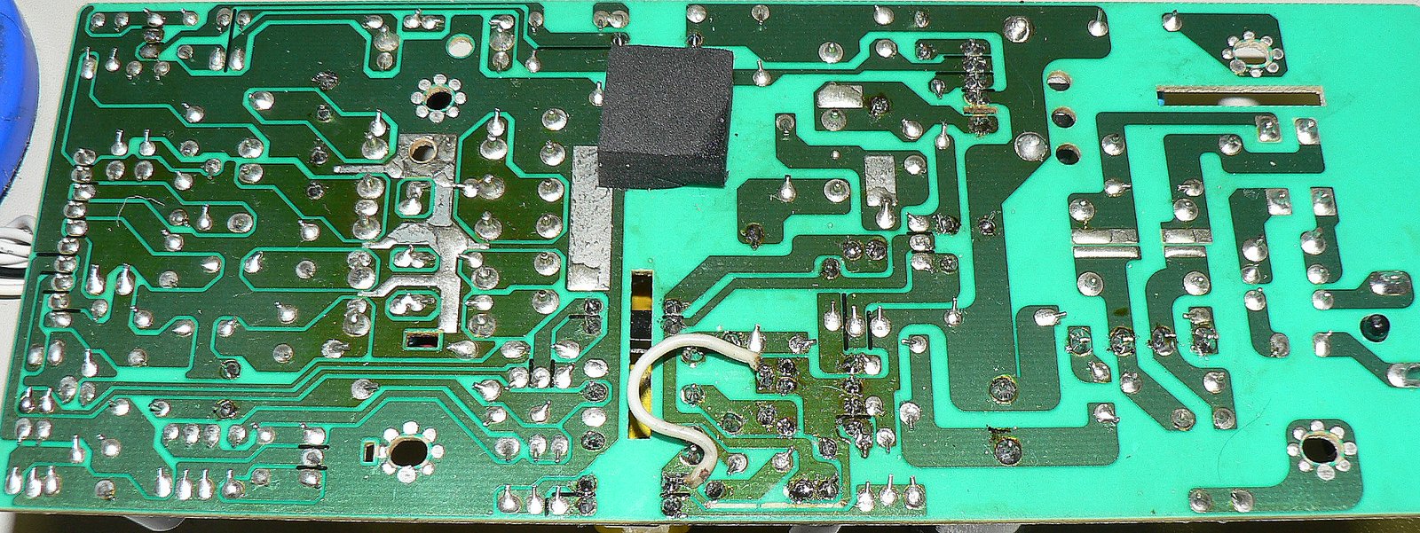

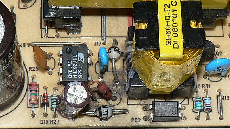

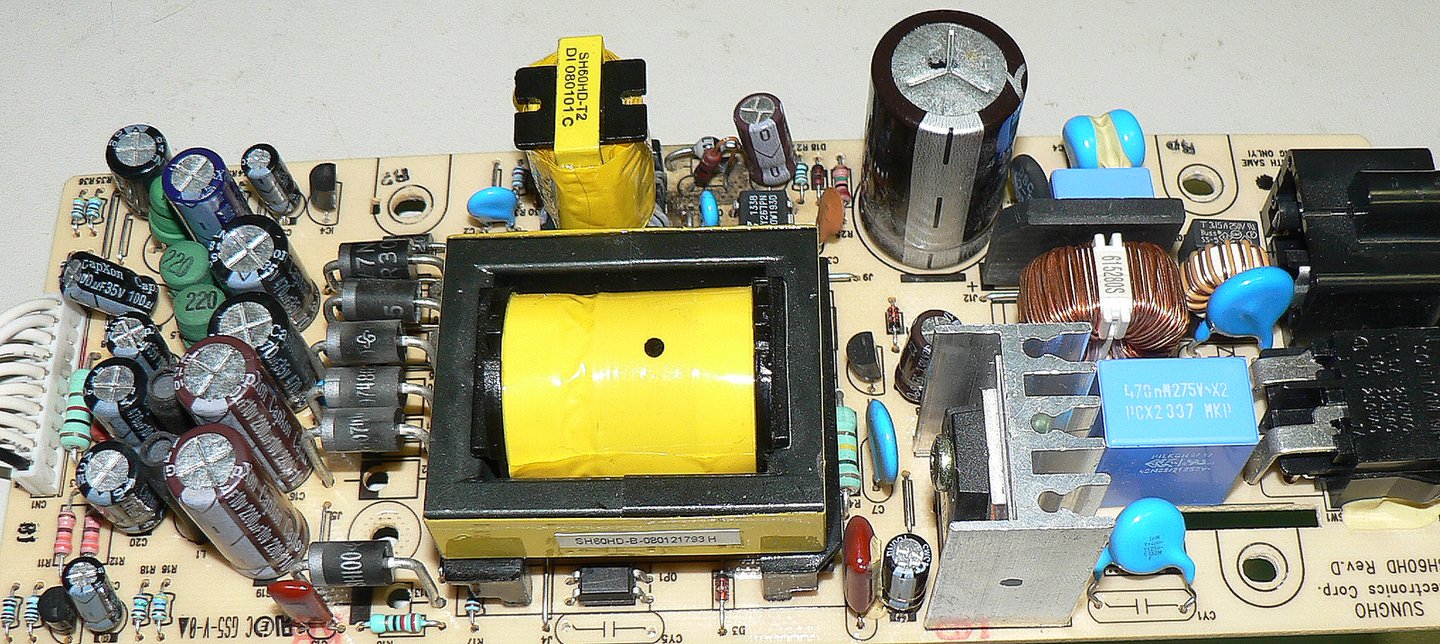

    An attempt to repair this one has been made but it still does not work. There is TNY267PN PWM controller with integrated MOSFET. Seems that it has exploded. It was replaced together with (probably) the optocoupler, some diodes and caps. According to O-scope it is not working as I only see 50Hz input capacitor ripple on the transformer primary (and secondary).
    I read something over 5 V on the C10 capacitor right next to the TNY267PN. There is 1,43 V over PC2 optocoupler and also the EN/UV pin of the TBY267PN.
    Any idea? Is the PWM bad again? Or wrong optocoupler has been selected?

      The cap in question is Samyoung 68 uF/450 V, measures 77,6 uF and 0,57 ohm.
      I should notice I did not have the negative side of the capacitor grounded by O-scopes ground and the PSU itself only has phase and neutral so it may have been floating a bit, as the waveform looked almost as one half of sine wave. The point is, the TNY267PN is not switching.

          The scope probe ground has to be on the Negative leg of the cap because that is the circuit ground ref, if you do not put the Ground probe there then you will see big way form because the bridge is the isolation (not electrical isolation) between the Line and Neutral of the incoming AC. You will have to put the load on isolation transformer that has both Line and Neutral floated by not the safety ground to allow you to put scope ground on the negative legs of the cap.
          What is the original opto # and the sub?
          D18 Protection diode is OK (it does not it was replaced?
          "some diodes and caps" which one?

            Anyway, I am afraid I did not get the original optocoupler but there is another one for main supply feedback, we can maybe anticipate both were the same from factory…?

              You need to look at the spec of the two opto to find CTR spec.

                        replace IC4

                            Not. IC4 is that of a series of 431, and is on the board shown in the secondary (cold) chain optocoupler.

                              Oh I see, TL431. Can try.

                                There are some good example circuits in the datasheet including opto part numbers that might be suitable.

                                  Re: Satellite receiver - no +5 V SB
                                  I second the idea of checking the mains rectifier bridge / diodes.
                                  Also, it might be worth checking if the snubber components are all (still) ok. Usually it's an RCD snubber across the (main) primary winding of the transformer.
                                  In this case, they're most likely the ones between the TNY267 and the transformer. I hope / assume that charred resistor(?) in the 3rd photo has been replaced?

                                    Two diodes were repalced incl. the snubber.
                                    I may replace the resistor in there, it reads 15 ohm and should be 22, even though I don't think that is that much of a difference…or is it?

                                      Hard to say. Is it within its specified tolerance? If not, definitely replace it.

                                        I've replaced the TL431, no change. The resistor is now within tollerance, don't know what happened.
                                        What are the important characteristics of an optocoupler? TNY datasheet specifies LTV-817 or TLP181Y in sample circuits, the ones in here (seems like replaced) are 817B, possibly FOD817B. This has CTR of 130-260 % while TLP181Y has 50-150 %. LTV-817 is not known, in the sample circuit there is no class specified.
