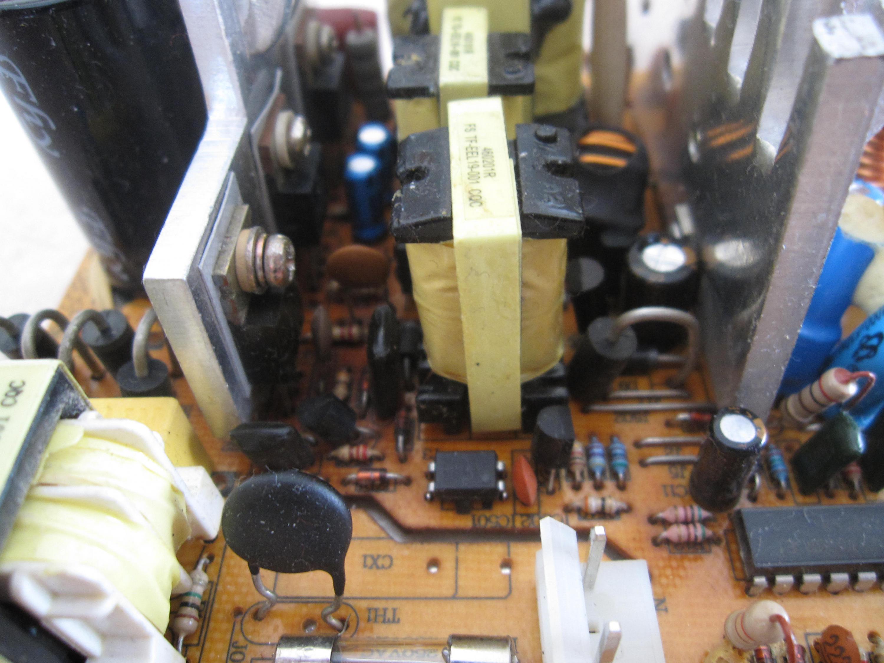

    Hello @ll !!!

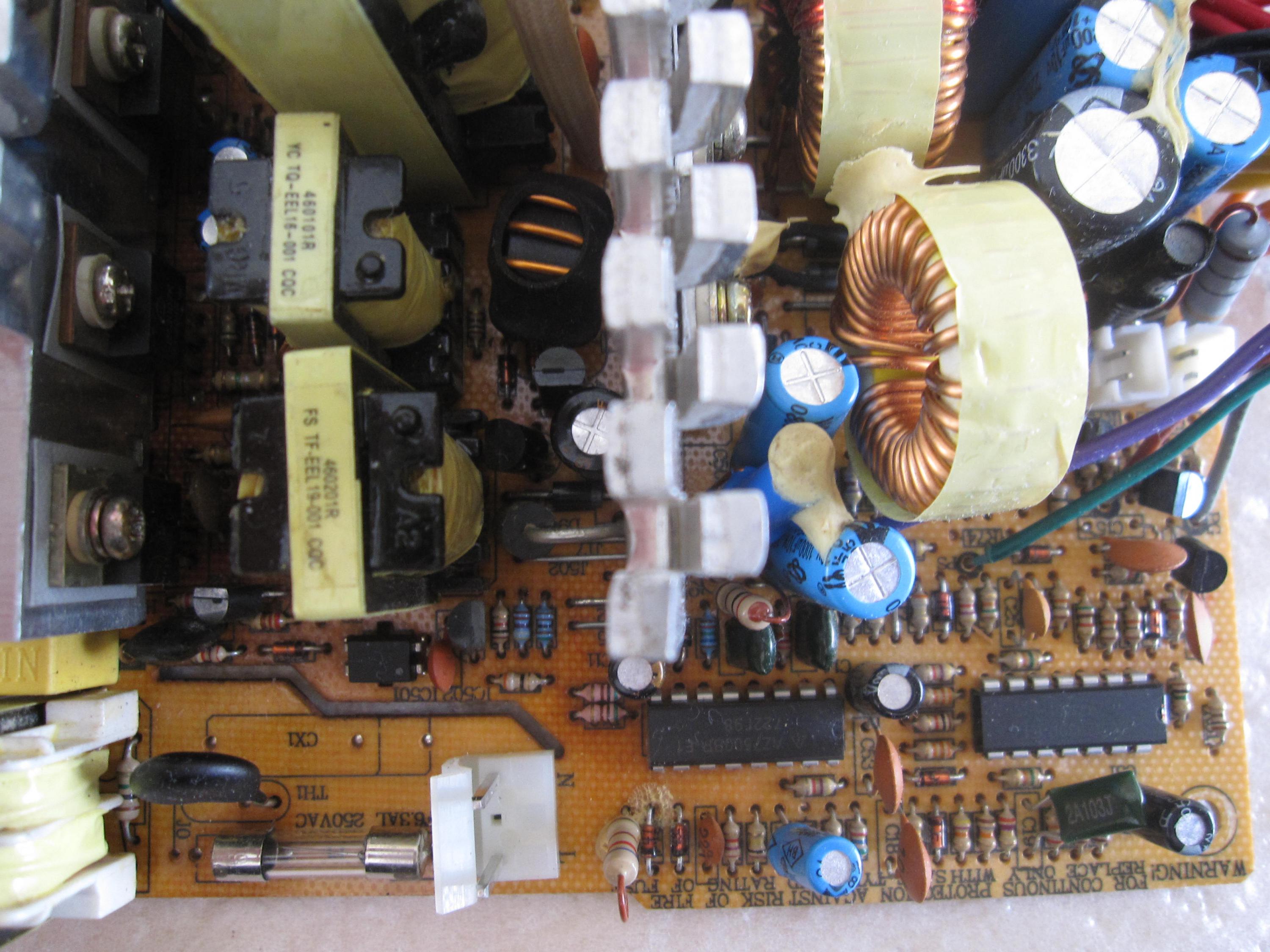

    I am trying to repair Trust 420W PSU, model PW-5210 (http://www.trust.com/en/all-products...ual-fan-pw5210).

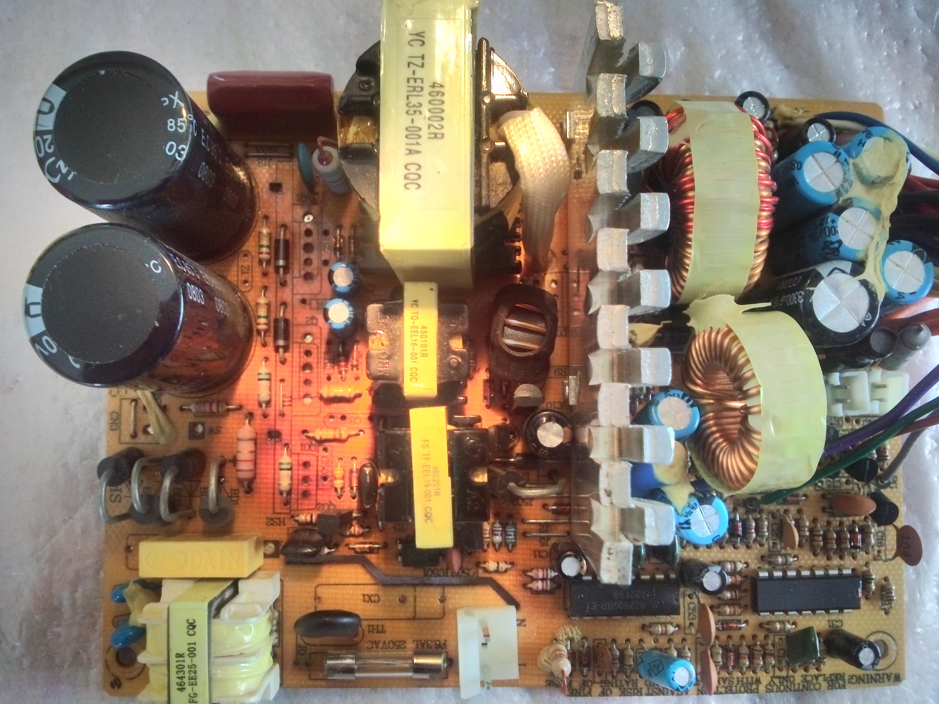

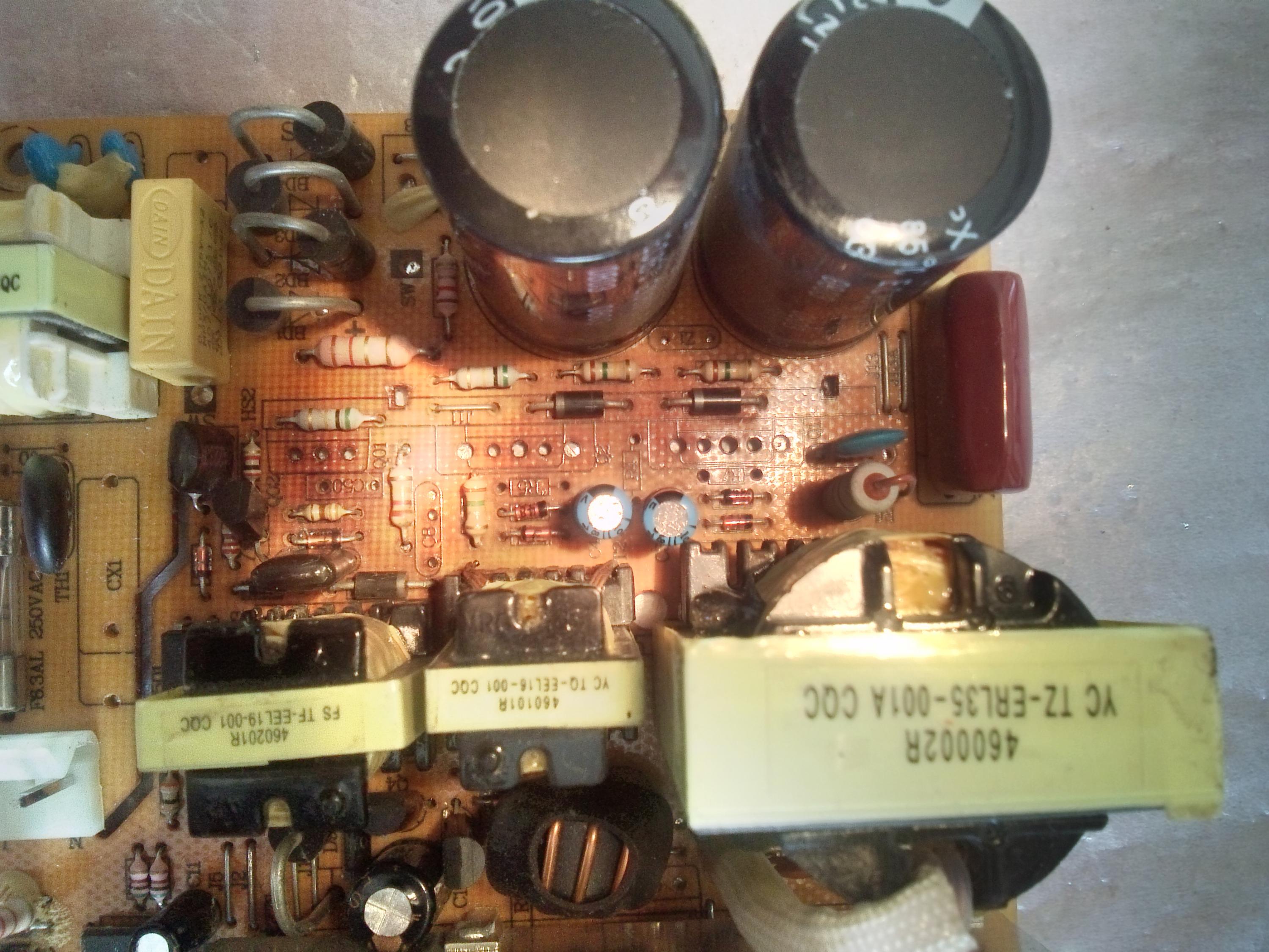

    When I checked the psu for the first time I founded in primary side:
    1. Glass fuse was blown.
    2. 2 x Power FET's MJE13009 was shorted.
    3. 2 x 0.5 Ohm, registors (R4, R5) was burned.
    4. 1 x Orange or Red + ? + ? + Gold, registor (R7).
    5. 1 x 472 1KV capacitor missing one leg.
    6. 2 x 10uf 50V was burned.
    1, 2, 5 and 6 replaced with new one.
    Because I couldn't found 0.5 Ohm (Green-Black-Silver-Gold) registor, I have used 2 x 1.2 Ohm.
    R7 registor measured as 10K with my MM but I am not sure if it's the correct value. I used 2.6K registor instead.
    When I switched on the psu with the light bulp in serial, I got in my psu tester +5vsb output only and no shorts.
    Ic's are AZ7500BP-E1 and AZ339P-E1.
    Can you please give me information to make it work? What else to check?
    Thanks in advance.

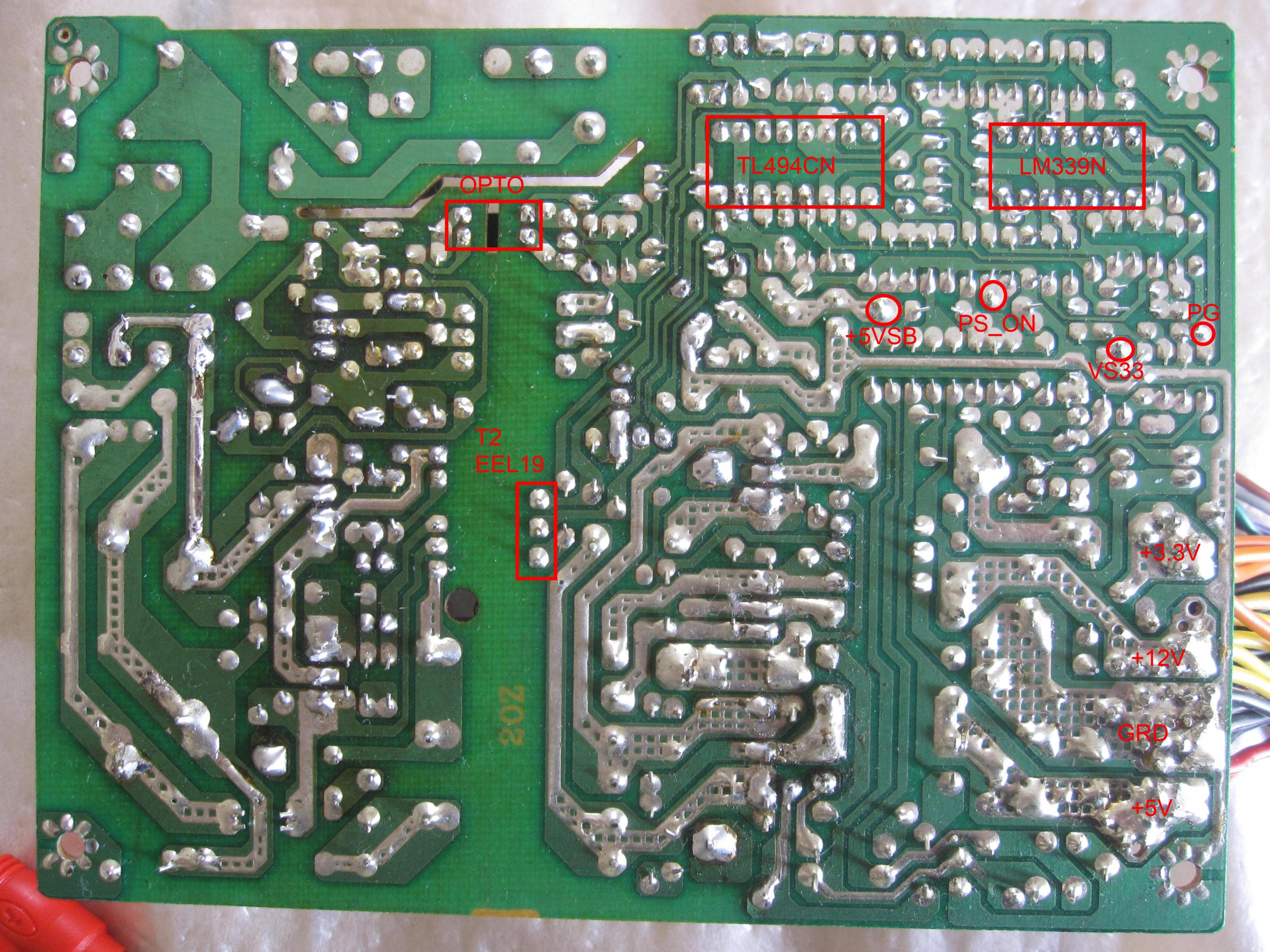

      I've changed both ic's with new one using TL494CN and LM339N but seems there was ok because voltages measurments was same as old IC's.
      IC: TL494CN (PS_ON state ----- PS_OFF)
      1: 0.5 m v
      2: 4.427 v
      3: 61.8 mv
      4: 34.6 mv --- 3.364v
      5: 1.496 v
      6: 3.733 v
      7: 0.5 mv
      8: 1.602 v --- 2.365 v
      9: 0.7 mv
      10: 0.6 mv
      11: 1.6 v --- 2.363 v
      12: 10.35 v --- 10.37 v
      13: 5.018 v
      14: 5.018 v
      15: 5.016 v
      16: 472 mv
      IC: LM339N (PS_ON state)
      1: 4.252 v
      2: 35.1 mv
      3: 5.018 v
      4: 1.248 v
      5: 0.792 v
      6: 0.6 mv
      7: 2.457 v
      8: 1.334 v
      9: 62.7 mv
      10: 1.1 mv
      11: 1.2 v
      12: 0 v
      13: 0 v
      14: 4.2 mv
      OPTO: (PS_ON state -----PS_OFF)
      pin 1: 5.079 v --- 5.075 v
      pin 2: 4.010 v --- 4.008 v
      T2 transformer (PS_ON state -----PS_OFF)
      pin 1: 1.560 v --- 1.617 v
      pin 2: 1.560 v --- 1.617 v
      pin 3: 1.560 v --- 1.617 v
      Green color at PS_ON state does not have voltage, but on switching off state has 5.015 v.
      When I shorted pin 4(DTC) with pin 7 (GRD) on TL431CN ic, psu didn't worked, only +5vsb output was ok.

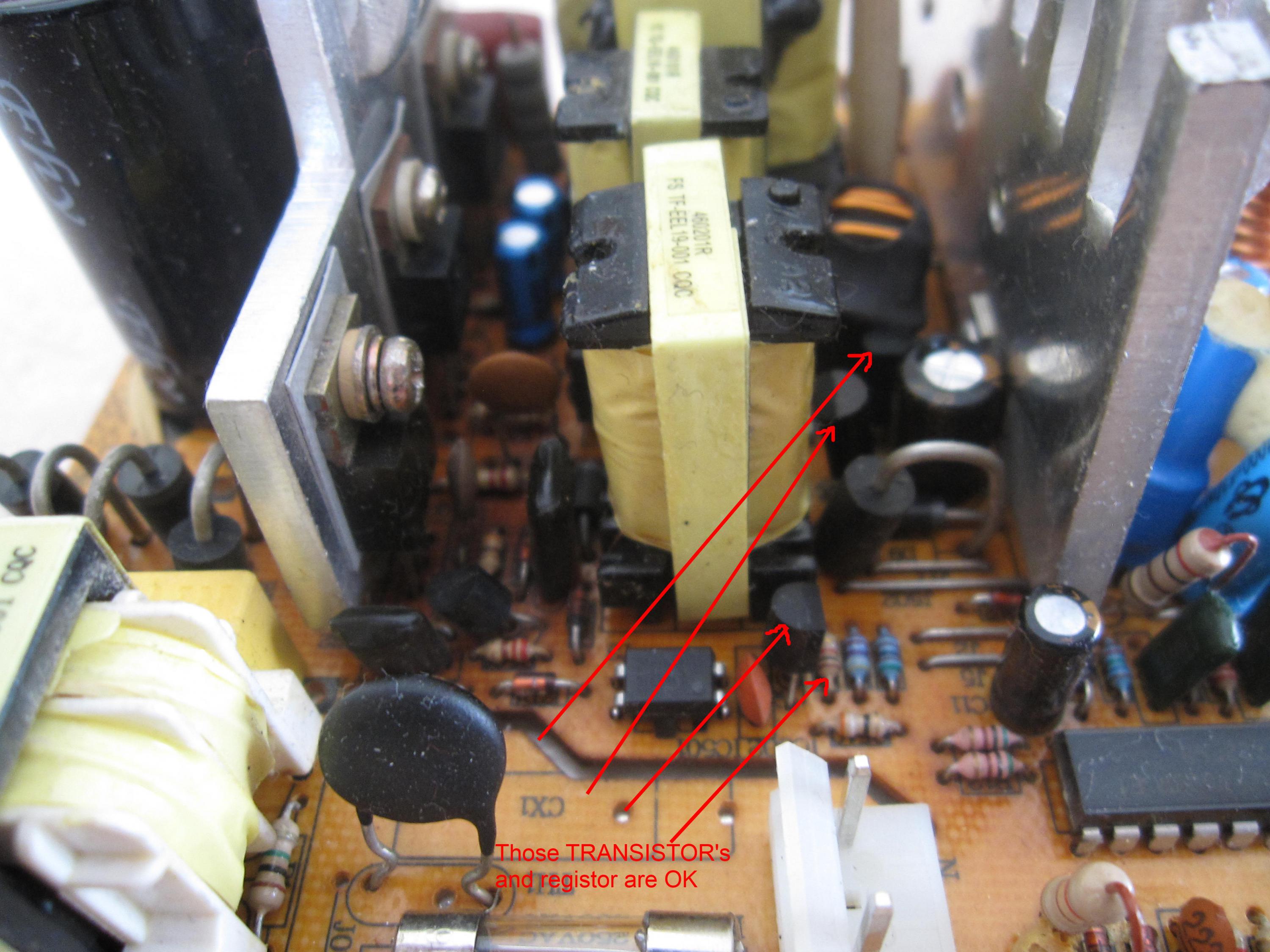

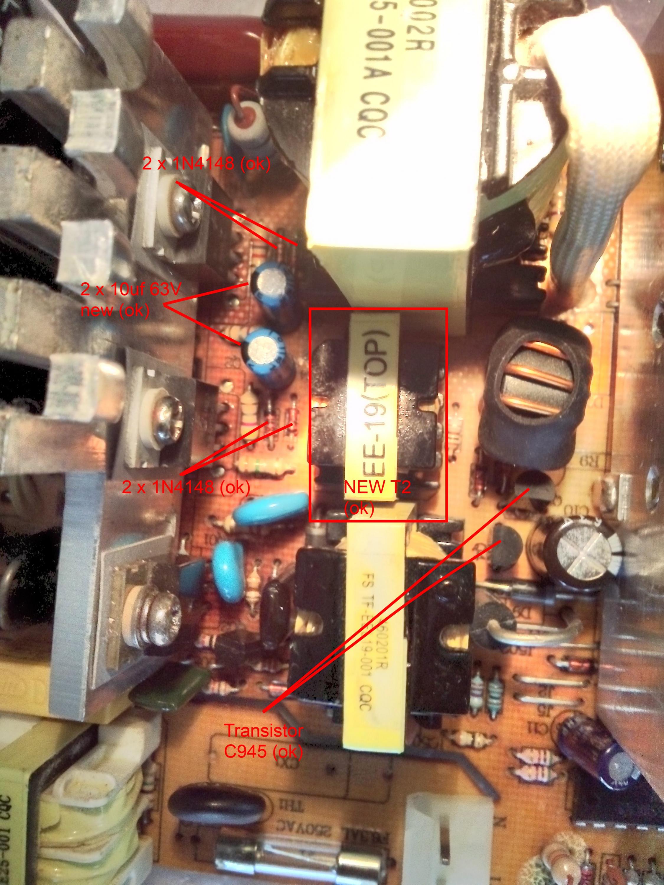

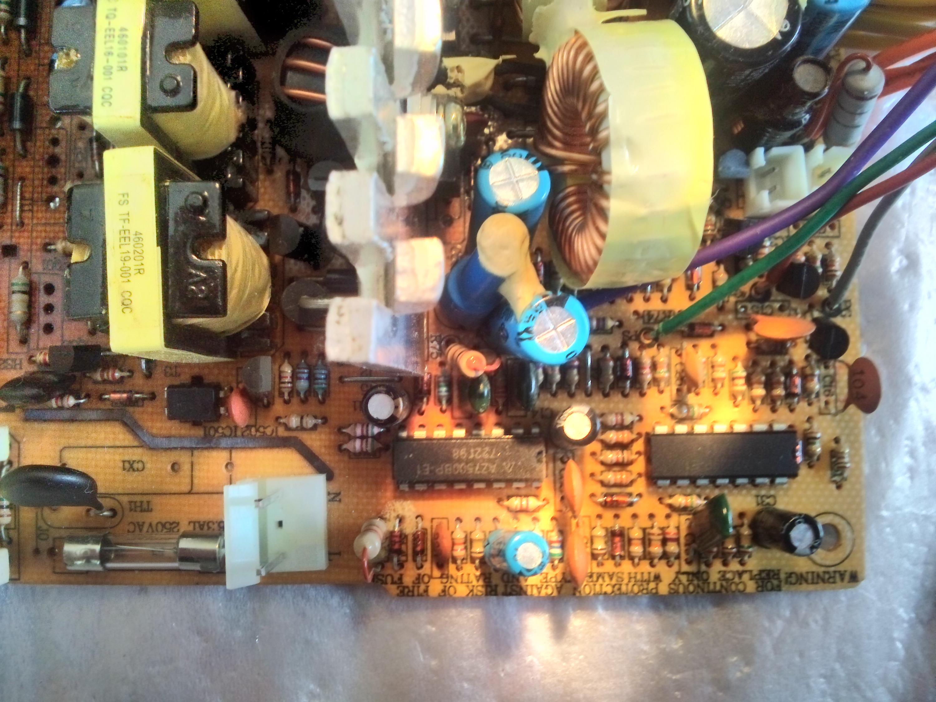

      Check the two switching transistors (C945/C1815)- are they ok or not .
      Checked most of the transistor's and those in attached image. Can I make some voltage measurement to verify that are working as expected?

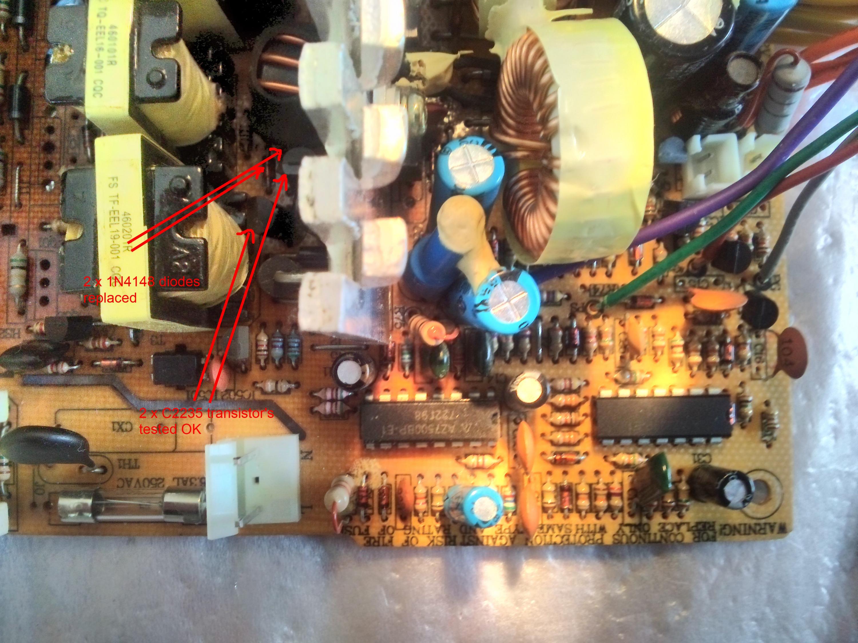

        Found 2 x 1N4148 bad and replaced, but still no go. Only +5vsb

            1N4148 are damaged but Surprisingly C2235 are survived !!
            When you are shorting 4+7 Pins, then what is the voltage in T2 Transformer Pin ??

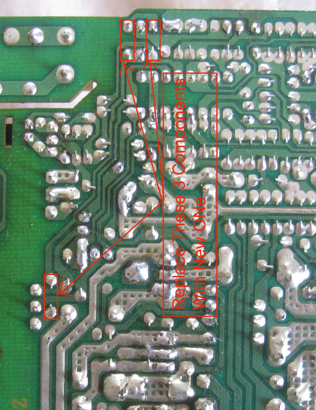

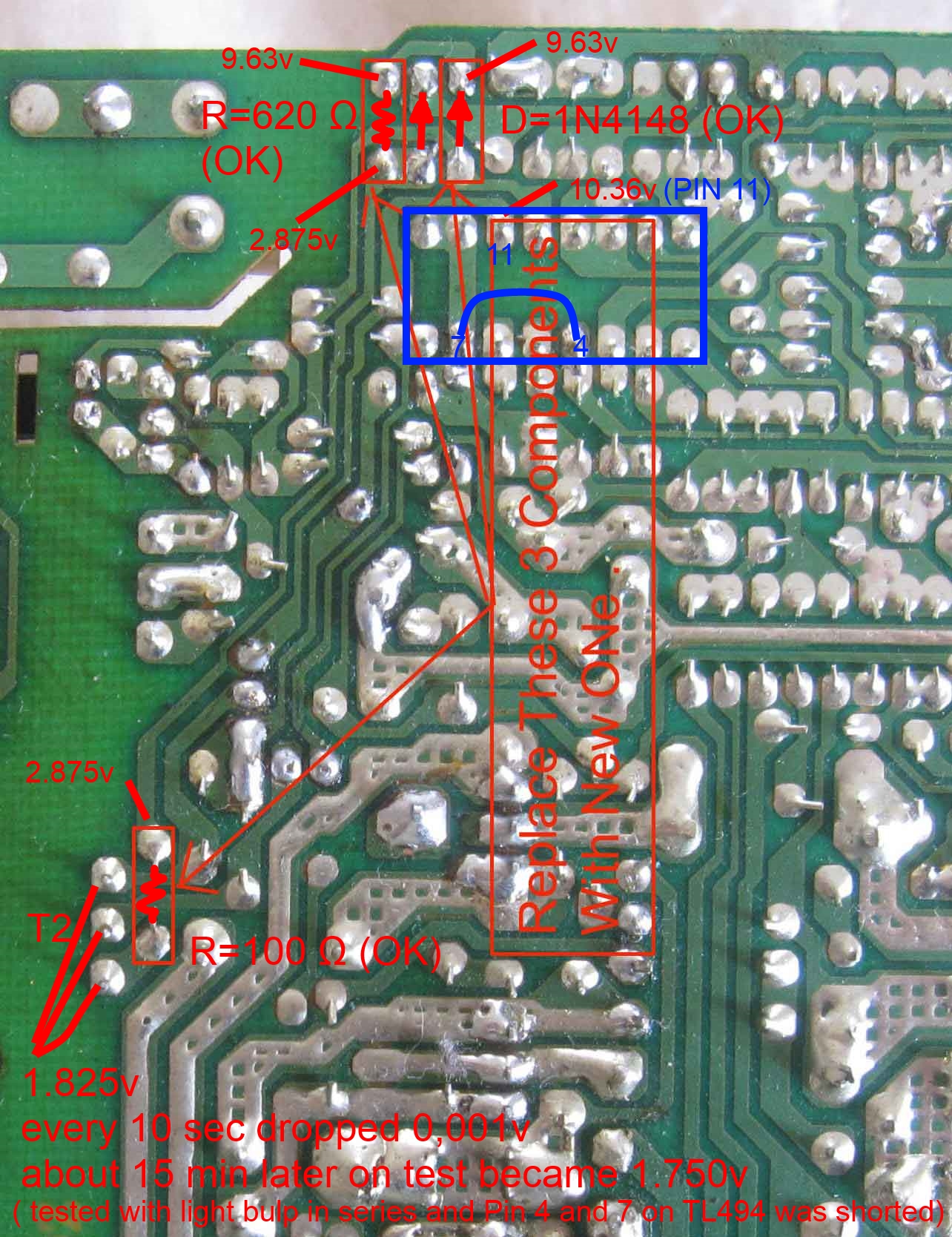

            Replace those Components with new one . Shown in the image . Let's see what happens .

              Re: Trust 420W PSU DUAL FAN PW-5210 only +5VSB output
              I shorted pins 4+7 and power on psu with light bulp in series using psu tester.
              Got +5vsb only.
              1. Fan no rotation as always.
              2. Voltage on T2 1-2-3 pins was 1.825v and produced 0.001v voltage drop every 10 sec. About 10-15 min later voltages was 1.750v.
              Desoldered 100 Ω, 620 Ω registors and 1N4148 diode tested and founded OK.

                I told you to replace those components .
                At the time of 4+7 what is the voltage at 8 and 11 PIN ??

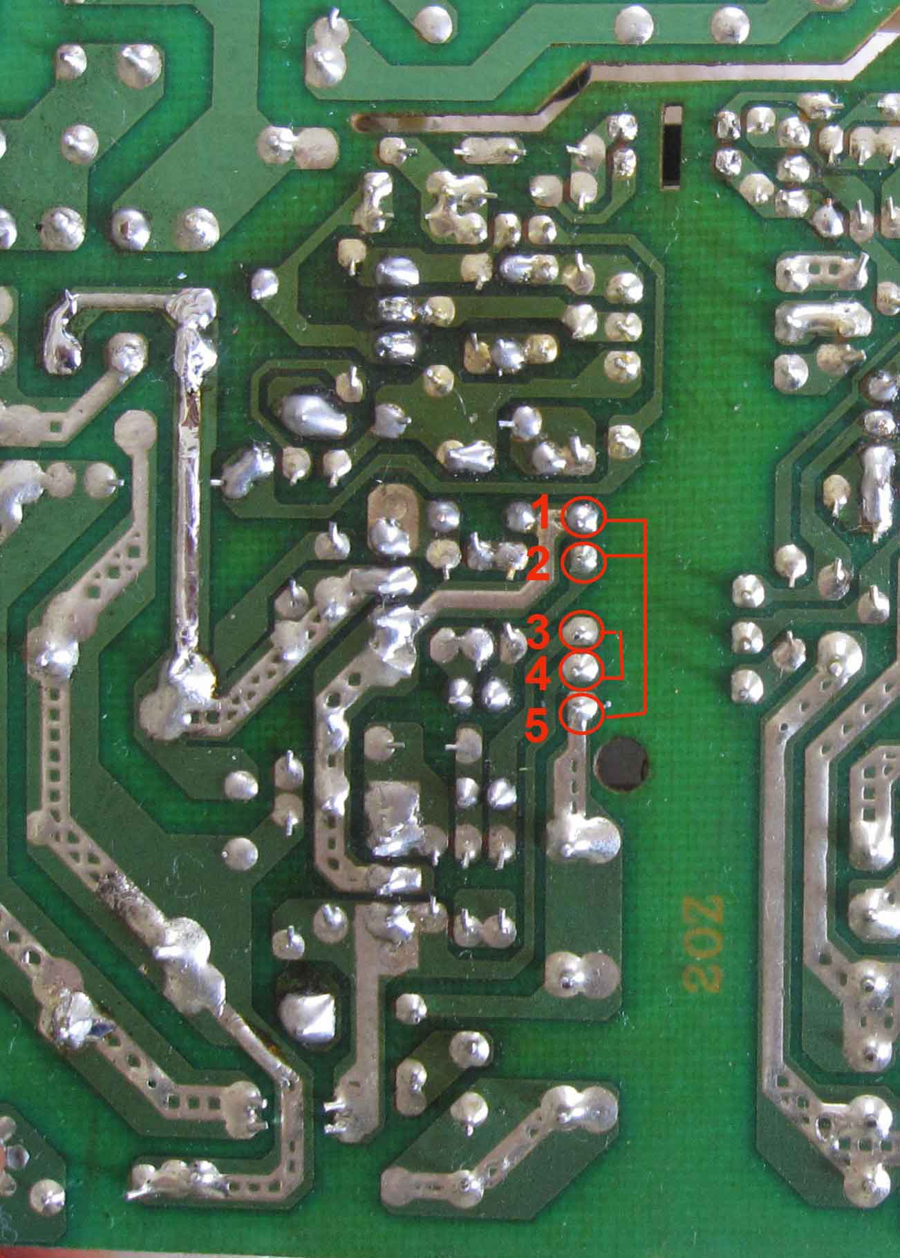

                Check the T2 Transformer - Is it ok or not ? 1,2 & 5 will give you continuity and 3 & 4 will give you continuity . Shown in Image "IM-01"
                As far as I can Remember - I repaired a Power supply which Transformer was same like as yours . I can remember that power supply was not running . Every Parts was OK but PSU was not turning on !! Then I changed the T2 transformer but Power supply did not run !! At last I changed the Main T1 Transformer and PSU Started running . But Meter is showing Transformer is OK !! My Meter is giving continuity in both Primary side and Secondary Side . No side is open . That transformer still is in my vault . I have uploaded the Picture of that Transformer "IM-02" .

                  Voltage measurements on TL494 IC was as following:
                  Pin 1: 1.3 mv
                  Pin 2: 4.930 v
                  Pin 3: 62 mv
                  Pin 4: 0.6 mv
                  Pin 5: 1.497 v
                  Pin 6: 3.706 v
                  Pin 7: GRD (0 v)
                  Pin 8: 1.591 v
                  Pin 9: 0.6 mv
                  Pin 10: 0.6 mv
                  Pin 11: 1.581 v
                  Pin 12: 10.37 v
                  Pin 13: 5.012 v
                  Pin 14: 5.012 v
                  Pin 15: 4.018 v
                  Pin 16: 517.8 mv
                  T2 Voltage on pins 1-2-3 was 1.751 v and continuity test was exactly as you refered.

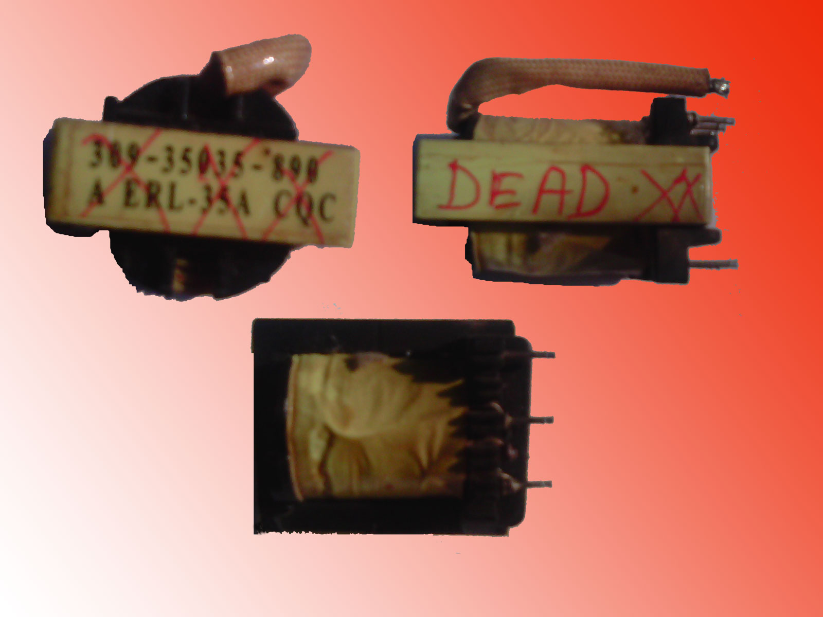

                  Unfortunatlly I don't have this type of T1 transformer to try it out.My meter gives continuity in both 1-2-3 primary pins and 1-2-3-4-5-6 pins on secondary side.

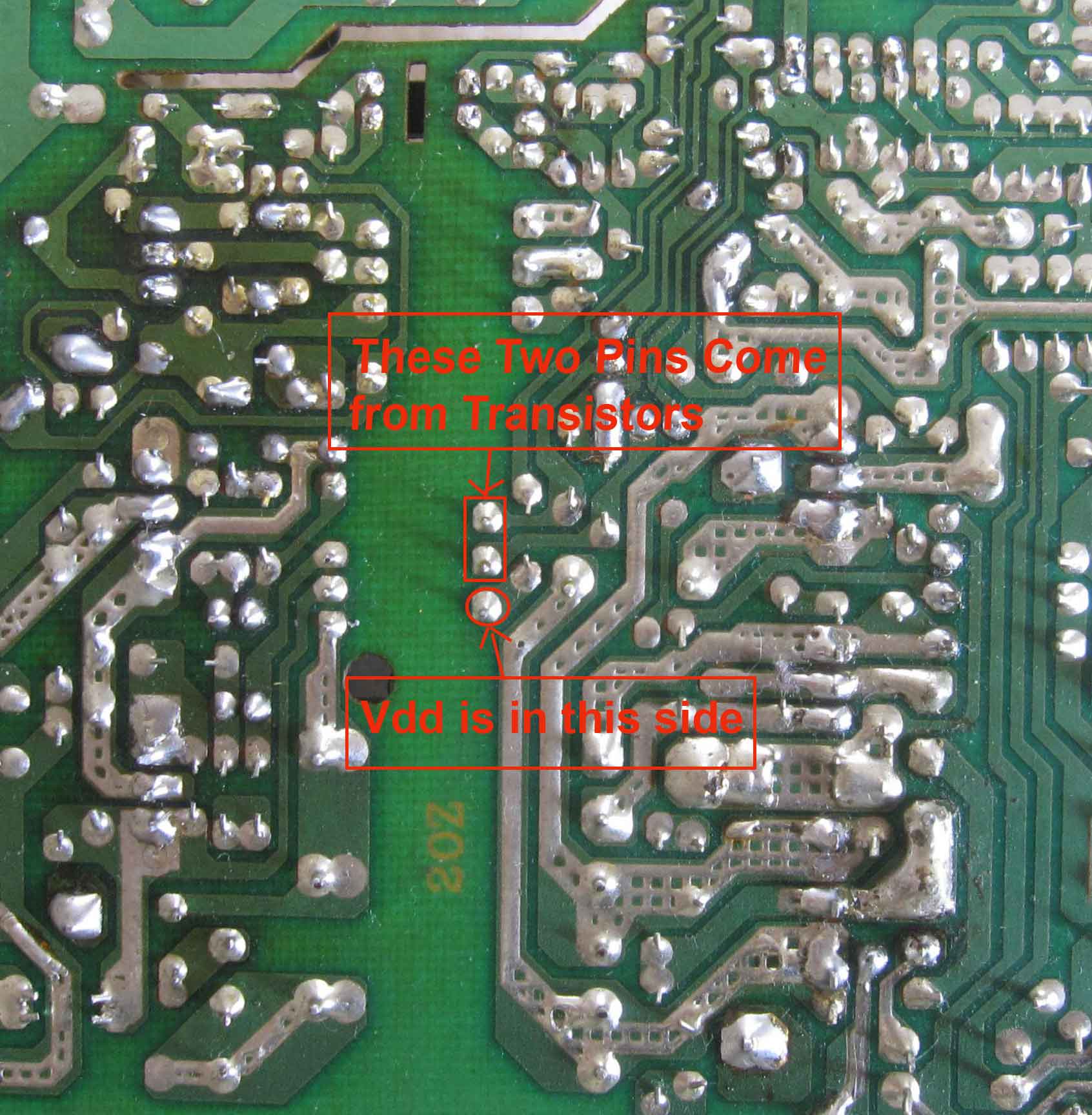

                    Your TL494 is switching properly . The Problem is laid after the IC to T2 Transformer . First Replace the Switching Transistors C2235 With C945/C1815 . Let's see PSU runs or not .
                    Still the PSU is not running then change the T2 Transformer . I think it will solve your problem . To change the T2 Transformer you must be careful that Vdd will be in side position and other two pins will connected with switching transistors . Shown in Image "IM-03" . And Primary side's Pin Continuity will also match with the Original one .
                    By the way - In primary side All Parts are OK ?? I mean Four 1N4148 Diodes and two capacitors which you replaced - are they in right direction ??

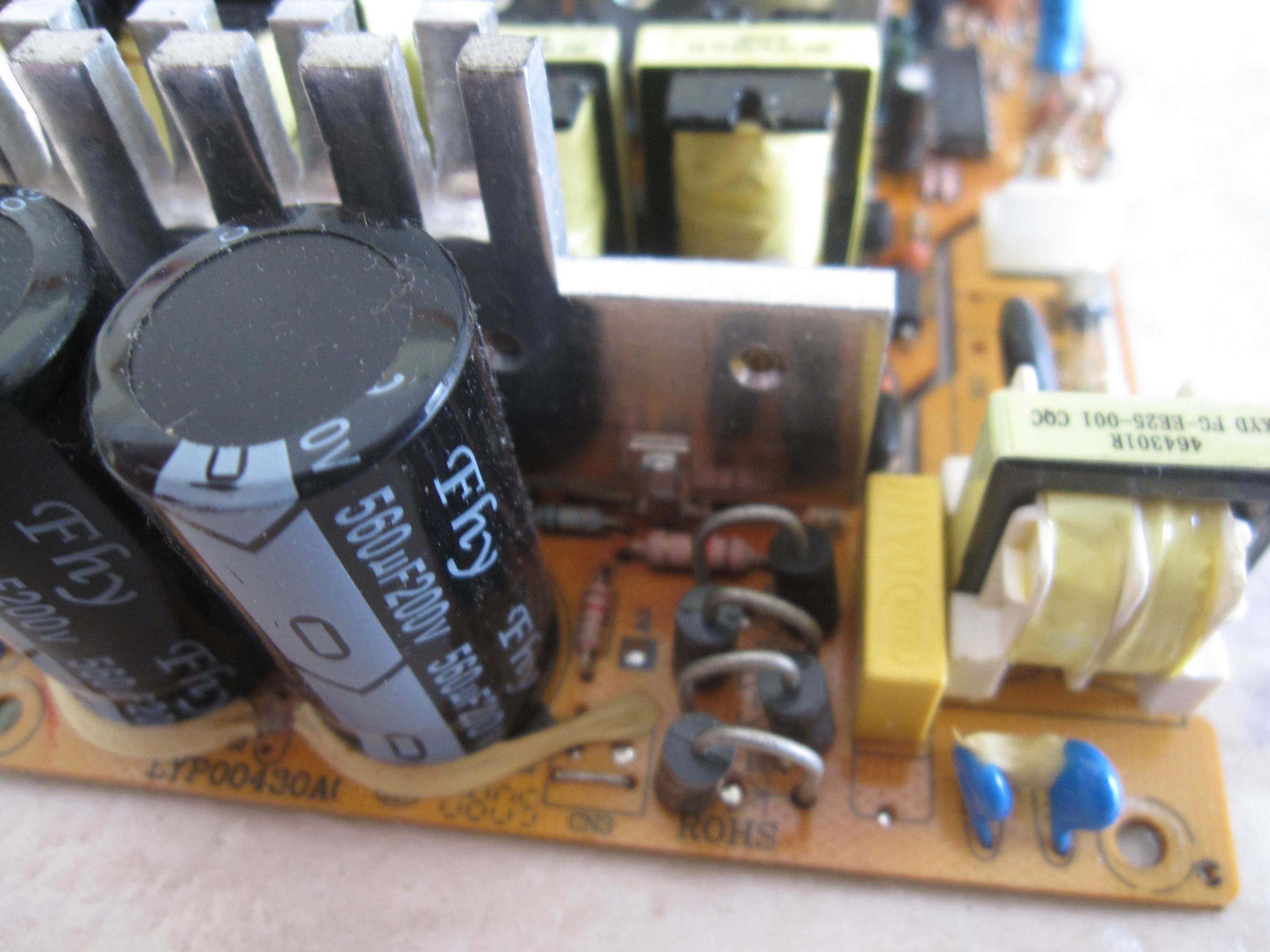

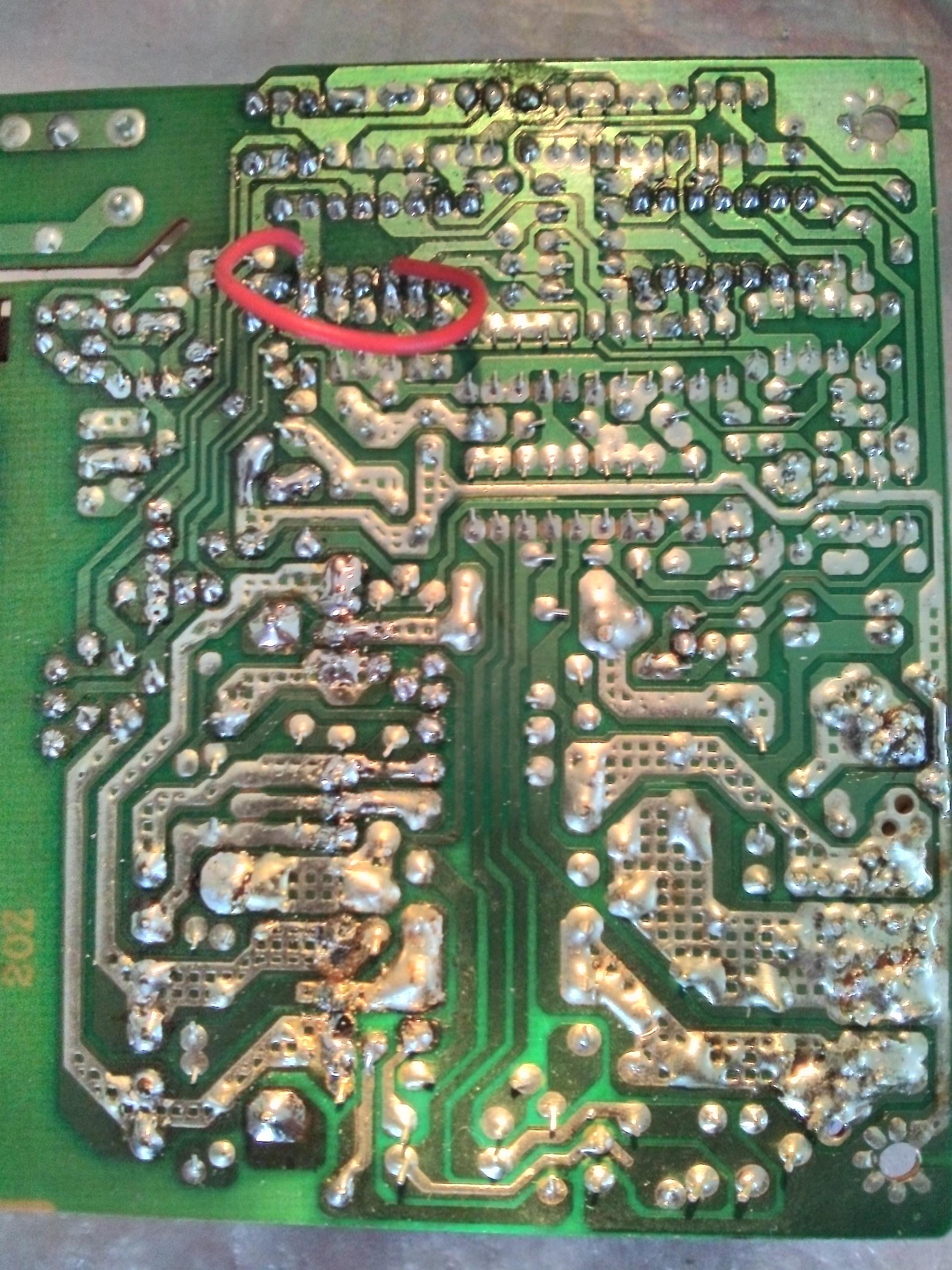

                      Used another T2 transformer with same continuity and got same voltage output (see image [470]). Problem remain.
                      Test out of circuit 4 x 1N4148 diodes and was ok and the new caps direction is ok too (negative polarity is facing pFET's).
                      Probably the problem exists on T1 transformer as you mentioned before.
