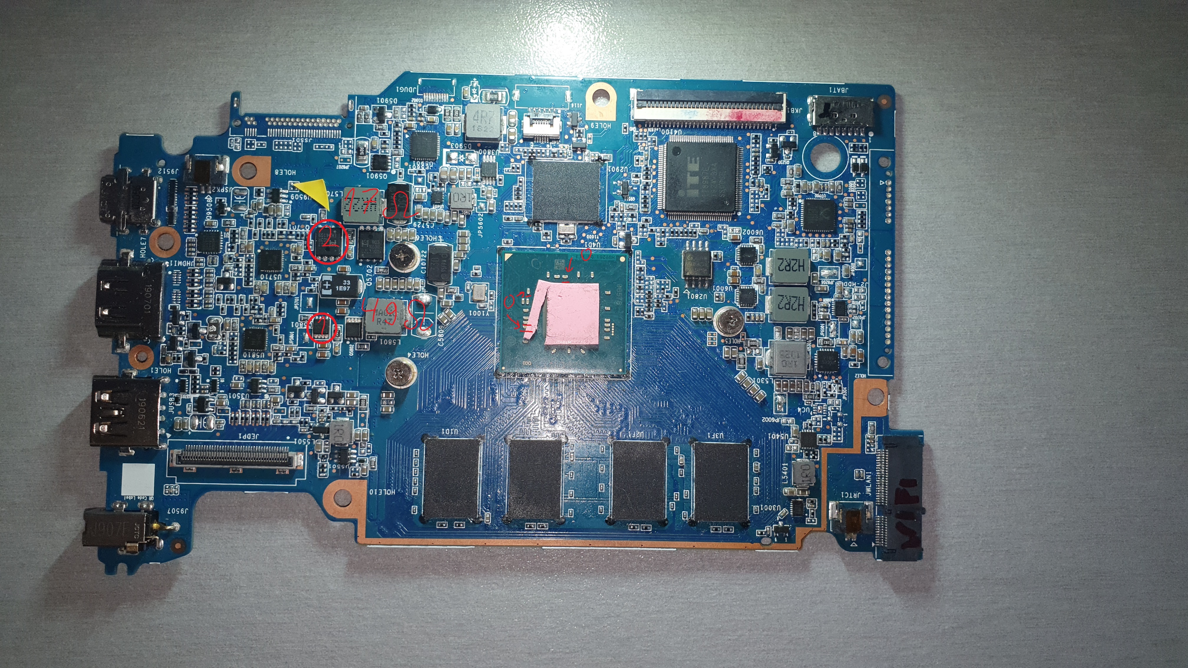

    Good day.
    I'm trying to figure out what's wrong with a Lenovo Ideapad S130 motherboard. When I connect it to the bench PSU and limit the supply to ~2.2A (about the limit of the lenovo stock PSU), the board absorbs all the amperage and the voltage on the PSU drops down to about 4-5V.
    The components on the board that get hot are the two mosfets ( 1 and 2 on the photo ) and the CPU. The resistance to ground measured on the power rail coils can be seen on the image (~17 and ~50 ohms). On the top of the CPU there are few caps which measure dead short. I checked all caps on the top side of the board and did not find anything suspecious.
    I guess this means that the CPU has shorted, but people say that the CPUs usually have low resistance.. but wasn't able to find what exactly "low" means.
    Thanks in advance.

    It'll be wiser if you check resistance to GND on CLR and all big grey coils(no power attached).
