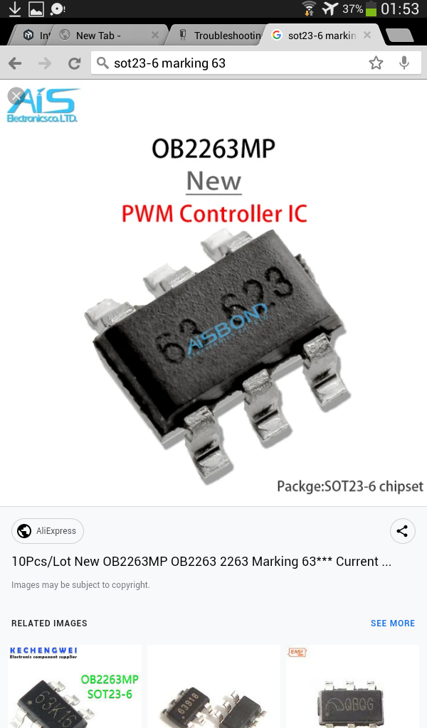

    Hi There got one of these projectors with no power after stripping down the power supply the main fuse on the board has blown and the n-channel MOSFET is shorted so need to replace the small 6-pin ic but not sure about the ic number 63 523 also the values of the resisters that are blown r24 r28 r29 r30 and also if there is a compatible to the MOSFET KEF5N65
    Thanks for any info

    R24 is 0 ohm
    Other R28,29,30 are same 1R2 (1.2 ohm)
    IC is OB2263MP
    For mosfet not sure...

      For the MOSFET match something up for “5N65”.
      https://www.digikey.ca/en/products/d...N65APBF/812289
