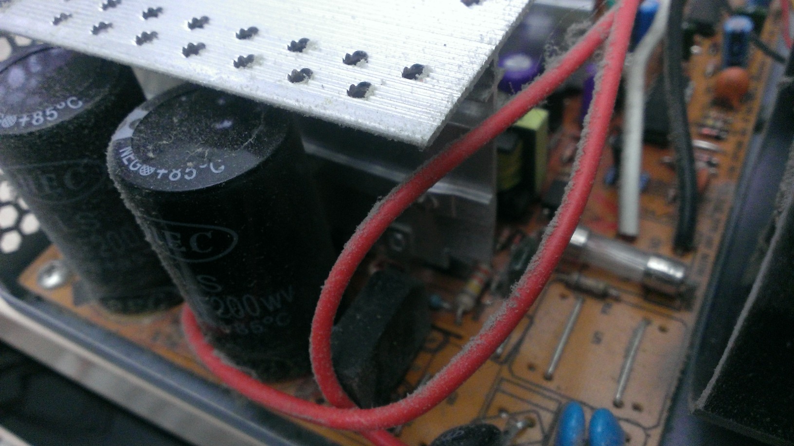

    So I needed to assemble some budget servers for a couple clients that wanted to pay less... and to save on cost I'm using random PSUs I already had...
    Antec Basiq 500W
    Antec True 380W (partially recapped at some point)
    LiteOn 250W

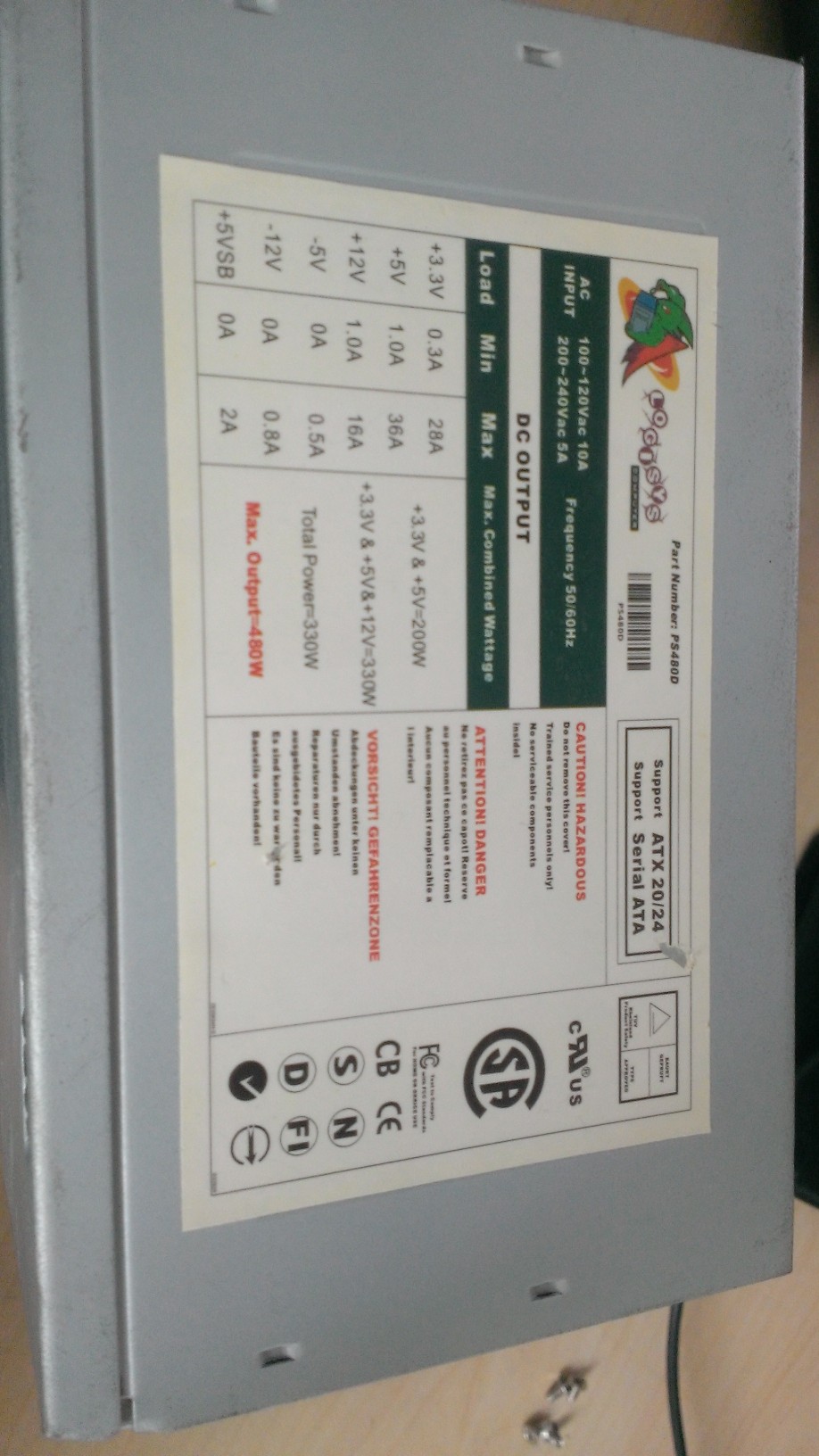

    Logisys "480W" lol... <-- gutless wonder
    HEC Orion "585W" lol... <-- slightly less gutless wonder but absolutely no input filtering
    The Logisys was in a friend's server for several months working fine... pulled from a customers old PC. So it's certainly been tested to be functional :P the Orion came from somebody online basically paid nothing for it. Good choices? :P

          Even with Logisys, it depends. Some of their "higher end" units are made by Keerda and will probably be okay up to 275W. At least some of those have CLC on each rail. They're still not reliable with crap fans and BH caps but better than their super low end ones with one cap per rail.
          The Basiq is an old FSP unit that runs hot and will toast the Teapo caps.
          I wouldn't touch the TruePower without a FULL recap, period.
          The LiteOn 250W is probably well built but probably also needs some new caps.
          That HEC Orion is a mediocre 350W PSU. I'm sure you've seen the one I rebuilt, I have it in a light server But I did a full recap and added an input filter
          Would love some pics

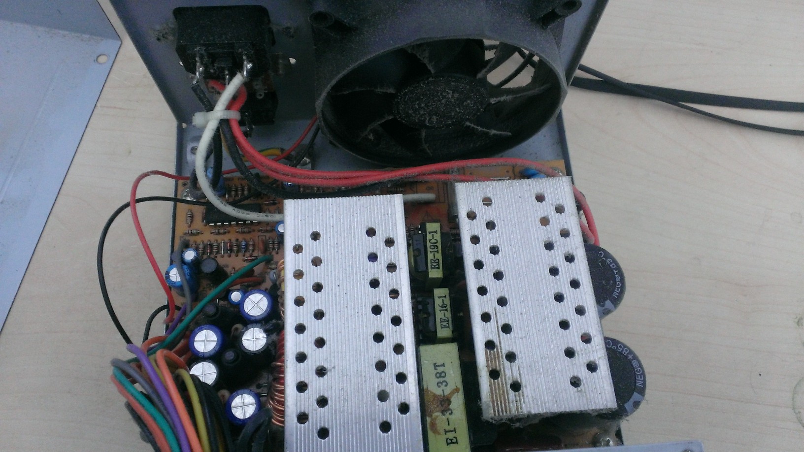

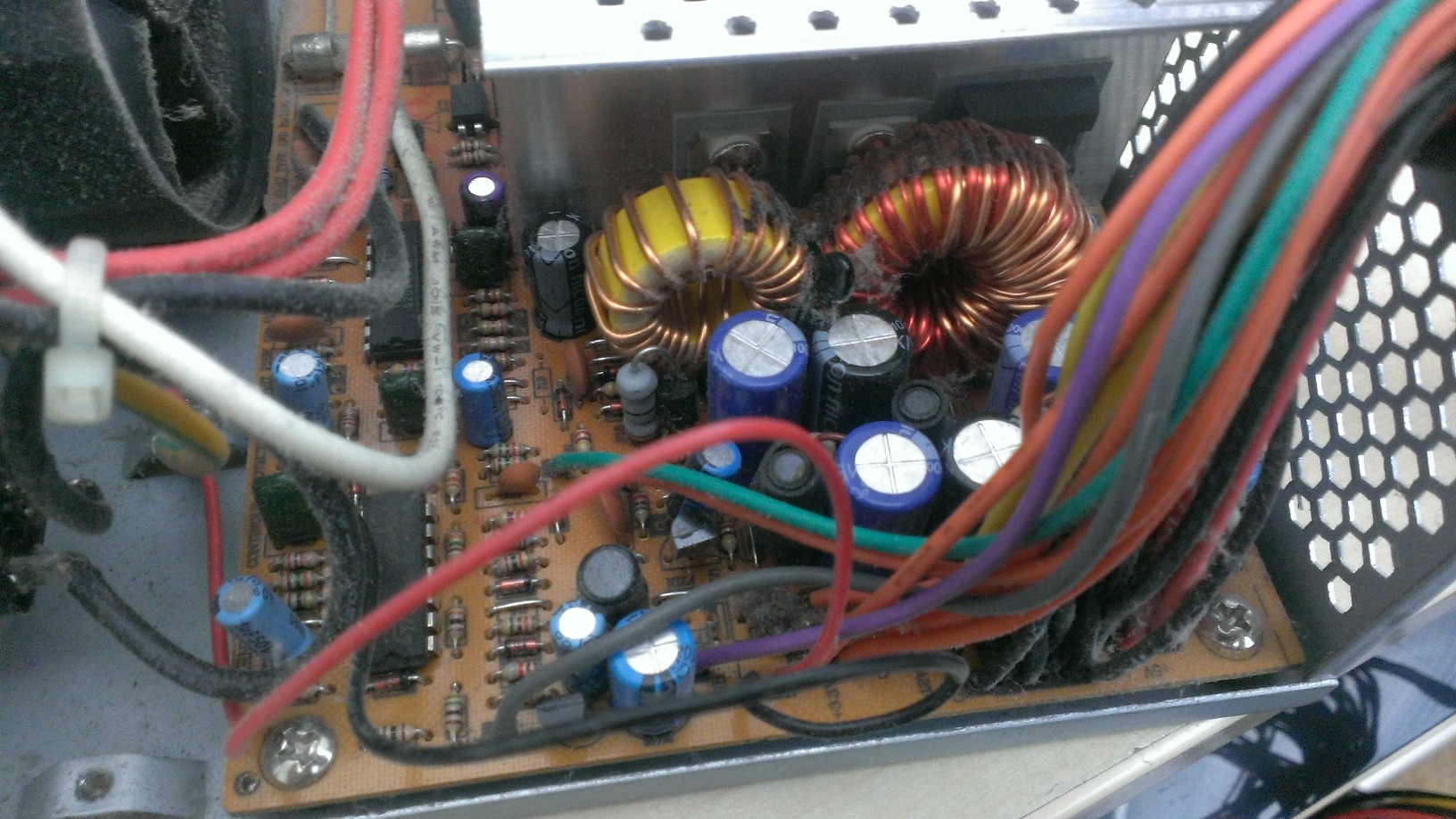

            Logisys pics

              150w-250w max. with 60-70% efficiency.
              Usually efficiency is important for dedicated servers... don't you pay for Amps for the rack?

                  That thing (I'm not even going to call it a "power supply"... it looks more like a "fire supply" or a "ripple supply" depending on what goes first) looks only slightly less gutless than "Hercules", whose review ended with "If you have one of these, shut your system down and throw it away. NOW.".

                        Junk caps, junk fan, laughable input filtering, tiny heat sinks, all the usual things wrong with a cheap and nasty unit. Working or not, just get that thing out of the computer and sledgehammer it already!

                              Not only is that Logisys horrible, it also looks like it's already had quite a bit of running time. Who knows when those cheap nicon caps will pop. I'd also be worried about how much oil is left in the bearing of that cheap fan
