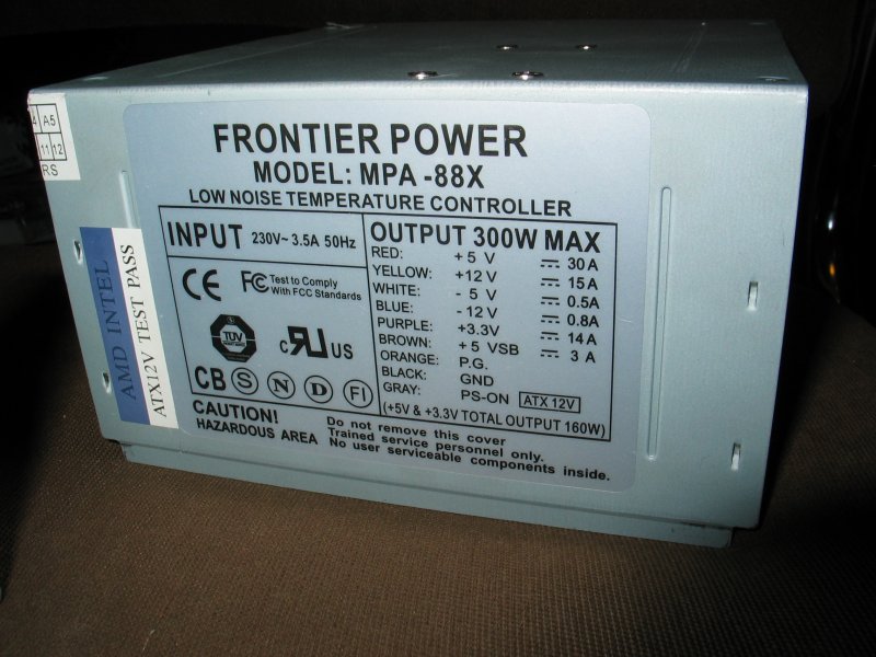

    Typical Macron Power label and blue-white ATX12V sticker:

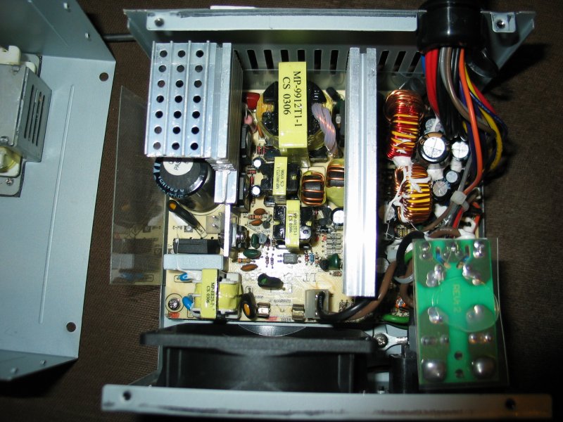

    Overall view:

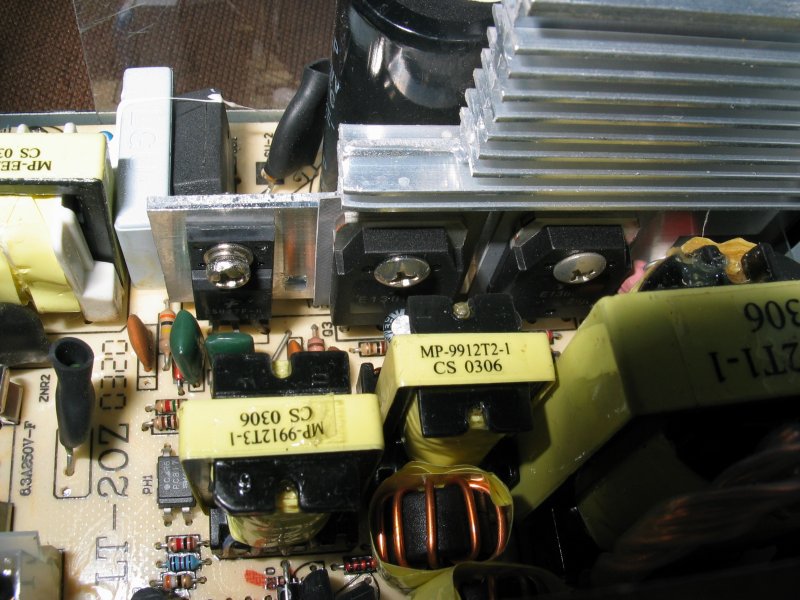

    G-Luxon and JPCE-TUR and maybe something else (don't remember) - everything OK:
    Nice big transistors:

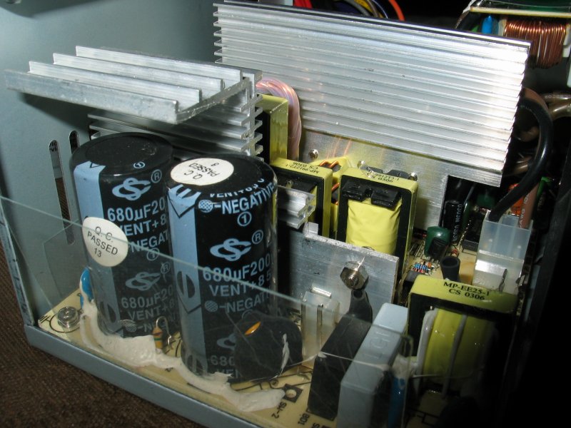

    680uF caps:

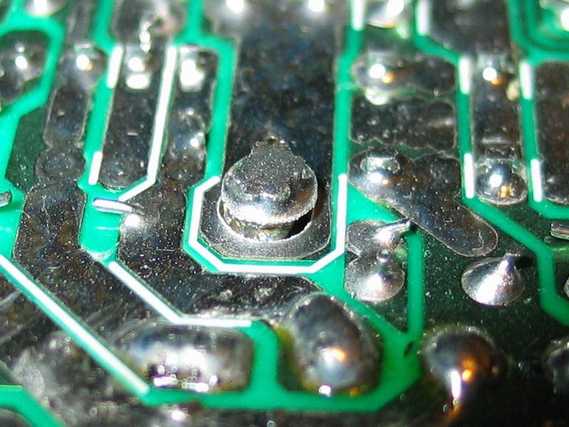

    And this is why I got it - a big broken solder joint on the transformer ground:
    It works fine after resoldering that.

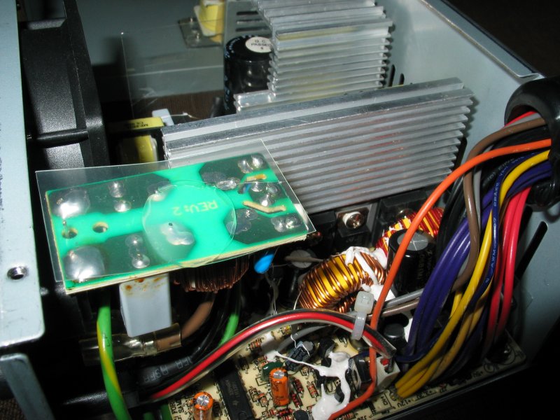

    It's really heavy - even with the top cover (with attached PFC inductor) removed.
