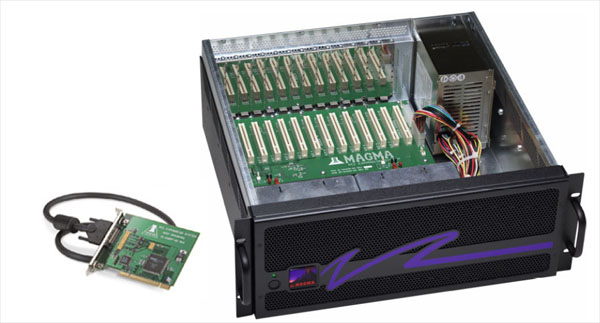

    I have an PSU out of a Magma PCI Expansion Chassis. The name on the PSU is 3Y Power Technology. Only the company shows up on a Google search. Not really a whole lot of info.
    The reason I'm trying to get info on them is that we are having problems with out expansion chassis. It is a 14 slot chassis and all 14 slots are being used (actually there are only 13 available slots, but I included the host card). Anyway, we are having random failures. (Tech support calls them "panic attacks". Great...now we need psychiatrists to fix computer equipment. )
    The expansion chassis has 13 cards used for communications links. Each card has 8 links that go to modem splitters.
    Ok...my theory is that the 420W PS (+3.3 along with +5 cannot exceed 220W) is not supplying enough juice.
    If I can get into this PS further, I will post more info.
    Oh yeah...another weird thing is that it has the normal ATX connector, but then it has a second ATX connector with just 1 red, 3 black, and 2 grey wires. The only connectors used in this application are the two ATX connectors.

              ...i still wonder if maybe there's too much draw on the PCI bus of that expansion chassis. do you know what that second ATX connector is for??
              basically, i'd like to find a 600W PS that would go in there. but it has to have that damn second ATX connector. ugh...i should have paid more attention in PSU school

                Magma 13 Slot 32-bit/33MHz PCI Expansion Backplane (Part Number 01-04625-00)
                Dimensions and Electrical Pin-Outs
                well it says that both ATX connectors are in parallel? i have seen a few oem solutions and they are using just one psu. looks like the J16 ATX is the main power connector and the J1 is for the second ATX coming from a psu unit with redundant capability
                if your unit has one psu with two atx connectors and two power cords then its probably a redundant psu (strange that it doesnt have all the wires though). if you want to replace then best get a server grade one like supermicro or zippy (supplying good 5v, 3.3v) not an overclock special.
                anyway check the pinout of your second connector wires and see what its doing.
