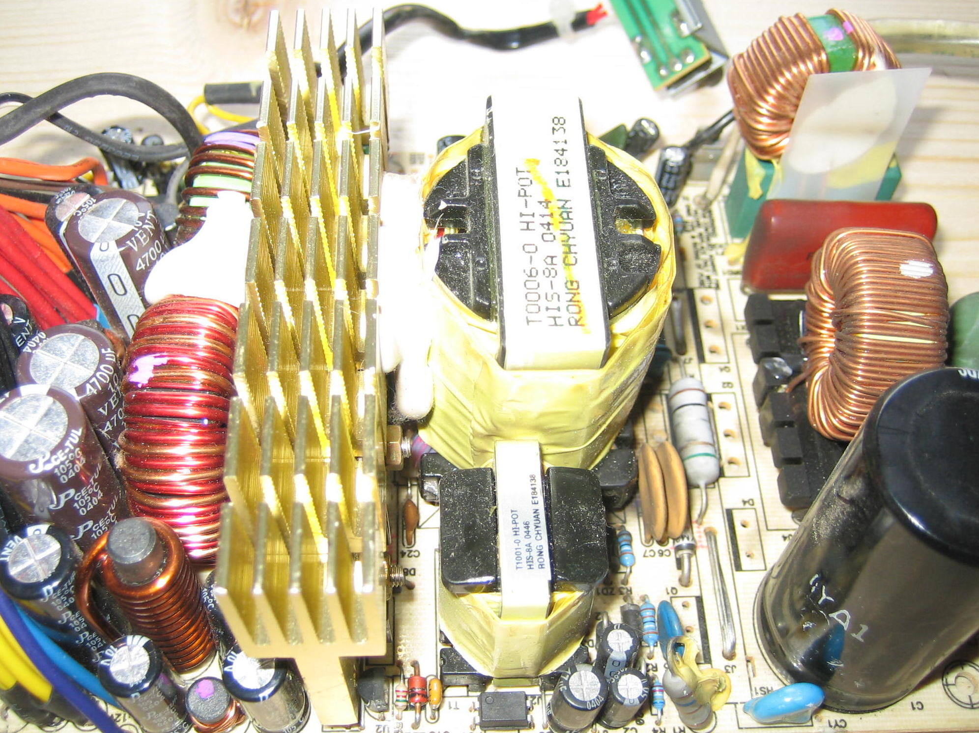

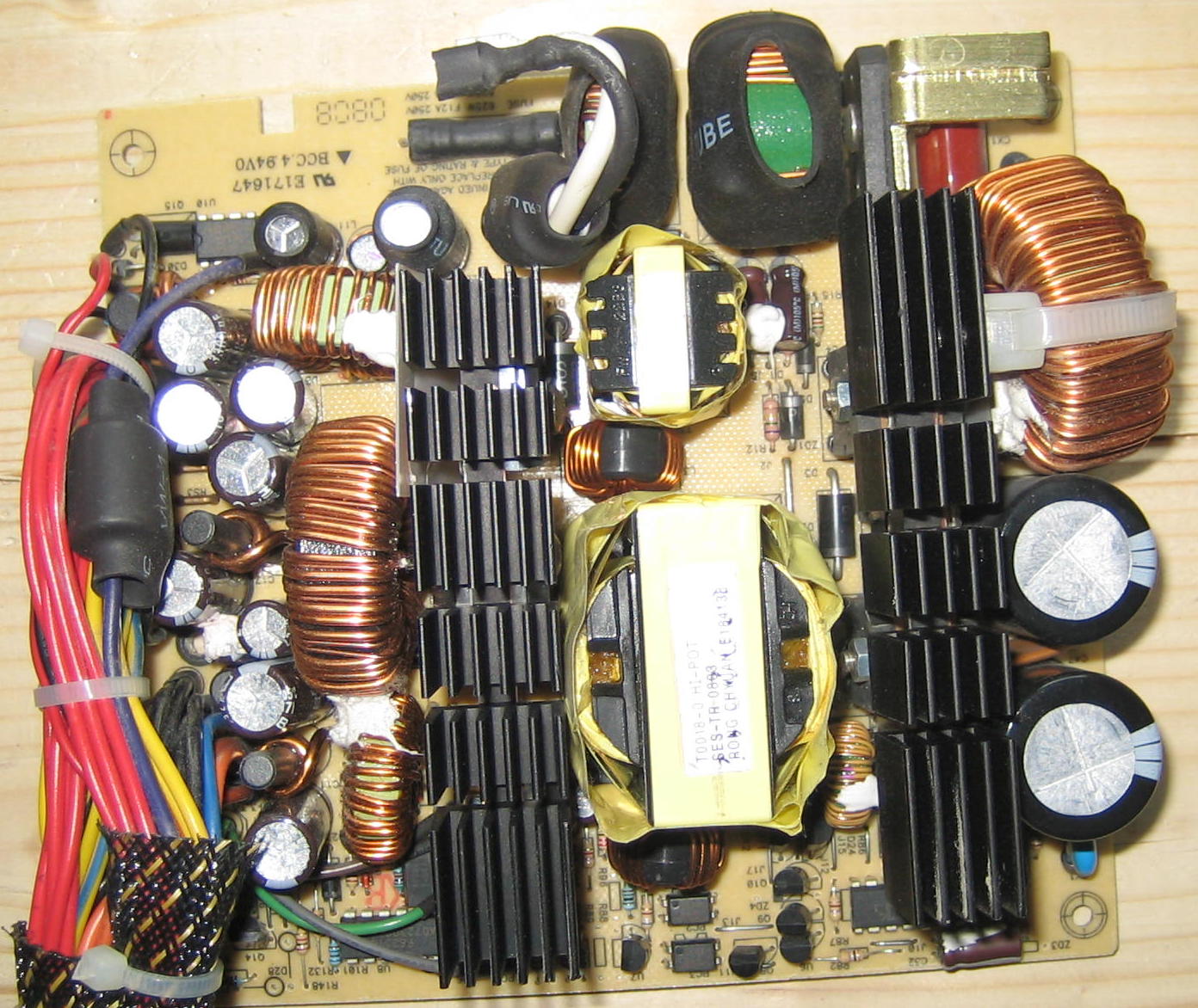

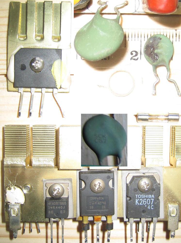

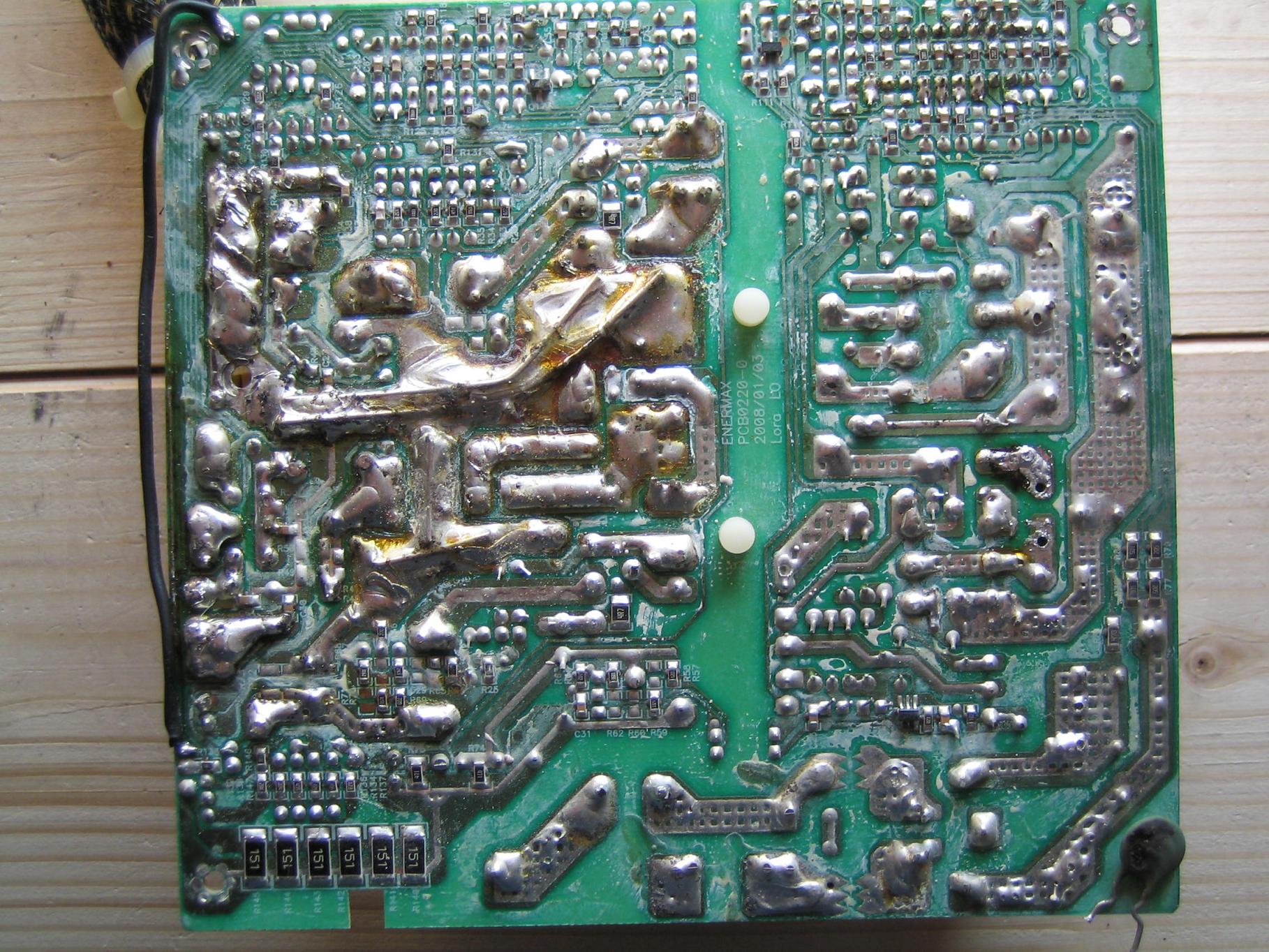

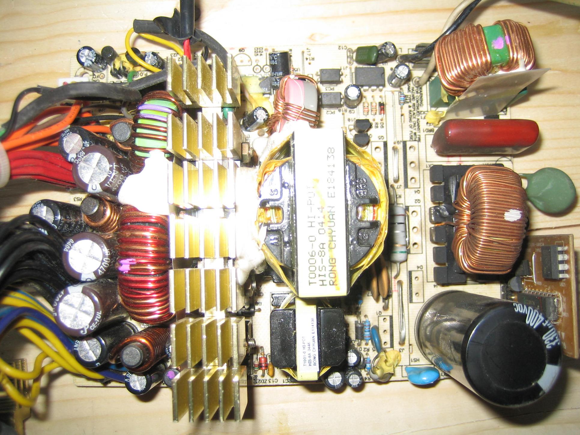

    Hi, I have two ENERMAX failure in repair, a PRO82 + and a EG565AX-VE.
    In PRO82 + burned the THR1, is unreadable.
    The Fusiblie is OK.
    In the pictures are not known, but the R8 has a sign on the fusion with lead.
    Maybe by replacing only the THR1, you might solve the problem.
    However for security, I would like to remove R8 and put an insulator on the lead.
    I checked on-board the primary and is not shorted.

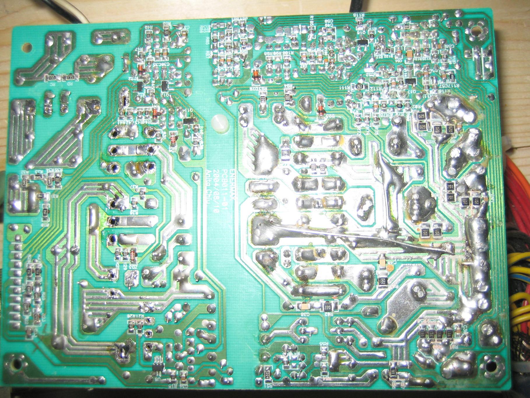

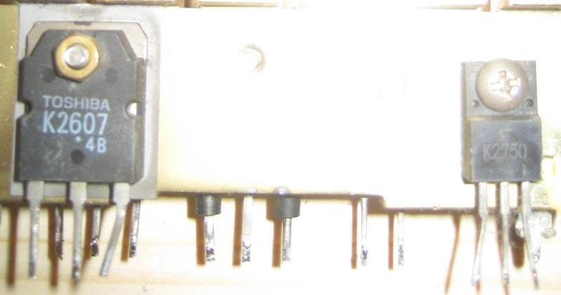

    In EG565AX-VE I vaporized fuse with D4 and Q2 shorted.
    The D4 is a HFA08TB60 (600V 8A).
    The Q2 is a IRFP460A (500V 20A).
    The fuse is a 8A, but in PRO82 + is 10A.
    The fuse of the EG565AX-VE, could be from 10A?
    Is anyone able to give me a help, for the THR1 PRO82 +?
    Compared to the EG565AX-VE THR1 (SCK 057), PRO82 + is smaller then what would?
    Thanks Greetings
