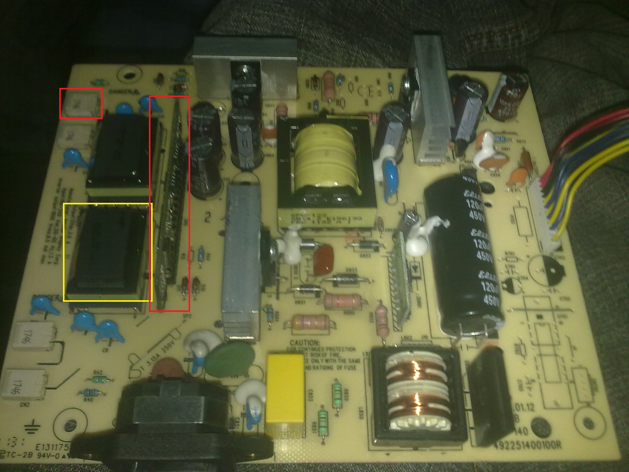

    HP Compaq LCD Moniter Q2210s
    My lcd had a problem that it,s display goes after about 2 or 3 secs .. First i claimed it,s warrenty and this problem comes again after 5,6 months.I gave it for repairing and now it displays white screen for 2 or 3 secs and problem become worse.Then I decided to repair it myself :p ... I think that there,s some problem with following highlighted components.Kindly guide me what should I do ????????????????

    Re: HP Compaq LCD Moniter Q2210s
    OK - Pic is not really clear enough - needs to be taken in more light.
    What is the number on top of the grey rectangles with yellow stripe
    (inverter transformers) marked in your picture.
    On the right near the connector is that a torpedo fuse - can you check it.
    Do you have a multimeter and soldering equipment.
    What is the part number of the board?
    Do you know what was replaced under warranty?
      White screen because the Video signal cable
      to the panel is not connected or seated correctly?
      Are the two backlight transformers
      secondary windings equal to each other
      in resistance?

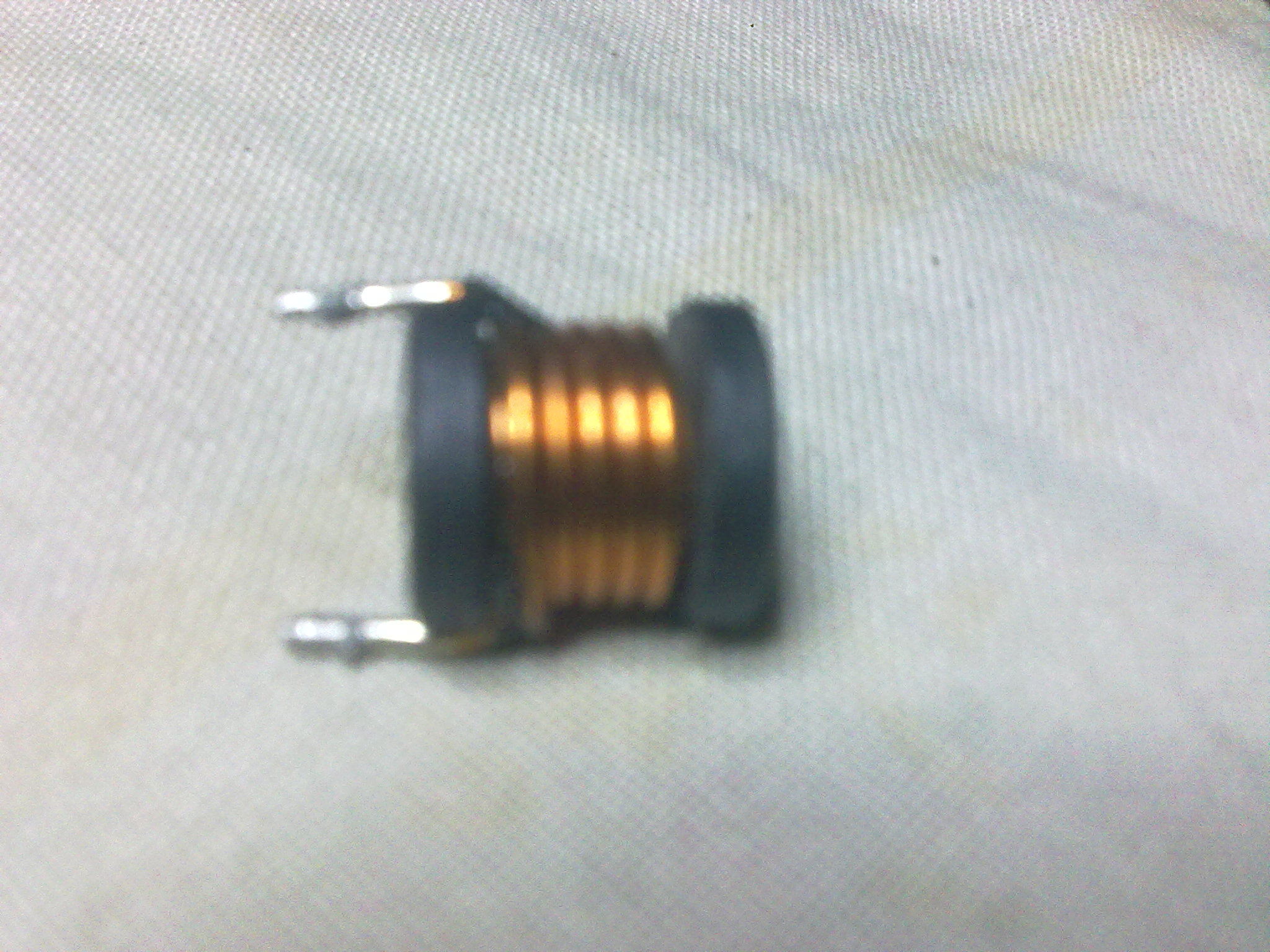

        Hi selldoor n tron , thanks for ur concern ... I don,t know about electronics much but I can change components :p So I observed my inverter board and saw an component a slight different in shape I don,t know what it is and kindly u people tell me it,s functions and if my problem of 3 secs display and gone is because of this??I think first I should stable my first problem of unstable display and then I,ll kill second one :p the white screen .. don,t know how to upload picture here but it was like golden wire surrounding it with two legs hope u guys get it .. I see if there,s any option to upload pic with this post .. Thanks :-)
          That is an inverter it should have a L*** number on the board beside it.
          They rarely go bad and when they do they burn up.
          What is the part number I asked for? It is marked in yellow on your first picture
            SPW-060 Rohs
            DAFRON 2034M 110809 B_
            These r the numbers mentioned above this part :-s
              ok - I need a good clear picture of the back of the board
