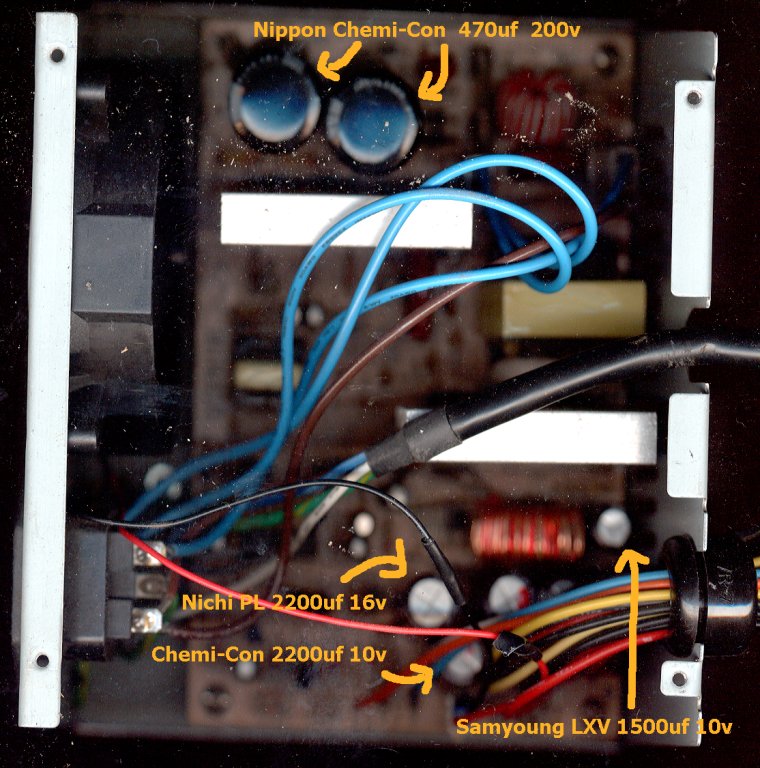

    Hello all,
    I had an old 230W KME power supply go flaky in a 486 awhile back, and since then retired it to the junkpile of PC parts outside. Well recently, I was digging around in that pile when I came across it. Suddenly I came up with the crazy idea of recapping it.
    So I dug it out of the pile, brought it inside, and took a look inside. In there I found that it had two 180uf 200v Panasonic primary (input) caps, which I thought were weak for a supply that's supposed to do 230W. The secondary caps were all D.S. type LL, and none had a capacitance higher than 1000uf. Also, the fan was missing (from a previous experiment.) So I went to work.
    First thing I did, was replace those two 180uf primaries with some beefy 470uf Chemi-Cons. The general majority of the secondary side went to my beloved Nichicon PLs, as well as a Chemi-Con LXF.
    Here are the original caps and parts, and what I replaced them with:
    2x 180uf 200v Panasonic --> 2x Nippon Chemi-Con 470uf 200v
    3x 1000uf 16v D.S. LL --> 3x Nichicon PL 2200uf 16v (I love the Nichi PL/PM )
    1x 1000uf 10v D.S. LL --> 1x Nippon Chemi-Con LXF 2200uf 10v
    1x 470uf 10v D.S. LL --> 1x Samyoung LXV 1500uf 10v (temporary)
    1x 10uf 50v D.S. LL --> 1x JPce-tur 10uf 50v (temporary)
    Missing 80mm fan --> 1x cheap 80mm Mitachi Spacefan (hey, it has to go someplace )
    The new caps were much bigger and heavier than the cheap D.S. things I removed, thus giving this lightweight supply a little weight.
    The result: It works! I connected an old DTK 386SX motherboard to it, as well as three old full-height 3.5" IDE hard drives (the biggest of which was a 340MB Maxtor LXT-340A which ate 10W idle). I ran a DMM on the voltages, and found that +12 had 12.13v and +5 had 5.21v. Tomorrow I'll finish up the recap (those Samyoung and JPce-tur will definitely be replaced).

    Here's some more information on the unit: It uses the Daewoo DBL494, which I assume to be similar to the Texas Instruments TL494. The PCB is nicely constructed and soldering is quite good (and it melted fast enough for my cheapo 25W Radio Shack iron to work with!) Heatsinks are a little small though, really makes me wonder if this unit is really just an over-rated 140W.
    Also I looked in the secondary section and found a single Rubycon 47uf 50v cap. Why they'd only use one Rubycon and use D.S. for the rest of the secondary section, I'll never know.
    Here's a craptastic pic of the unit (taken with my scanner)...

        Here's an update on the PSU.
        I replaced *all* D.S. electrolytic capacitors on the board. I had to use a (low-value) JPce-tur next to the flyback because I ran out of Nichis, Rubys or Chemis that would fit.
        Parts Replacement:
        Samyoung LXV 1500uf 10v --> Nichicon PF 1000uf 16v. (original was 470uf!)
        JPce-tur 10uf 50v --> Rubycon MH 10uf 50v
        Various low-value D.S. caps --> Rubycon, Nichicon and Chemi-Con equivalents
        One 1uf 50v D.S. --> JPce-tur 1uf 50v
        Cheap 80mm Mitachi fan --> Nidec Beta V 80mm 0.29amp /w shorted thermistor
        Also, I had to solder a capacitor ghetto-style because the solder pad broke off the board when I pulled the old cap out.
        Anyway, I tested the unit, seems to be OK so far. +12v remains at 12.11v, and +5v is steady at 5.20v. Will do some more testing later.

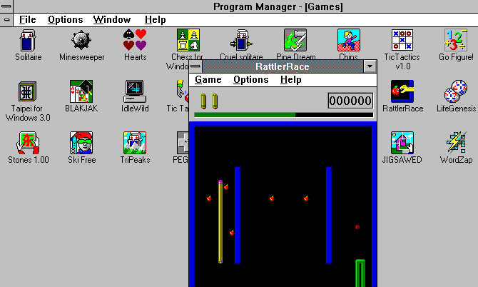

                Sometimes I powered my Acer 386sx just to play Rattler Race yours is older what can it do?

                  SkiFree! Wow, haven't seen that since the old Packard Hell...
