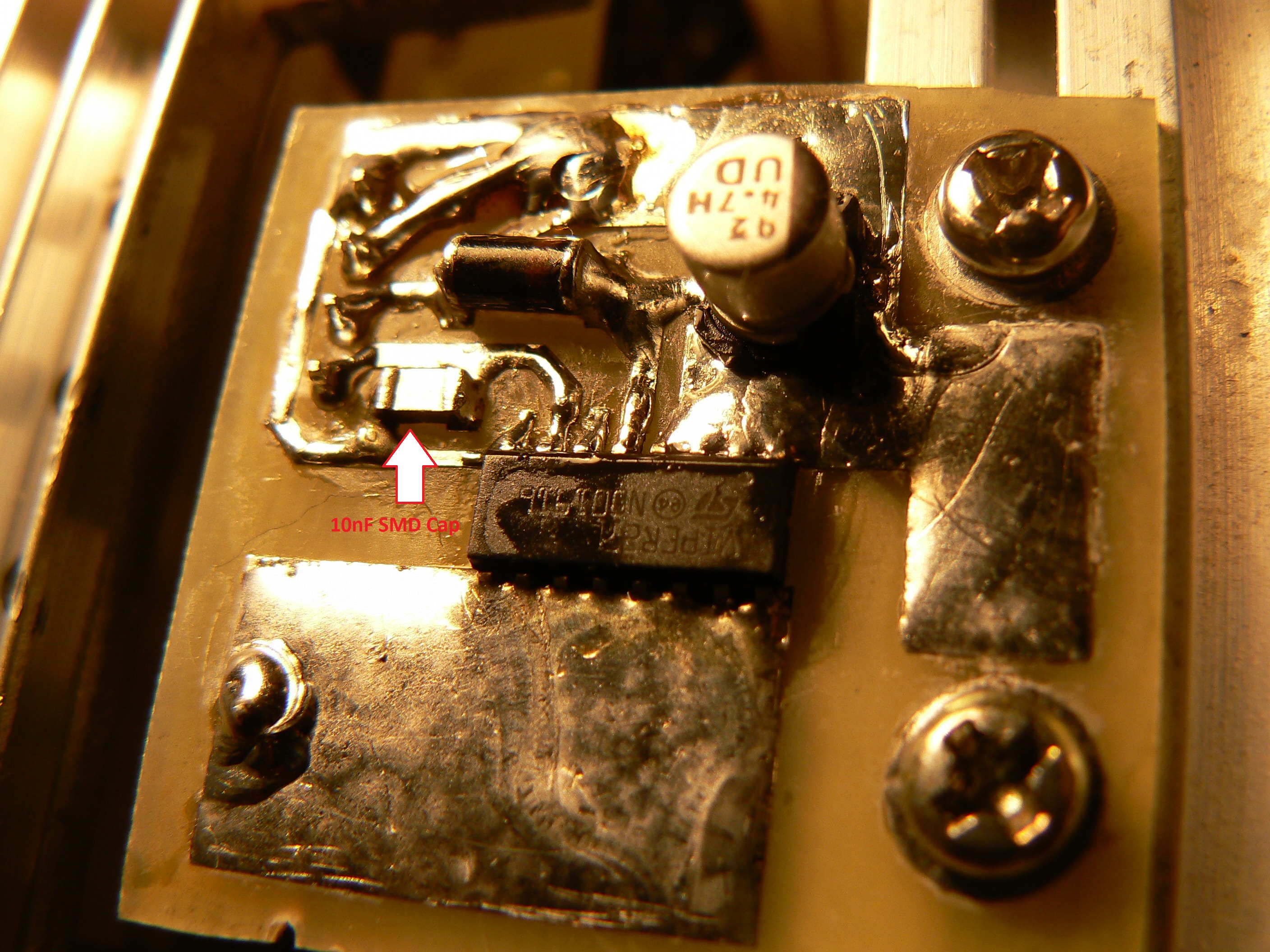

    Re: Antec Smart Power SP-350 5VSB mod using VIPer 22A pwm chip
    Originally posted by eccerr0r
    Hmm... looks like the feedback loop is not working since it hit 10V.
    How many volts at the feedback pin (careful, don't probe short!) (or measure across the transistor portion of the optoisolator)?
    Since the VIPer27 is a pull down feedback, the optoisolator should be pulling the feedback pin down to 0.3V (saturation voltage) when the voltage is that high. See if the "output" side of the optoisolator is indeed saturated. If it is, then something's wrong with the VIPer27 circuit, else something's wrong with the sense circuit on the secondary...
    I say the same. Also, there should be a small capacitor (10nF?) across the opto transistor, to help make it stable.
      You have blue wire going to 9.1k to ground. Remove the 9.1k resistor and replace it with a small piece of wire. This will short the blue wire to ground. Now measure the emitter of the optoisolator (pin 3) with respect to ground....should measure zero ohms. Now measure the feedback pin of the VIPer 27 with respect to optoisolator collector (pin 4)......should also measure zero ohms.
      The VIPer 27 does not use that 9.1k resistor. Wiring to the optoisolator pins 3 & 4 is backwards from the VIPer 22A.
        Check out the second picture, I have marked the capacitor you are suggesting.

        From what I saw from your DM211 design and the Viper27 datasheet I was thinking that the feedback circuit would not need a resistor but I was not sure. I figured it would be easier to have one I could remove than than it would be to add one later if it actually was needed. Plus I was curious to see what it would do to the circuit, I was surprised by the result as it was opposite of what I expected. I did remove it and I replaced it with just a wire as you suggested and as you can see from the picture it is now working properly. With the 16 ohm load my ATX tester puts on it the Vdd was running at ~17V. I cannot wait to make the load tester to see what both chips will do compared to the DIP Viper22A.
        Thanks for the feedback everyone.

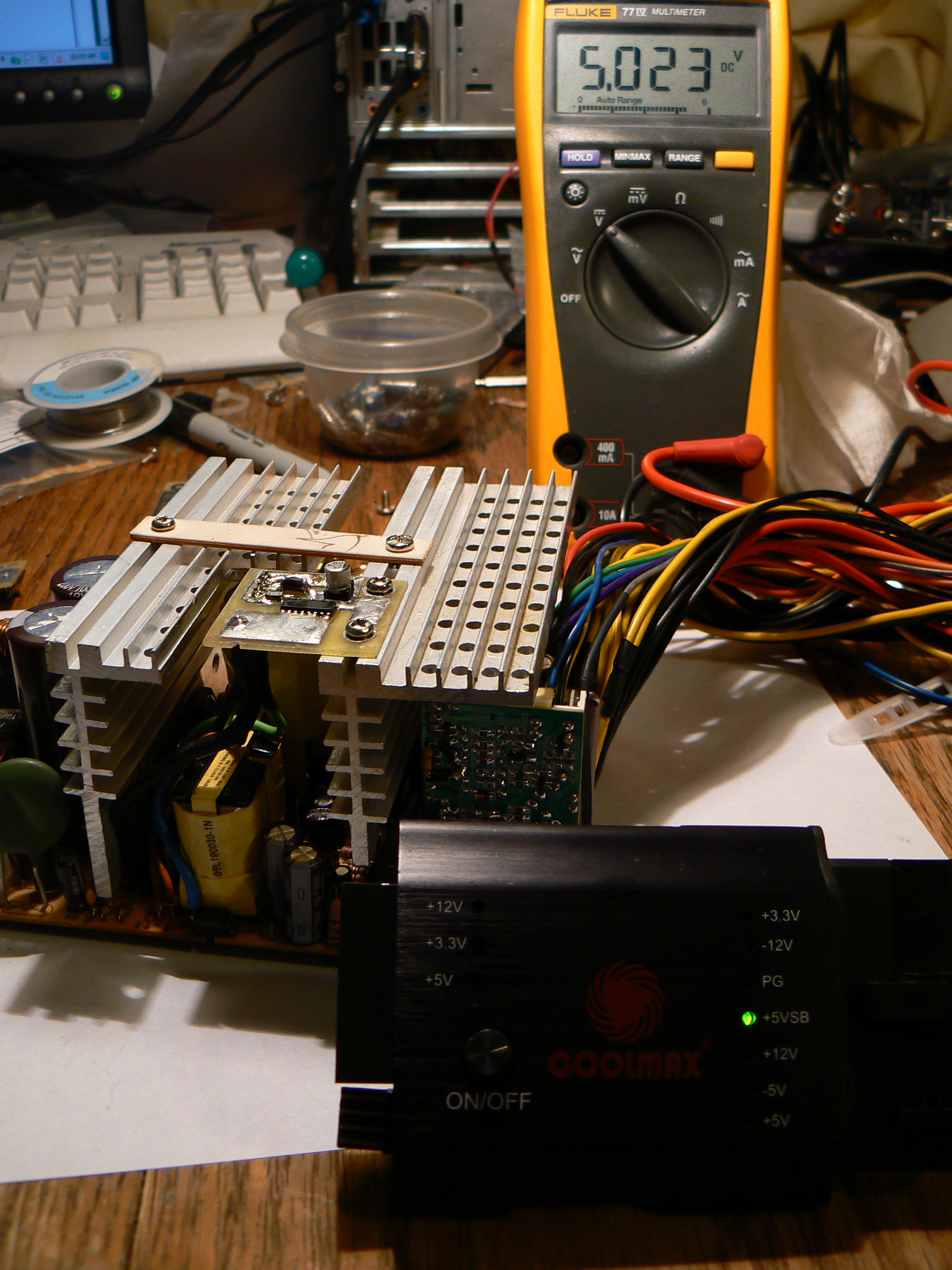

          Good job!
          P.S. - The datasheets don't lie! (VIPer27 datasheet shows no resistor for feedback)
          How is the temperature of the VIPer27 compared to the VIPer22, after, say, 10 minutes?

                    I have not had much time to work with these boards yet. I did not check the 22 but the 27 was ~175 F at the legs after about 5 minutes with a 16 ohm external load. The board for the 27 has ~205mm^2 of copper on the drain which is twice what the data sheet shows. I put even more copper under the SOIC 22 but I have not taken the time to calculate the actual area. The Viper22 calls for 200mm^2 so hopefully it does not get too hot.

                      A few suggestions, first, you should try to have an insulating pad in-between the PSU heatsink, and the VIPER board. I am talking about the kind they put 'tween power transistors and heatsinks. This could help cool it off a little more.
                      Second, since the operating frequency of the smps remains just about constant, you can use a capacitor of the correct value to limit the current. This is called capacitive reactance. The capacitor would go before the rectifying diode, where the AC is present. The capacitor also dissipates very little heat(MUCH less than a resistor).
                      However, everell, do you think this would work? I don't know if the varying duty cycle would interfere.
