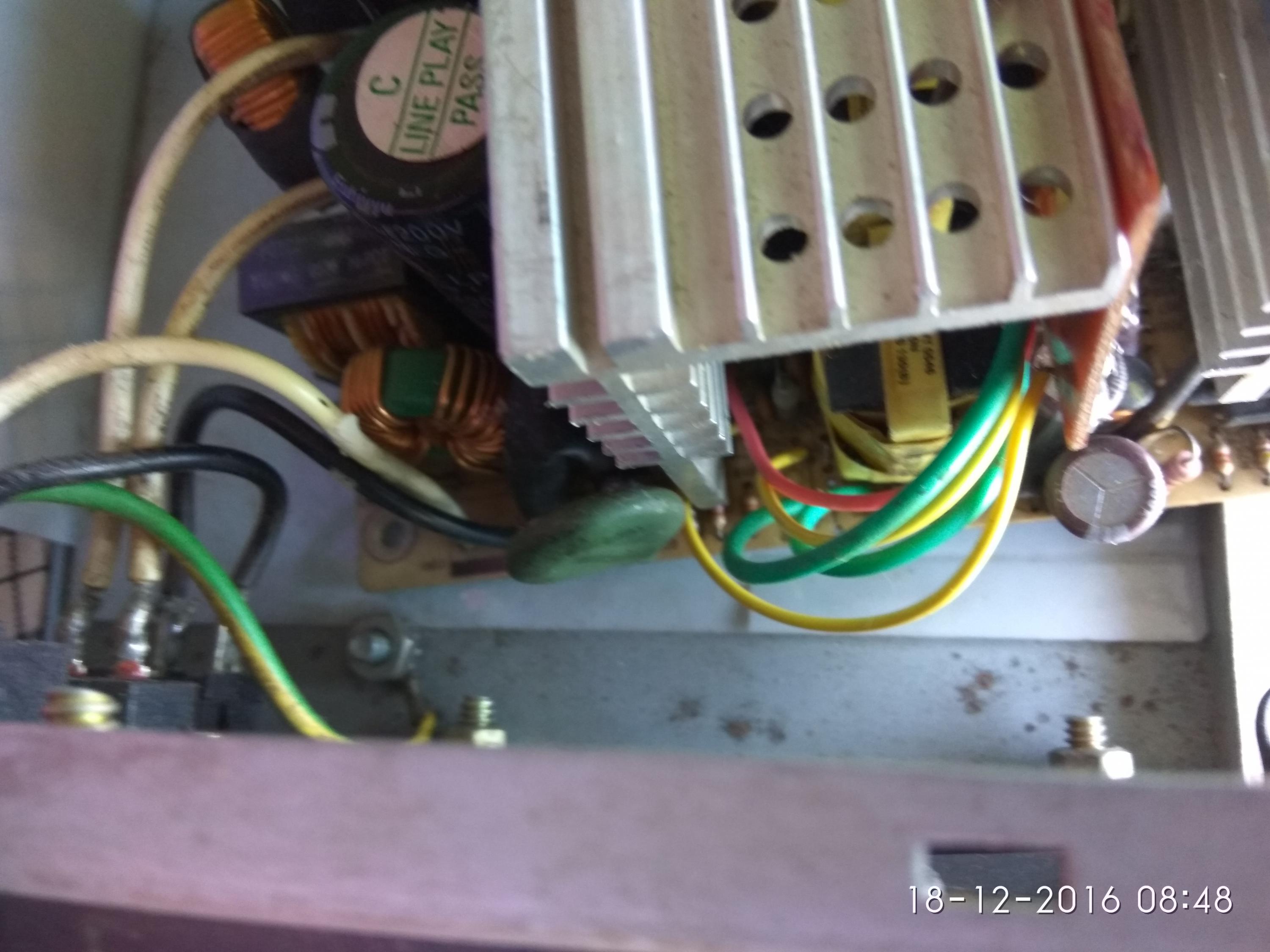

Antec Smart Power SP-350 5VSB mod using VIPer 22A pwm chip
  • bmaamba
    replied
    Re: Antec Smart Power SP-350 5VSB mod using VIPer 22A pwm chip
    First Post. Expertise level- novice in Electronics ( only built Rod Elliot's P3A Amp 10 years back with some help from an expert - which I am using).
    Antec SP-350P - Used some years in an AMD k6II-450 system. I do not remember now why I stopped using the Antec (must have been something major) and purchased a Gigabyte Superb 430w PS. Changed my cpu/MB to Intel E2160/Gigabyte G41 MB. Blew this Gigabyte PS while wrongly connecting the Power on a sata to ide adapter. Bought a Seasonic SII12 430w.
    Meanwhile, decided to do recap of the Antec. This Antec Fan was continuously making whooshing noise i.e. rotating at high speed in bursts. Found bulging secondary caps.
    Recapped most caps (with KY, KYB, KZN series caps) except 4 small value caps - 0.1uF,0.22uF,1uF, 10uF . Also did not recap the fan board and 2 Big 680uF caps. Replaced 1uF, 2.2uF caps with 4.7uF KMG caps, 10uF with 22uF KY cap.
    Thought I will also try the viper22A Everell mod. Mistakes made : a) used stiff house wiring single strand 1/18 copper wire for the mod board to psu board connections. Due to this and bad soldering, the track pads on the Antec lifted/got damaged. Replaced the 1/18 wires with soft multistrand wire.
    b) Did not trace/write down the “trace cut” on paper.
    Advice to another novice like me - Before you cut the trace on antec board (as advised by Everell), take a pen/paper/magnifying glass/headband and draw the (cut ) trace so you know where it goes . Check Everell', LDSisHere' photos and my photo. Hope somebody posts a “clean/nice” photo similar to mine (I have also not cleaned the board with Iso-propyl alcohol).
    Connected the larger fan outside the case because of the larger size cap used (this cap is visible below the Viper mod board) - someone else on badcaps.net has also done this.
    Connected PS with 60w bulb in series. Bulb dimmed. 5vsb was fluctuating between 4-5v. Other voltages were very low.
    Retouched the soldered joints (soldered by me). 5vsb was now steady @5v. But other voltages were low and fluctuating.
    Viper mod board securing screw to Heat Sink (HS) came out from the HS hole (due to the soft wires used in place of 1/18 wire and no nut used for the screw) and solder side of the Viper Mod board touched the heatsink. Fuse was blown. (Drilled hole in HS is in line with existing hole of HS).
    Installed the ceramic fuse (ordered from china). Soldered a new Viper IC bought from a local shop different from the one the 1st Viper IC was purchased ( this 1st seller had sold me a lemon DM311 (for Gigabyte PS repair)). Put the drill bit in the existing hole in the HS, tilted the Drill/drill machine at an angle in 2 opposite sides (along the HS ribs) so that a square nut fits in the sort of oblong/conical hole made – now screw tightened so that the Viper mod board is firmly held against the HS.
    60w bulb in series - dimmed. Success – 5vsb, 12v, 5v, 3.3v show OK.
    4 caps remained to be changed - 0.22uF (SS series, 105 C), 10uF, 0.1uF, 1uF.
    10uF, 50v Teapo cap (near that 0.22uF cap) - measured (out of circuit) 9983nF, ESR - 1.2 Ohms, 0.8% V loss on 13.0 USD GM328A Transistor Tester. (Should it be replaced? ??). Put the same cap back - after reading mockingbirsd's post where the PS was fine w/o this and 0.22uF cap.
    0.22uF (out of circuit) cap was showing 227.6nF, ESR-7.3, Vloss - 0.7%.(Should it be replaced? ?? or replaced with a ceramic cap?) Local shop only had 0.47uF, 85 C Rubycon (General) electrolytic old stock. Put the same cap back.
    (new KY 22uF, 50v on T Tester : C - 23.9uF, ESR - 0.5, Vloss - 1.5%). Ambient about 26 C.
    Replaced 1uF (near the 0.1uF cap) with 4.7uF cap.
    So 3 caps (+ caps on fan board + the 2 Big fuhjyyu 680uF caps) are unchanged - 0.1uF, 0.22uF, 10uF.
    Now, voltages (on new UT 139C MM) on Antec with a 8GB Samsung HDD load :
    5vsb - 5.03 v
    12v - 12.44v
    5v - 5.017v
    3.3v - 3.335v
    -12v - -11.49v
    Did not attempt the Fan board mod as - a) only light work is done on pc.
    b) could not find a high resolution photo of where the resistor is to be connected/soldered.
    Removed the Seasonic PS and using this Antec for about last 5 days.
    Thanks to Everell, LDSisHere and other posters.
    Leave a comment:
  • LDSisHere
    replied
    Re: Antec Smart Power SP-350 5VSB mod using VIPer 22A pwm chip
    I finally was able to make a board to test the Viper27 DIP version. (Sorry I do not have any pictures.) I had the same results with it as I did the SOIC version which is that it would run with a 5.1 ohm load but with a 3.4 ohm load it starts cycling off and on in less than a minute. According to the data sheet this chip should easily handle a 3.4 ohm load so I am not sure what the problem with it actually is and for now I am going to shelf this idea.
    I need this supply for actual use in a PC at least for a while so it will get a real world test powering a P4 D and a GTS250. I am using a Viper22A SOIC-8 to power the 5vsb to see how it holds up for an extended period of use.
    Leave a comment:
  • LDSisHere
    replied
    Re: Antec Smart Power SP-350 5VSB mod using VIPer 22A pwm chip
    Ben7,
    What kind of power supply are you working with? Also what kind of oscilloscope are you using, as I need to get one myself and I know very little about them?
    Leave a comment:
  • ben7
    replied
    Re: Antec Smart Power SP-350 5VSB mod using VIPer 22A pwm chip
    I tried making a VIPer22A psu again but it doesn't work. With a ballast (7W lightbulb) the thing ticks, and the output pulses from about 2V to 4.5V. It is at about 1-2Hz. With no ballast (I am using a 20-watt isolation tx which limits current) the chip gets slightly hot. Tried switching all the windings on the transformer around. Both tests, the aux winding only puts out 9-12vdc (after rectification). I always have bad luck with SMPS But, I got my new oscilloscope, so I will take a look at it. (It is digital too, I could upload some snapshots of waveforms!)
    Leave a comment:
  • ben7
    replied
    Re: Antec Smart Power SP-350 5VSB mod using VIPer 22A pwm chip
    Originally posted by LDSisHere
    I doubt that I have a snubber circuit since I do not know what a snubber circuit is in the first place. As far as the circuit diagram, I only copied the hand drawn schematics that Everell supplied into GEDA to make sure the connections were correct in the PCB software. The labeling is for my own purposes too suit my needs and corresponds to the pictures on how to connect this mod that Everell posted at the beginning of this thread. I am just trying to learn how these supplies work and give a little feedback on the difference in the different chips and packages. When I said the Viper22a should be able to handle more than 8.5W I was referring to the DIP package and I meant to be specific in the post but apparently I left that part out.
    Yeah yeah, thats ok, no problem!
    Leave a comment:
  • LDSisHere
    replied
    Re: Antec Smart Power SP-350 5VSB mod using VIPer 22A pwm chip
    1) Wow, good use of all the different types of probes and connector tips.
    I think you will really like the silicone leads as they are less likely to get tangled.
    2) The Fluke 12 has the Vchek (automagic detection of volts, continuity, diode, etc) feature and is sort of predecessor technology to the Fluke 113 which you hate so much.
    The 12 has a min/max function that timestamps the maximum and minimum readings as per user manual snapshot attached.
    3) And yes I have an used Fluke 12 and I like it. While it has the Vchek feature, I never use it. I use the manual controls instead when making measurements. The controls are slide switches and not rotary so the user interface takes a while to get used to if you are no familar with it.
    Thanks for the information about the Fluke 12, I will keep it in mind if I decide I need another meter. I have to say I am disappointed in the spring tension of the croc clips and the way they "bite" but I do like the variety of tips I have with the TL81A kit I bought. I just need to add Fluke style connectors to my Blue ESR tester like I saw on post on the EEVblog forum.
    Originally posted by ben7
    Do you have a snubber circuit installed? It does not look like it, from the poorly labeled circuit diagram
    I doubt that I have a snubber circuit since I do not know what a snubber circuit is in the first place. As far as the circuit diagram, I only copied the hand drawn schematics that Everell supplied into GEDA to make sure the connections were correct in the PCB software. The labeling is for my own purposes too suit my needs and corresponds to the pictures on how to connect this mod that Everell posted at the beginning of this thread. I am just trying to learn how these supplies work and give a little feedback on the difference in the different chips and packages. When I said the Viper22a should be able to handle more than 8.5W I was referring to the DIP package and I meant to be specific in the post but apparently I left that part out.
    Leave a comment:
  • ben7
    replied
    Re: Antec Smart Power SP-350 5VSB mod using VIPer 22A pwm chip
    According to the datasheet, the VIPer 22A soic can only do about 9-10 watts.
    Do you have a snubber circuit installed? It does not look like it, from the poorly labeled circuit diagram
    Last edited by ben7; 12-30-2012, 09:10 AM.
    Leave a comment:
  • retiredcaps
    replied
    Re: Antec Smart Power SP-350 5VSB mod using VIPer 22A pwm chip
    Originally posted by LDSisHere
    I ran it for an hour (Picture 10) with the Fluke 77 set to record the minimum 5VSB voltage.
    1) Wow, good use of all the different types of probes and connector tips.
    I think you will really like the silicone leads as they are less likely to get tangled.
    2) The Fluke 12 has the Vchek (automagic detection of volts, continuity, diode, etc) feature and is sort of predecessor technology to the Fluke 113 which you hate so much.
    The 12 has a min/max function that timestamps the maximum and minimum readings as per user manual snapshot attached.
    3) And yes I have an used Fluke 12 and I like it. While it has the Vchek feature, I never use it. I use the manual controls instead when making measurements. The controls are slide switches and not rotary so the user interface takes a while to get used to if you are no familar with it.
    Leave a comment:
  • LDSisHere
    replied
    Re: Antec Smart Power SP-350 5VSB mod using VIPer 22A pwm chip
    I have finally made some progress on testing the various VIPer chips and I thought I would share the results.
    The big hold up for me was a load tester that I trusted to run for more than a few minutes at a time. The the resistors on my first one would get close to 200 Deg F in under 10 minutes so I was afraid to run it for a longer period of time. The first four pictures are of my new 5VSB load tester. I have five 10 ohm 10W resistors in parallel with each controlled with a switch. I mounted them an old P3 heat sink in a gutted ATX power supply. I left the fan which I power with a separate 12V supply so it has no bearing on the tests.
    1 resistor = 10.1 ohm
    2 resistor = 5.1 ohm
    3 resistor = 3.4 ohm @ 5V = 1.47A or 8.5W
    4 resistor = 2.6 ohm @ 5V = 1.92A or 9.6W
    5 resistor = 2.1 ohm @ 5V = 2.38A or 11.9W
    The first test (Picture 5) is a Viper22a SOIC-8 loaded with 3.4 ohms of resistance. I ran it for an hour (Picture 6) with the Fluke 77 set to record the minimum 5VSB voltage. I did this so that if the chip reset I would know it. It ran for the hour with no issues. The max IR temp I could get was 166 Deg F at the drain pins. If I loaded it with 2.6 ohms of resistance it would reset in a matter of just a few minutes.
    The second test (Picture 7) was of the Viper27 SOIC-16 loaded with 3.4 ohms of resistance and a 100 ohm VCC resistor. It would reset in just a couple of minutes.
    The third test (Picture 8) was of the Viper27 SOIC-16 loaded with 3.4 ohms of resistance and a 10 ohm VCC resistor. It would reset in just a couple of minutes.
    The fourth test (Picture 9) is a Viper22a DIP-8 loaded with 3.4 ohms of resistance. I ran it for an hour (Picture 10) with the Fluke 77 set to record the minimum 5VSB voltage. It ran for the hour with no issues. The max IR temp I could get was 156 Deg F at the drain pins. If I loaded it with 2.6 ohms of resistance it also would reset in a matter of just a few minutes.
    I have some Viper27 DIP I intend to test but I have to make the boards on which to mount them first.
    The Viper22a chip should be able to handle more load than 8.5W so it seems something else in the system may be limiting the output when the resistance is lowered below this point.
    The Viper27 SOIC-16 should be able to handle more load than the Viper22A SOIC-8 according to the datasheet but the tests do not show it. Using the 10 ohm VCC resistor did allow it to run longer than the 100 ohm but not by much.
    I was actually surprised by all the results as they were not what I was expecting, especially the Viper27 tests.
    Leave a comment:
  • everell
    replied
    Re: Antec Smart Power SP-350 5VSB mod using VIPer 22A pwm chip
    For convenience, I'll just post it again here. To configure the pwm chip with a FET power driver, you should be able to use the power transistor in the original two transistor circuit. Just eliminate the small transistor (and its associated components) and use the pwm chip to drive it.
    You might want to find a different power supply to do this experiment with - most any old crappy power supply should do fine.
    Leave a comment:
  • LDSisHere
    replied
    Re: Antec Smart Power SP-350 5VSB mod using VIPer 22A pwm chip
    Originally posted by everell
    Now that you have a load tester, try these tests:
    Using VIPer 22a 8pin DIP circuit, run 5vsb for an hour with 4 resistors loading. Should do fine.
    Using VIPer 22a SOIC chip circuit, run 5vsb for an hour with 3 resistors loading. Hopefully it will do fine.
    Using VIPer 27 chip circuit, run 5vsb for an hour with 3 resistors loading. Maybe it will do fine.
    Using VIPer 27 chip circuit, run 5vsb for a few minutes with 4 resistors AFTER reducing resistor to 75 or 82 ohms. Will it stabilize?
    Using VIPer 27 chip circuit, run 5vsb for a few minutes with 4 resistors AFTER increasing resistor to 110 or 120 ohms. Will it stabilize?
    Maybe BOTH soic chips just can't handle the power. Perhaps you should consider building a 8 pin DIP VIPer 27 circuit. Then test it to see if it can handle the 4 resistor loading.
    When using a soic chip, we might have to use it to drive a power FET like in the Thermaltake Toughpower circuit I posted earlier.
    I have a problem with the load tester that I made that will have to be corrected before I will be able to run it for an hour at a time. I think I made a bad choice in resistors. They were getting to almost 200 deg F after just ~10 minutes of running so I am going to have to get some different ones. This is a link to the ones I bought: http://www.digikey.com/product-detai...TCT-ND/3114511 I am now thinking I should have went with the "cement" type which were cheaper to anyway.
    I will see if I can find your post about the Toughpower as the idea of driving a FET sounds intriguing and may be a much better idea for this project.
    Leave a comment:
    replied
    Re: Antec Smart Power SP-350 5VSB mod using VIPer 22A pwm chip
    Viper22a: That is dip 8 can handle more power than the SO-8, four 10 Ohm resistors in parallel is 2A = 10Watts which Dip8 can handle.
    What you see with SO-8 with four 10 Ohms is normal because you are trying to get more than it can handle.
    Also what was original circuit output current rating, that will limit how much you can pull from the transformer, transformer can only handle so much per VA rating. You can try driving the transformer with higher rating SMPS IC, but if you do not increase the VA rating of the transformer, you will not get the out power that you want.
    Last edited by budm; 12-01-2012, 08:25 PM.
    Leave a comment:
  • everell
    replied
    Re: Antec Smart Power SP-350 5VSB mod using VIPer 22A pwm chip
    Now that you have a load tester, try these tests:
    Using VIPer 22a 8pin DIP circuit, run 5vsb for an hour with 4 resistors loading. Should do fine.
    Using VIPer 22a SOIC chip circuit, run 5vsb for an hour with 3 resistors loading. Hopefully it will do fine.
    Using VIPer 27 chip circuit, run 5vsb for an hour with 3 resistors loading. Maybe it will do fine.
    Using VIPer 27 chip circuit, run 5vsb for a few minutes with 4 resistors AFTER reducing resistor to 75 or 82 ohms. Will it stabilize?
    Using VIPer 27 chip circuit, run 5vsb for a few minutes with 4 resistors AFTER increasing resistor to 110 or 120 ohms. Will it stabilize?
    Maybe BOTH soic chips just can't handle the power. Perhaps you should consider building a 8 pin DIP VIPer 27 circuit. Then test it to see if it can handle the 4 resistor loading.
    When using a soic chip, we might have to use it to drive a power FET like in the Thermaltake Toughpower circuit I posted earlier.
    Leave a comment:
  • LDSisHere
    replied
    Re: Antec Smart Power SP-350 5VSB mod using VIPer 22A pwm chip
    Originally posted by budm
    Three 10 Ohms in parallel (= 3.33 Ohms) to load the 5V, that is only about 1.5A. How much was the original 5v circuits supposes to be able to handle?
    Viper22A
    Table 1. Typical power capability
    Mains type SO-8 DIP-8
    European (195 - 265 Vac) 12 W 20 W
    US / wide range (85 - 265 Vac) 7 W 12 W
    SO-8 7WATTS, DIP8 12WATTS
    So you are using SO-8
    So 5V @1.5A = 7.5W if 100% efficiency. I do not think you will get reliable 1.5A from the setup.
    If the transformer VA rating is not made to deliver more than 1.5A, then it will not matter much how hard you drive the transformer.
    This was discussed on the first page of this thread, it is the reason the Viper27 is being used as it should be able to match the output of the DIP version of the Viper22A.
    Viper27: US / wide range (85 - 265 Vac) 12 W - Open frame
    The SOIC-8 Viper22a version is only being used for comparison purposes. It was expected to be limited to 1.5A or less of output.
    Originally posted by LDSisHere
    I still want to do a SO-8 version of this mod but when I was looking at the datasheet I noticed that it was good for 7W (US) where the dip version was good for 12W (US). Would the reduced power capability be an issue if the SO-8 version was used?
    Originally posted by ben7
    Well, most of the time, the standby power has to power the smps control chip too (ex, a TL494). Most PSUs have a 5vsb rating of 1.5 to 2A. So the 7W would only do about 1.4 amps. You could use the SMD version (16-pin SOIC) of the VIPer25
    Originally posted by everell
    Maybe you should start by making a surfact mount board using the Viper 22A even if it has less power. Then develop a board using the Viper 27.
    For the concerns about the transformer being able to deliver the 2.0A I am attaching a picture of the power supply panel information and my tests with the DIP version of the Viper22a also confirmed to me that it could deliver the required power.
    Originally posted by LDSisHere
    I also did a little testing of the DIP Viper22a to see how it would perform and it would hold steady with all four resistors engaged.
    The four resistors in parallel measured 2.7 ohms so at 5V that equals 1.85 Amps which is close enough to 2.0A to suit my purposes.
    Originally posted by everell
    With the 100 ohm resistor, what were the Vdd values for each of the ten ohm resistors? You would think that reducing the value of the resistor would help with all four resistors in. Actually, just the opposite is true, because when the chip is trying to shut down from overvoltage, it REDUCES the Vdd as it oscillates.
    Write down the Vdd measurement for each of the first three resistors, then CALCULATE what the next value should be. The Vdd should increase for each resistor just like the VIPer 22A DIP circuit did.
    Everell I have attached an image of the schematic for the Viper27 circuit. Vdd is going through a 100 ohm 1/2W resistor and the Vdd also has a 22V zener attached to it but it should not have come into play according to my tests. If you look at picture 4 in post #85 you will see the Vdd is only 18.08V. In picture 5 you will see the same Vdd but the Viper starts to reset itself when attached to a 2.7 ohm load. In picture 1 you will see a picture of the Vdd at 10.90V when the Viper27 only has a 470 ohm resistor and LED attached to it.
    The SOIC-8 Viper22a had a starting Vdd of 13.73V with only the 470 ohm resistor and LED attached to it. (Post #85 picture #6) The Vdd on this board peaked at 26.06V with a 2.7 ohm load. (Post #85 picture #10)
    My initial thoughts on lowering the Vdd resistor value was that it was dropping Idd too much and causing it to shut down under high load, however I now do not believe that is the case since the Viper27's max Idd is 25mA. I may still try a lower value resistor just to see what happens. I do not think it would hurt anything and it would give us more information about what the circuit is actually doing and maybe give some clues as to why it is shutting down.
    Leave a comment:
    replied
    Re: Antec Smart Power SP-350 5VSB mod using VIPer 22A pwm chip
    A normal flyback is wound with the aux winding the same way as the main output winding. That way it is fixed at a constant ratio to the main winding.
    But some self-oscillating circuits do it differently, which could be why you are seeing excessive aux outputs; you're picking up the "back emf" (I cannot recall the correct term.) This varies with load. What does reversing the aux winding do?
    Leave a comment:
  • everell
    replied
    Re: Antec Smart Power SP-350 5VSB mod using VIPer 22A pwm chip
    With the 100 ohm resistor, what were the Vdd values for each of the ten ohm resistors? You would think that reducing the value of the resistor would help with all four resistors in. Actually, just the opposite is true, because when the chip is trying to shut down from overvoltage, it REDUCES the Vdd as it oscillates.
    Write down the Vdd measurement for each of the first three resistors, then CALCULATE what the next value should be. The Vdd should increase for each resistor just like the VIPer 22A DIP circuit did.
    Leave a comment:
    replied
    Re: Antec Smart Power SP-350 5VSB mod using VIPer 22A pwm chip
    Three 10 Ohms in parallel (= 3.33 Ohms) to load the 5V, that is only about 1.5A. How much was the original 5v circuits supposes to be able to handle?
    Viper22A
    Table 1. Typical power capability
    Mains type SO-8 DIP-8
    European (195 - 265 Vac) 12 W 20 W
    US / wide range (85 - 265 Vac) 7 W 12 W
    SO-8 7WATTS, DIP8 12WATTS
    So you are using SO-8
    So 5V @1.5A = 7.5W if 100% efficiency. I do not think you will get reliable 1.5A from the setup.
    If the transformer VA rating is not made to deliver more than 1.5A, then it will not matter much how hard you drive the transformer.
    Last edited by budm; 11-30-2012, 11:20 PM.
    Leave a comment:
  • LDSisHere
    replied
    Re: Antec Smart Power SP-350 5VSB mod using VIPer 22A pwm chip
    I finally was able to get the new Viper27 board done. I used a 100 ohm resistor and a 22V zener to limit the Vdd. I think the 100 ohm resistor did enough that the 22V zener never came into play. The first five picture are of the Viper27 board in operation. You should be able to see the number of switches that were thrown in each picture. It was able to stay steady with up to three 10 ohm resistors in parallel providing the load. When the fourth one was thrown it would hold for just a short while then it would start resetting. The interesting part was that the Vdd never got higher than 18.1V. It may be that a lower value resistor could make the difference but I have not tested that theory.
    The next six picture show the SOIC8 Viper22a board being tested. The interesting part of this test to me was that it acted much the same as the 27 the main difference was that the Vdd climbed much higher as would be expected. It climbed to 26.1V when all four resistors were engaged and it too started resetting. It would hold steady with three resistors like the 27.
    I also did a little testing of the DIP Viper22a to see how it would perform and it would hold steady with all four resistors engaged.
    I do not know if the SOIC8 Viper22a version can be modified where it would hold under a higher load as it may just be at its' design limits. I do think that more power may be squeezed out of the Viper27 but it too may have been running at its' operational limits. I think I will try a lower value of resistor to see what that does to the circuit when I get a chance.
    Leave a comment:
  • LDSisHere
    replied
    Re: Antec Smart Power SP-350 5VSB mod using VIPer 22A pwm chip
    I finally got my 5VSB load tester built. I have been extremely busy so I have not had much time to spend on this project. I just had time to test it with the last Viper27 board I built to see if it worked properly. I have etched a Viper 27 board to use a Zener diode or two also but I did not have time to populate it tonight. I also just got in some 22V Zeners to use with the Viper27. In my quick test it would hold for just a few seconds with all the resistors on, which measured 2.7 ohms. After it started osculating on and off it would not stabilize until they all were turned back off. I hope to have some time tomorrow to work with it some more.
    Leave a comment:
    replied
    Re: Antec Smart Power SP-350 5VSB mod using VIPer 22A pwm chip
    I subscribe to this magazine, it has lots of information which helps me a lot in designing the products. These are great website for learning about power electronics design:
    http://powerelectronics.com/
    By the way, if the drop in IC is not the same , the control loop circuits should also be adjusted.
    http://www.edaboard.com/thread254203.html
    http://www.beigebag.com/case_TL431.htm
    http://www.sonsivri.to/forum/index.php?topic=23855.0
    juts google control loop using TL431
    Last edited by budm; 11-26-2012, 01:10 AM.
    Leave a comment:
  • Rgyver2
    Antec EA-430D 5VSB issue
    by Rgyver2
    I have an Antec ea-430d that will not turn on due to a problem with the 5VSB circuit. the TNY278PN has a burn "drain" pin (pin 4) and the two diodes (D901 and ZD901) near it look burnt with black on the board. (they were covered in that white goop which i removed).
    The TNY278PN needs replaced and likely the 2 diodes as well. I found the TNY278PN, but need to know what to order to replace diode D901 and the zener diode ZD901.
    From reading other posts, it seems wise to also replace the large 450V 270uf cap.
    The diode info and any other advice of what else to...
    04-18-2021, 12:00 AM
  • прямо
    Viper22A 5VSB circuit
    by прямо
    So I have a cheap non working ATX PSU that I was learning to repair a decade ago. At the time, it blew the main fuse, bridger rectifier, NTC, and primary 9A 900V MOSFET. Replaced all except the MOSFET. 5VSB came back online. Then I poked around in it so much, measuring components one by one to a point I accidentally made the 5VSB circuit primary side went bang. Blown the AP8022 (Viper22A) PWM chip, along with a low resistance resistor and the PC817 opto isolator. I replaced them all.
    In the process of poking around, I also lost a zener diode that stabilize the voltage coming from...
    01-13-2024, 07:05 PM
  • kotel studios
    FSP300-60GTF - no 5VSB, PS_ON; 5VSB carnage
    by kotel studios
    Finally replaced all of the shorted 4148's and resistors and an blown tl431 on my FSP300-60GTF after 5VSB going crazy and destroying it self. Those components also made the secondary transistors appear shorted (while in reality they weren't).
    Powered it on through my dim bulb tester and they (bulbs) only flash once meaning primary caps are getting charged, but that's it. No 5VSB, PS_ON voltages.
    I am sure I have replaced the components correctly and that there weren't any shorted/blown traces left.
    Any ideas where to go next?
    02-23-2025, 11:47 AM
  • mrcliem
    CM V700 no +5vsb, ICE2QR4765 low VCC in... Need guidance please...
    by mrcliem
    Hello...
    I got my self a dead CM V700 PSU, with nothing on +5vsb
    I have tried to fix it for the past 2 week, and I'm stuck... so i guess i post it here to get some pointer before i scrap it..
    As you can see in photo, the psu still pretty clean, no visible damage or bulging cap.. when i got it, it still has CM seal on it
    The +5vsb system use ICE2QR4765, I have trace and measure the voltage on ICE2QR4765 and the only voltage reading i got is in VCC 4.8v, Drain 310v and FB 3v.
    I have read the datasheet and and still can not...
    06-29-2023, 08:18 AM
    Mounting and Handling Guidelines for TO220 TO220F TO247 Cases / Packages
    Mounting and Handling Guidelines for TO220 TO220F TO247 Cases / Packages
    The TO220, TO220F and TO247 are the popular packages for power devices because of their versatility and ability to dissipate moderate amounts of heat. This application note describes the basic guidelines for handling power MOSFETs in TO220, TO220 and TO247 packages shown in Figure 1. Please note that only mechanical and soldering guidelines are covered here. Additional precautions are required for isolating high voltage rated devices to meet safety regulations.
    Securing a good thermal interface between...
    10-07-2024, 04:35 AM
