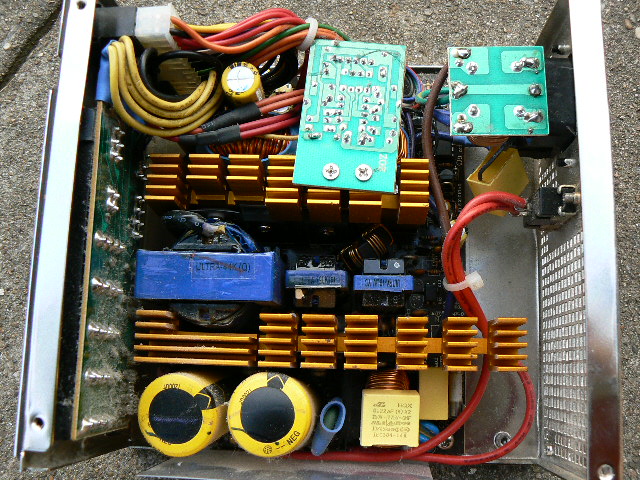

    I have been going through my power supplies to see if they have problems since I have seen what happens if you wait until something pops. I remembered this Ultra 550 (ULT-X2550P) supply that I had in an old case. I pulled it out and found a main cap bloated. I also found the strangest arrangement of capacitors. You have to look at the pictures but they stacked two caps in the same space. The top cap has heatshrink on the legs of the cap.

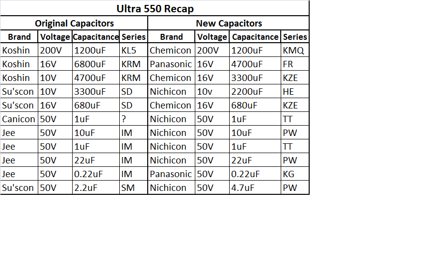

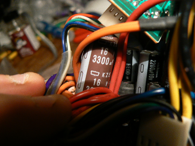

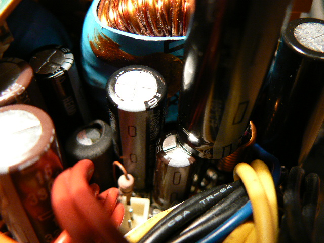

    I have already replaced ALL the capacitors and it all seems to work, the voltage is within ATX specifications but on the high side. The main chip is a KA7500 if that matters. Does anyone know if this can be adjusted and how to go about it? Also I would like to do the 5VSB OVP mod to this supply if it is applicable, can anyone tell me if this is the type of supply that needs this done?
    12V = 12.01V
    5V = 5.19V
    3.3V = 3.39V
    I really like this supply, so any input on improving it would be appreciated. I have already added a resistor across the thermosistor to increase the fan speed.

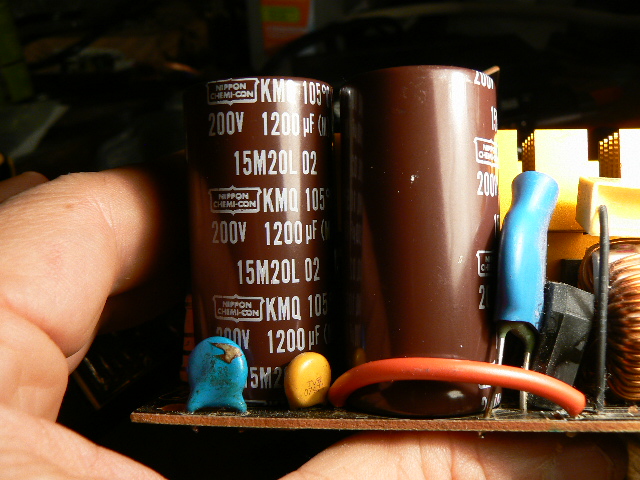

      This seems capable of doing its rated Watts. Could you make a list of the original capacitors (maker, series, uF) and the ones you used to replace them?
      The values you get are ok.

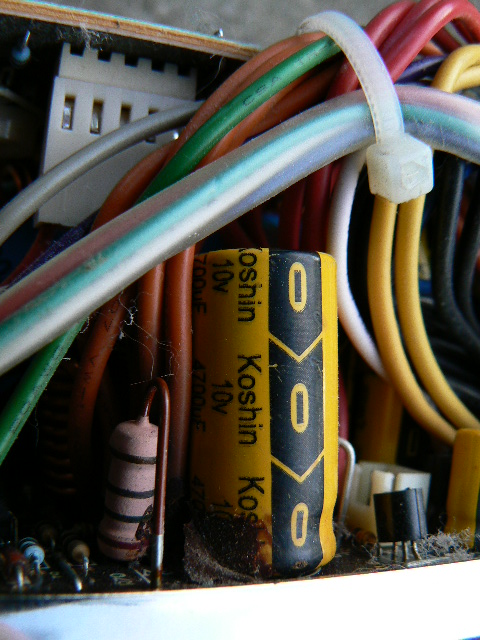

        I have included an image of the capacitor values I used and a spreadsheet. It could be my choices here are a problem as I have just recently came to understand their importance but I am again limited by my knowledge.
              The cap choices you made are good.
              As for adjusting the output... there may be a potentiometer for that, but it could also be used for OCP or OPP, so you will have to trace the circuit to make sure it's for adjusting the voltage. If not, post #5 in this thread shows how to mod a half-bridge PSU like yours.
              https://www.badcaps.net/forum/showthread.php?t=22129
              I think the only difference between your KA7500 controller and the TL494 is the pinouts.

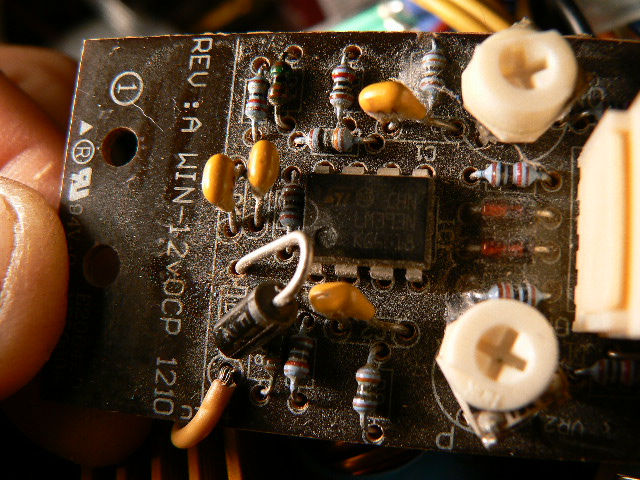

              But most importantly: this is a group-regulated power supply (i.e. the 12V, 5V, and 3.3V rails are all regulated together). If you lower the voltage on one of these rails, the voltage on the other rails will fall proportionately. So it may not be possible to adjust the voltages to exactly the way you'd like them to be.
              IMO you should try the power supply first with a load (an old P4 motherboard would be good) and if the voltages are still too high for your tastes, then adjust. But again, IMO, your voltages are pretty good. If anything, the 5VSB is the most important. Make sure it is well within spec.

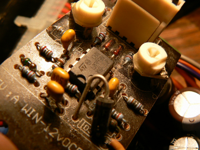

                I was wondering how the 12V OVP board played into this regulation? (attached picture) Is 12V regulated separately or is it just monitored closer? The only potentiometers that I saw in this supply are on the 12V OVP board that you see in the picture. Power supplies are way more complex than I ever gave them credit for in the past.

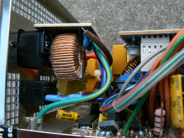

                  A cousin of mine recently, gave my parents a system containing one of these supplies. I can't get past how the inductors are pressed right up against the heatsinks, and the caps raised up off the PCB because they can't fit otherwise. Blech! It has a few of the medium sized caps beginning to blow on the secondary side so I'm just gonna look for something else. Just seems like a bad design layout.

                      In this case, I have to agree with Logistics that these Ultra PSUs, which appear to be based on an outdated YoungYear half-bridge design with terrible layout, are indeed hardly worth fixing/upgrading.
