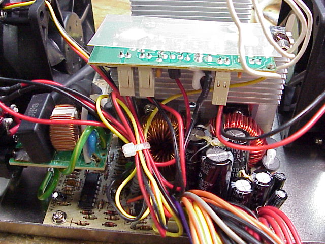

    ablecom sp301-ra.
    seems i have seen this board in some cheapie.
    must be their entry level psu.
    no bulging caps but it had enough ripple to cause video artifacts.
    seems fine after a recap.

    Rubycon input, but what were the output caps?

        jpcon pce-tur on the output.
        pc turds?
